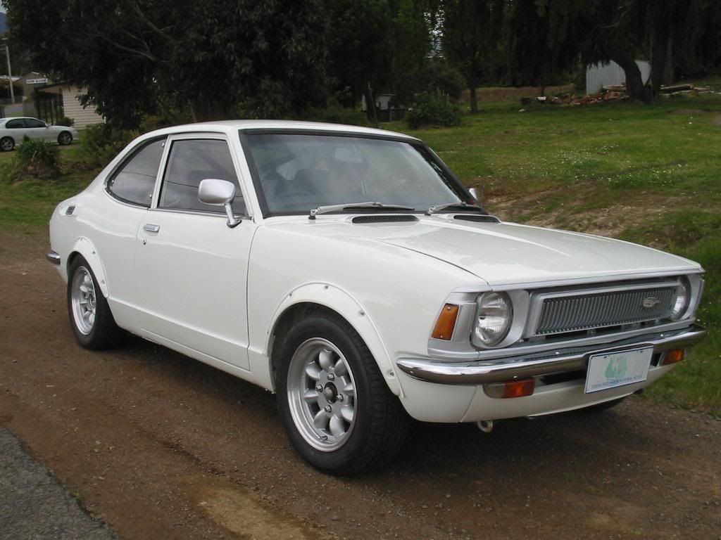

Ke 25 3sge, Pics
Wow!!! What a tough little 25! :n:
If you don't mind me asking, where did you source the U-bolts and backing plates from?
Whiteline kit, which included 2" Lowering blocks and U bolts for a Corona or Sigma, can't remember which one. I had two kits for a while. I used the standard backing plates, and even though the lengths of the U Bolts are not exactly parallel, they are not too bad. I was able to bend the U Bolts by hand to make them fit the standard backing plates. Without the 2" spacer, they would be, in my opinion, too "unparallel." I think there is enough metal on the original backing plate to file away some metal, to get them exactly parallel. But you'll have to check that for yourself.

Well, the project is now registered, and a blast to drive on the road!
I've spent too much on 98 octane in the past week, but well worth it. My mate (Jonny) and I have been taking turns behind the wheel and the other in the passanger seat with the hand controller, and last night have pretty well sorted out the tuning side, the motor is purring along. I've set the rev limiter to 7000, and it pulls well all the way to it. To accelerate and be ahead at the "traffic light drag" only need 3500 rpm change points, and will get up the big steep hills near where I live in 5th easily. Back a gear (or two) and it takes off well.
The LSD is tight, and I'm happy with the overall gearing and tightness of the car too. Will play around with the adjustable shocks in a while, but they are doing great on the curvey back roads.
It ran too hot with a thermostat, but tends to run too cold (50 - 65C) without it. A few little issues like that, but all in all good.
Hopefully get a few pics soon.
A happy driver, rob.
