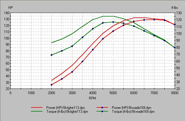

Felix Posted March 16, 2007 Report Posted March 16, 2007 Tighe 113 FTW, in a street driven engine. Following is a Dyno2000 prediction of Wade169 vs Tighe113. Carb airflow is for 40mm dellortos with 36mm chokes. Everything is identical except the CR. Stock valve size with pocket porting. Note Tighe 113 has 9.5:1 CR, the Wade 169 needed 11:1. Quote

Raven Posted March 16, 2007 Report Posted March 16, 2007 Nice nice. Dyno2000 says 135HP hey..... Can't wait till i get my dellorto's on and the motor in the car (once the car is restored) :P Quote

Bigger Is Better Posted March 16, 2007 Author Report Posted March 16, 2007 Hey felix was that RW HP or at the flywheel. Either way very impressive for. Was it a 4 0r 5k Josh Quote
