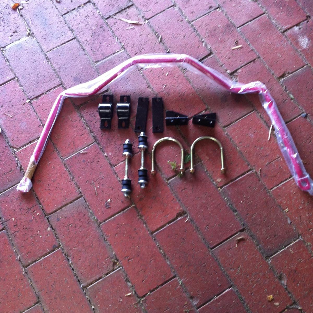

This is the only photo I have that may help with your Q Parrot.
I am also working on a group buy price for 16-17mm ke1x rear bar in kit form.
Sort of look like this, except slightly different mounting hardware.

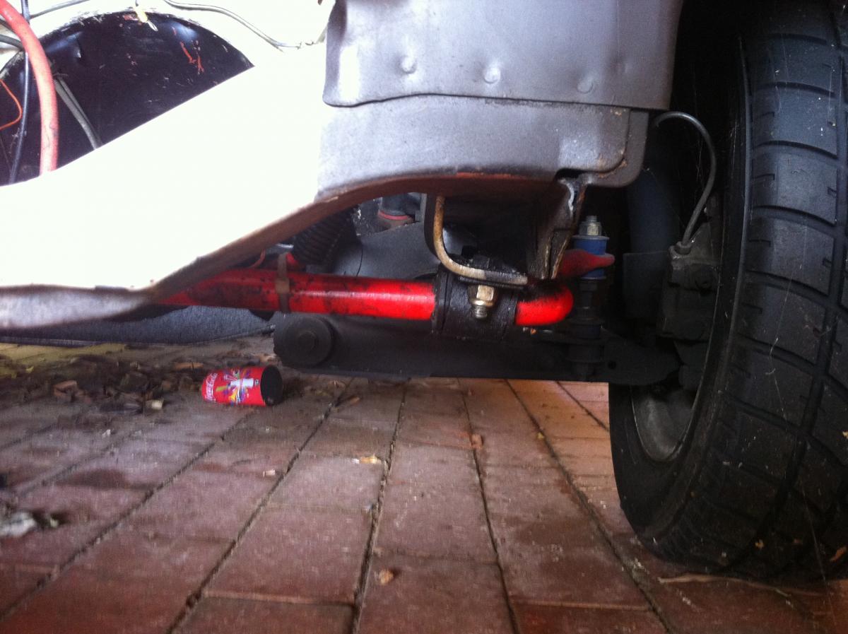

Hi there parrot sorry i havent been on for a while ,was just talking to Stu (kickn5k) and told me you were after a measurement of our front sway bar. I will get it for you tomorrow and post it up here or if you want to ring me? feel free to do so on my mobile 0428 574248.
Cheers:- Stuart (Thomas dad).
Put me down for a p.m re: rear sway bars when your ready aswell Kick'n
cheers
darren
Stuart kindly measured his adjusted bar and I have provided this detail to Todd at Selby's. The centre to centre measurment at the eyes is 895mm.
Todd can make the bar to that measurement, which will hopefully prevent further issues with disc braked cars.
Cost for the bar & kit is $253 + freight.
I am going to get one made up for my car.
Perhaps if anyone else is interested now or later, you may wish to talk to Todd specifying the adjusted bar.
