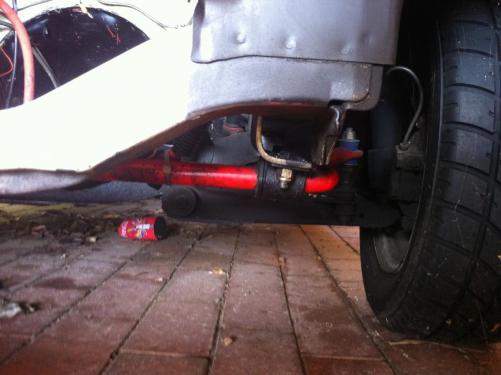

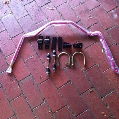

The single biggest improvement to handling on a ke1x is to add a front swaybar. Whiteline makes a good 22mm kit. Alternatively if you can find a front bar from an RT40 corona, you could make up some brackets to adapt. The RT40 bars are 19mm, and are almost identical in dimensions to the bar in the Whiteline kit.

Doug convinced me to get a whiteline swaybar and i would never drive a ke1x without
one. interesting about that rt40 corona one, ill look into that...
Think i paid AU$230 (delivered) for the last one I bought for the ke16. That was about 3 years ago though.
I have one on both my ke15 and ke16. Makes a huge difference to handling! As ROL-110 said, I would never drive a ke1x without one. Really helps to stop lifting the inside rear during hard cornering, and makes the car corner flat.
