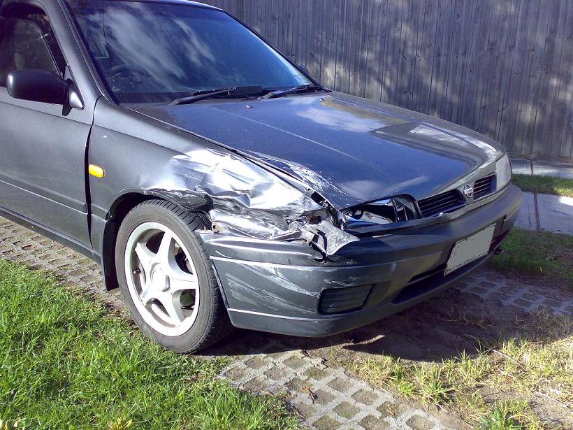

Well, Mothers Day turned a bit sour for me. I was driving in a straight line down Springvale road when a Commodore failed to give way, and decided to make a right hand turn right across infront of me. My front drivers side collided with his lhs front gaurd. 40-50kmh impact.....one of the less violent ones i have been in.
The Panel shop quoted at least $5000 to fix the damage using genuine parts. Considering the car is insured for $4550, he suggested that it will be an economical write off. The assessor came and looked at the car whilst i was at work, am i'm yet to hear what his decision is.
The visual damage consists of Front Gaurd, Bonnet (payed to have that resprayed 6 months ago :cool: when the car was in the panel shop being repaired after a Mazda 6 rear ended me), Bumper, Headlight, metal trim under grill, rhs section of the radiator support panel, most likely the inner gaurd/engine bay where the top of the front gaurd bolts on.
The car drives fine, and luckily the suspension and chassis were spared.

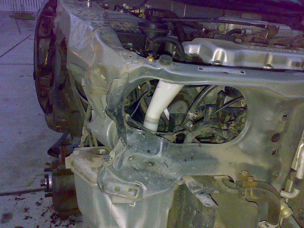

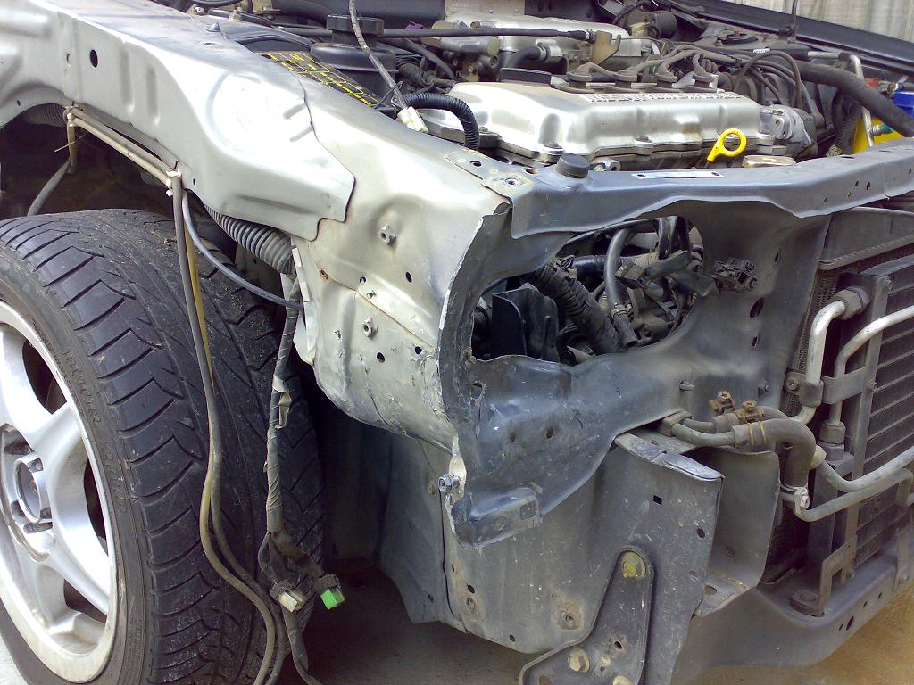

I had a bit of a play this morning with it. I've got the inner gaurd all hammered out and sort of resembling a straight car. The inner gaurd faired better than i expected actually. Luckily the bumper reinforcement/support bar took a heap of the impact. I will have to wait for new panels to arrive before i can fine tune it and make sure the gaurds will bolt up.
Also got a few quotes on parts (Bonnet, Front Bar and reinforcement bar, Front Gaurd,Headlight and Indicator, Filler Panel). $720 from the first place (dreamers!) and $563 delivered to my door from another. I could get them much cheaper at a wreckers, but finding a car that has all the parts i need proved to be harder than expected. I would have to pull apart at least 3 cars from two different wreckers to get all the necessary undamaged parts that I need. Let me tell you, that these cars are not as easy to work on as a Corolla. Everything is bolted to each other. To get to one simple part, you need to pull the whole front assembly off to get to it.
Melbourne has finally got some decent rain and all the wreckers have pools of water under the cars. I would rather pay a few hundred extra to have all the parts removed and delivered rather than lay in a pool of oily water. So I am going with the $563 quote as above. Hopefully will have them Tuesday.
Heres two pics of before and after I hammered the inner gaurd out this morning.
