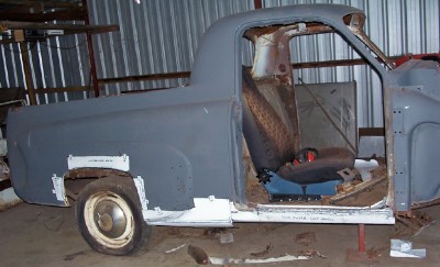

Ok so work has been slow on the ol vauxhall ute of late,had the chance too work on it twice in the last two weeks.
The results are in the pics, tho the story more interesting.

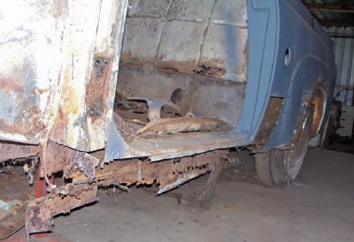

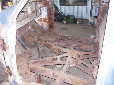

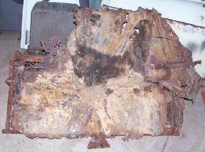

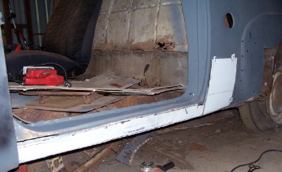

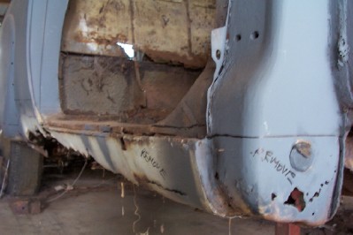

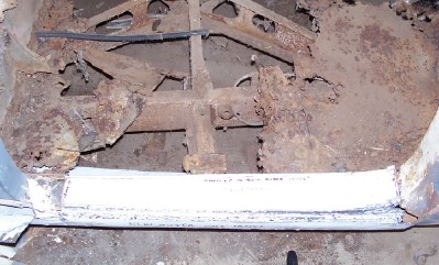

I had not been able to find where the seat unbolted,due to the amount of rust etc in the floor.So bugger it i took the seat and the floor out in one,few cuts with a grinder and cutting disc (mmm should have brought more disc`s) and with the help of a garden tool mainly a pick axe to hack the floor when i ran out of cutting disc.
the tailgate would budge either on one side,the lock pin was jammed solid.so with the leverage of the matock i at last got it free and was able to get the tailgate off.

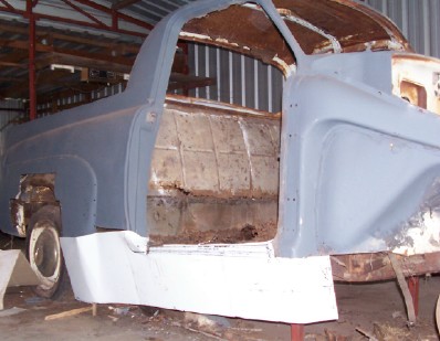

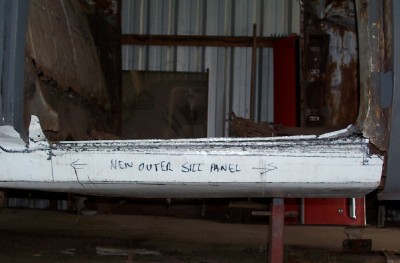

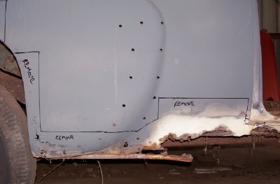

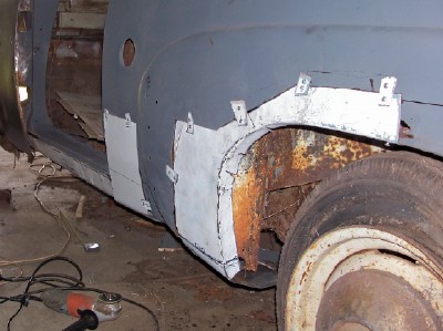

The next trip out was rust repair making time,and we just had an old washing machine blow up. Kept the stainless bowl for a friend and the metal cabinet of the machine to use as repair metal, being zinc annealed.What better for replacement of the rusted out sill panel.The white parts you see were hand formed using only hammers, cold chisel ,blocks of wood and some the home made front tube bar that was on the ute.

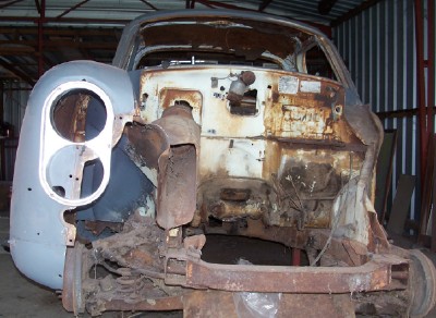

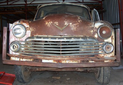

pic of how the twin headlight surround from s series valiant looks, quick mock up shot.
Yes it is in rough form, but once welded in i will be able to smooth things out and make pretty.so a long slow process has begun,i reckon 90% of the lower half of the car needs to be remade and replaced.but the fun and enjoyment of being a metal fabrictor and the result in the end is what its about for me.

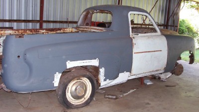

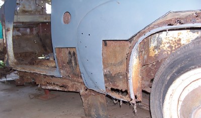

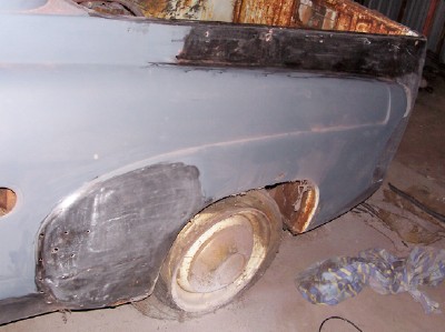

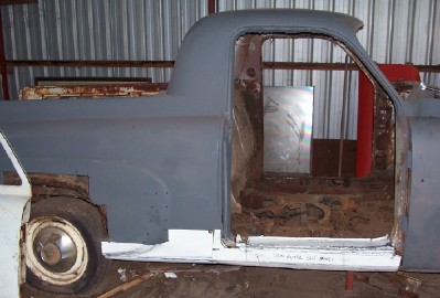

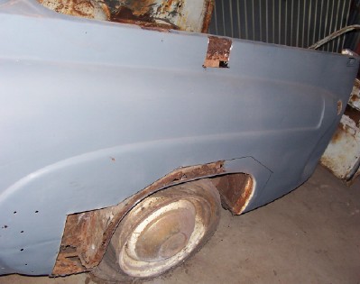

HI 2 all
Just a quick update with a few pics of recent work, right side replacement metal made and temporarily fitted tot the body awaiting the hire of a mig welder and more of my time to work on the ute.Yes the quarter panel lower sill does meed morework to make it meet the very lower sill panel line(will do more forming of shape whilst welding)
Left side the worst of the rust so far removed and awaiting again my time to make replacement meatal panels
(sill panel,etc),some rust removed from across the top of the ute bed also.

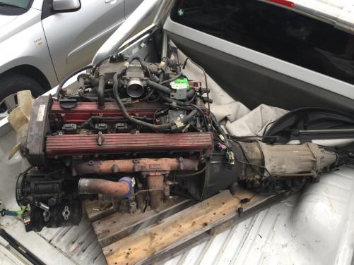

i'm thinken 1uz-fe

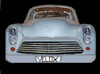

HI 2 all,
Just had a little play on paint program on computer,doing some design ideas for the custom
front for the vauxhall velox ute.
the original grille set up 1957
the s series valiant twin lights mounted up n down
with original grille in a new opening
as per the last pic but with a fc-e holden grill
the ultimate would be a 53-4 desoto tooth grille butthey are rare too come across and expensive.

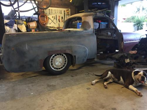

HI 2 all,
Ok so i have been a bit quiet lately with the working on cars, have done some more metal replacement panel making for the left side of the ute around a month ago.

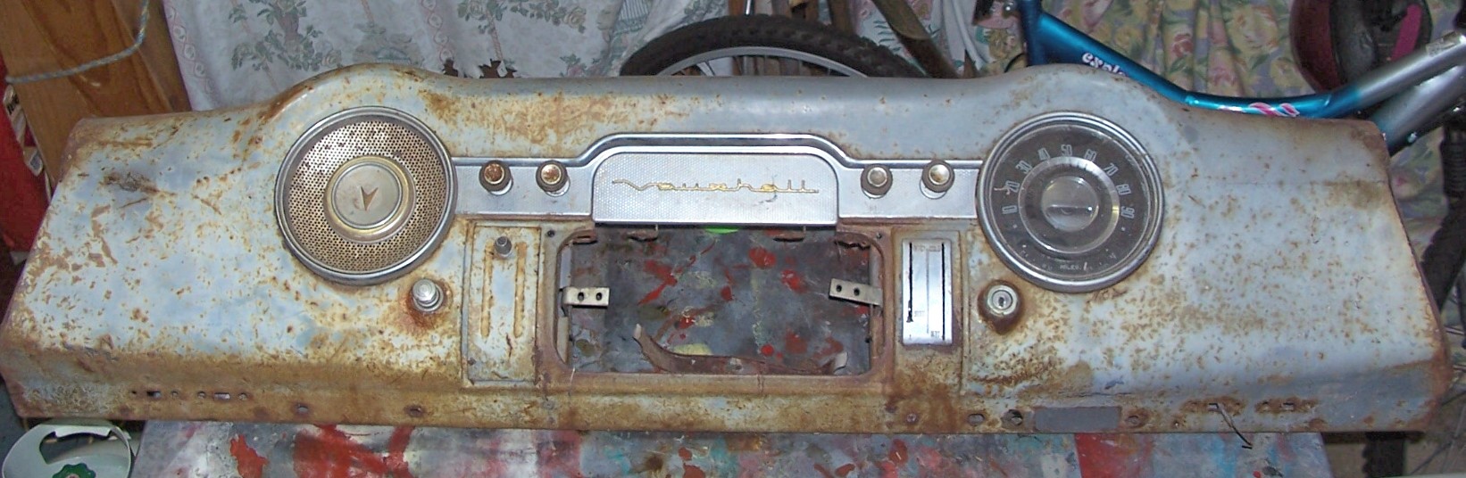

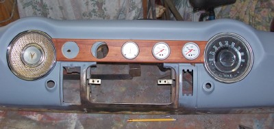

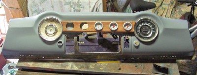

Last week end i headed out there and brought the dash back to work on at home (getting bored) and yes lack of money does that to most people,the dash has been stripped back to bare metal and primed so far.have a small bit of rust to fix but later,as you can see by the first pic the dash has a nice looking dress plate between the speedo and the dress trim on the passenger side.
The large rectangle hole is the original glove box spot (glove box lid rusted out as it was on the ute cabin floor for many years) with ash tray on the left and heater controls on the right of it, these are going to be deleted as are the ciggie lighter and the igniton barrel.
Ok for the interesting bit,as this is a now 51 year old car it didnt come with much in the way of gauges for information of whats happening while the car is in motion.
So its up date time,I'm using 2 inch speco white faced sport series gauges in the tacho,fuel,oil pressure,water temp and amps and will use the sport series 85mm km/h speedo also with white face.as of so far i have 3 of the 2 inch gauges out of the 5 i plan to use so far cost of $75.00 the fuel guage and sender unit cost is $80.00 and the tacho cost is $90.00 and the speedo...well i will find out later could be scary the cost.
I have decided that for a bit of class i will use timber for a facia to set the small gauges into between the original speedo and dress trim (see pics).
The rest of the dash will be painted in burgundy/maroon colour as per the cars main outer colour.
AHhhh thats better not bored now.
