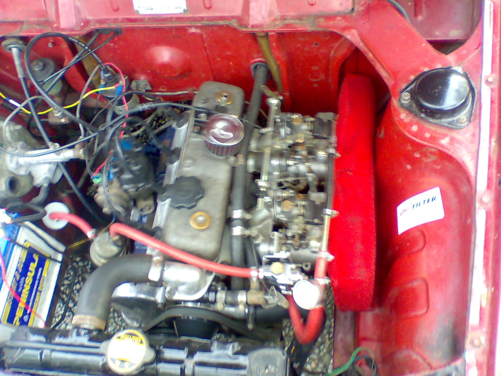

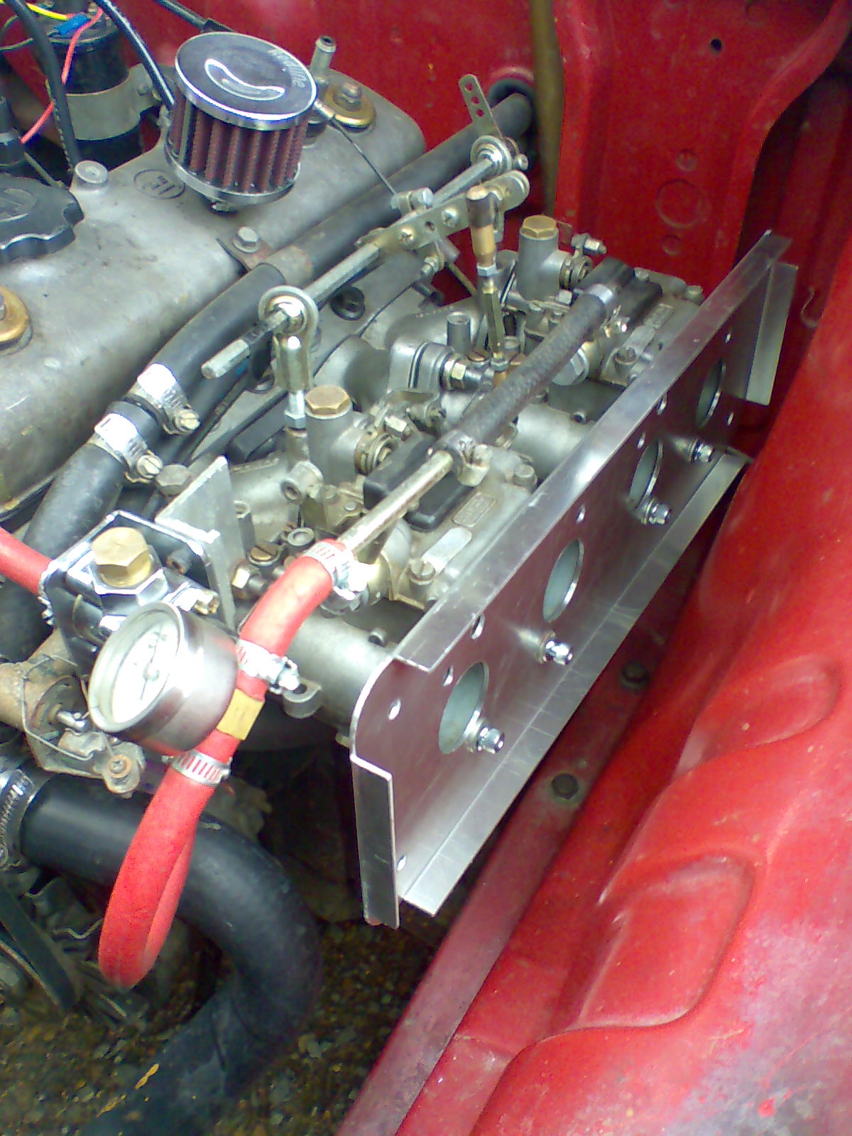

philbey Posted May 18, 2009 Author Report Posted May 18, 2009 Ok, got the Uniflow air filter into the car. I got a custom 36mm tall item, they can do any height you want. I drilled the baseplate and fitted it up. I was considering offsetting it upward but I don't think it would have made that much difference. The actual body of the filter doesn't touch the strut tower but the foam is squished against it in one spot. No noticeable performance issues. Its got a main element and then there's a "sock" that pulls over the whole assembly, really easy to remove and clean. Quite impressed with it overall, and it's about the only thing that will fit in a KE1x with non uprighted motor! Any bigger and it's a no go. Car is at the Dyno now, they've given me some figures but I'll wait til they finish before I quote anything! Quote
