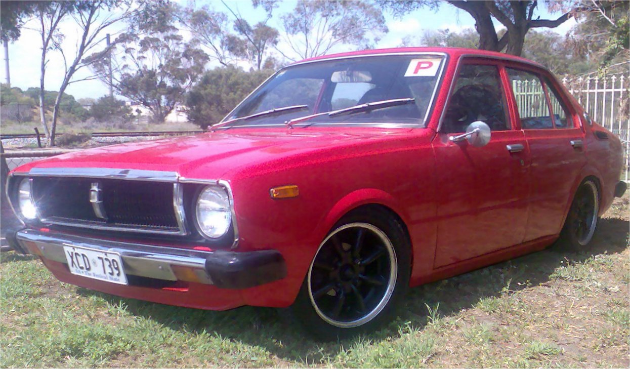

hey i just got my rims put on my rolla there 15s by like 7s or something but the front end is sitting way too high now, just wondering what other 55s are using?

cutting springs bad! lowered springs are quite cheap...you might also find that 15x7 on a KE30-55, once lowered, will hit on the spring seat...not totally sure but it might be an issue...
depends how you like your ride quality, and to be honest our cars are not fully sik drifters, get some spacers so they fill the guards more
if you want to do it right, get tyres with the same rolling diameter as stock or close, get lowered springs for the front $140 and get the rears reset by a springworks $180. there are tyre calculators online that will allow you to enter tyre specs to get a circumference, ie rolling diameter - kumho.com.au has one.
