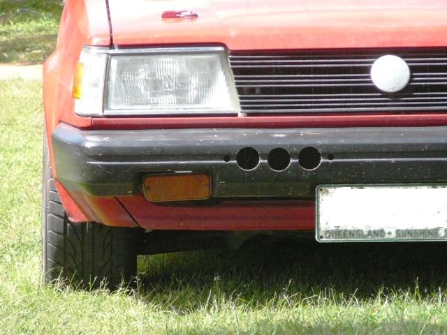

Another thing you can do to clear the caster you run for drifting with big wheels and standard gaurds is to simply fold a crease along from where the little metal arm holds the bottom of the gaurd, to the line in the body down the bottom there. You just kind of tip the corner out, no need to cut anything, you only really need about 15-20mm to be really safe from catching it and if you do it to both sides it looks factory. I did it on the red car and the lip fitted snug over it, so you couldn't really see it, but there was clearance there. here is a picture of it without the lip. I like it because you see less wheel sticking out as well which helps make it look a little sleepier.
Do you reckon that type of bend would clear your wheels?

With the guard, I originally bent it out similar to what you did. Wasn't enough to clear the wheels unfortunately. :( Wheels rubbed higher up along the guard as well. I made the guard just clear the wheels while stationary, took it for a drive and it pulled the guard in all different directions.
