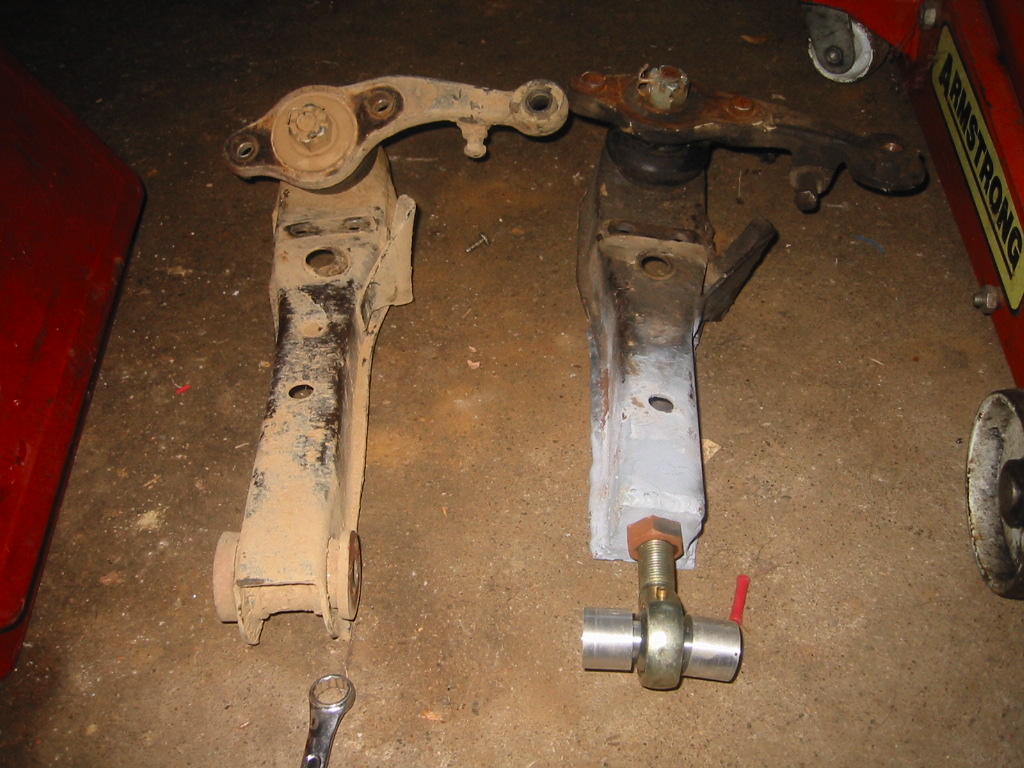

Have now got hold of a pair of Lower control arms (thanks Simon!)which we are in the process of rose jointing to help out the front end some more. My 4.77 diff gears arrived the other day from NZ (thanks Tony!) and will go into the car next week.

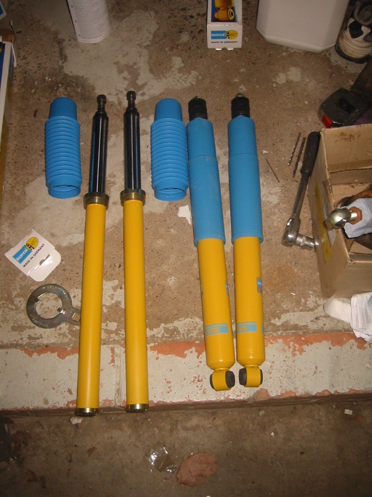

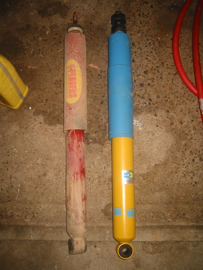

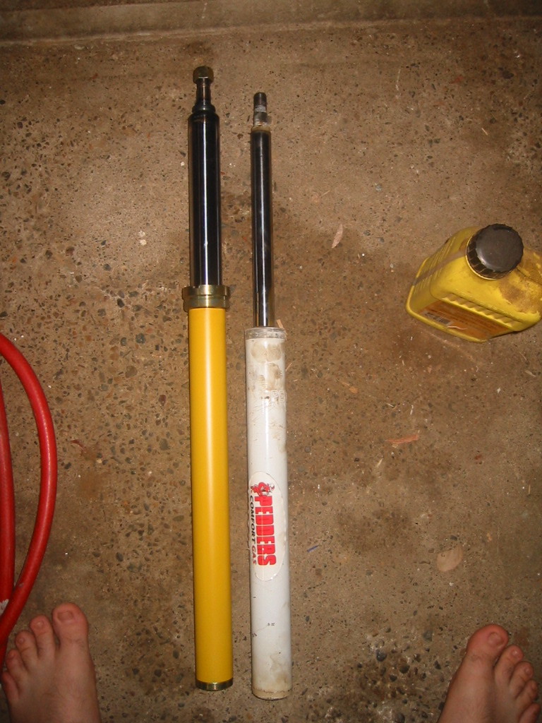

As anyone who has talked to me since I got this beasty will know the handling both sucks and blows on this car. I've found out why. Pulled the front struts out and found the most basic Pedders shock that Centrelink can buy residing inside them. That now explains a lot. All that I can now say is " g0t Bilsteins?"
Yep, I spent some cash and have a pretty set of 32mm shaft upside-down shocks for the front, and a set of Commodore wagon shocks for the back. Together with my adjustable lower control arms, things should be a lot better.
New vs Old front shock. (Nice feet Idiot)
Rears. I think the old one may already have been a Commodore item.

Also finished (finally) my adjustable lower arms. (Disclaimer: yes, I know they're not legal.)
