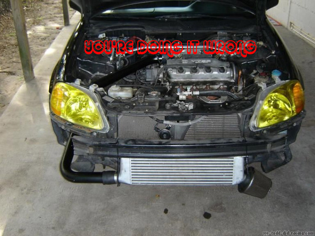

it seems VTEC can give you forced induction without a turbo!
WOW!!! gotta love the honda tech... I've heard that long inlet runners help with lower torque, but this is getting rediculous!!!
I wonder if the ol pod filter to intercooler is actuallymaking an effect... I guess it would still drop inlet temperature, though i think the struggle to pull air through that long-ass piece of pipe would make it a moot point...

Spose if you REALLY want to do it, be my guest, but it is seriously a waste of time
If this is done better, its a good idea.
This is just ricey though.
Actually, i could see a top mount with a cold air inlet working quite well... now THAT's an idea!!! i'll have to do it now... lol!
Bahaha!! What an idiot. the air inside the intercooler is the same temp as the air outside the cooler. Intercoolers work because after boosting the air the is hotter and the temperature differential is lost to ambient. :yes:
SHHHH!!! don't tell the hondaphiles...
that tube is actually the breather/induction setup to more efficently burn the extra fuel vapur from the carcoal canister back into the intake duct to reduce emissions :yes:

That would be the only way a cooler would work on an NA car, but still be somewhat useless.
as beerhead stated, the cooler can only lower the air temp to atmo temp, which is the same as whats being sucked in. The dry ice could lower your inlet temps to below atmo temp.

Sorry lads - breaking the firs law of thermodynamics there, but hey, if you get it to work, let me know I'd like to turn your idea into millions of dollars hahahaha
Yep. Useless. But sure, you'll get 1/4 more horsepower. Cool.
