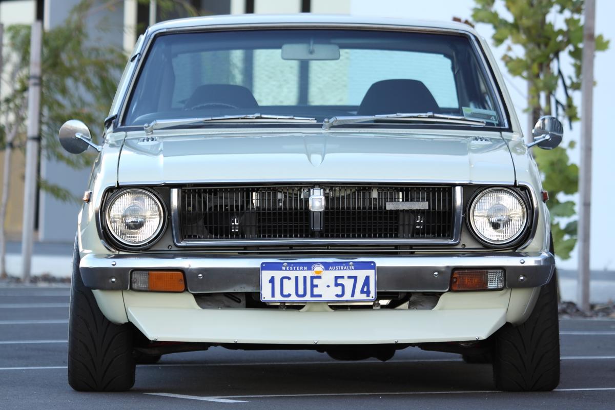

October 31, 201313 yr comment_670620 Hey mate was wondering wear I could get one of those lips from? Looks good. Thanks Report
October 31, 201313 yr Author comment_670654 Hey mate was wondering wear I could get one of those lips from? Looks good. Thanks The lip was from Thailand I will dig up the guys details and pass them on, the lip was a perfect fit made to suit the earlier ke35 apron, It won't fit the later ones with a little bottom lip. soo shiny :o looks awesome!! Thanks, they never stay that shiny though!! Report
October 31, 201313 yr comment_670656 Would the lip fit a 79 ke55 you think? Or anyway to make it fit? Report
November 1, 201313 yr Author comment_670729 Would the lip fit a 79 ke55 you think? Or anyway to make it fit? No, 79 ke 55 usually has the later apron, if your going to cut it up you may as well get a universal one. Report
