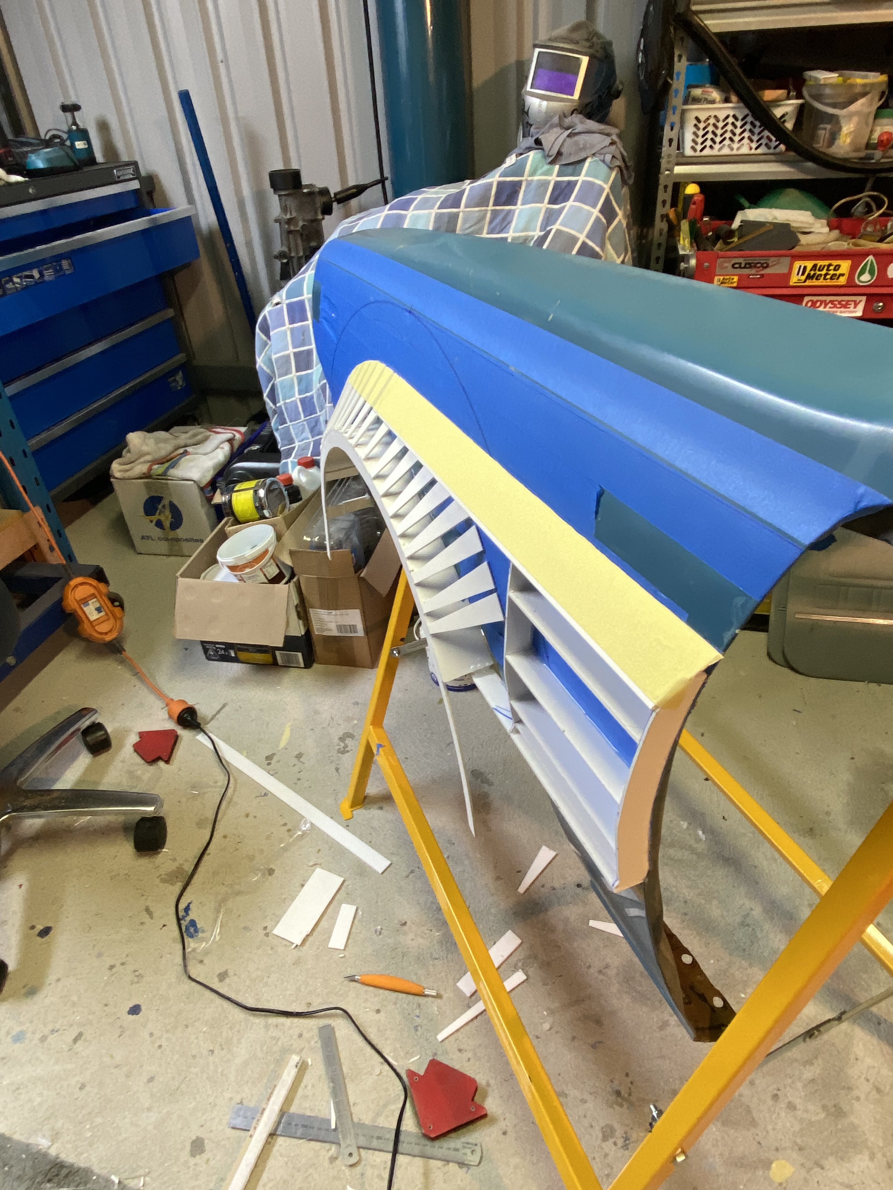

Until I start accumulating all the consumables for infusion I thought I would make a start on the wide body. Narrowed it to two styles, bolt on flares, kind of like what I am already running but boxier/wider. And full wide body arches trying to follow the cars body lines as much as possible.
I thought I would start with the front and try the full wide body option first.
Doing this on the spare guards I have as this gives me the option to return the car back to normal at anytime and let me enter a couple of events coming up. Gonna have to take my time unfortunately with this stage as I’ve got a home/shed renovation happening soon.
Couple of pics to help my ideas make sense to everyone, similar to the way I did the boot spoiler, get the general shape sorted, fill the voids with the foam blocks and then start shaping.
A little progress, have ended up with a combo of wide body and flare type.
I have progressed a little further than this but haven’t taken any more photos yet and every thing is in storage as I empty the shed for the new one.
