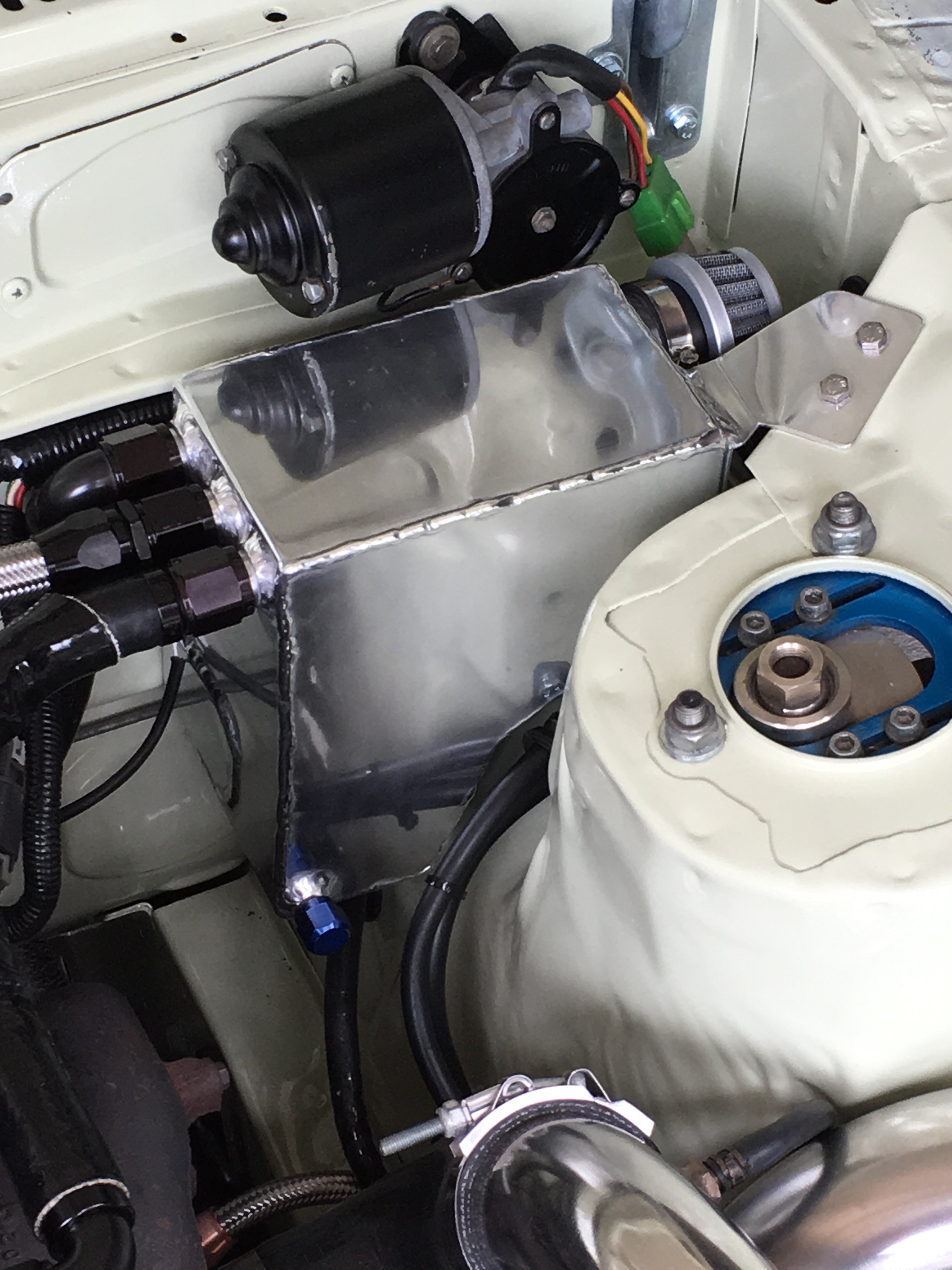

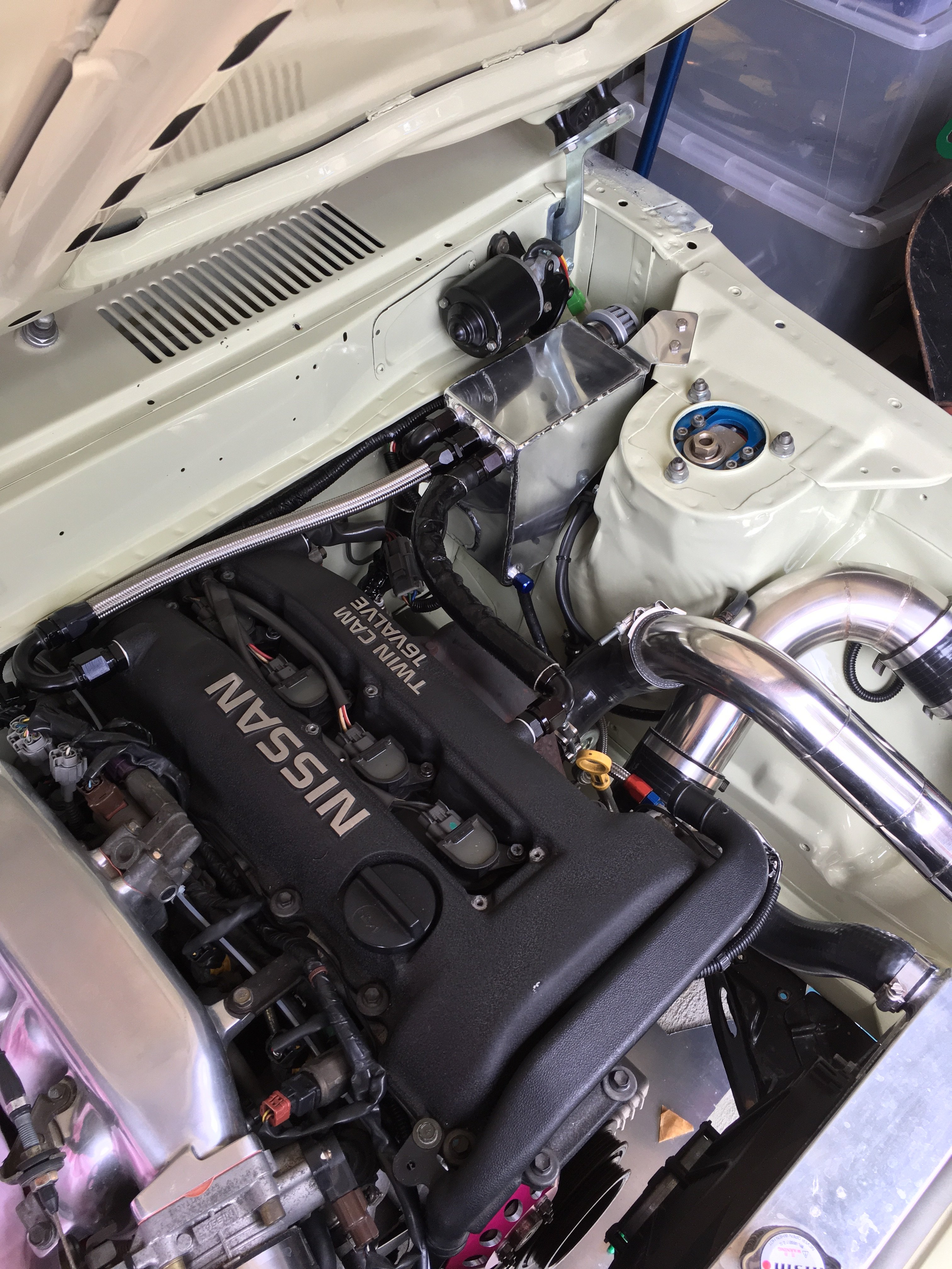

Thanks Dave, yeah it's great having the Tig, I have knocked up a few bits and pieces with it now it's been so useful particularly for the aluminium fabrication side of things. Definitely worth grabbing an ac/dc model for the versatility of material capabilities.
I made a new catch can with it last week, it's not perfect but for a first attempt it turned out OK.

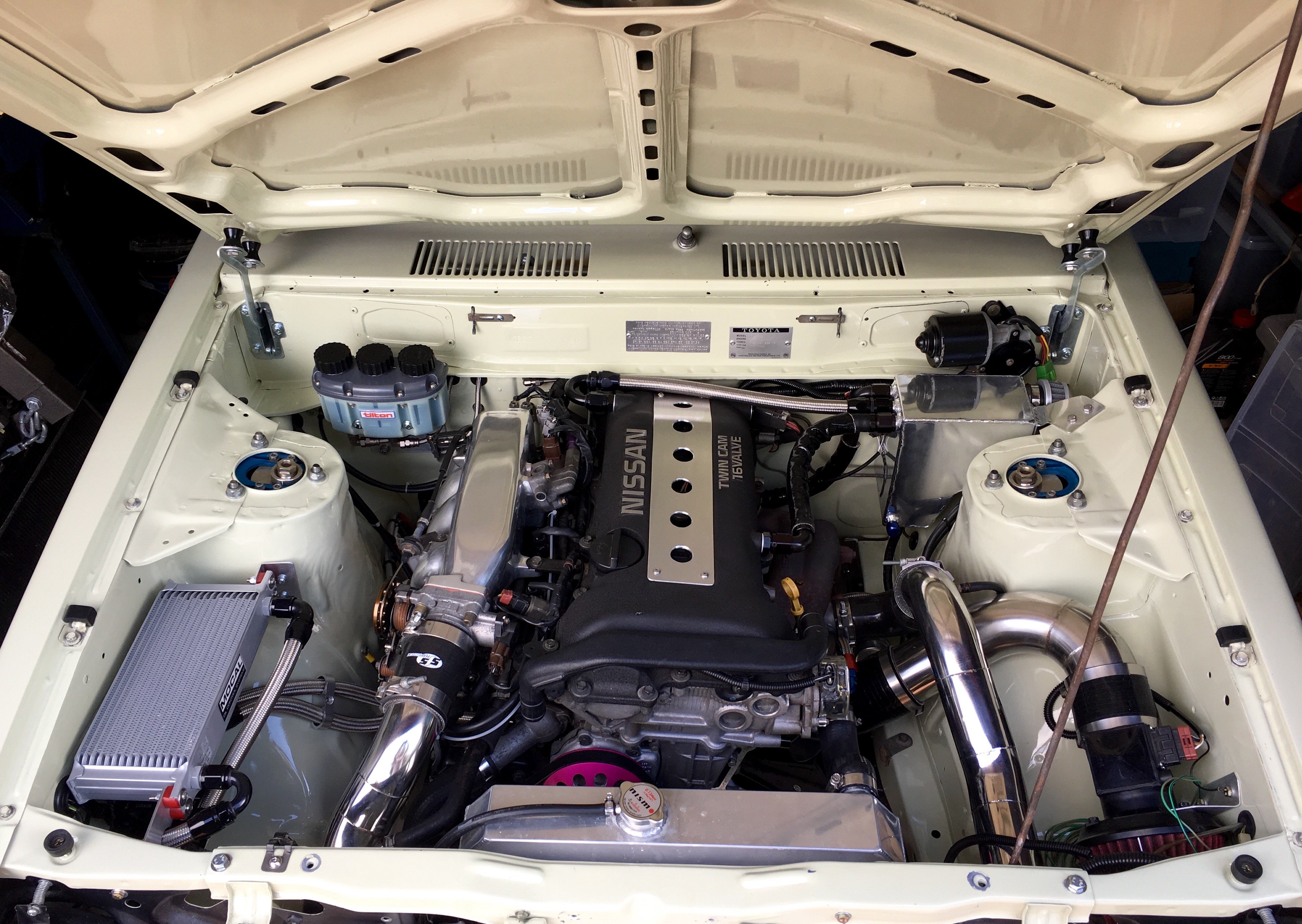

    Pretty much finished. Turned out ok, I think? Doesn't give too much away when the plates are on. Only need to do the short hose from the block to the thermostat. Thermostat fully opens at 86 degre

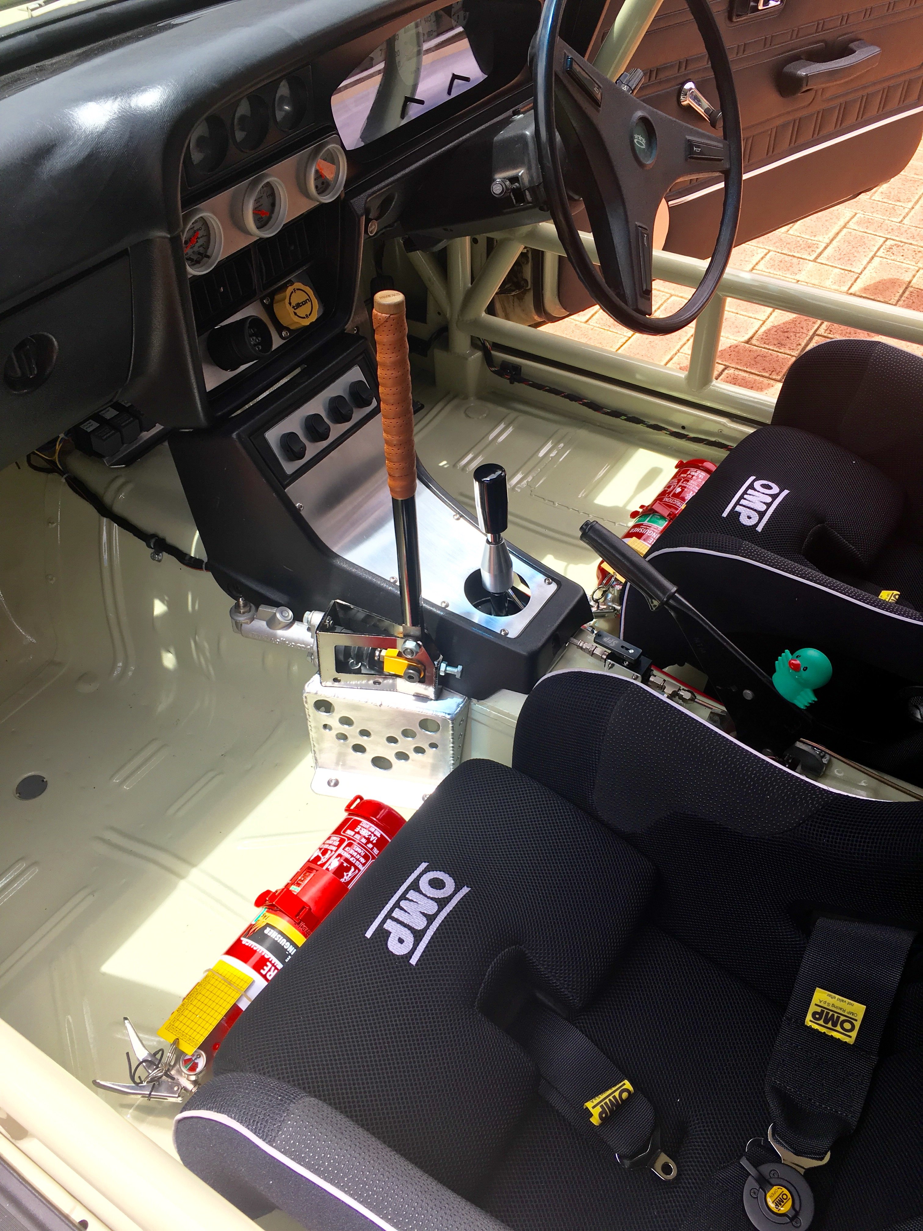

    Have made a start on the inside of the car, ripped out the old sound deadening off the inside of the firewall and stuck on some dynamat. I want the cabin to be nice and quiet. This stuff is great, e

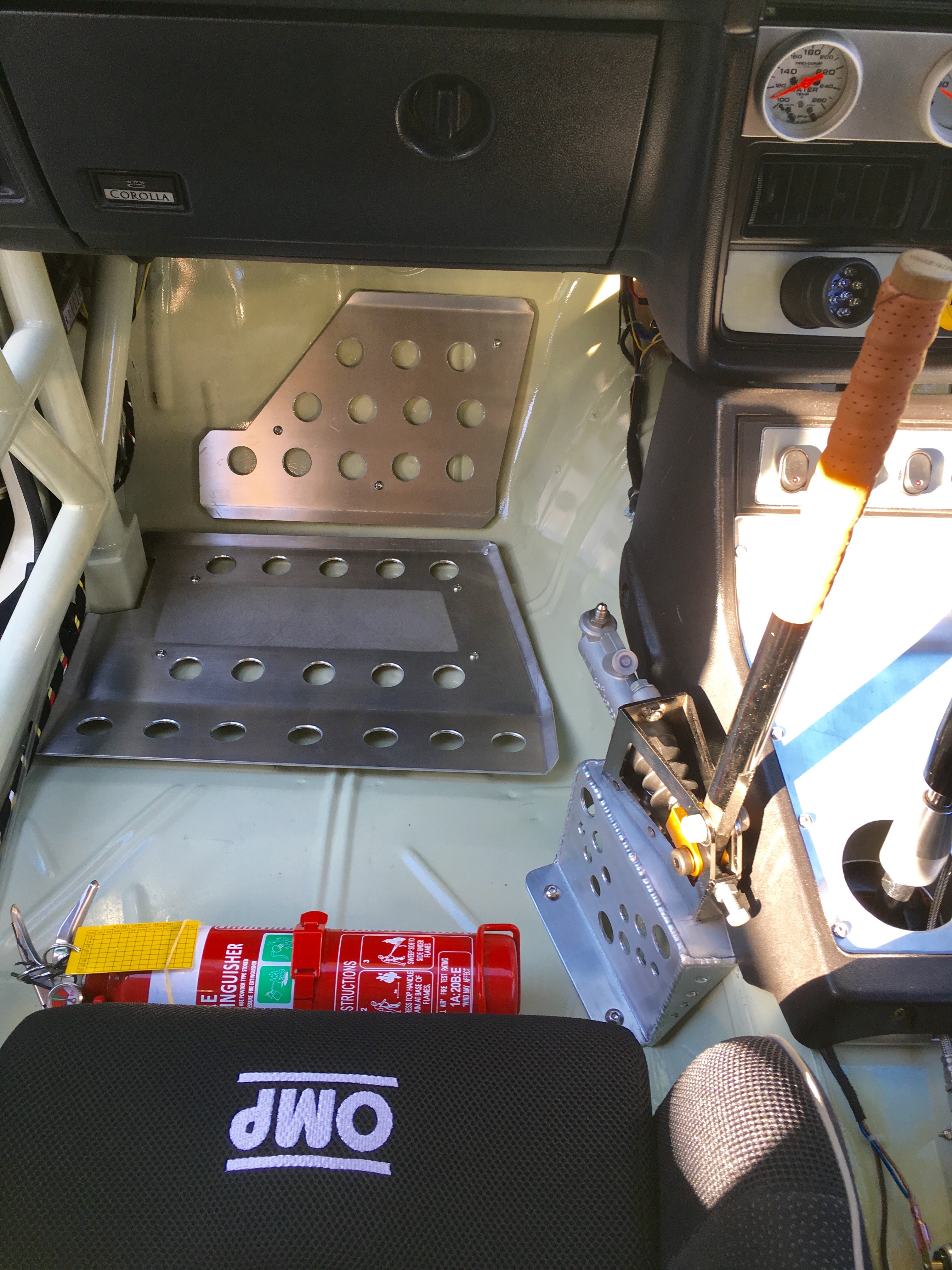

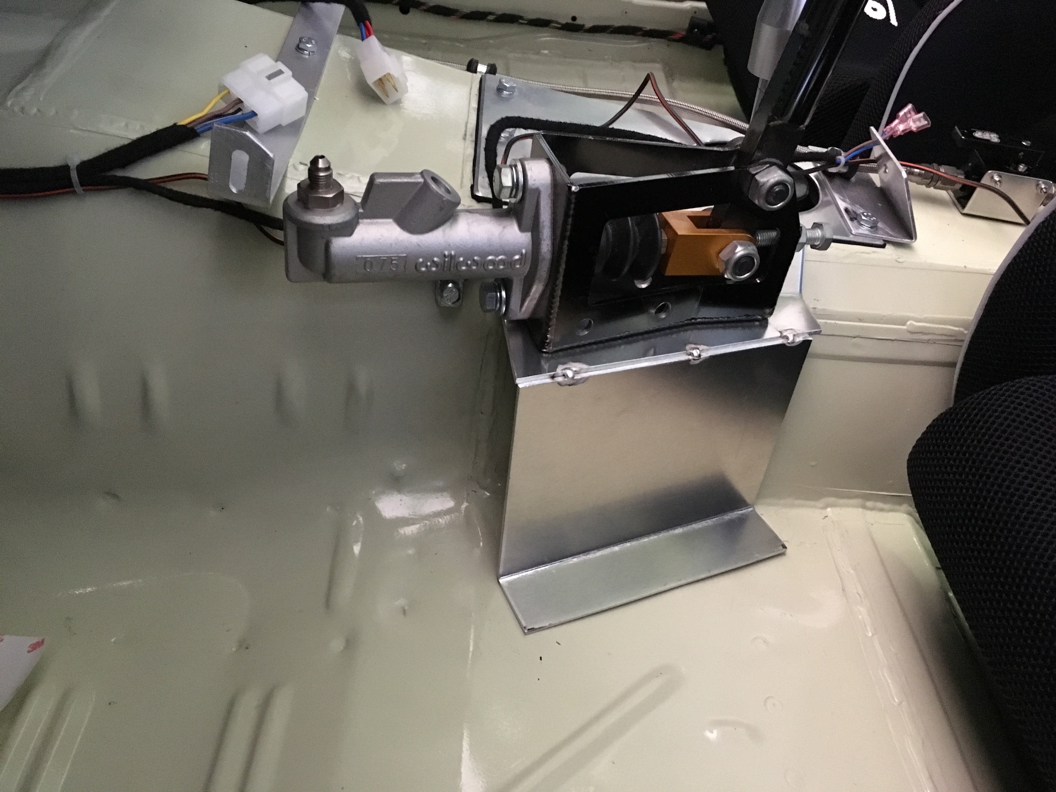

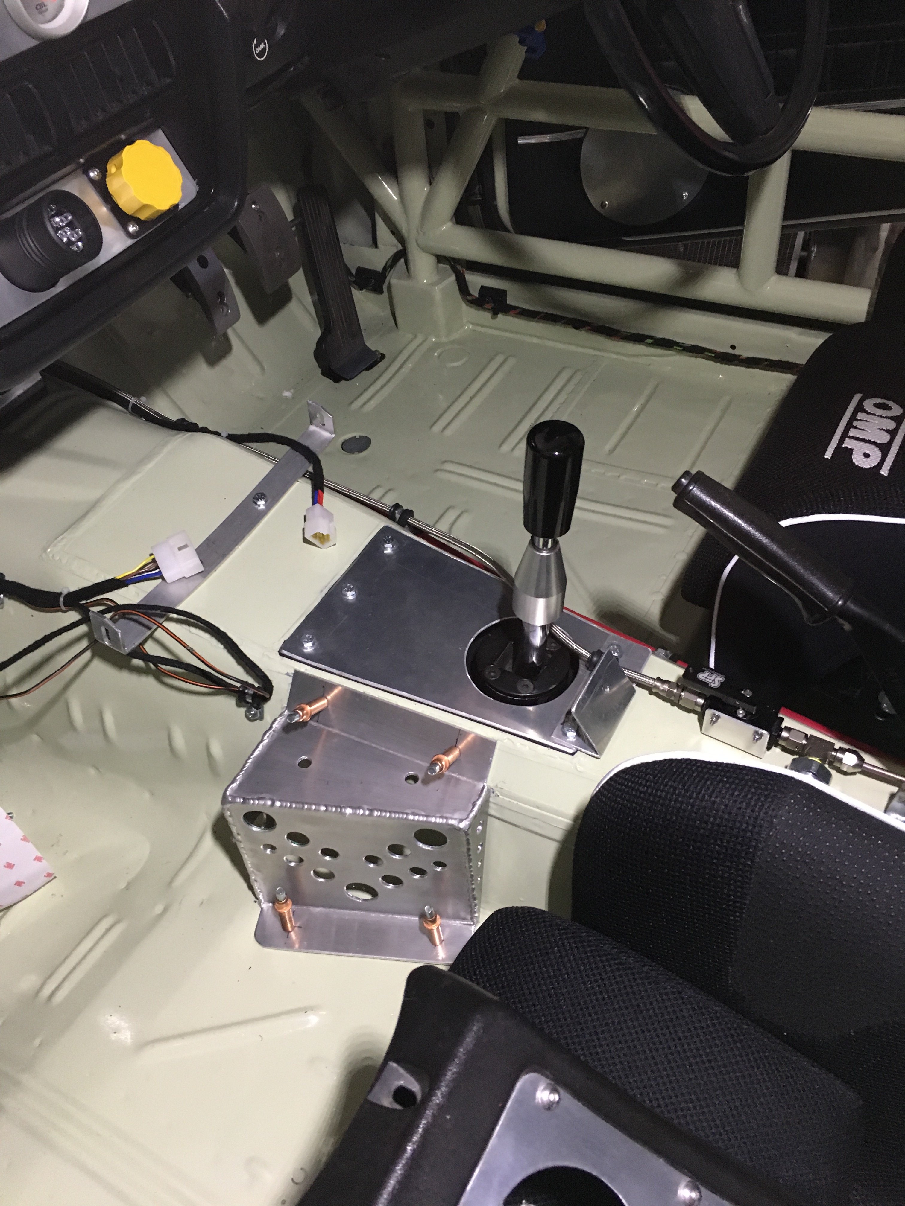

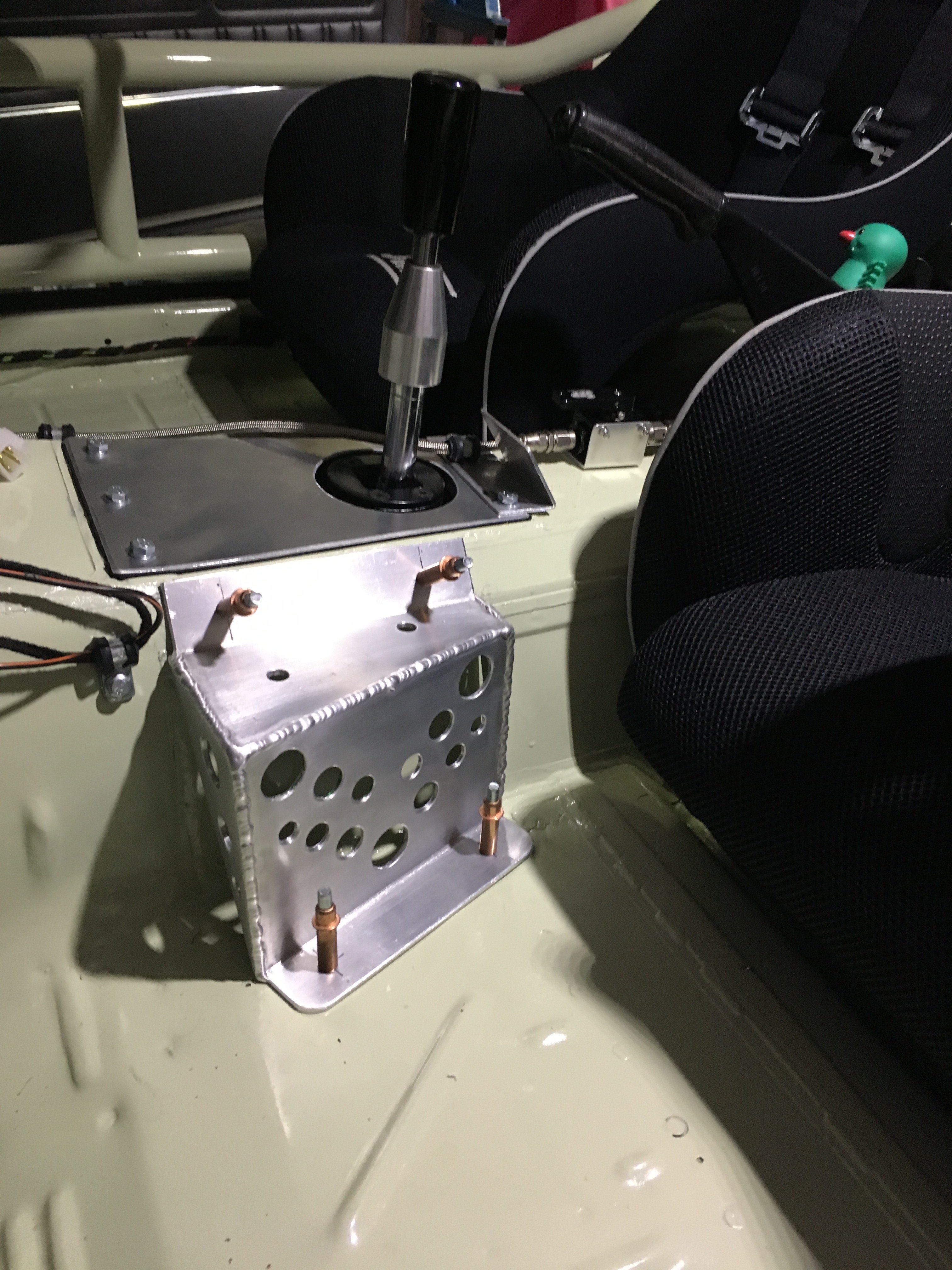

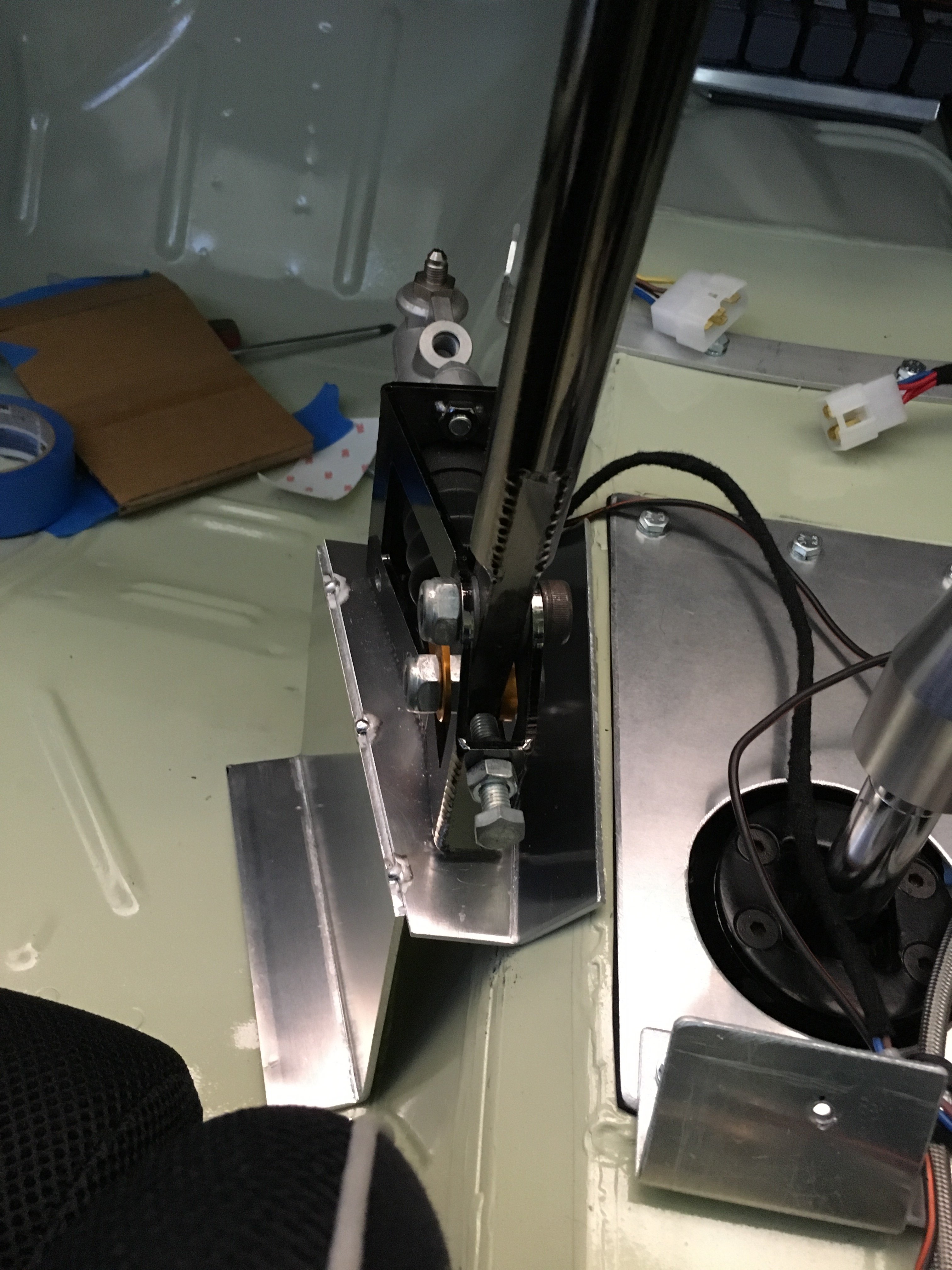

Re positioned the hydraulic handbrake to the side of the tunnel, it's a more rigid area to mount it to. Having it bolted to two surfaces rather than one like before has made it a lot stiffer than before.
Loving owning a tig welder, I made up mount with some 3mm aluminium plate and drilled a few holes to access the mounting bolts and lighten it a bit, just need to plumb it up and remount remote reservoir.
image.thumb.jpeg.9b4be3193c8351a33392f4d05374f343.jpegimage.thumb.jpeg.08991c75f51f56fadf253da1ff16849a.jpegimage.thumb.jpeg.8af45331008a7fcce645f809e6697840.jpegimage.thumb.jpeg.cd748cfa275a938fd87a56ed8cf759a0.jpeg

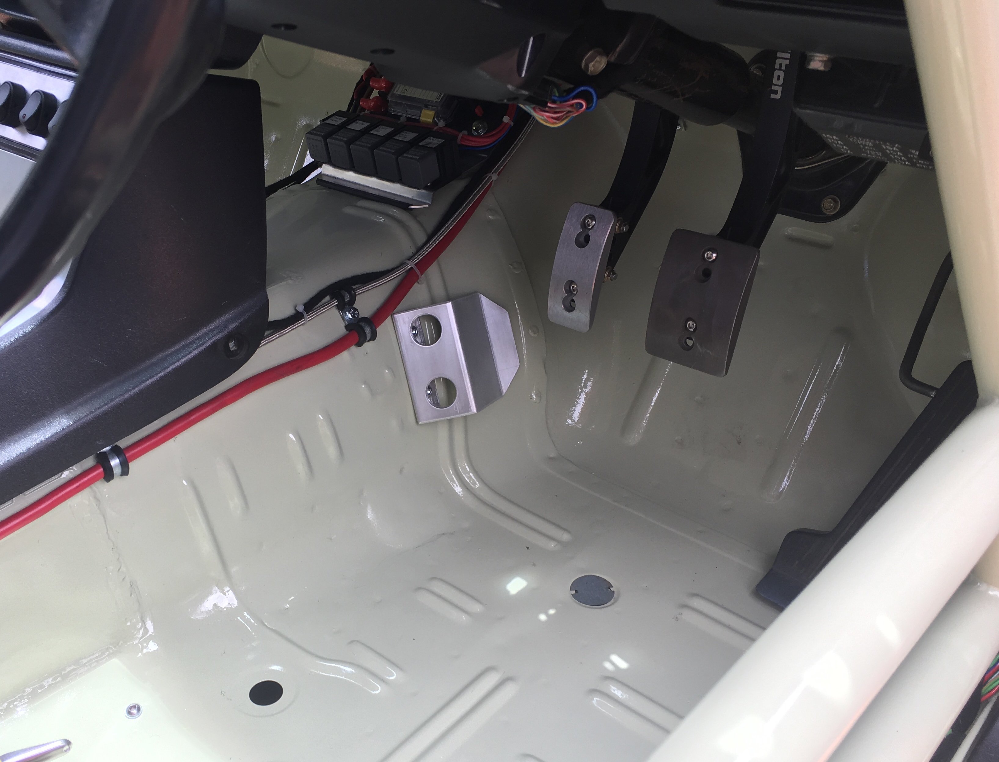

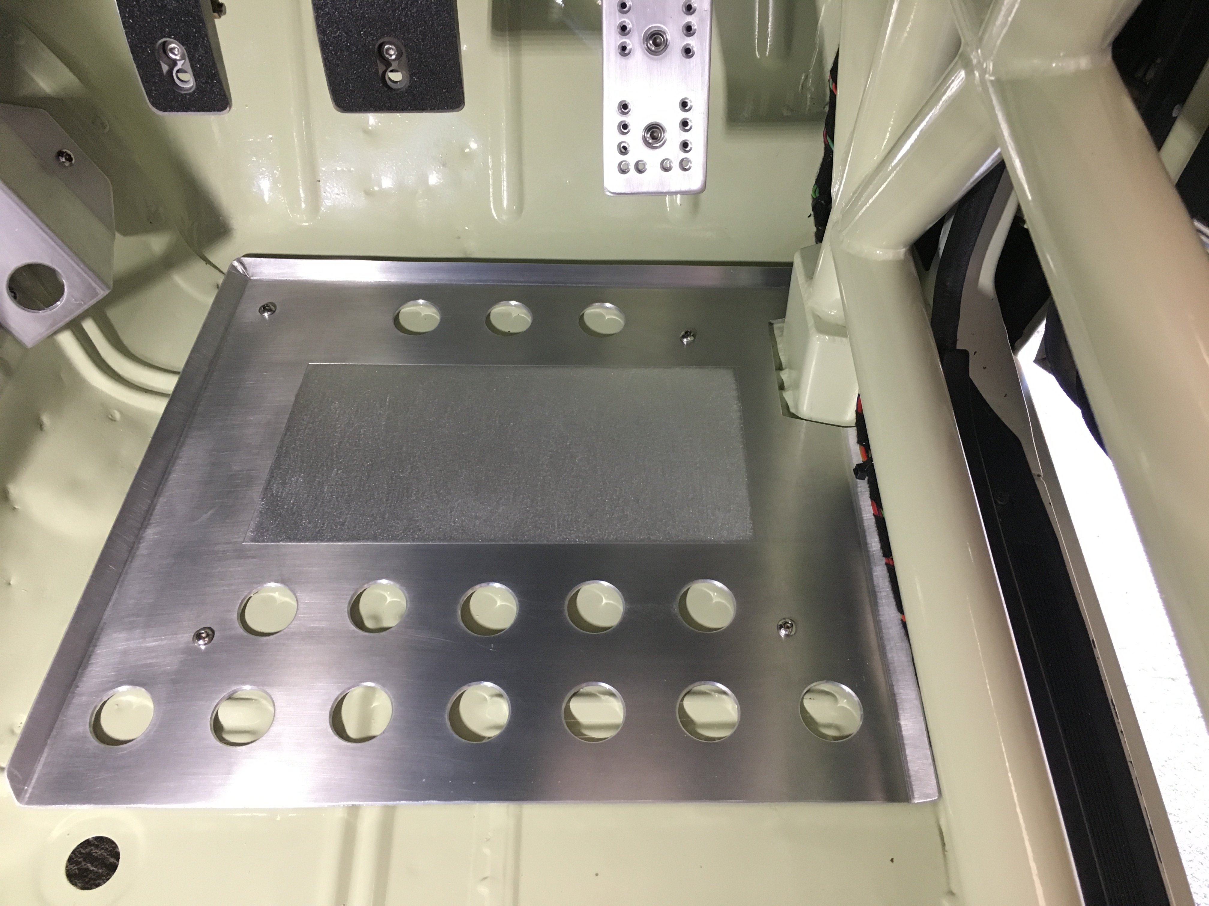

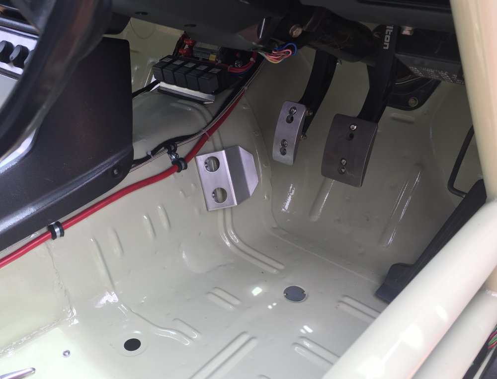

Just the small stuff left now, foot rest for clutch pedal made up and fire extinguishers mounted. Need to make up the heel plates next and mod the accelerator pedal so it's closer to the brake pedal.

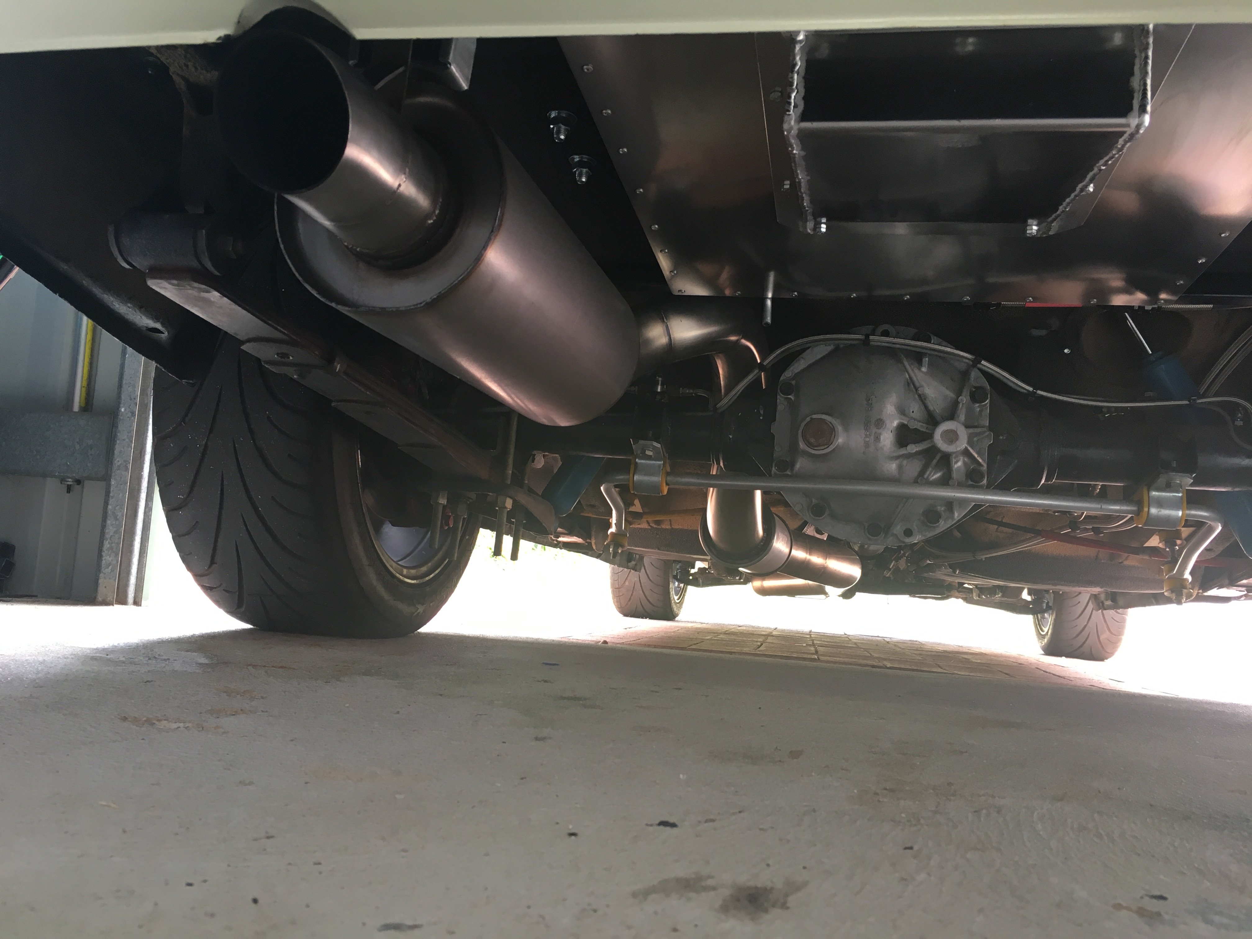

Finally got around to re doing the exhaust, it had to remade due to the floor of the car now being lower and flatter, the resonator used to fit into a slight rise in the floor but that section was cut out. This system should flow better though it's a more direct path to the muffler which I swapped out to stainless on as well.
Couple more things to hook up in the engine bay, prime the oil system and it's ready to restart after a long hiatus.

Remade the accelerator pedal and repositioned closer to the brake pedal, also drivers side heel plate done.
Passenger side done, I have raised this side above the floor by about an inch to try and avoid the heat from the exhaust, it runs directly under the passenger footwell. Can't have the passenger burning their feet!!

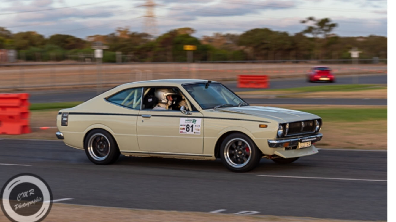

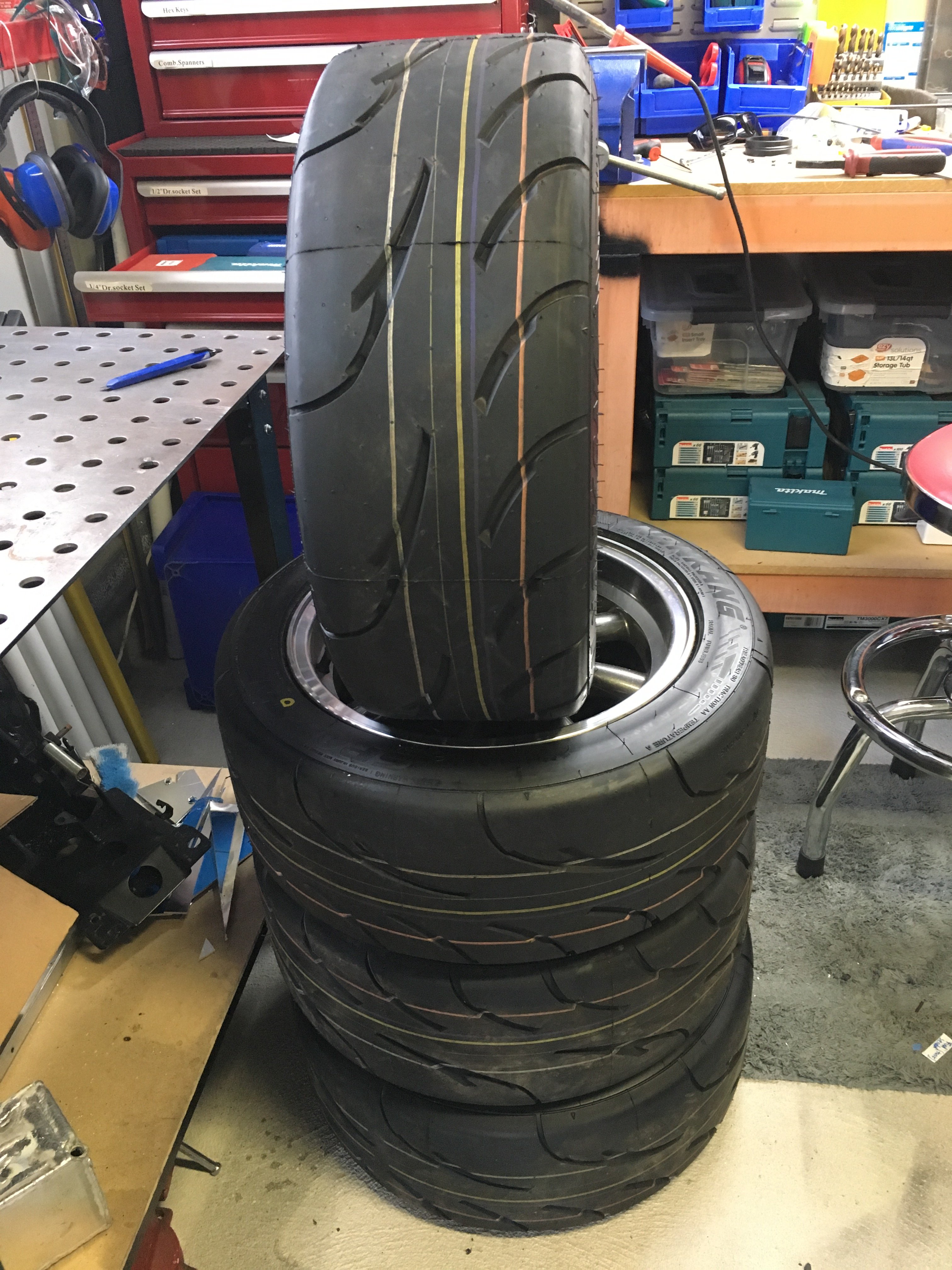

New tyres on and rolling smoothly now, oppted for a set of AR1's, great reviews on these and priced really well. Definitely more of a slick than the RSR, heaps softer with a tread wear rating of 80 compared to 140 of the  Federals.
My first event since the rebuild and couldn't be happier, still a lot of things to work on particularly the balance of the car, it's like starting all over again with handling setup, but it ran well with no issues. It feels significantly more rigid with the cage now and definitely getting a heap more feedback on the cars behaviour. First thing to look at is the brake pad choice and brake balance, currently running some QFM AR1M  but just not getting the bite they were when I was running the boosted setup. Considering a couple options one being Forza FR 6 carbon fibre based pads, after chatting to the guys at GSL Rallsport they said these are more suited to a non vacuum assisted setup. Once that's sorted I will sus out the front to rear brake balance and then move onto the springs and sway bars. Next round on the 7th, in the mean time a couple pics pinched from the web.

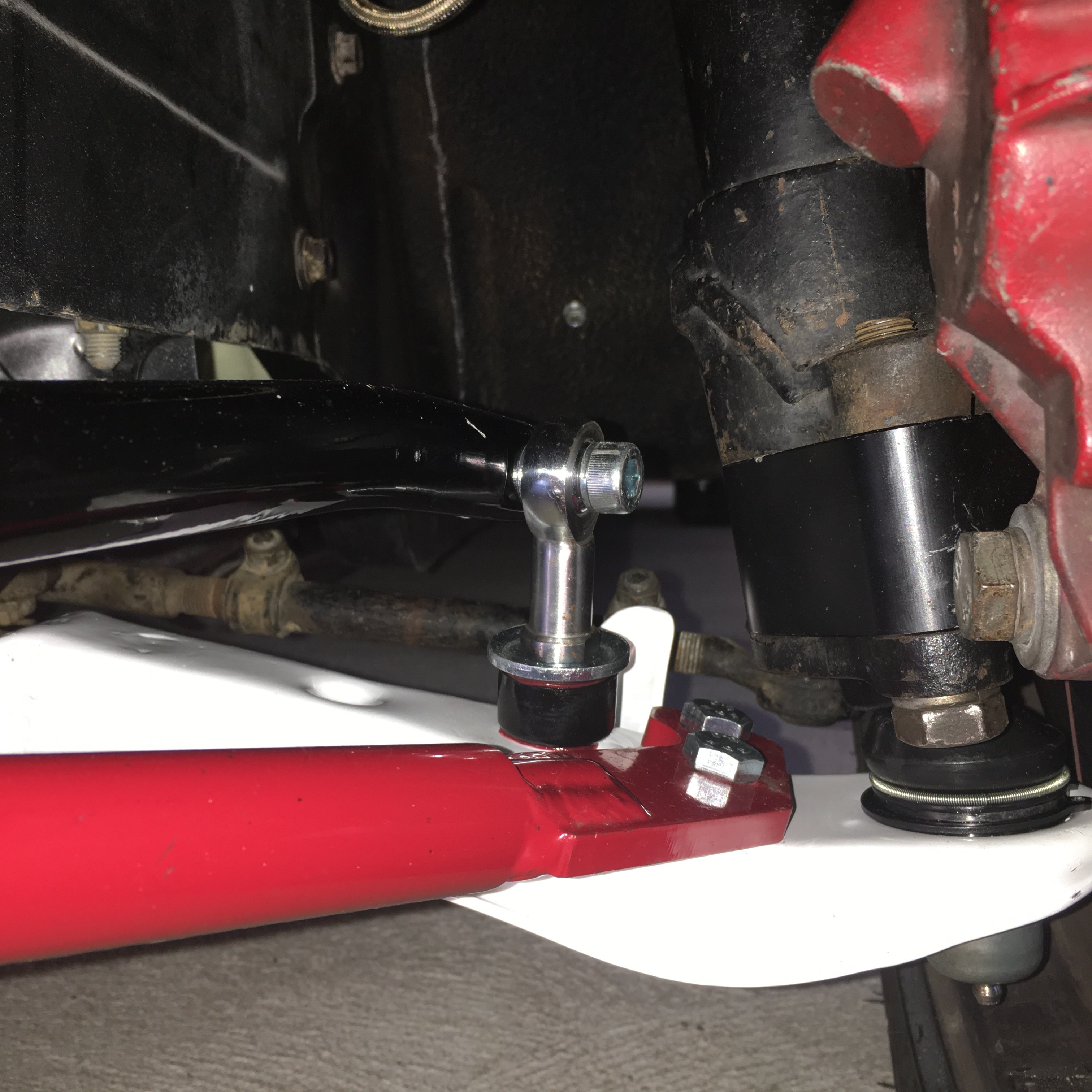

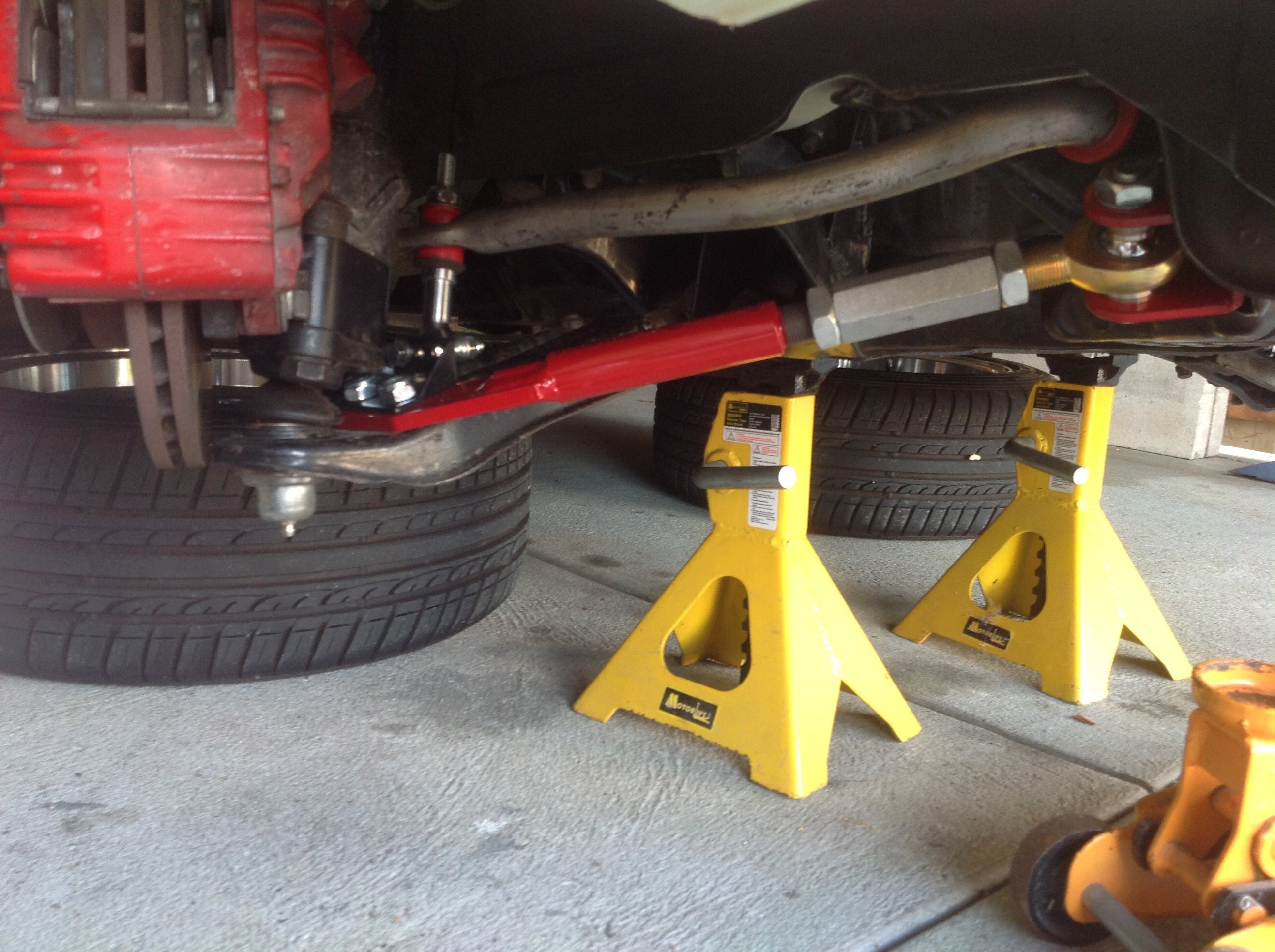

In getting things ready for the next round I thought I would fix somethings that I was never really happy with for a while. The extra positive castor and negative camber I am running causes my lower control arms to sit at a pretty high angle compared to standard. The sway bar link pins were at a bad tilt and I wasn't getting full benifit from the swaybar also the castor rod was starting to bind even though it has a rose joint connection. I did have go at a fix for the sway bar link a while back but it wasn't the best solution.
So I have changed the orientation of sway bar hole to the vertical plane and welded and redrilled the castor rod mounting holes on the control arm. link is nice and straight now and the castor rod pivots freely. Ultimately I wouldn't mind making up new control arms from some chromoly tube with multiple mounting options, but this is fine for now.

It would be pretty straight forward to fabricate just need to sus out the ball joint or maybe use a spherical bearing instead. Getting the wheel alignment redone on Saturday so I will see if this has made a difference, gonna run a little bit of toe out aswell see if that improves turn in. I also grabbed some higher rate springs of a mate to swap out and experiment after a couple of runs.
