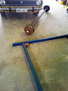

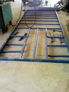

I have about a week off over Christmas I am hoping to complete a Car trailer project I thought it may be of interest as a project to a few of you.
I started today cutting and tacking together the main frame.

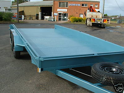

I have been going to do this project for 10 years and never got around to it. I have taken photos of trailers I have liked, i will use the good points to hopefully make a perfect one. I have got a few quotes $8000 - $12000 I can build it well under that price and know what I have.
I like this one off ebay but with a Gvm of only 2000 kgs it is way to light for Me. I also want a rear tailgate and provision for a winch.

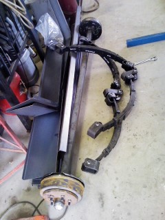

I also bought all the heavy 7 core cable today.
