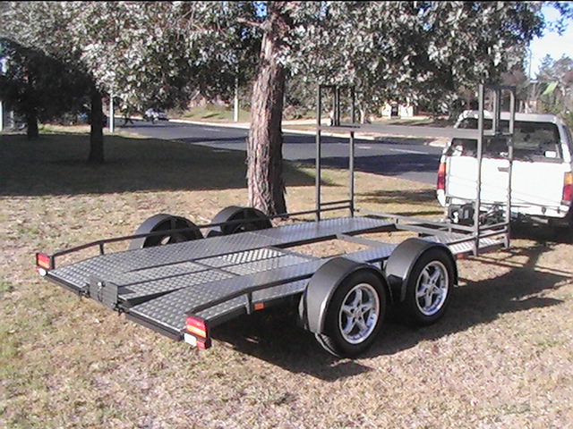

This was designed to be an integral part of the trailer so that when the ramps are fitted into there home at the rear it is a flatbed trailer. I will have a think about it as i have slid on checker-plate myself.

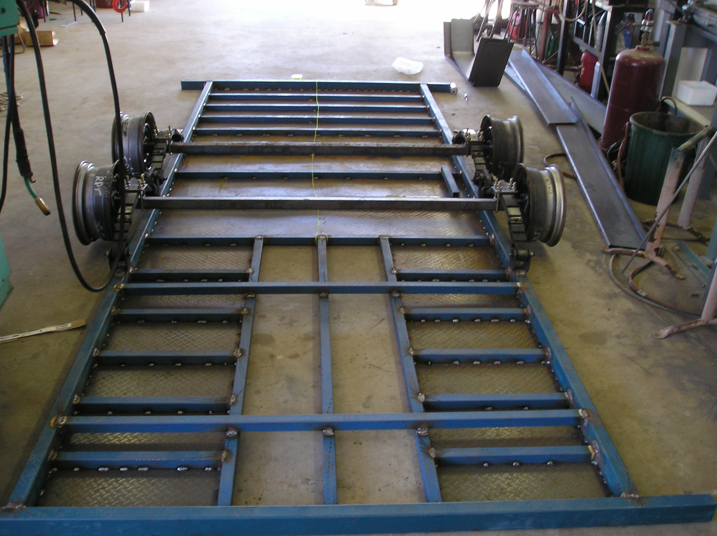

Welded in floor, fitted springs and axles, A big Thank you to Thomo for advising on spring position.
do this for a living ;)

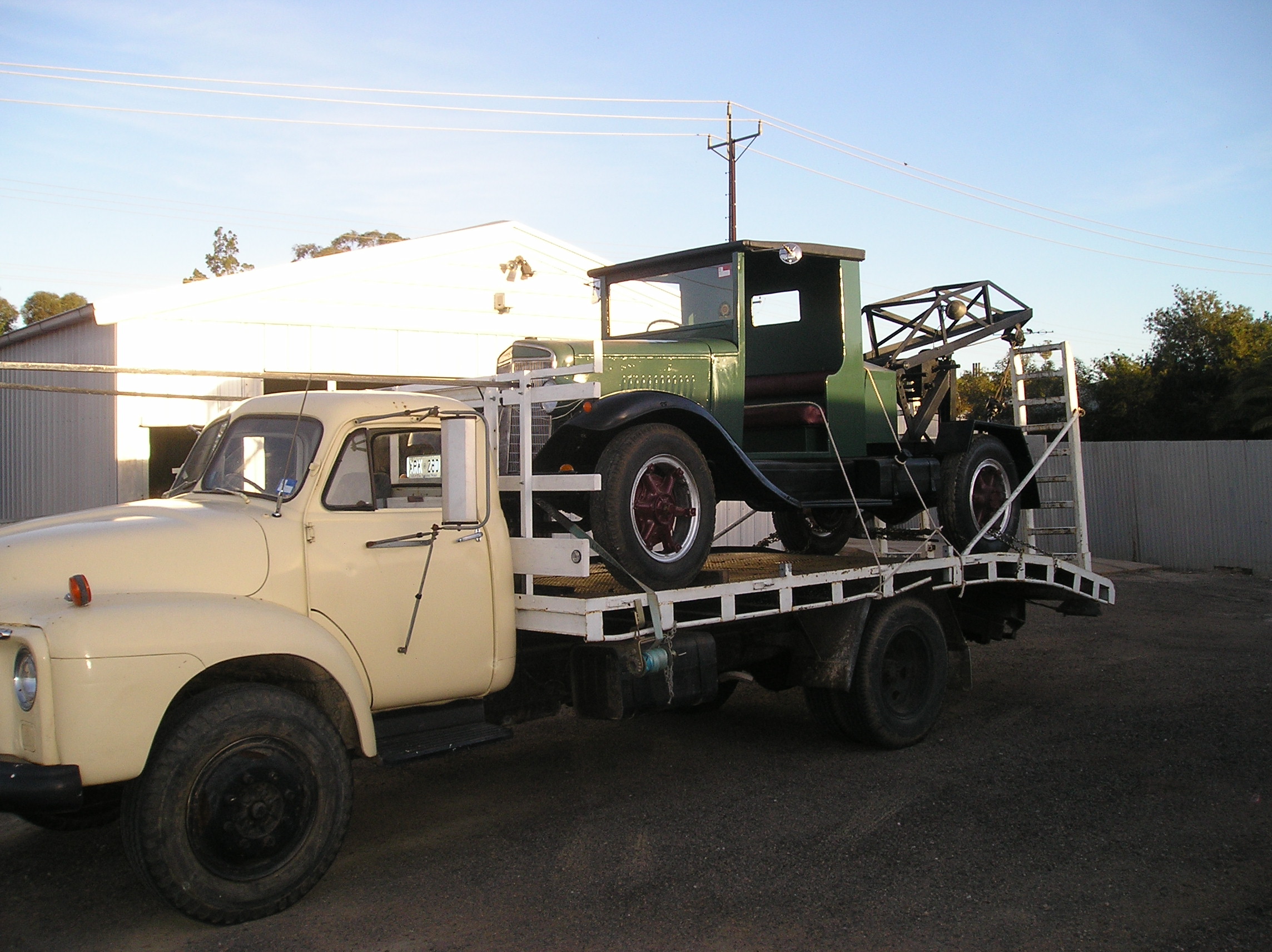

The trailer is sloped at the rear to minimise angle instead of having a large incline, You should know what my dads truck looks like, Imagine if it had a flat bed.

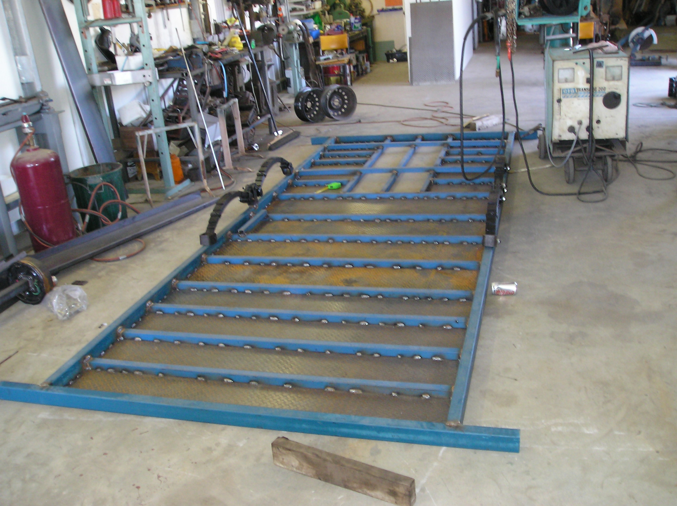

I have got a big problem its getting very heavy i don't know how I'm going to flip it on its wheels, if i use the endless chain it may pull my piss weak c150 shed frame down.
i might have to wait until I'm back at work on Monday and use a large loader and chain to flip it over on its wheels.
I like your dads truk. I want one.
I just got rid of my truck thats why I'm building this trailer.
