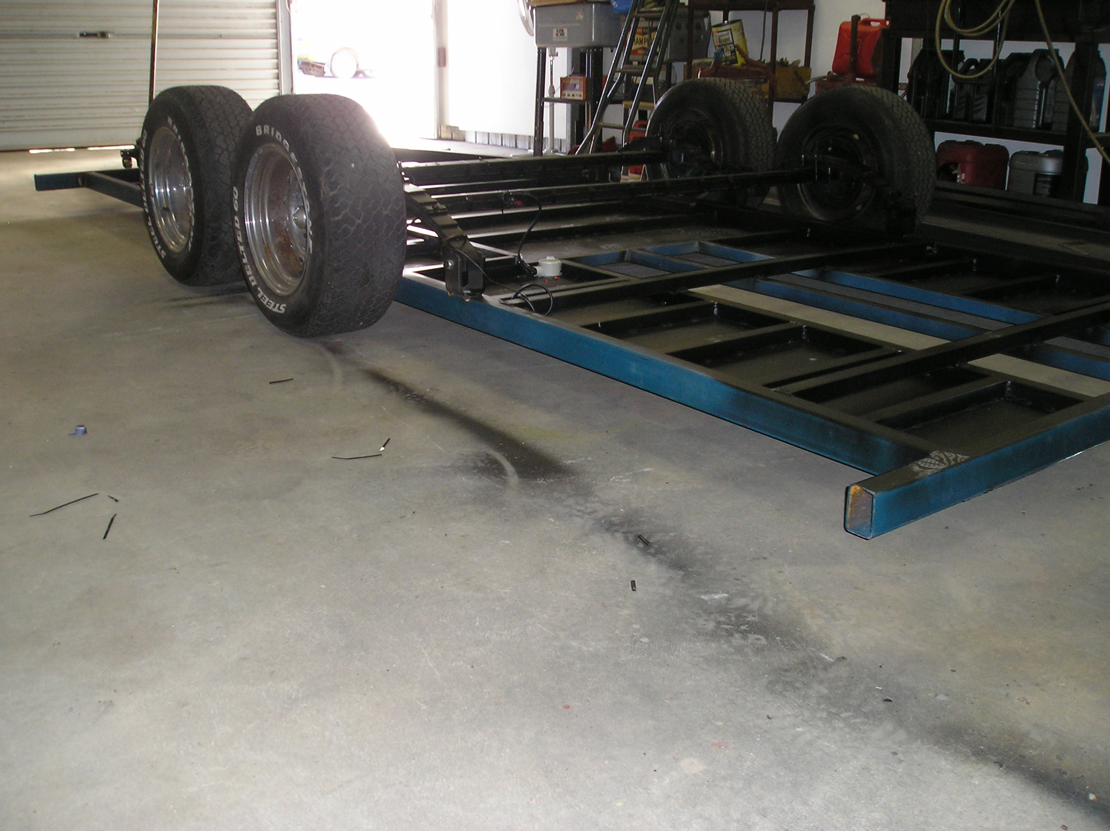

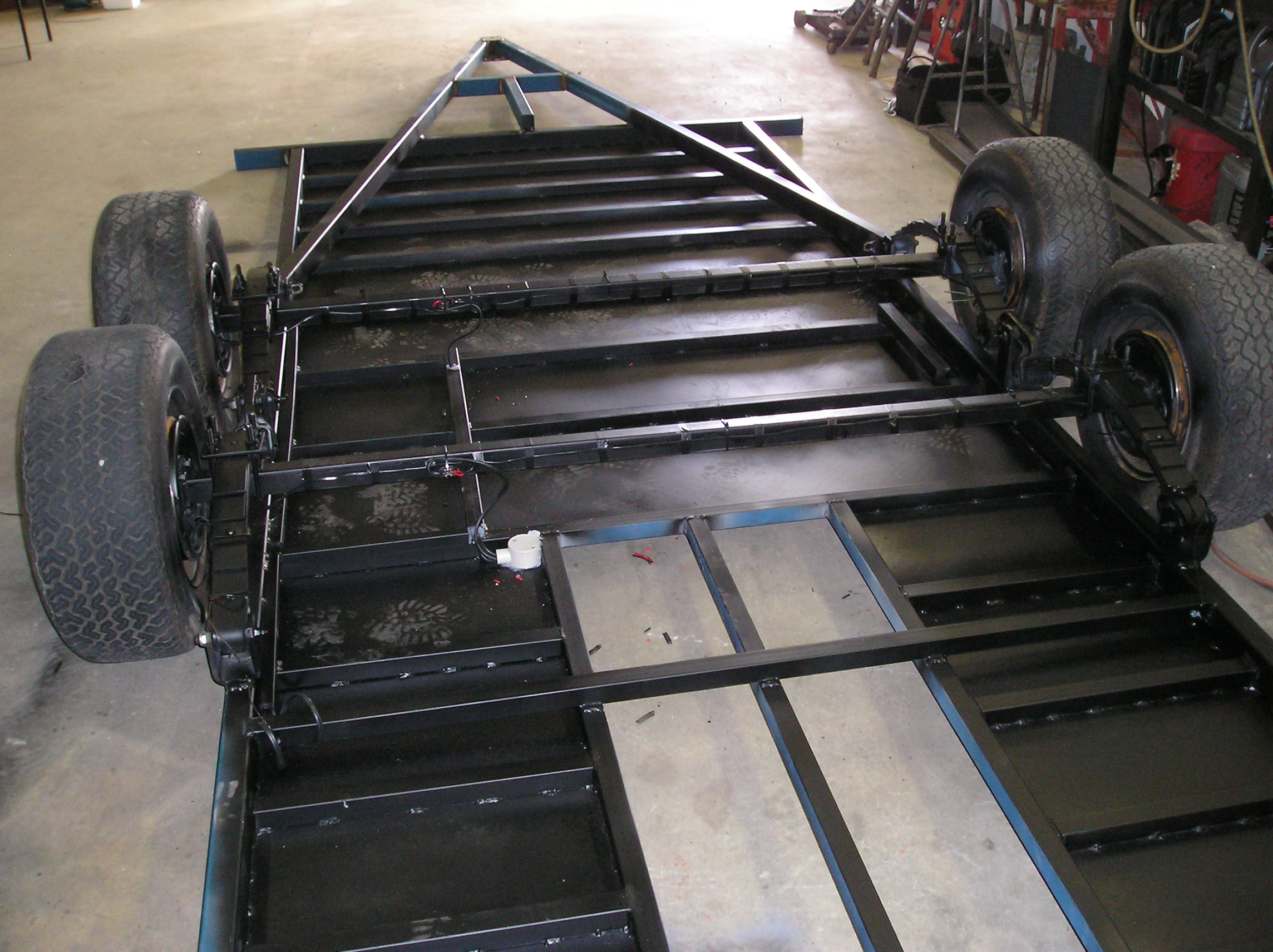

Thanks Everyone for your comments,
Day 4.2
I only spent 2 hours tonight as I worked all day.
I ran the wires for the electric brakes tonight
Good news ready to tip. ;)
More good news my boss said use any equipment i need. :y:

I just put the 12 slots on so i could roll it out the shed.
I am going to use VY VZ commodore one tonner rims they are thicker than sedans and stamped with Ute, If used with light truck tyres they will be legal.
what size metal are you using and how much did it cost you
whats the width of you trailer
the metal was the cheap part, it was the springs and axles that cost $3000 alone but if you wanted to just shift small cars axles/ springs would be cheaper.
Where did you get the springs and axles from? and what GVM are they rated to?
6 foot 3 inches inside 16 feet long
SA trailer and chassis on port Wakefield road, GVM 1600kg per axle 10" electric brakes x with springs and everything to hang them it came to $2793
