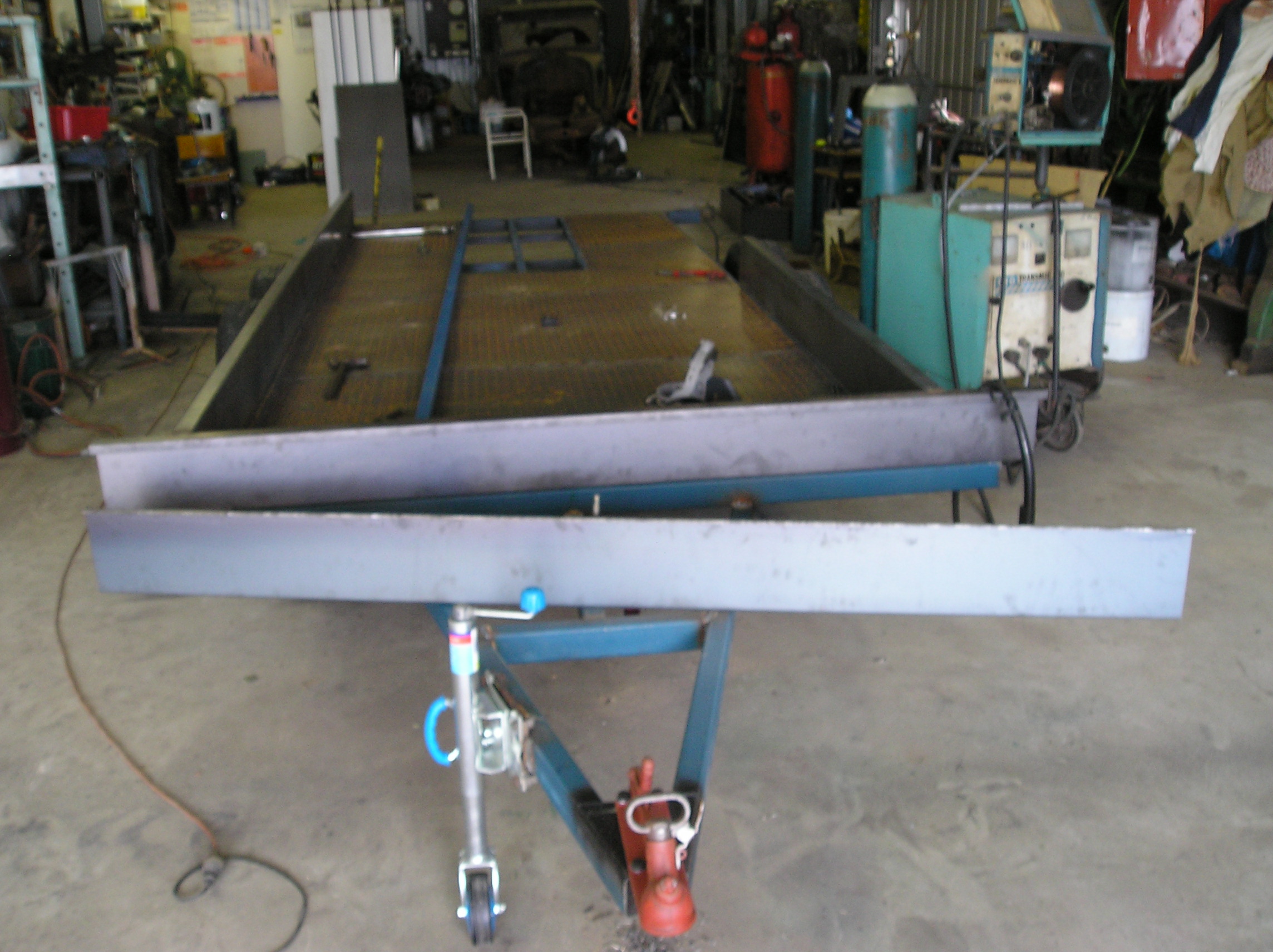

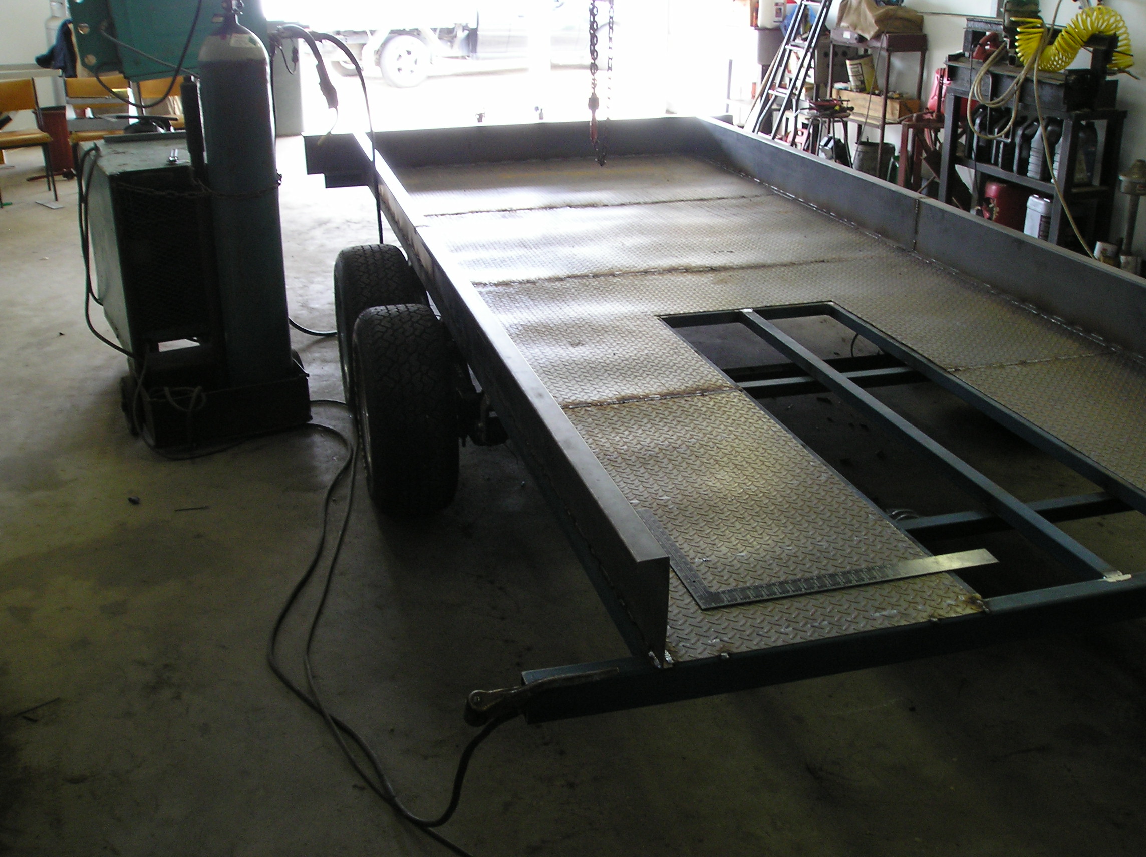

Looks like its coming a long well .What sort of tare weight do you reakon it will be?
I ve got my frame cut out for my new trailer, and like you bloody work gets in the
way of projects :)
One question where or how far back do you put the centre of the axles?
ive been told many formulas .

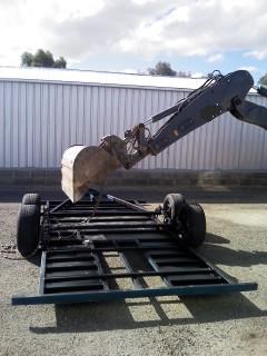

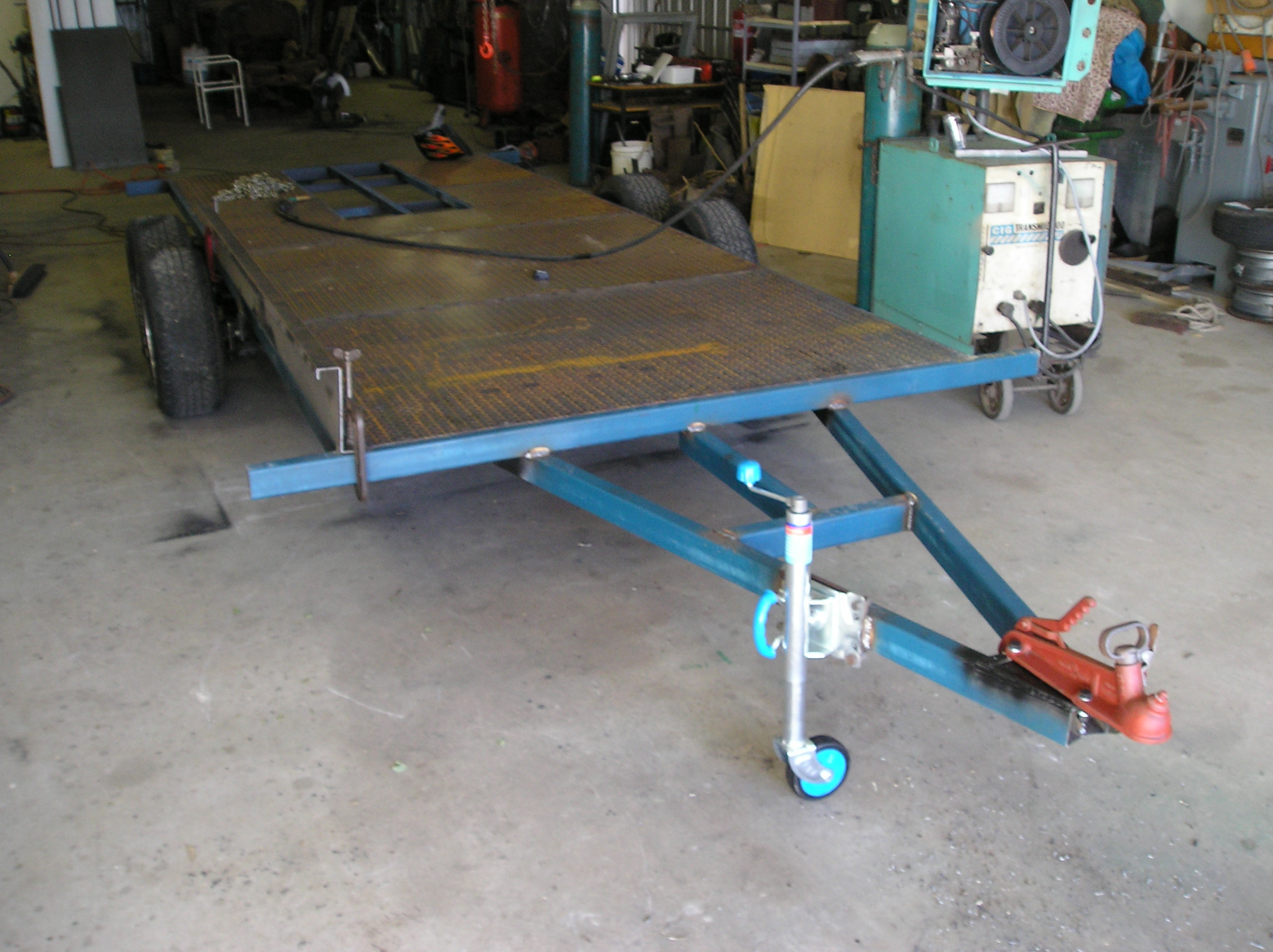

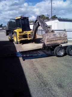

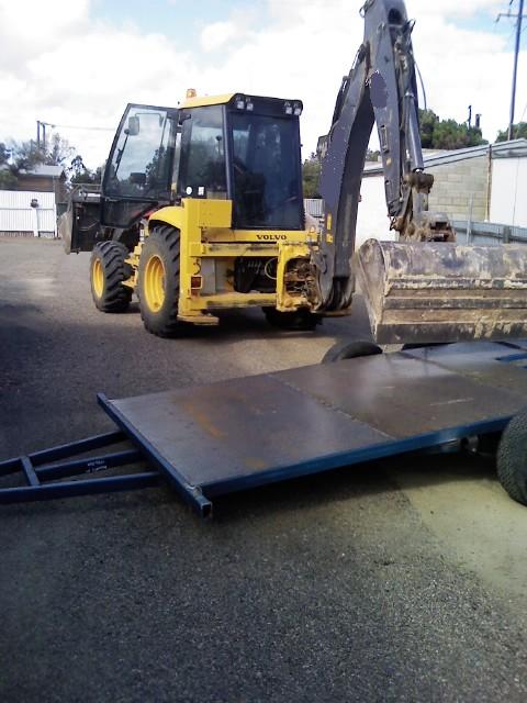

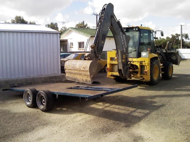

the trailer is getting heavy, the coupling is rated at 3.5 tonne so i will have to put over a weigh bridge and then work out my carrying capacity..
for axle placement i used 1/2 inch back of center for every foot of trailer. if there is to much weight on the draw bar with a short car I will just put the car back a bit.

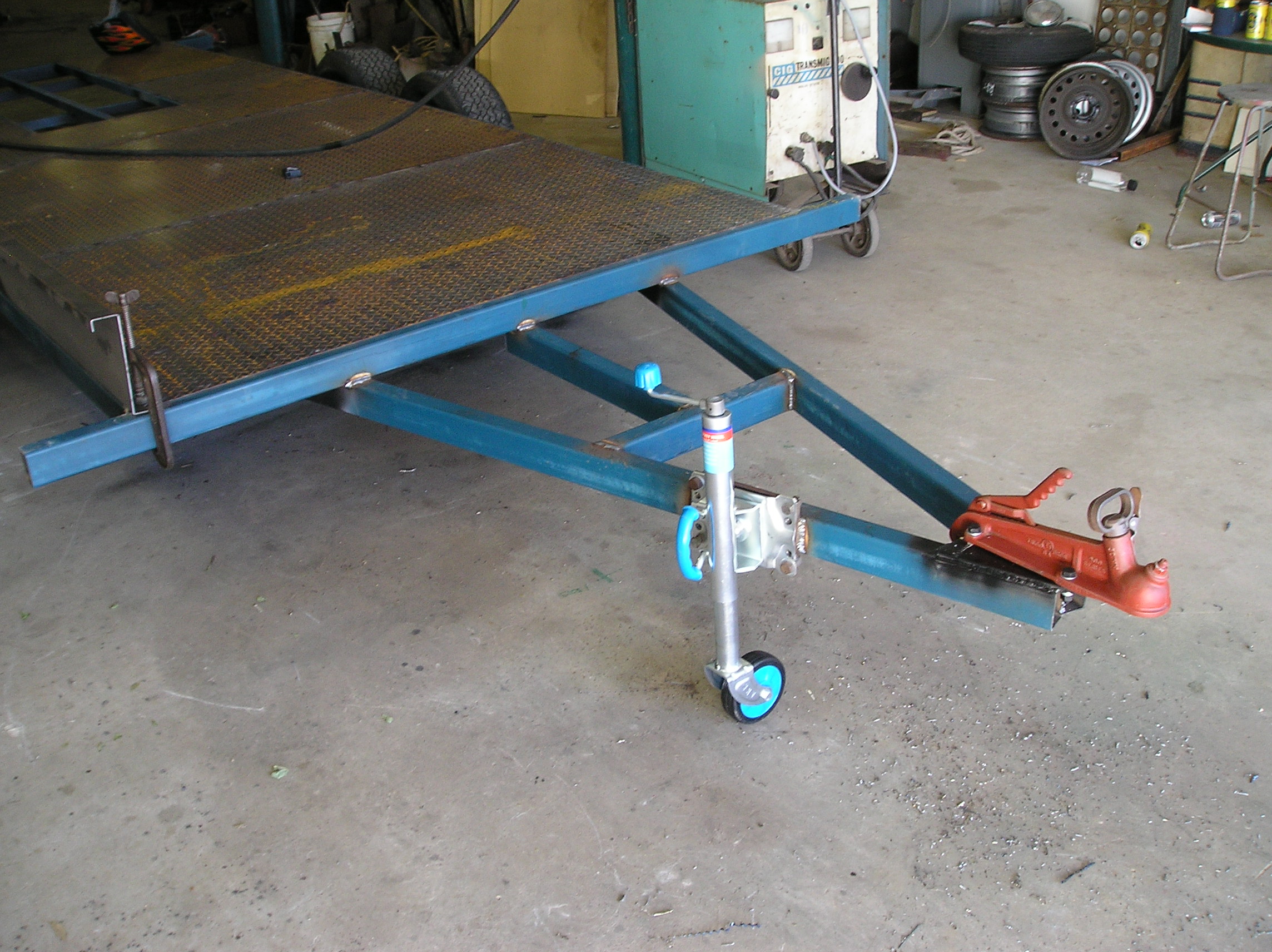

I have been thinking about how i can accommodate. The regulations say brake intensity must be adjusted from drivers finger tips AKA a brake controller. I was wondering if there is a remote control device that could be fitted ,to save a brake controller being fitted to every car i use to tow with.
bought these from a trailer place for $119 for the pair, will save me a little time.
I was gonna say you could buy these off the shelf. Looks the same as the ones we sell at work.

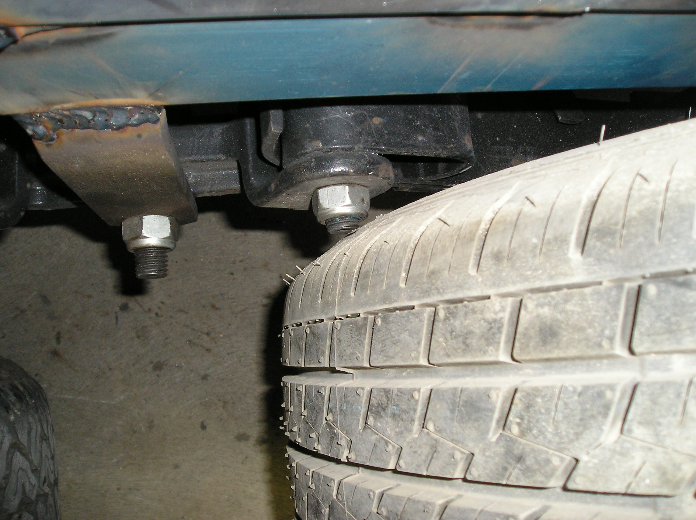

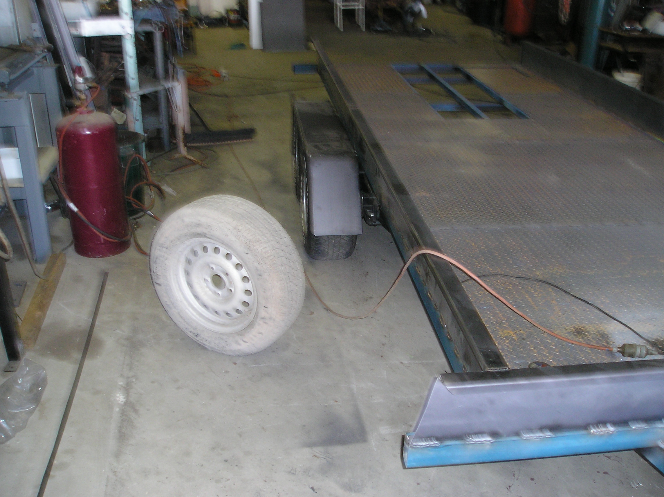

Day 6,
2 big problems,
1 wheel off set ,
2 spring shackle bolt almost rubbing on tyre.
I spent a lot of time today working out how to overcome these problems, I ordered the axle spring set to suite holden vy tonner rims,
