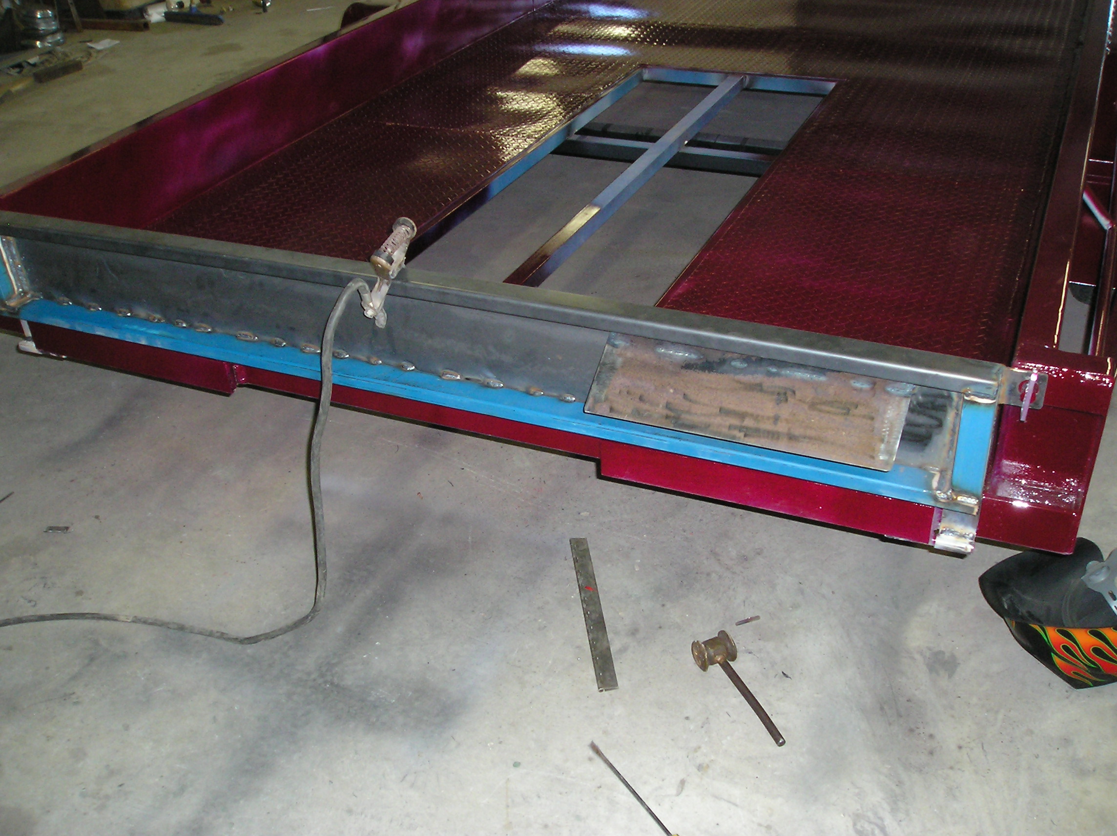

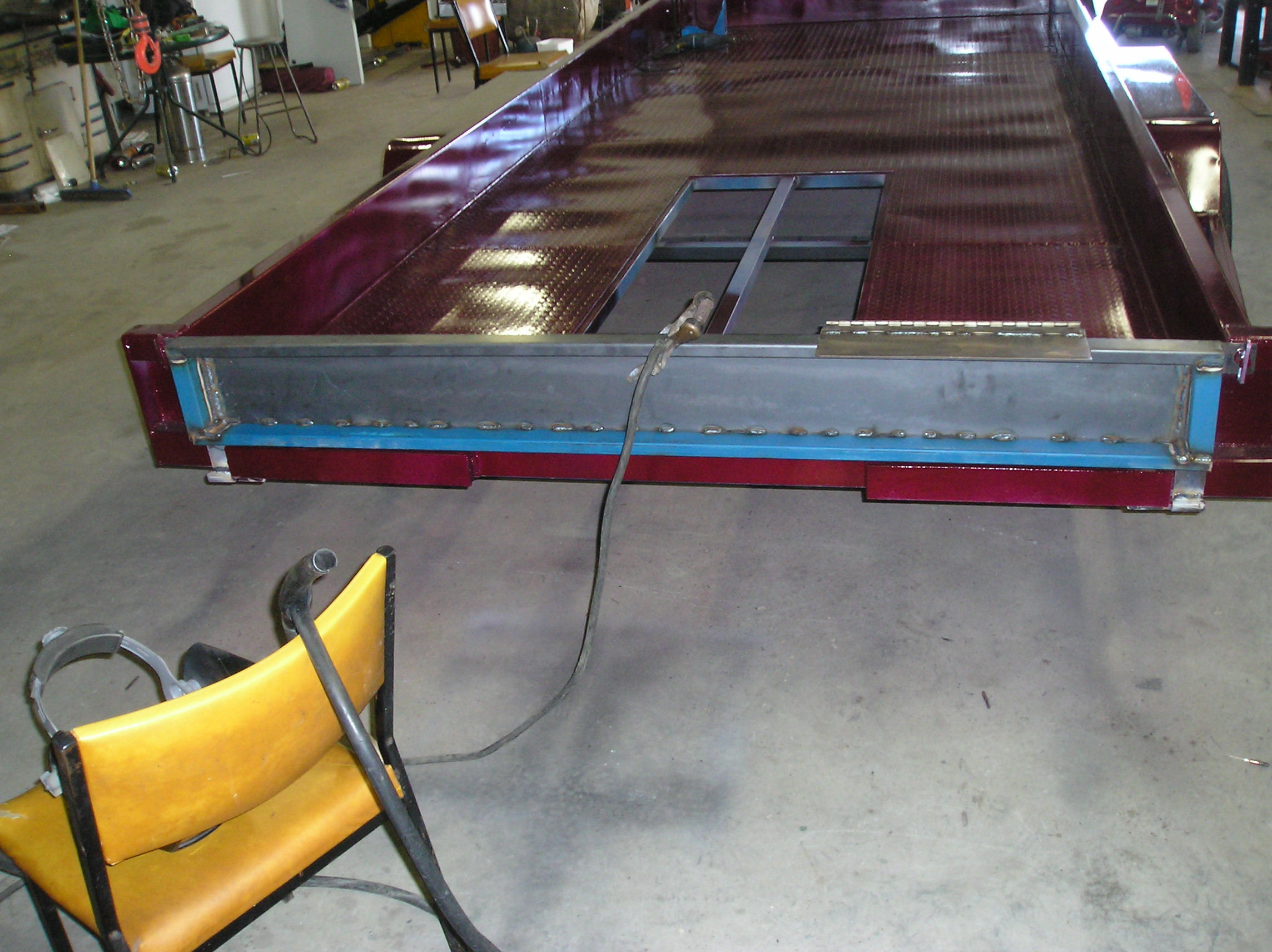

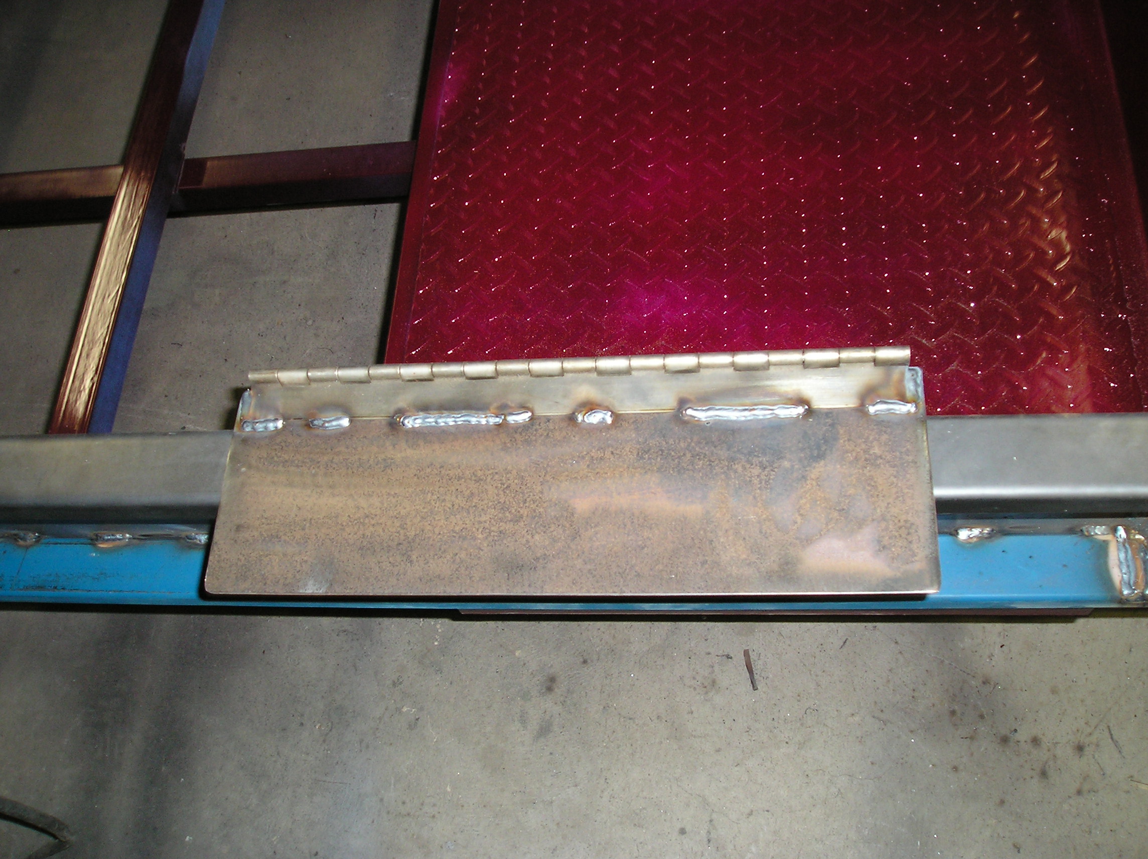

I put a few hours in after work finished off the back tailgate, fabricated a hinged number plate holder

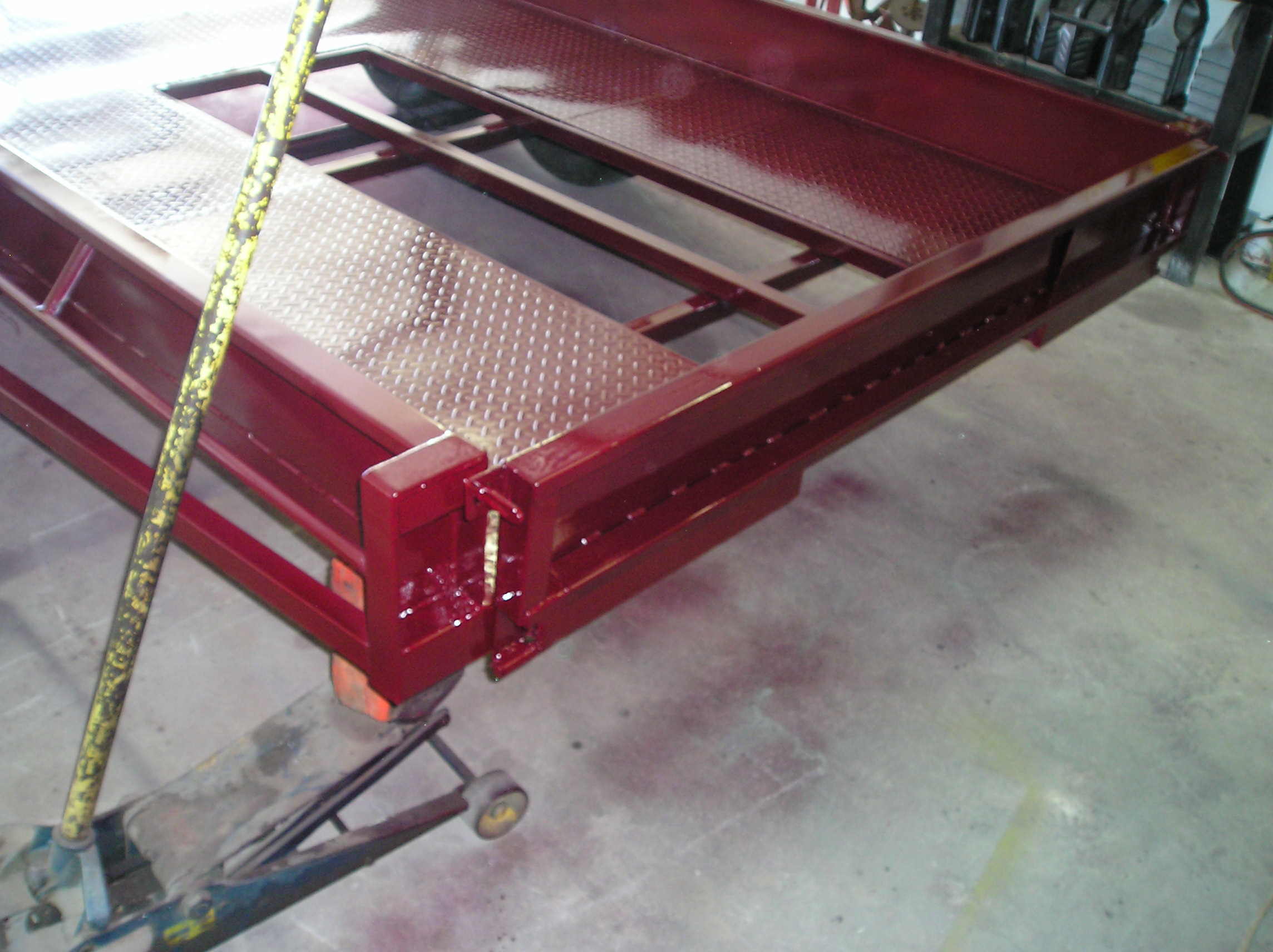

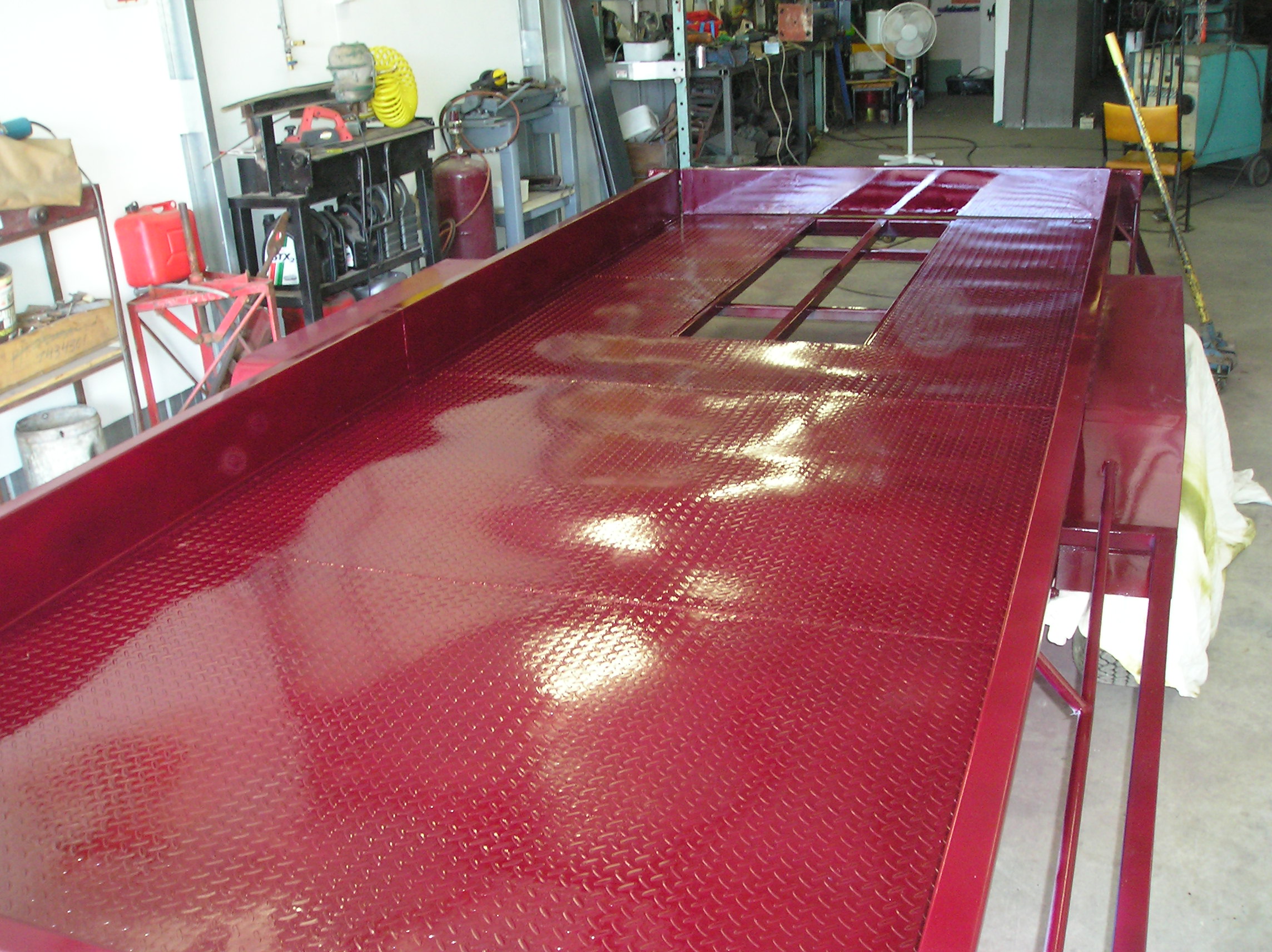

Tonight I got another coat on the walls floor and painted the tailgate.
In the photos the paint looks really good! Be interesting what it would look like in real life though if your not happy with the paint.

gaurds look good, welds look good, even from a distance, glad to see it wasnt fully welded, was done right :P
Why is it that you shouldn't weld it fully? It looks "holy" with all of them uneven gaps!
Love the colour by the way! Looks hot. But it definitely needs some hot-pink flames. :P
.... and a RollaClub sticker. :wink:
Well, the theory I use is that if a weld starts to crack, it wil crack the length of one weld, ie a couple of inches, as opposed to along the whole length as would be the case if the weld ran full length. You do the same with a car.
