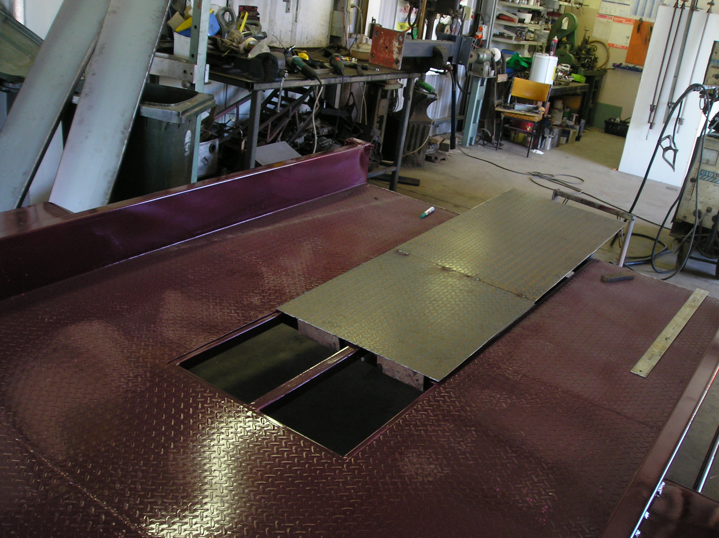

Because of the GVM I need a breakaway system the battery on the trailer that will hold the brakes on for 15 min. and may also later on be used to power a winch.
last night I Painted 75mm strip on the back white as required then fitted some reflectors.
today I took over a weigh bridge. the trailer weighs 810 kg.

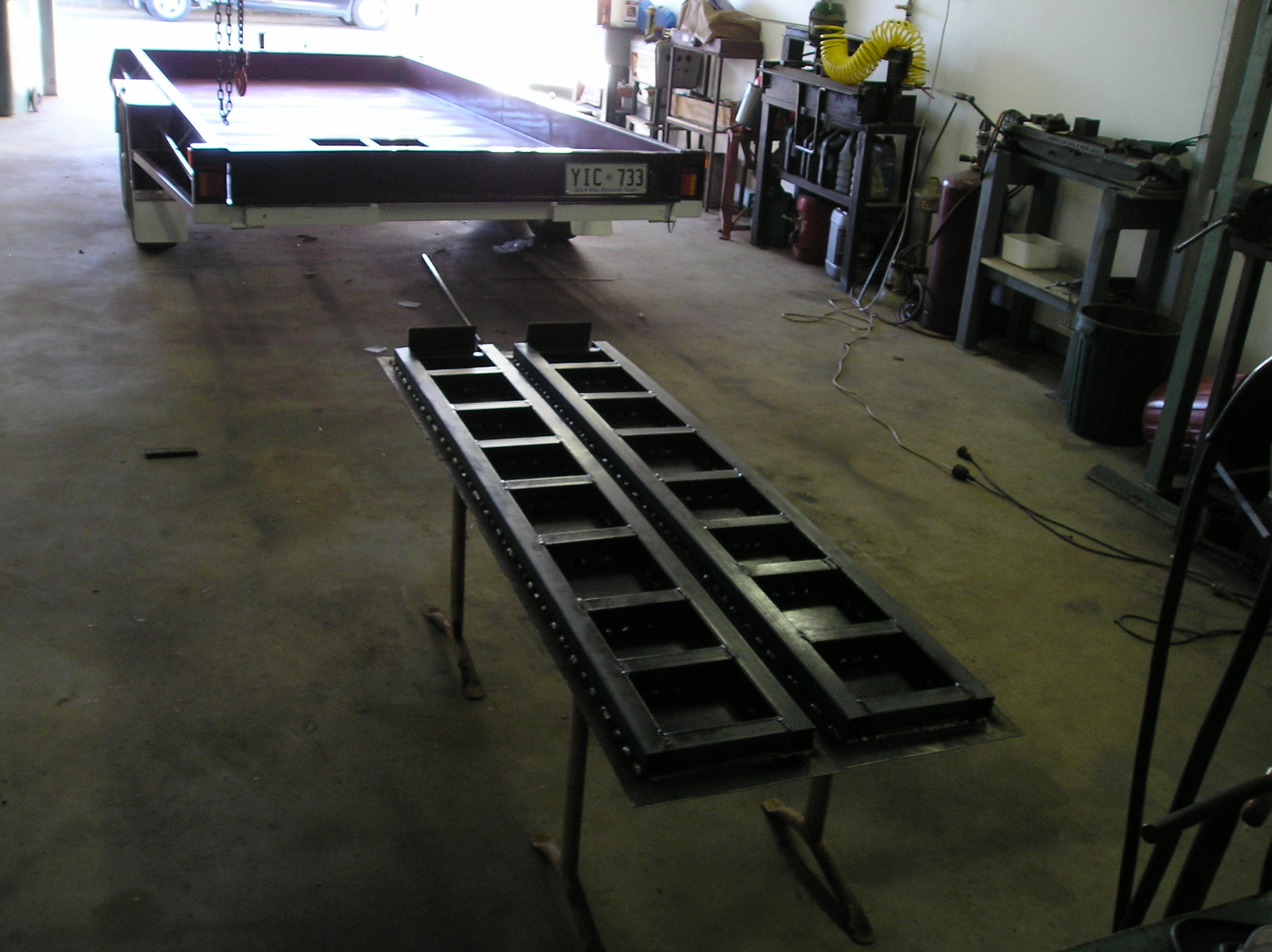

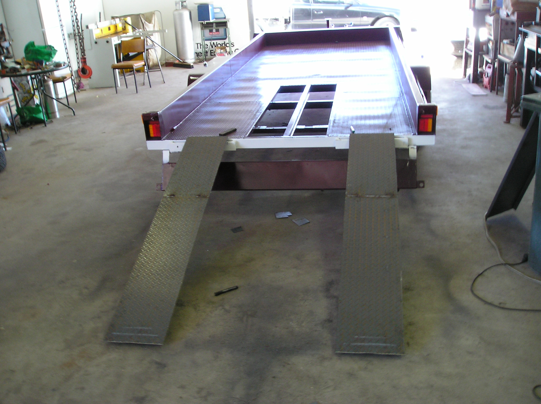

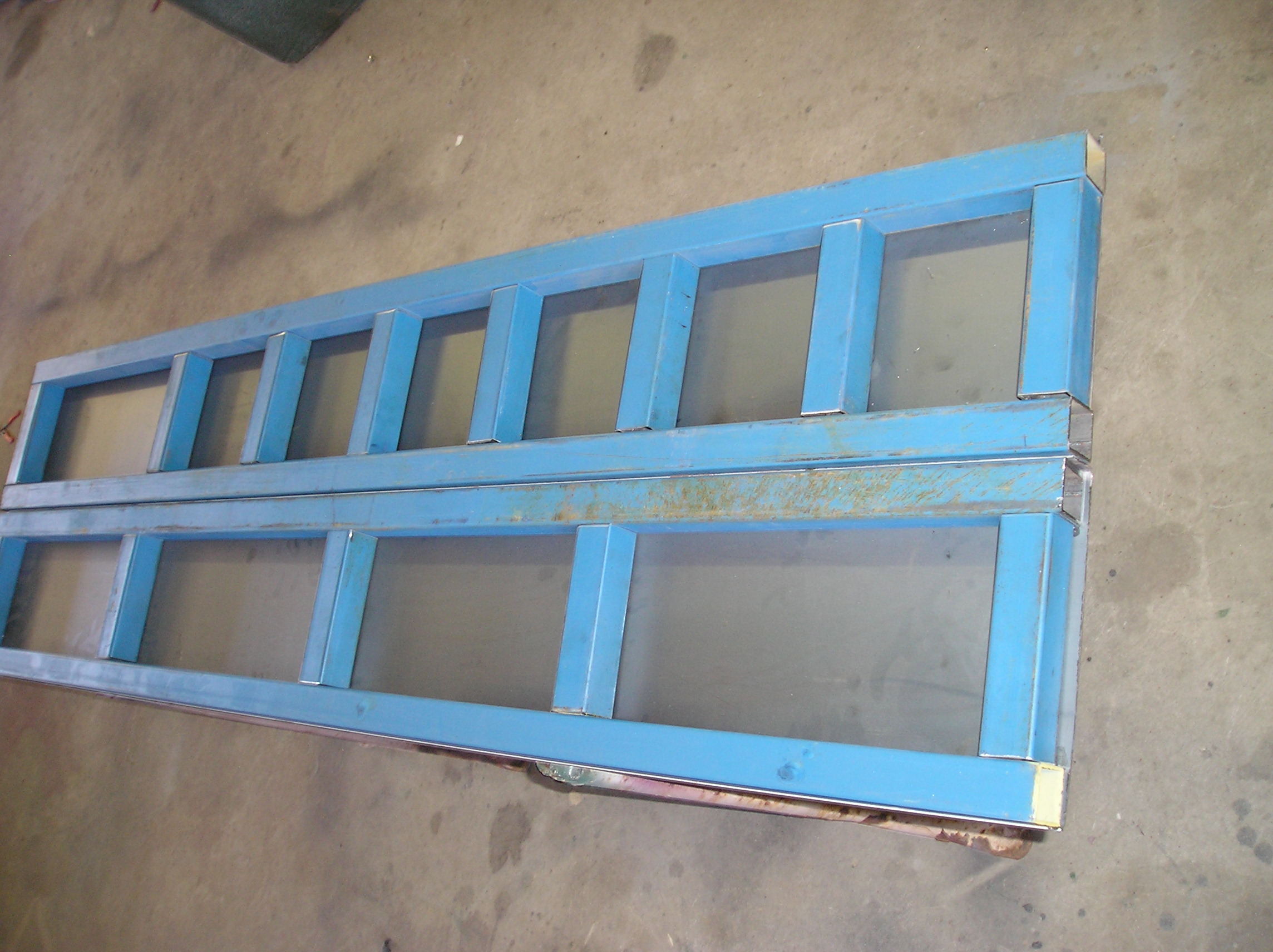

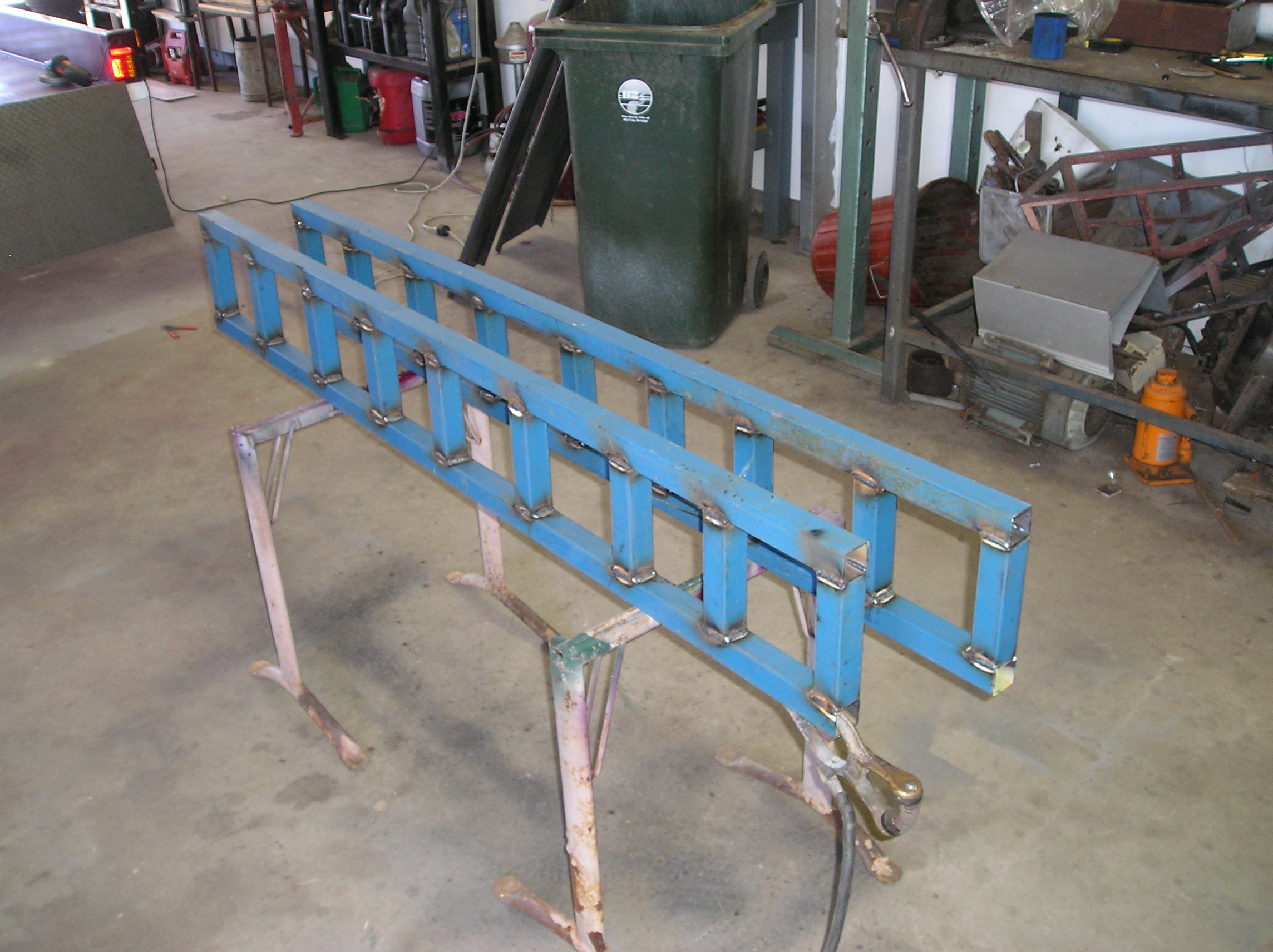

Today I made a pair of ramps for the trailer.
any reason why one is different to the other??
In the last pic they are just being set up to be welded i made then the same.
OOW I like, looking good kid. ;)

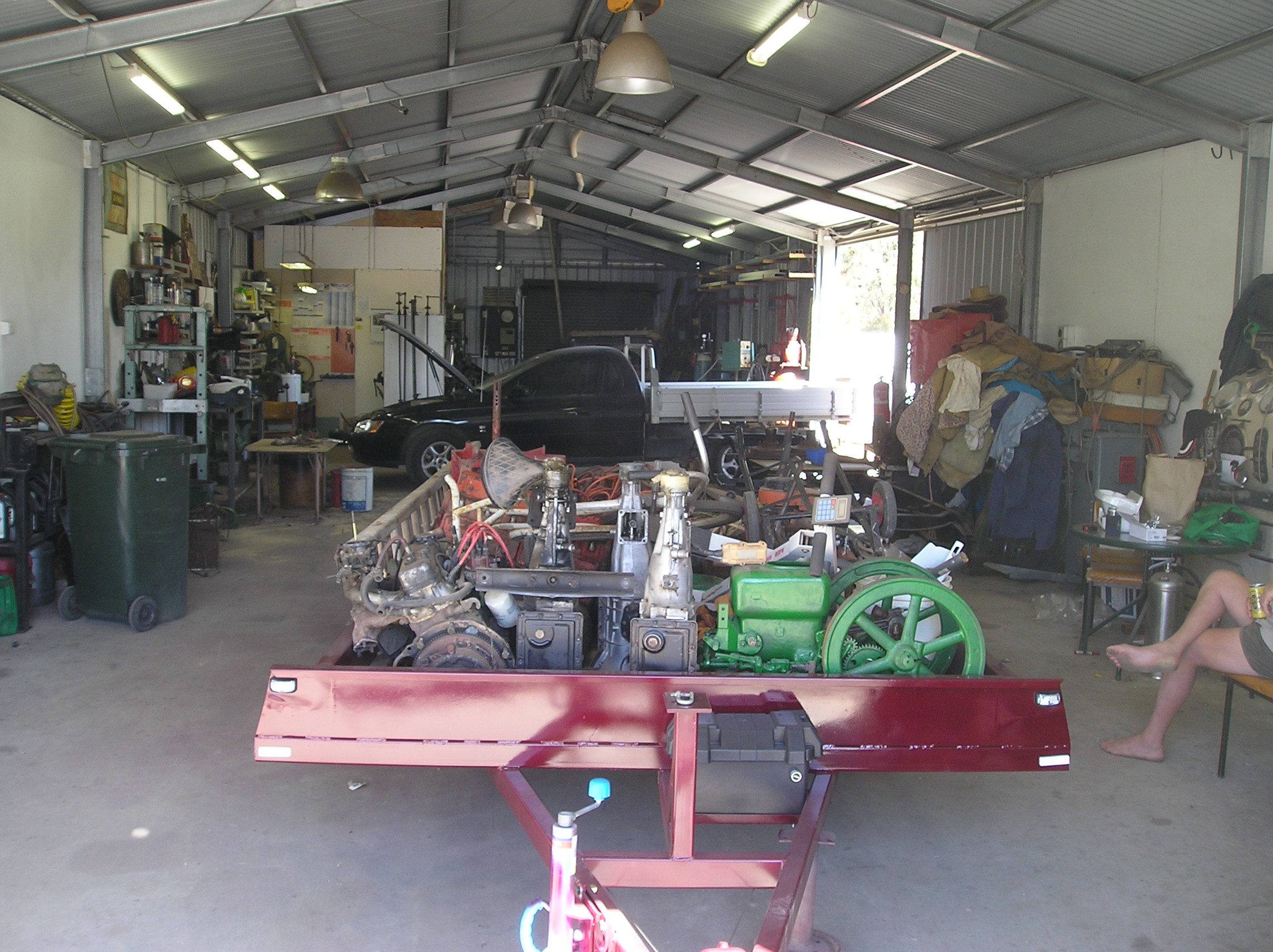

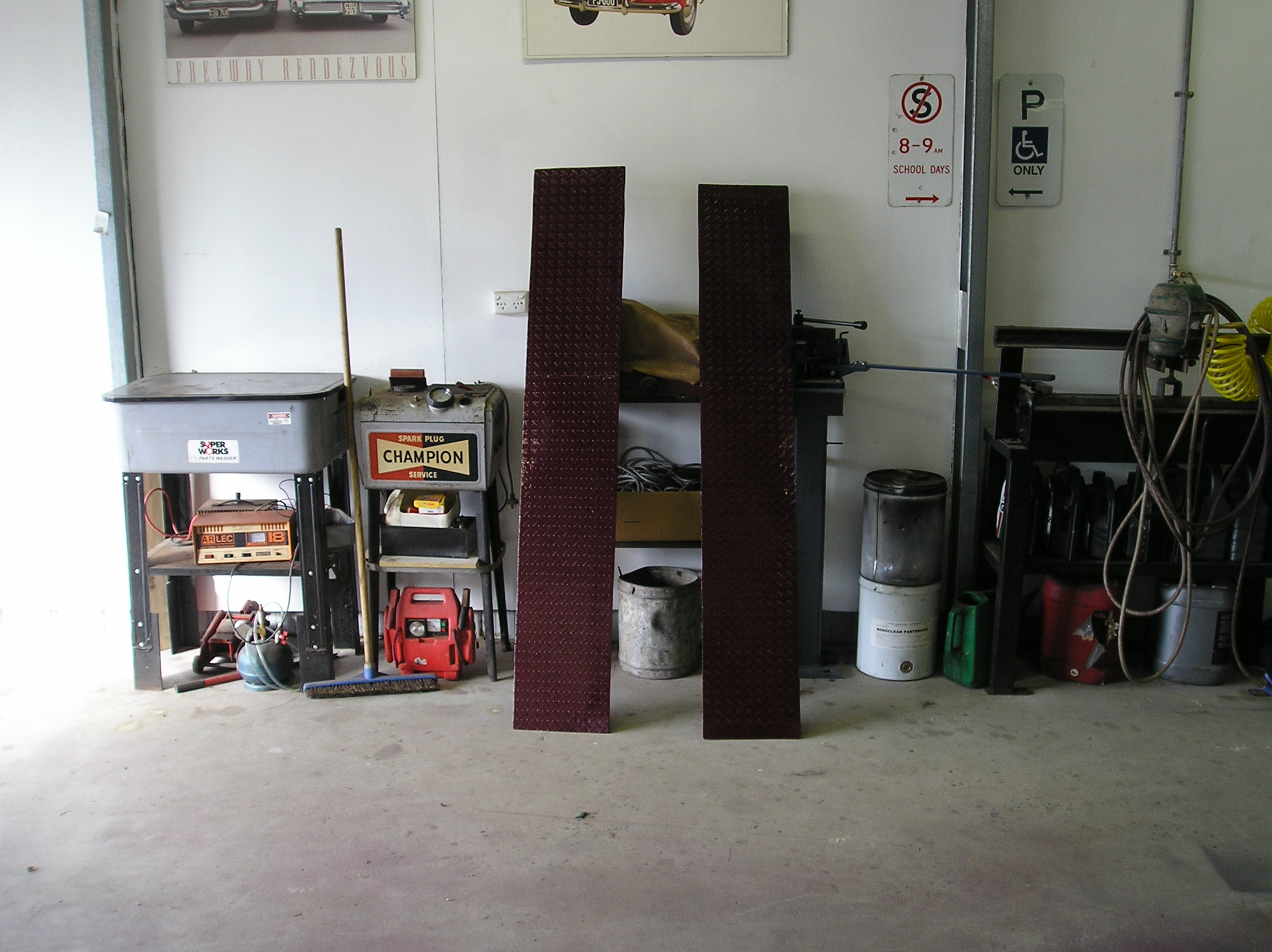

Project complete and tested :cool: :2thumbs: Ramps painted last week and fitted today.
i like the look of that old green engine right at the front left of the trailer
we got a couple of those at my work
they start up and everything!
