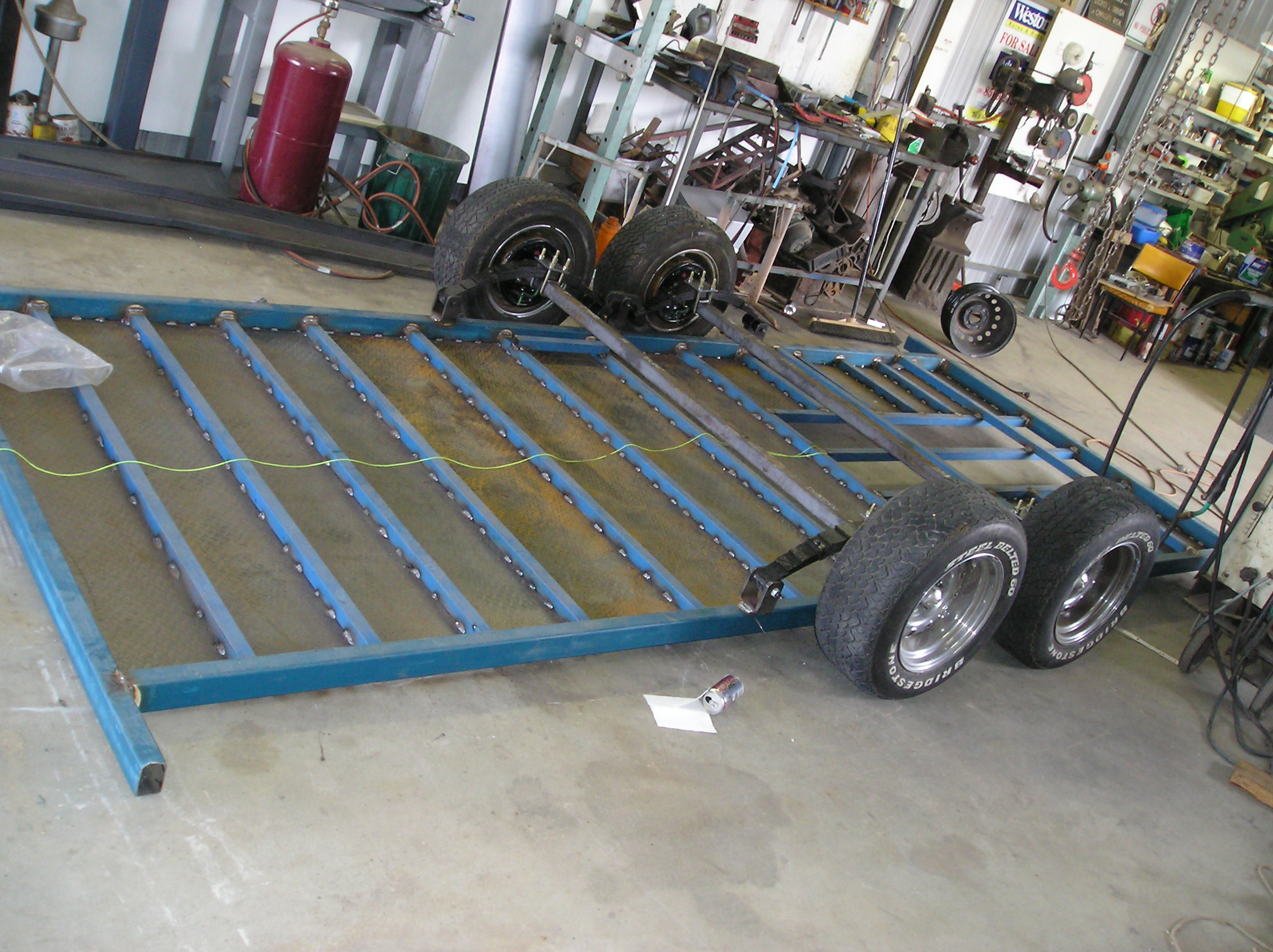

sucks about not being able to flip it over, I'm sure that if you made it out of aluminium with gal steel inside it, it would have been enough, seems a bit over kill to me, but who knows

I'm back to work on Monday for 3 days anyway. I have maybe 4 hours work left tomorrow ,
draw-bar ,
hitch plate and fit hitch,
chains,
light conduit to rear,
and painting underside. before I'm ready to flip.
The earthmoving company I work for is only 50 meters down the road from my workshop. so i will just borrow a loader or backhoe for 10 min job done.

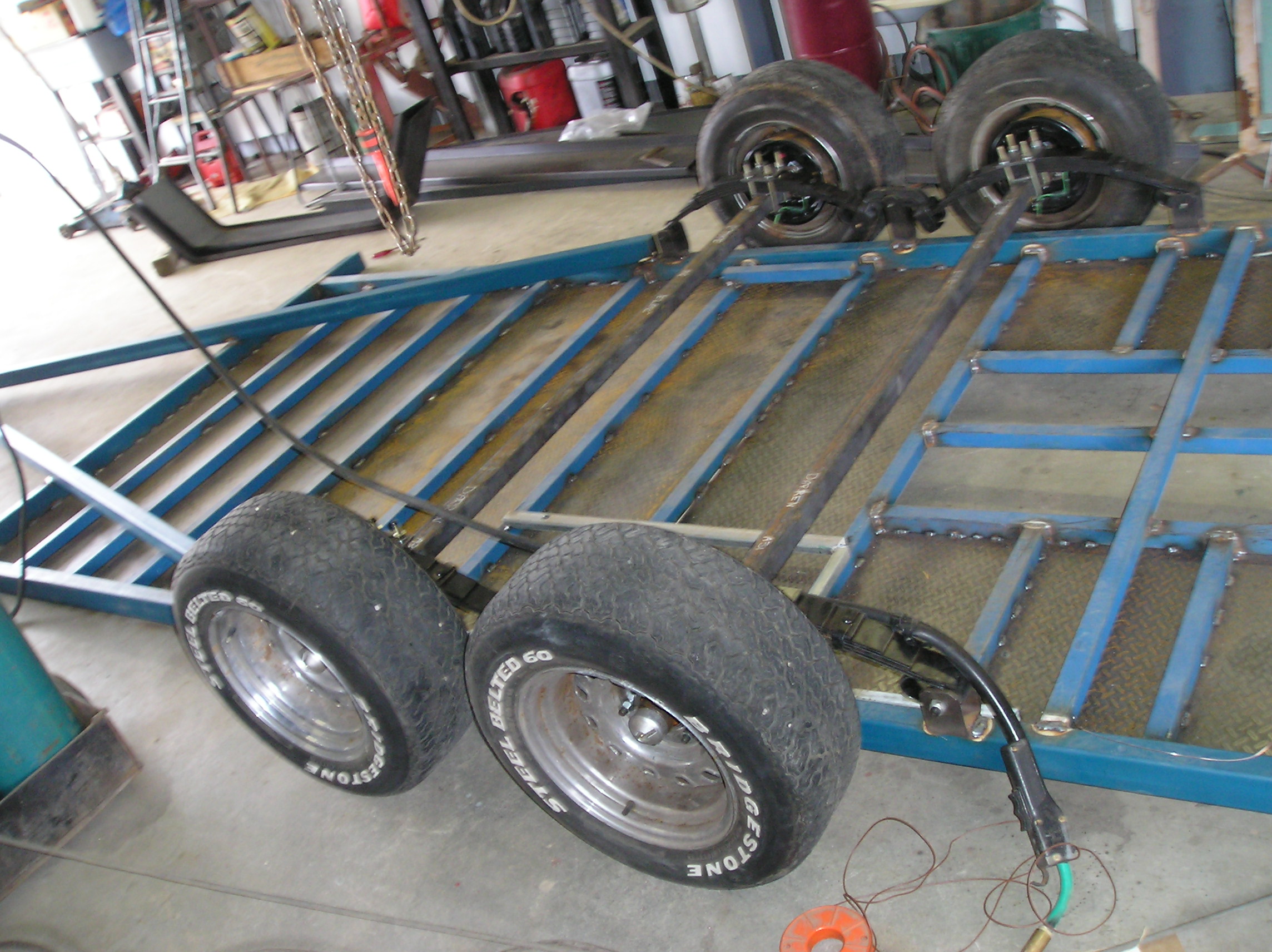

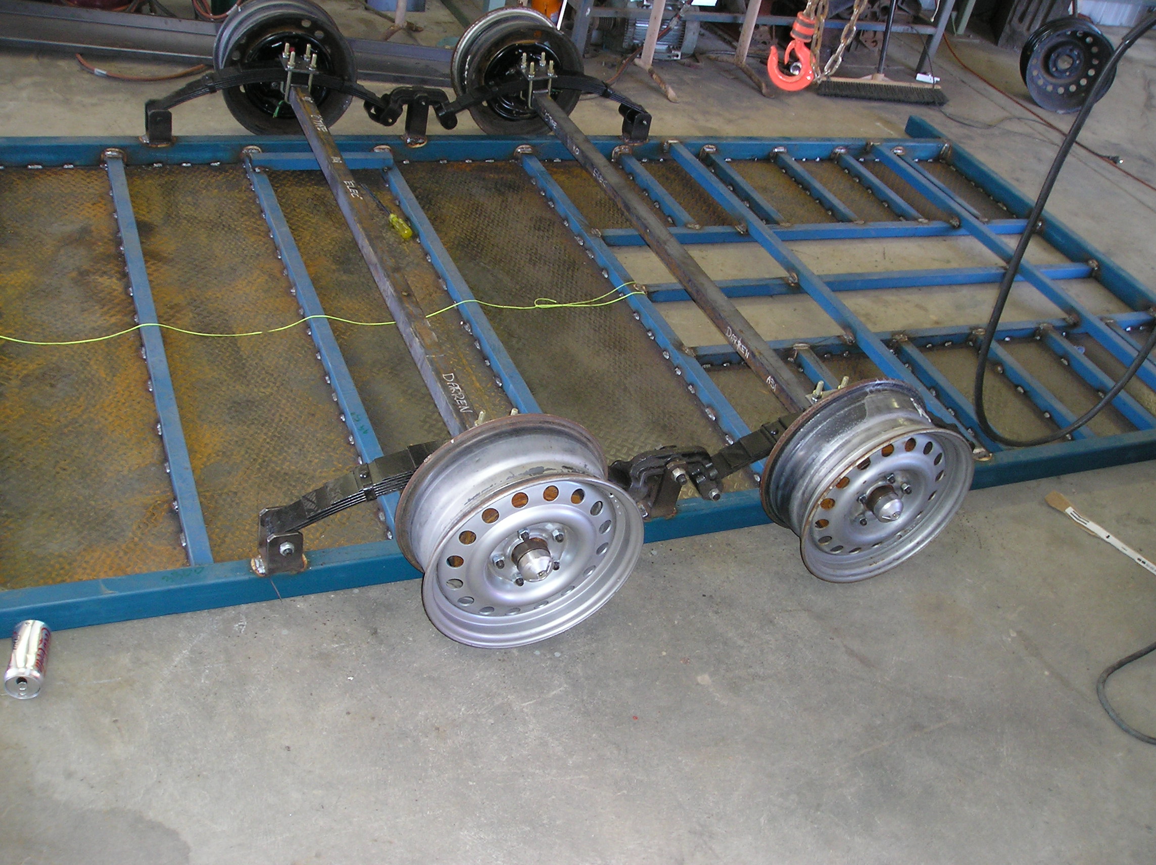

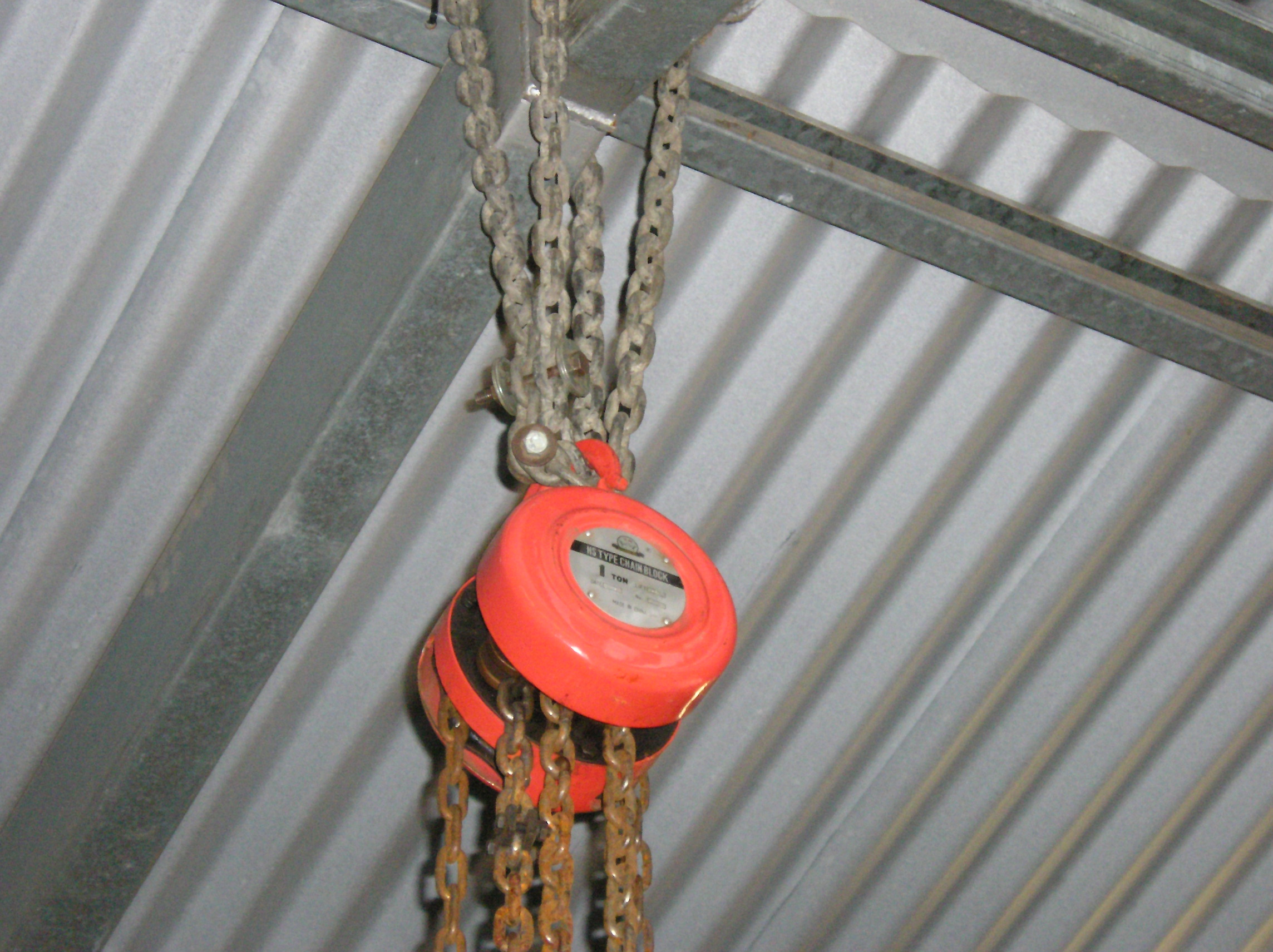

It is going to be interesting just how much it does weigh when i put it over the weigh bridge, i got a 1.0 tonne bock and tackle its starting to get a bit heavy for that.
Take the axles off and flip it. Then jack it up so you can put them back on.
It took me half the day to fit and align them, I'm just going back wards if i disassemble now.

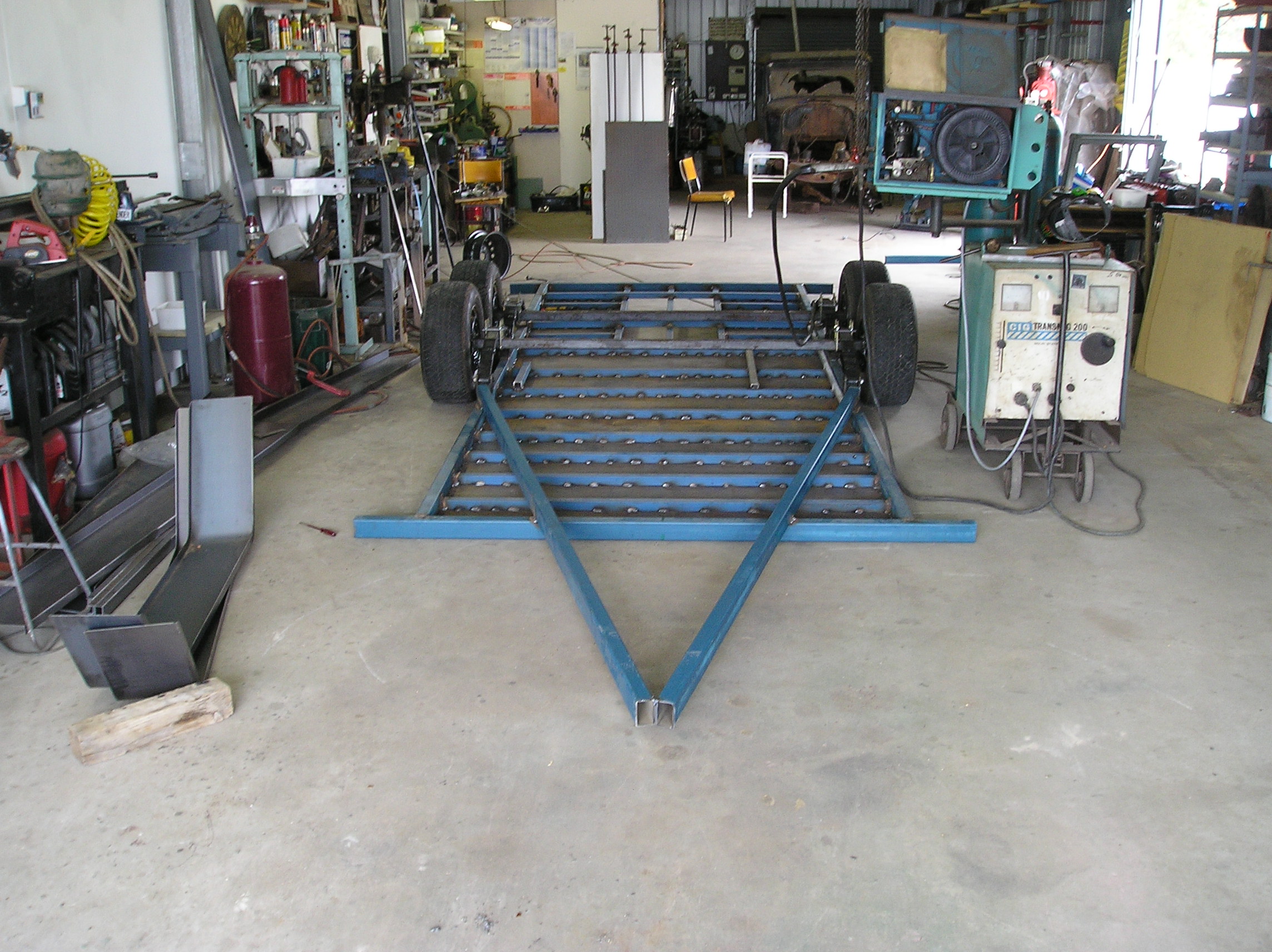

I would go longer ramps, ever tried getting a lowered car on a short ramp?
Also what about foot stands? Lets just say you drive your car on the ramp, wouldnt the trailer tip?

I'm thinking about having a spare set of long ladder ramps to take with me when i need them.
i have frequently had the back wheels of my Ute off the ground when loading its not good, on a hill no brakes and you start rolling down the road. I try and get someone to hold the brake pedal down in my Ute so the front brakes hold it.
at least with this trailer i can pull the breakaway pin before i load and its not going anywhere.

the trailer rolls OK upside down i have this chain block was thinking of trying to flip it over later on.
