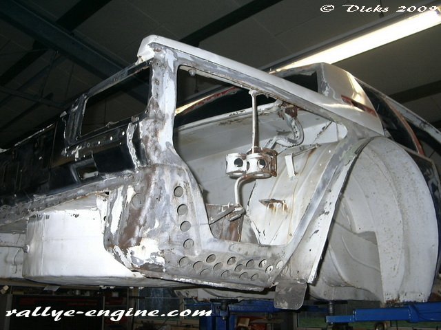

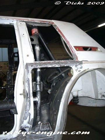

hahaha u think u have seen swiss cheese wait till u have seen this
i found it on a guy who restored the famous WHISTLING PIG (RA63) Group b rally car!!! :bash:
these pics are from what they did at factory rally team!!!
mind u there was fibreglass panels over these sections!!! :P
this build is an awsome look the link is http://rallye-engine.com/index.php

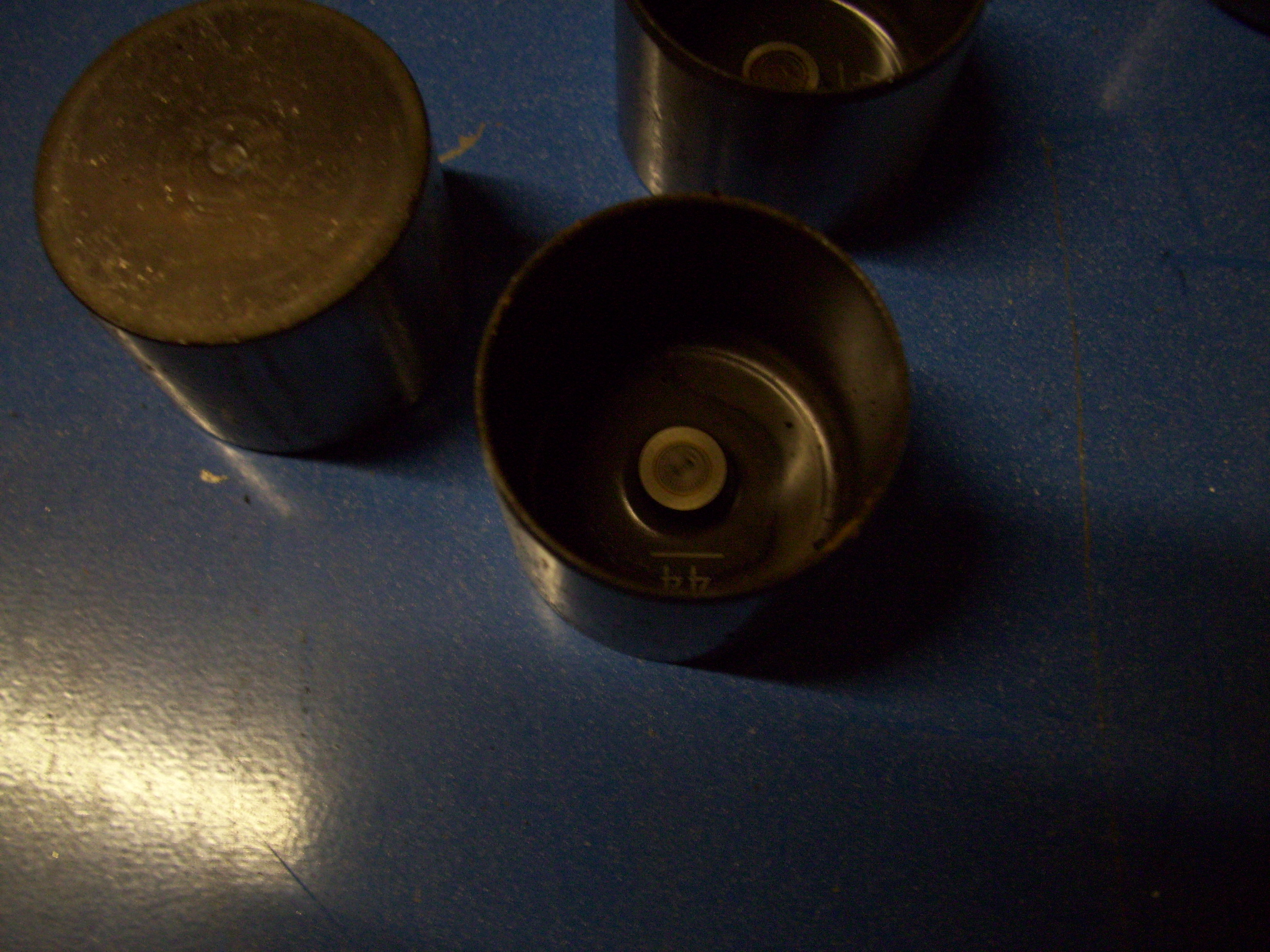

Today we scored a set of solid buckets for the engine, $$$ = FA.

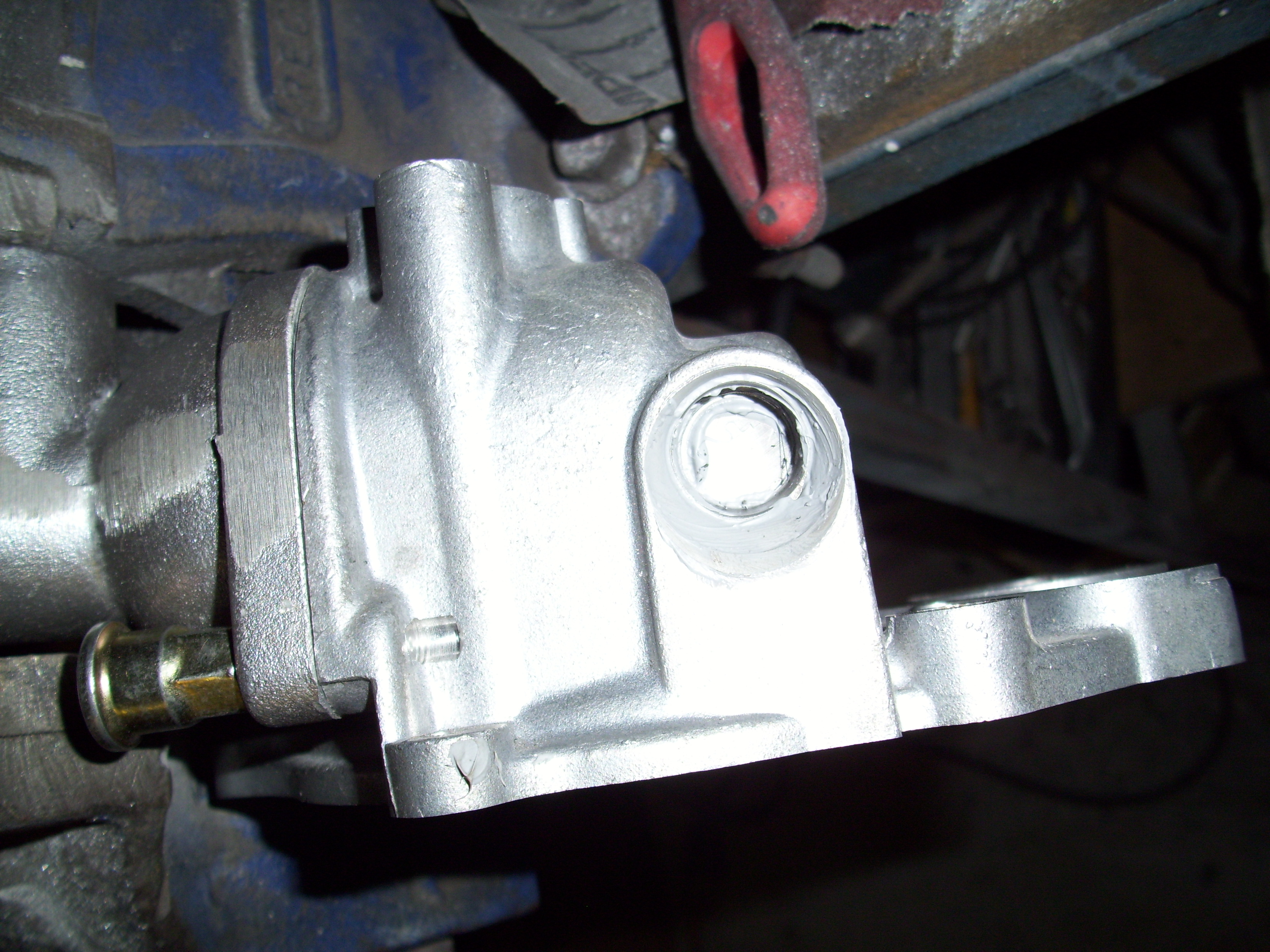

Also started machining the adapter to take the electronic K dizzy.

Hey Rob, still working on it at the moment, have found another way to do it.
Does still include an adapter, but it'll be flush with the head, discovered you can drill the K dizzy shaft as it's not case hardened.
Also there are 2 types of 4age dizzy gears, one is pressed on to the shaft, and the other is pinned through the shaft.
I'll post some pic's when it's done, and i may do a write up as well, because there is so much bad info out there about which is the best way to do it.

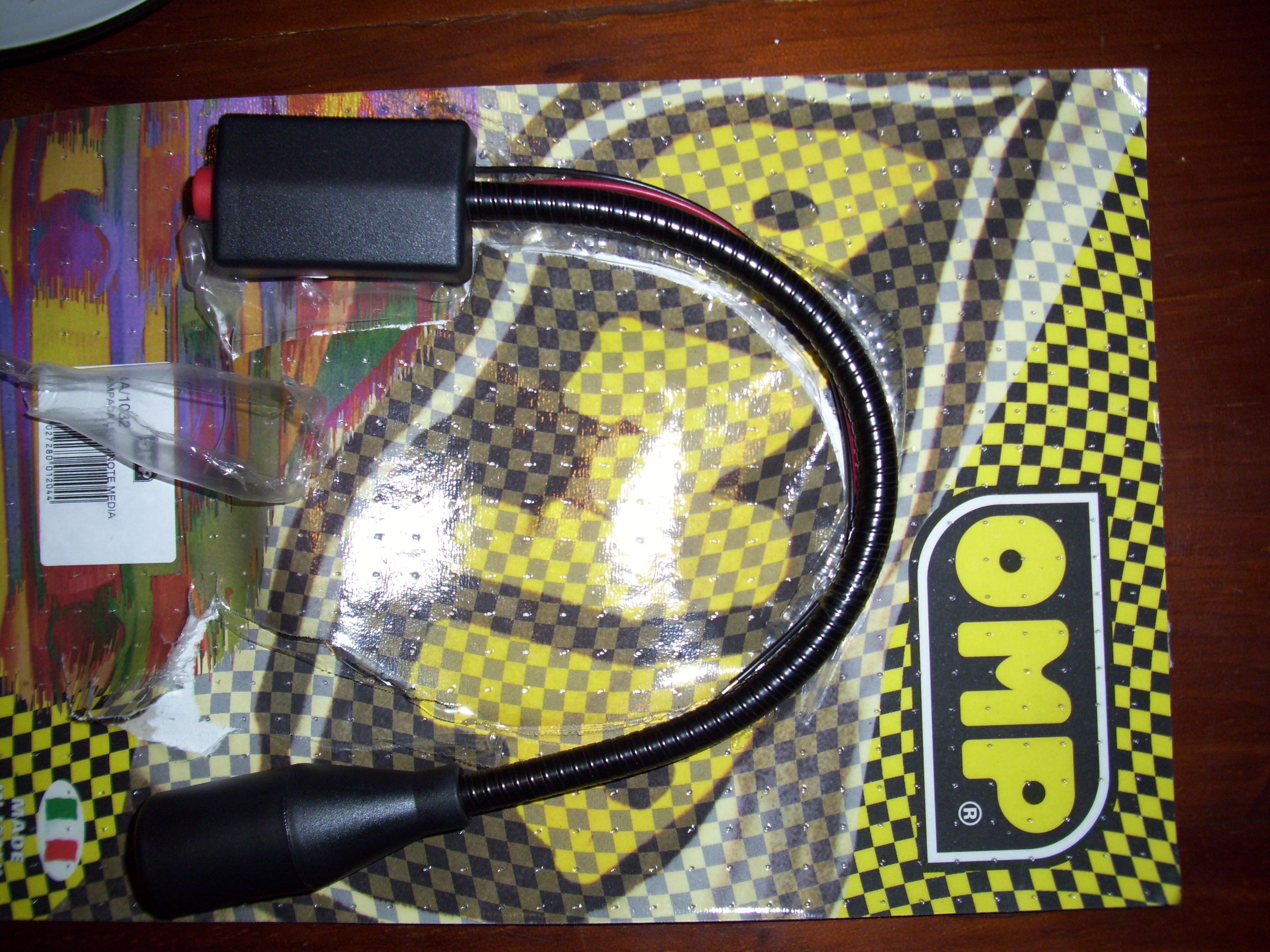

New map light has finally turned up, that'll be fitted to the car in the weekend.

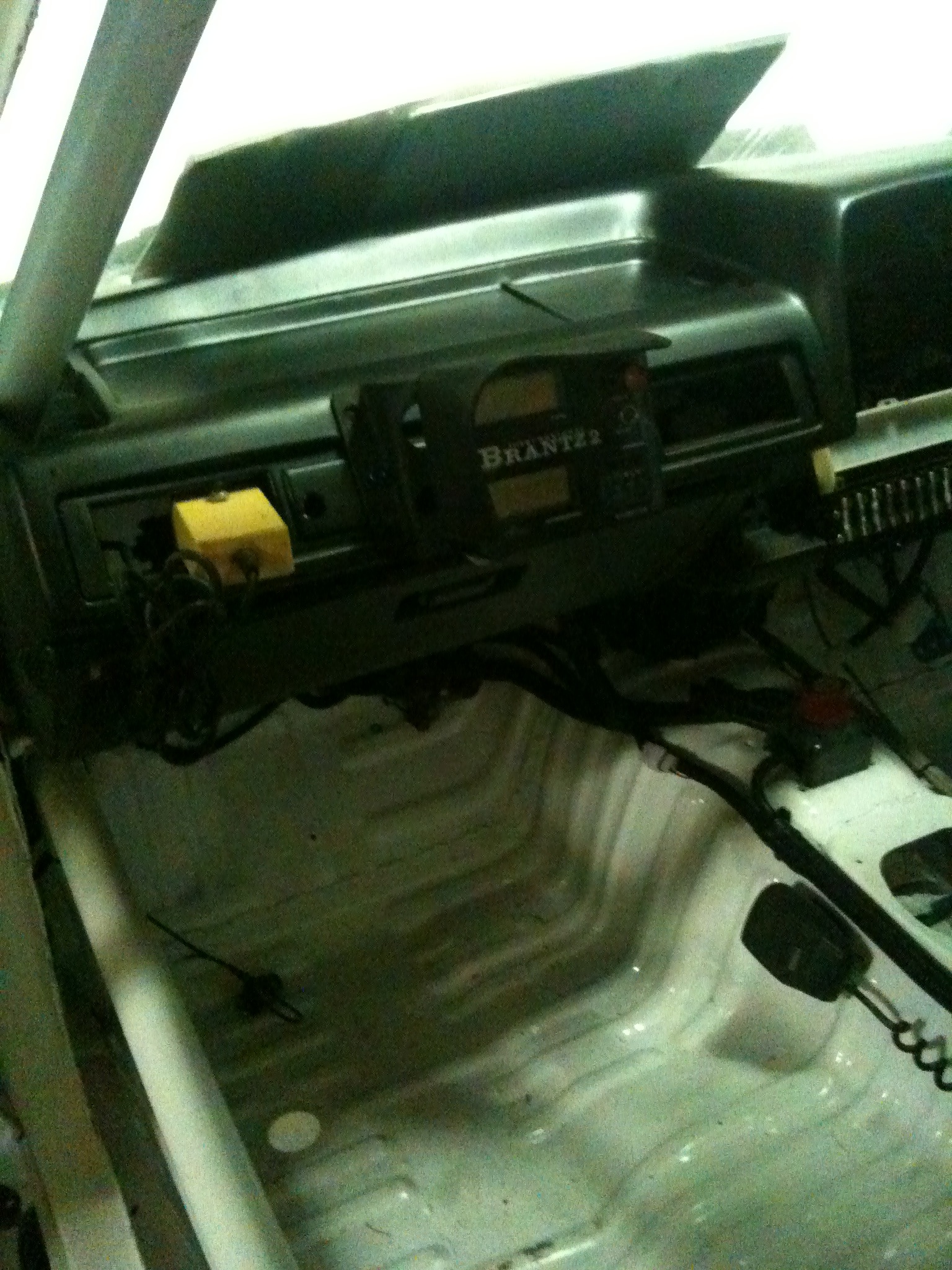

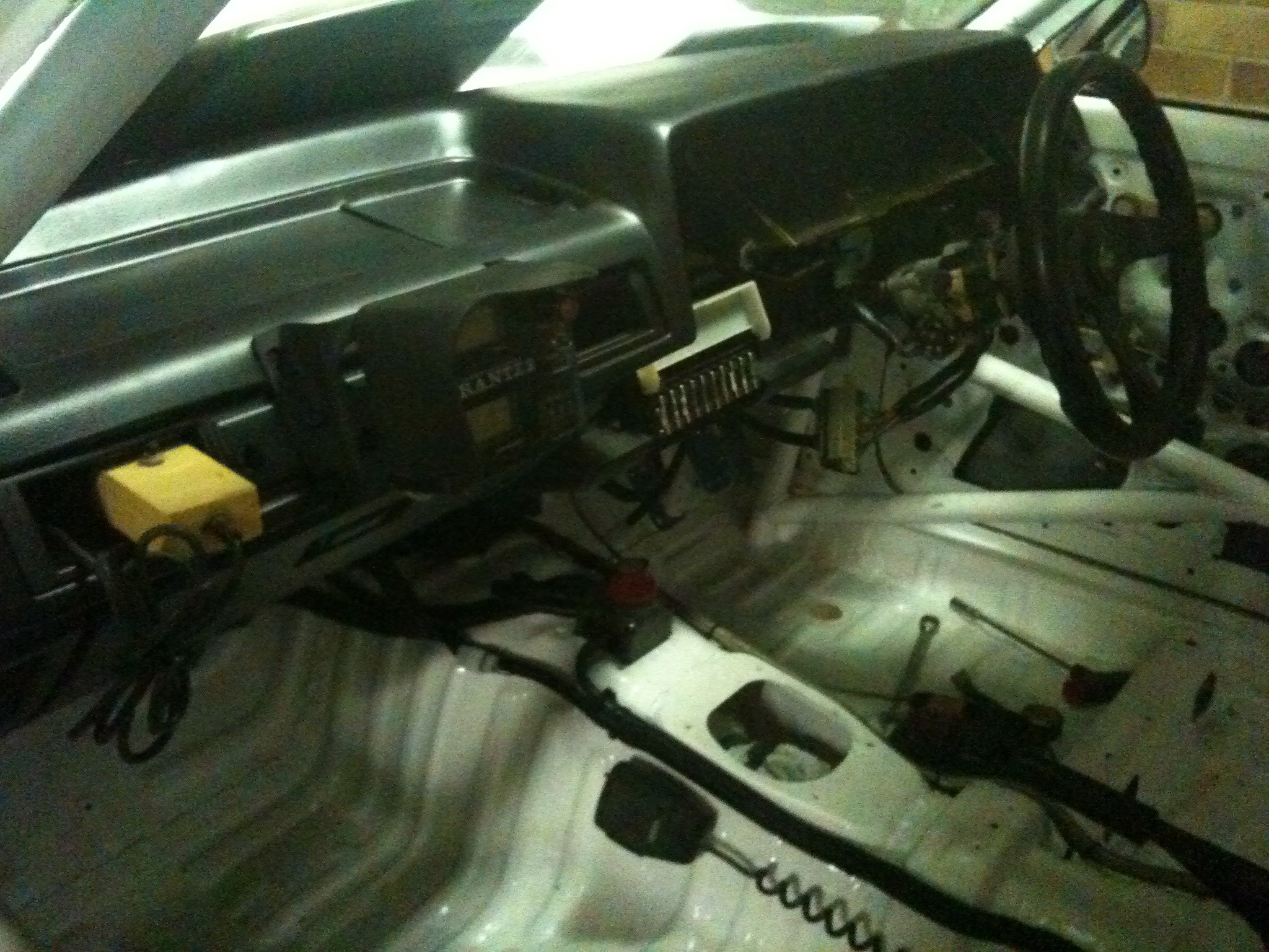

Have screwed half the dash in, and we're lightening things as we go.

Dash is all screwed in with Brantz (Terra trip)bolted in, and map light screwed on.

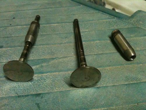

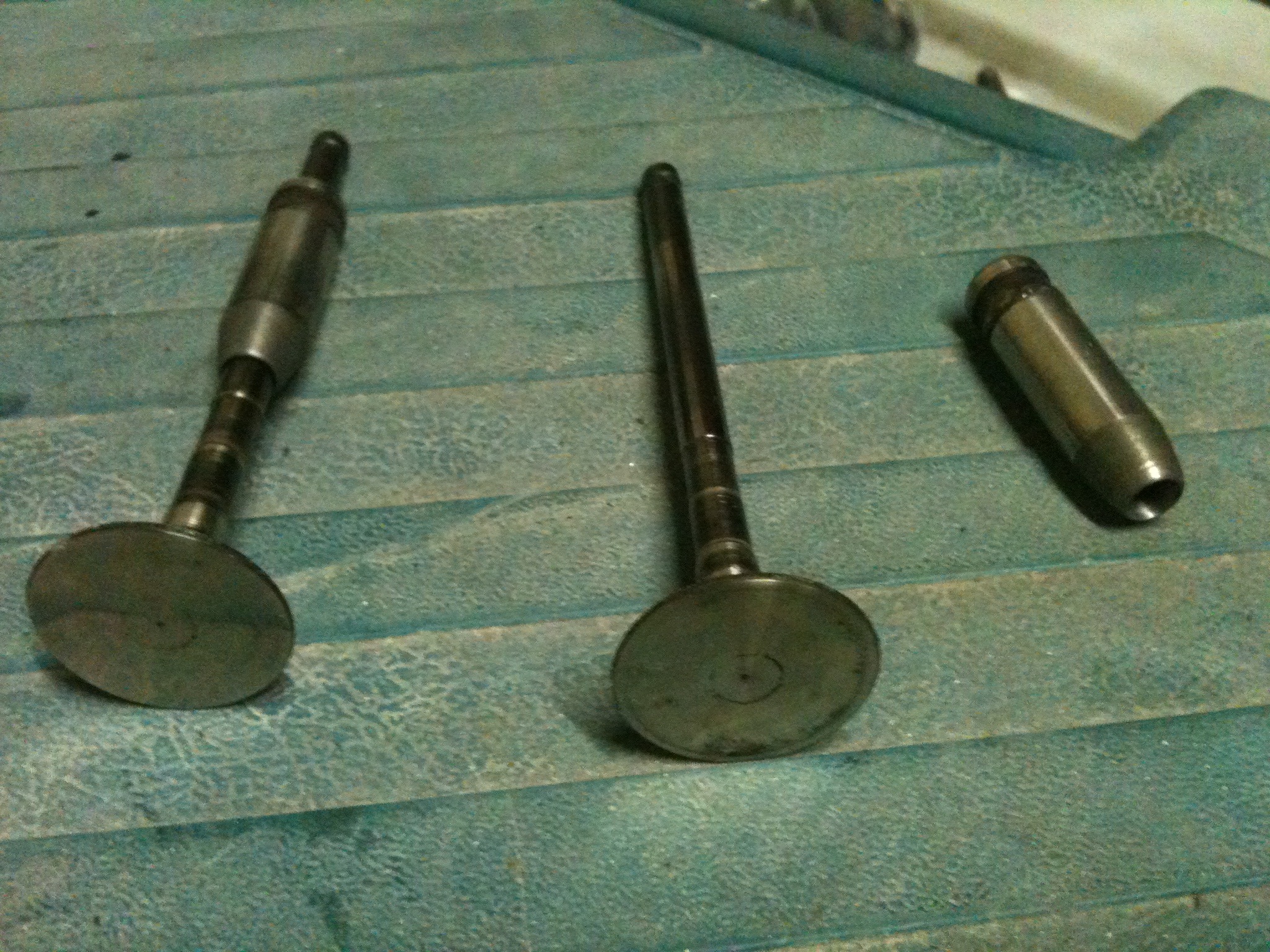

Valve and guide work has been started.

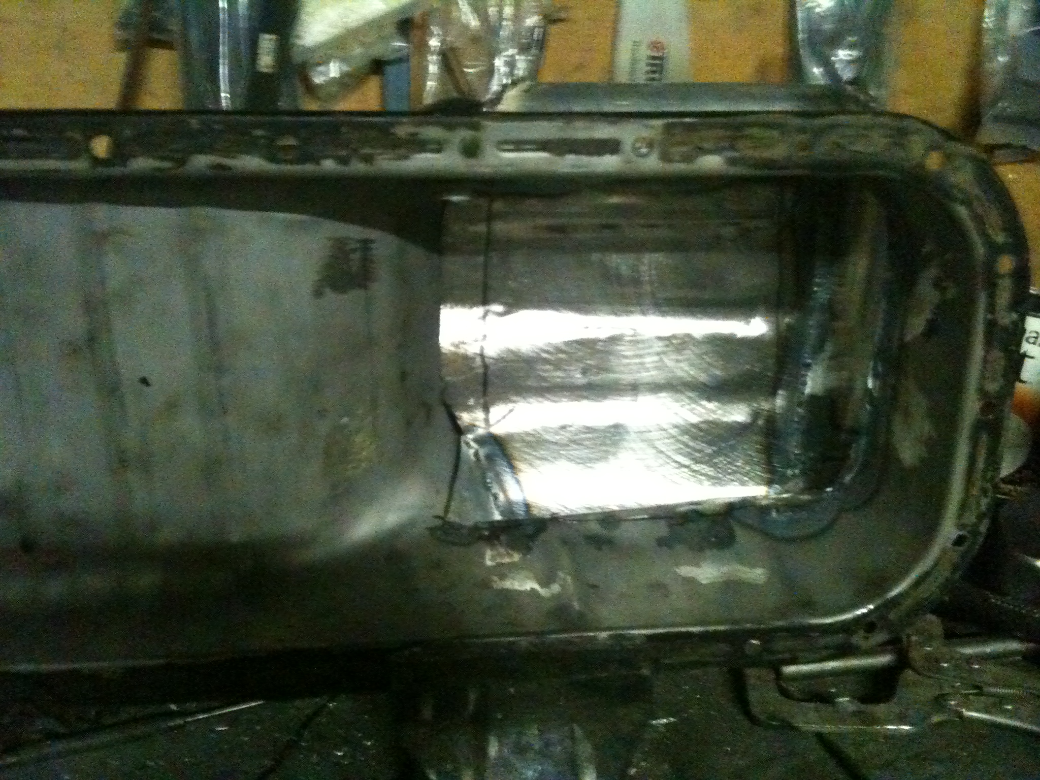

I now have to modify the sump, thought we might get away with it, but when it's fitted to the engine it doesn't have enough clearance between the sump and sump guard.
Needs about 15-20mm, so it'll be reduce the height of the sump and add wings to get the volume back.
I HATE DOING SUMPS!!!

Well the sump mods continue, wings have been added and i'm half way through welding it up.

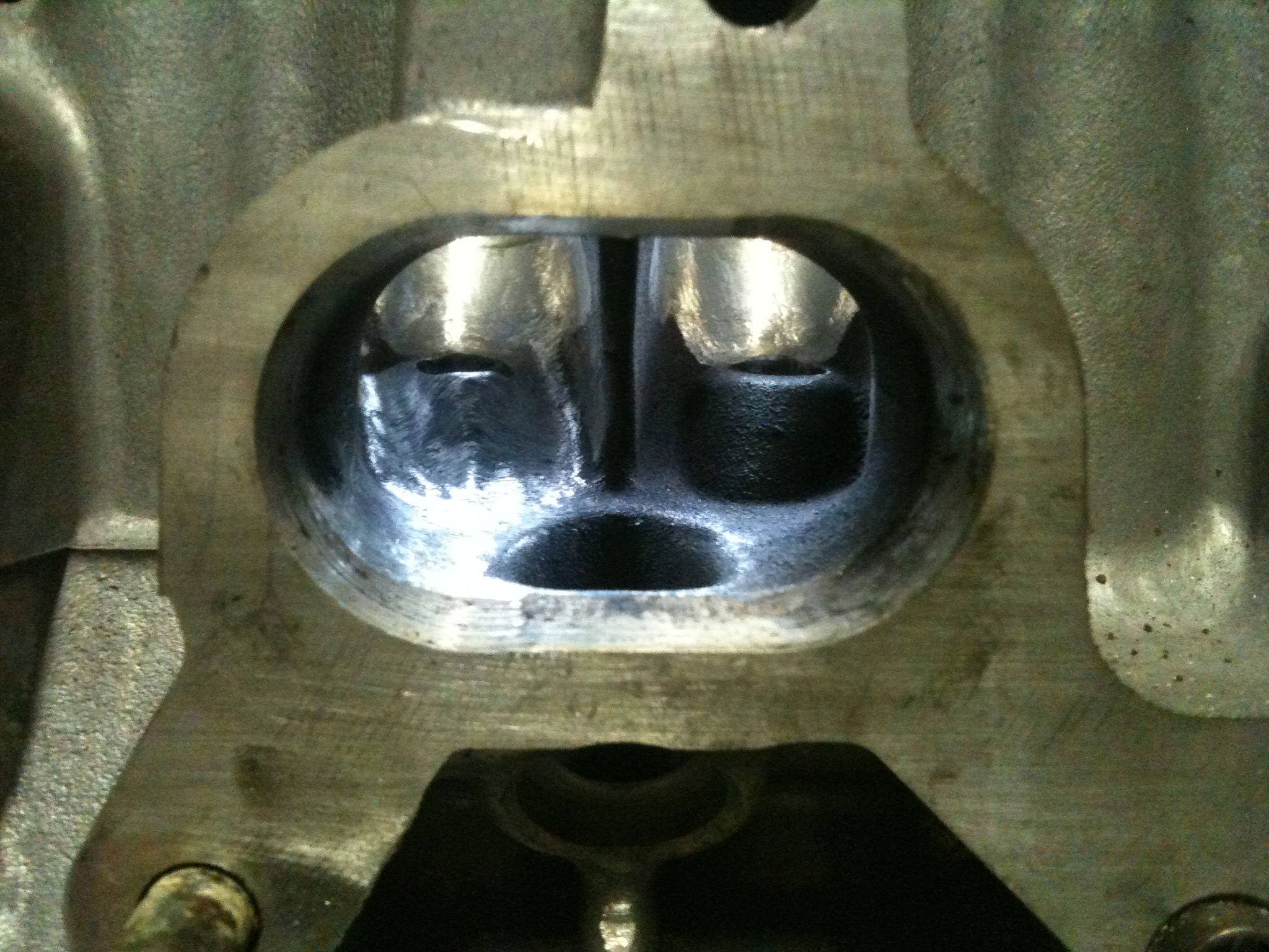

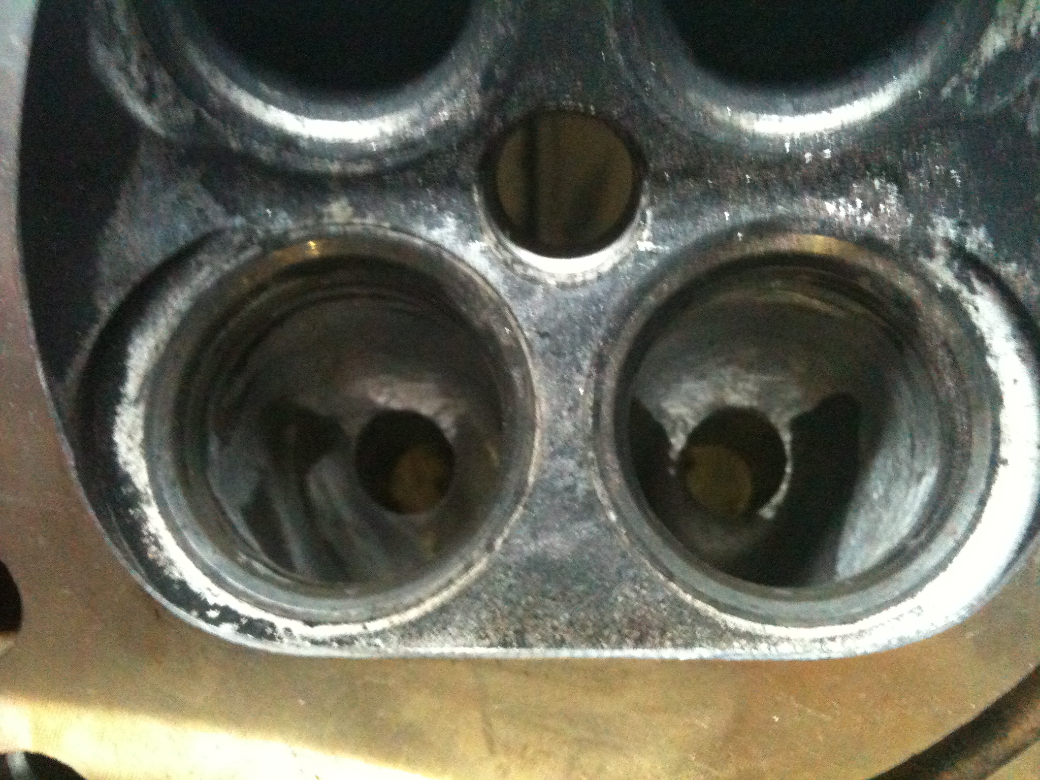

Tony has started on porting the head, after finishing the valves and guides today.

Yeah Jimi, didn't expect to have to mod the sump, but shit happens.
At least we know we'll have enough capacity, and it'll be baffled right.

the dash is just nice and simple, very lite too!!
