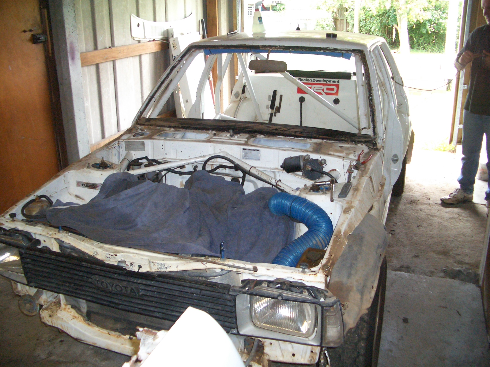

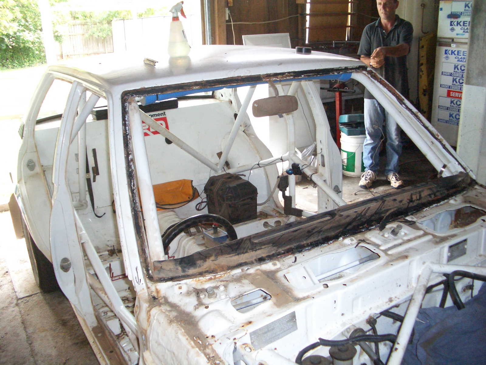

Well we have started on the re-shell today.
first off was to get the rollcage out of the old body shell, off came the roof.
3 hours later we managed to remove the cage in 4 pieces.

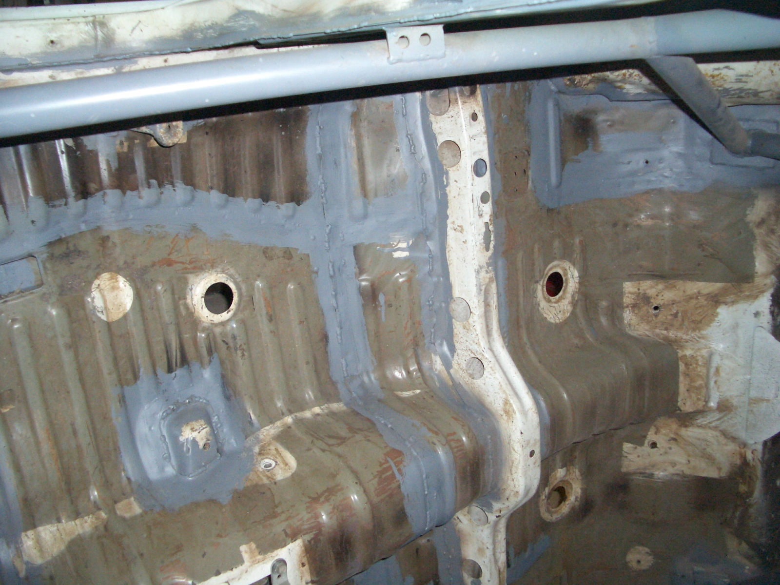

today we stripped the rollcage back to bare metal(weight reduction) cleaned up all the old foot plates, done a little seam welding around where the foot plates are going in the new body shell.
Tony got a lot of the body deadening off the floor and cleaned up some of the seams for welding.
pretty happy how things are going considering it's only day 2.

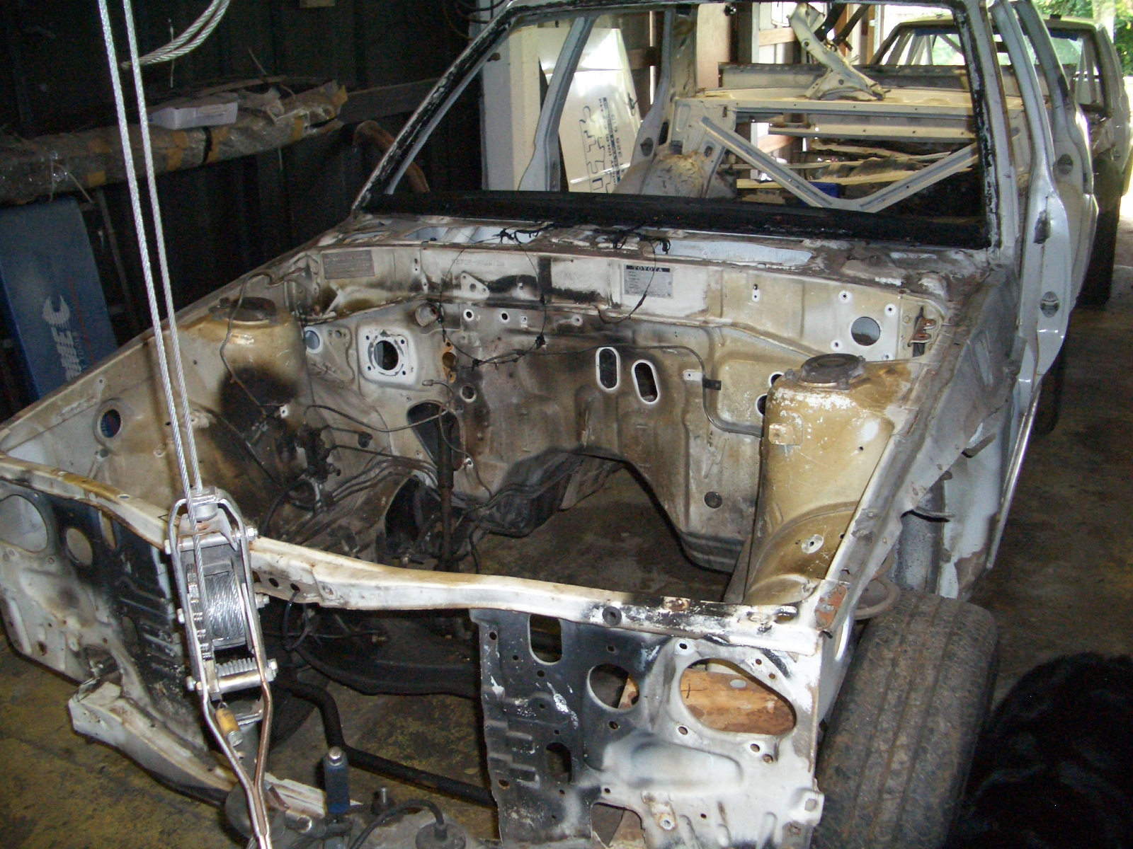

the new shell, if you can call it that.
Body deadening removed from the inside, a little seam welding was done around where the rollcage feet sit, already for the cage to go in tomorrow.

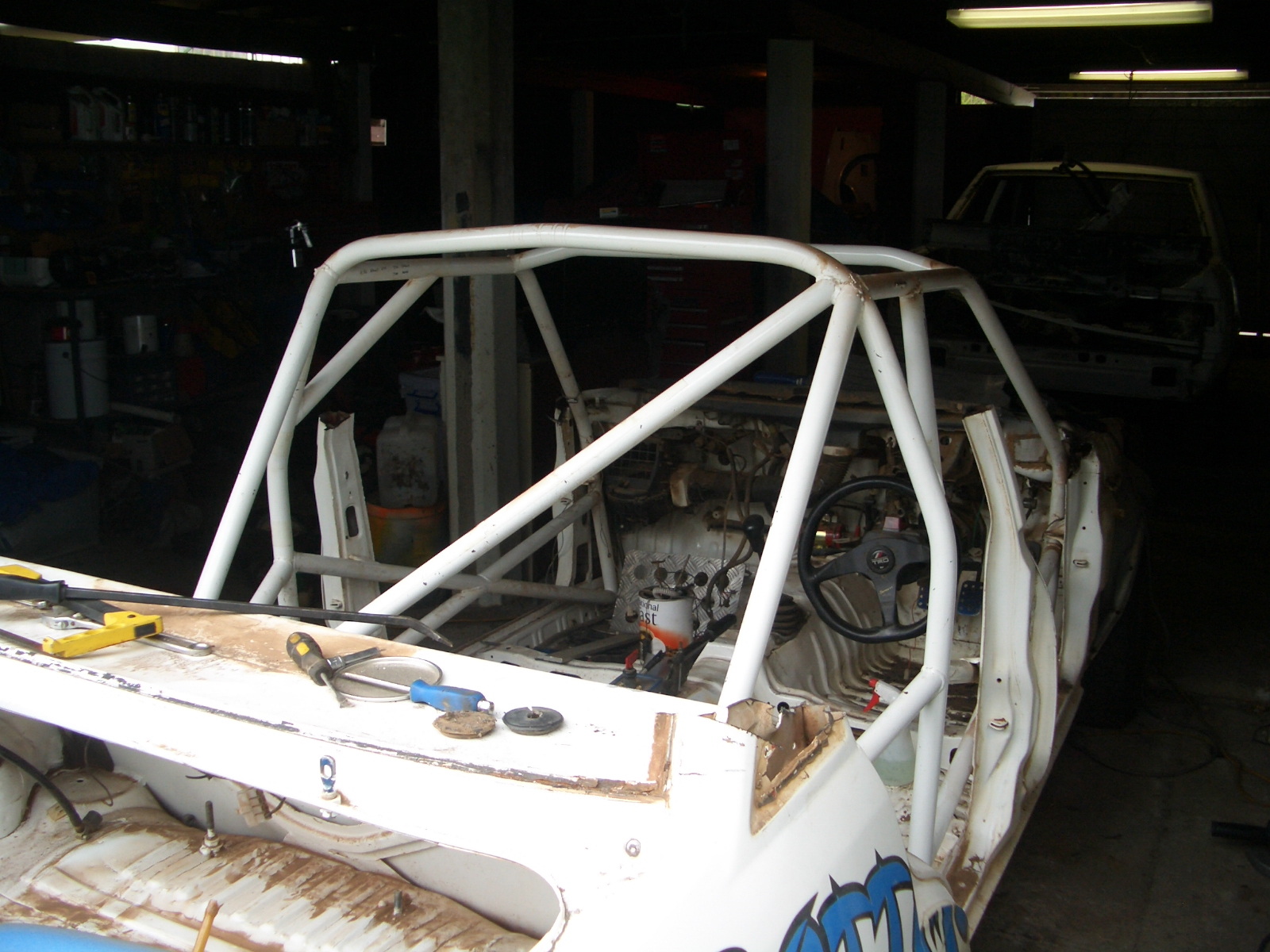

Cage has had all the old paint stripped off it and etched primed.
Edited by TRD ke70
well the rollcage went in today, that was fun.
all the foot plates were welded, then the cage went in, in 2 pieces and welded together and then welded to the foot plates.
Tomorrow we'll tag the cage to the shell and then fit up the bars that go from the towers to the front legs.
If you're wondering what the white stuff is, it's sikaflex to stop and moisture or dirt getting under the foot plates.

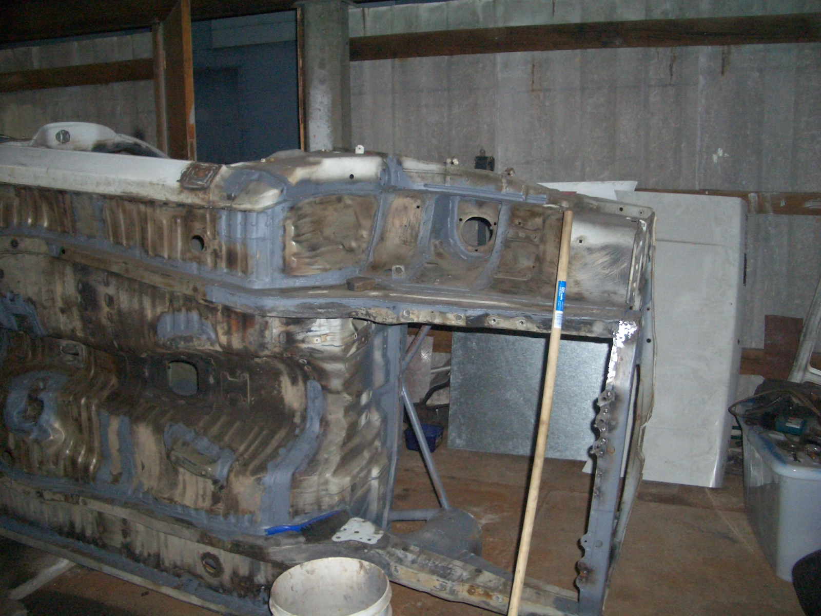

Rust repairs will start tomorrow,which we think will take a little time to complete, then it's roll the shell over and fully seam weld the body.
Edited by TRD ke70
  • 7 months later...
thought i'd update this as it has been a while.
Seam welding is almost done. Once we finished welding the underside, it will be painted and put back on to axle stands so we can start on the body work.
