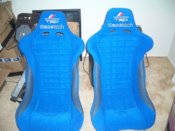

finally got the seats back from the trimmers

The seats look great.

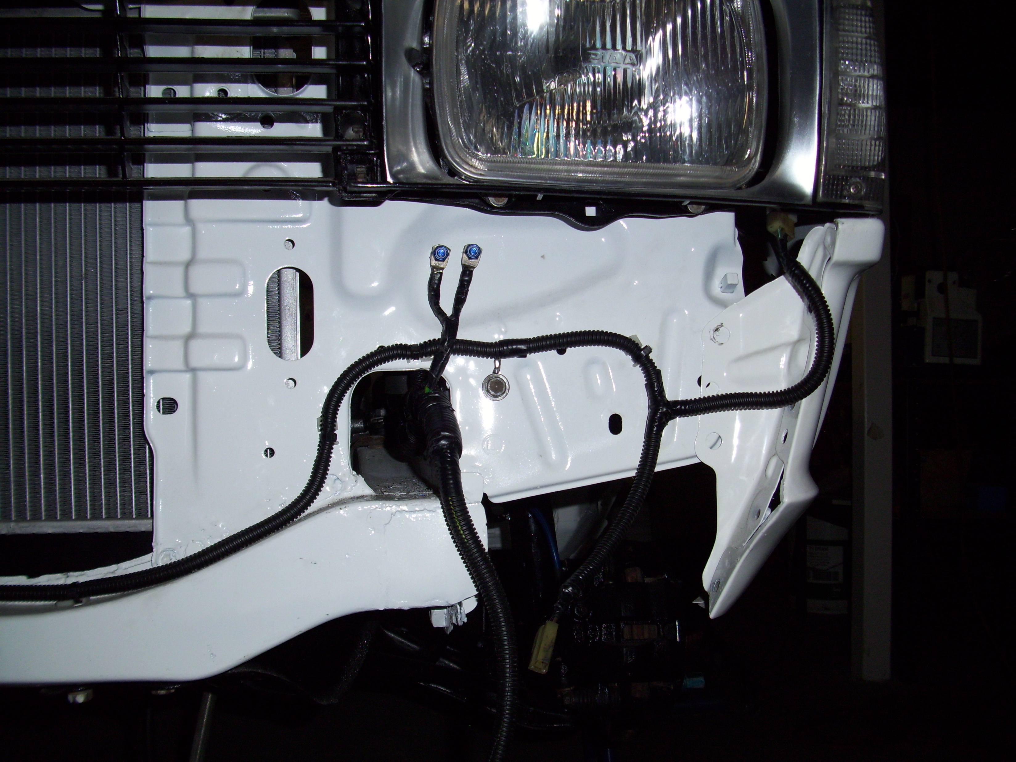

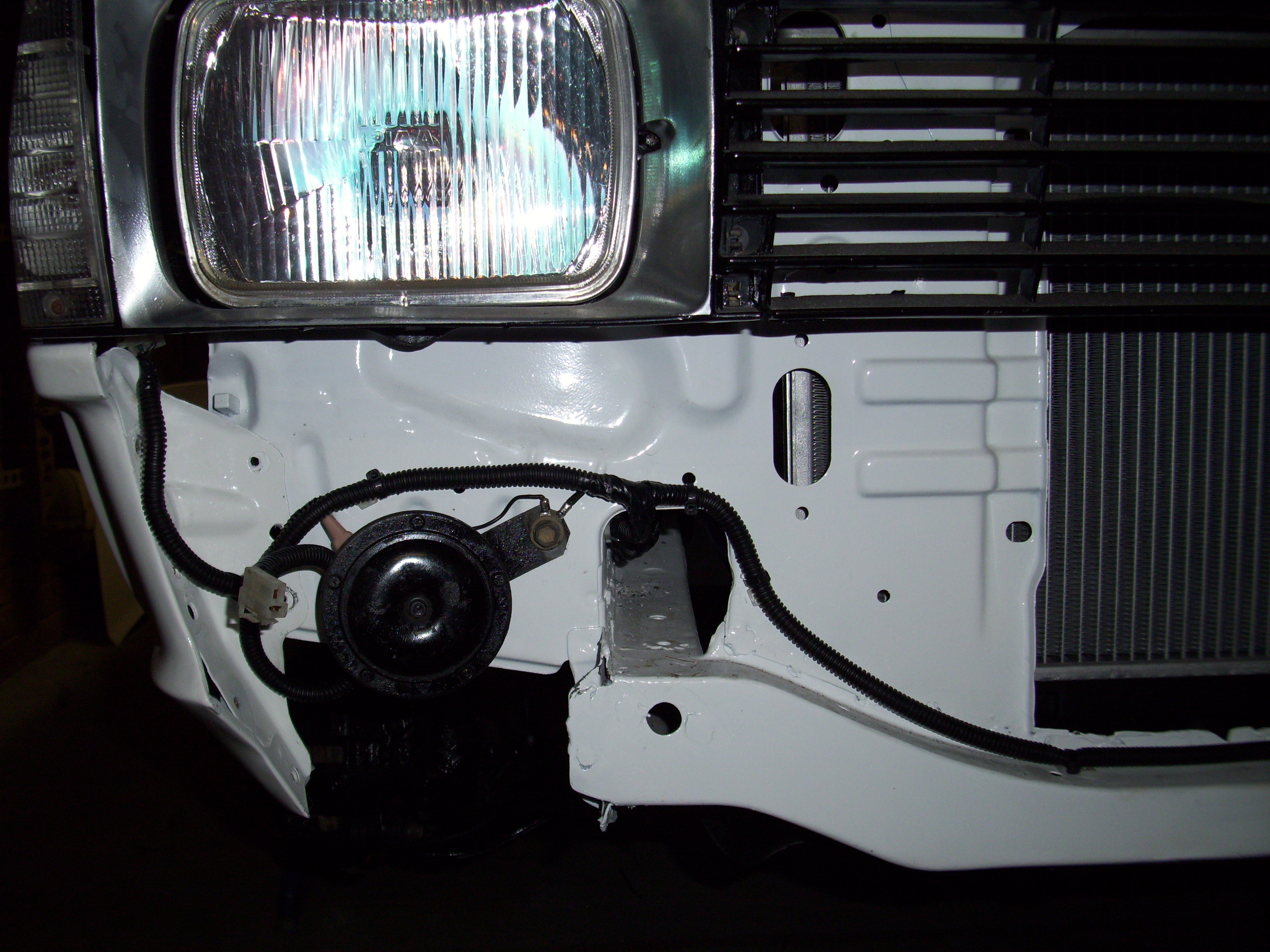

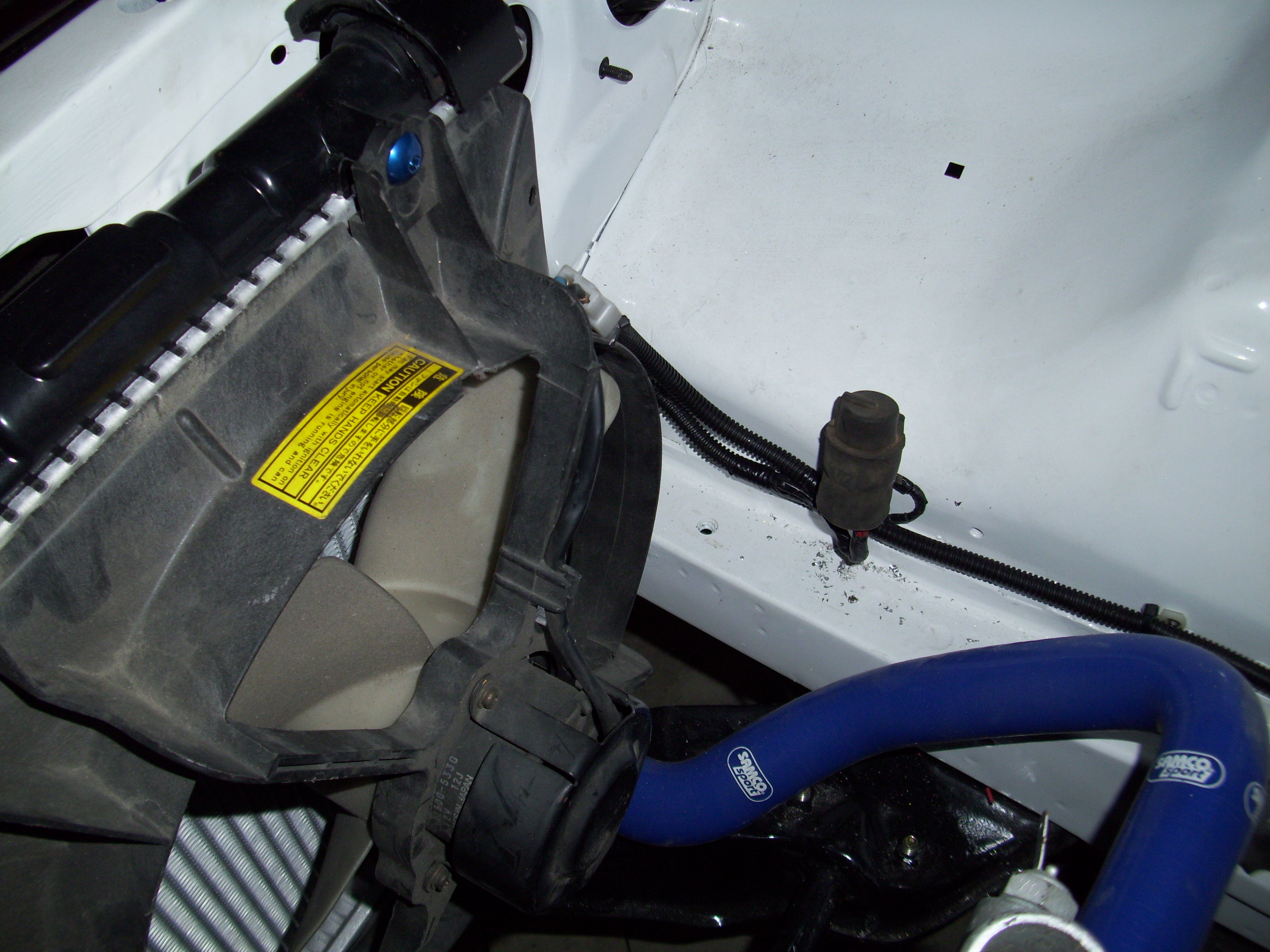

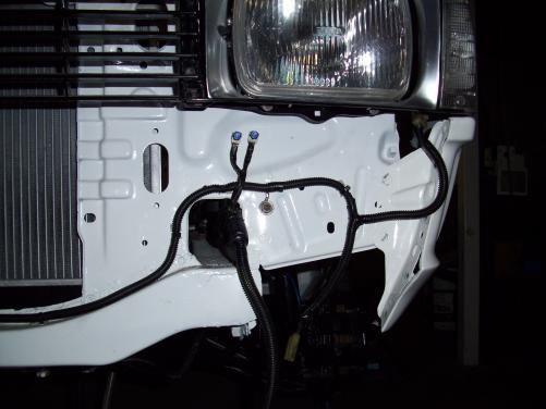

Finished the wiring around the front of the car, which includes the thermo fan,horn,indicators and park lights.

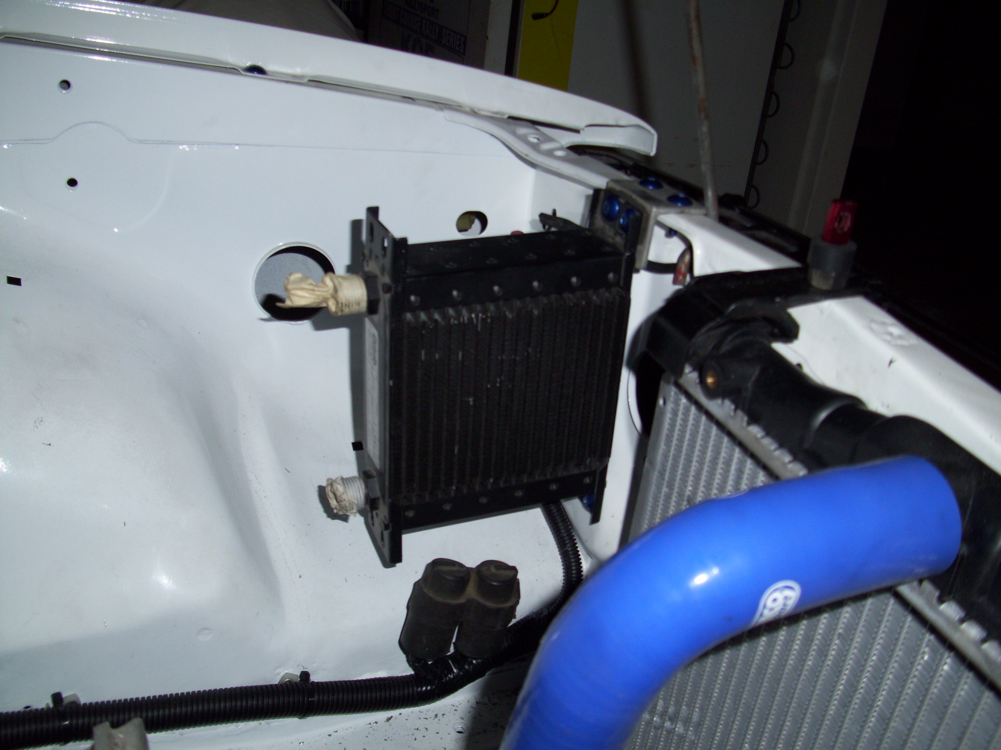

Mounted the oil cooler,thermo fan relay and bolted up the earths for the driving light relays.

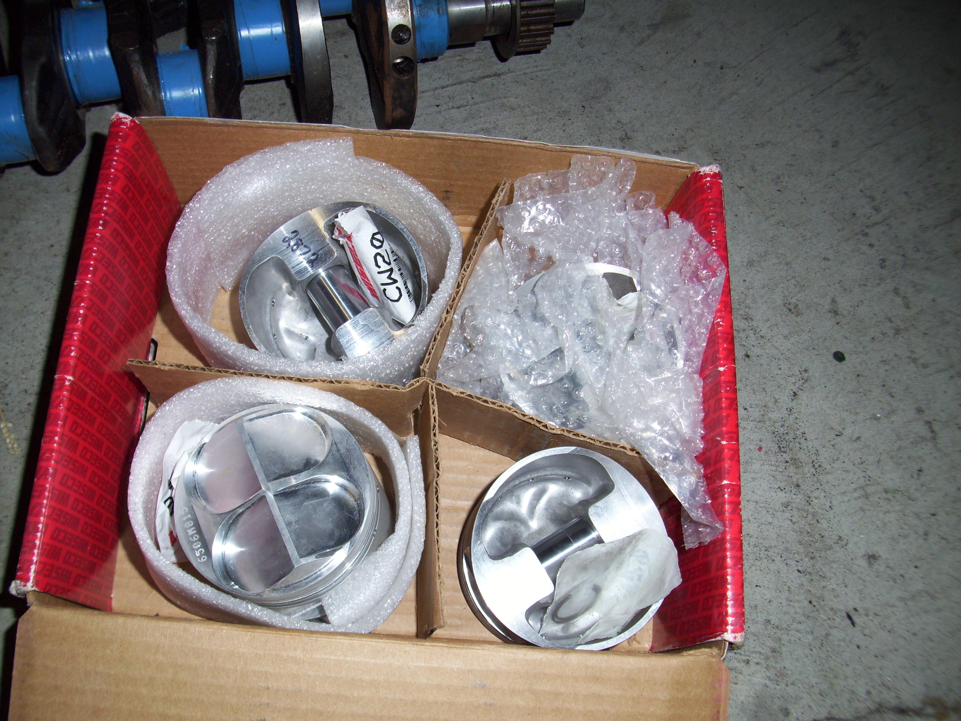

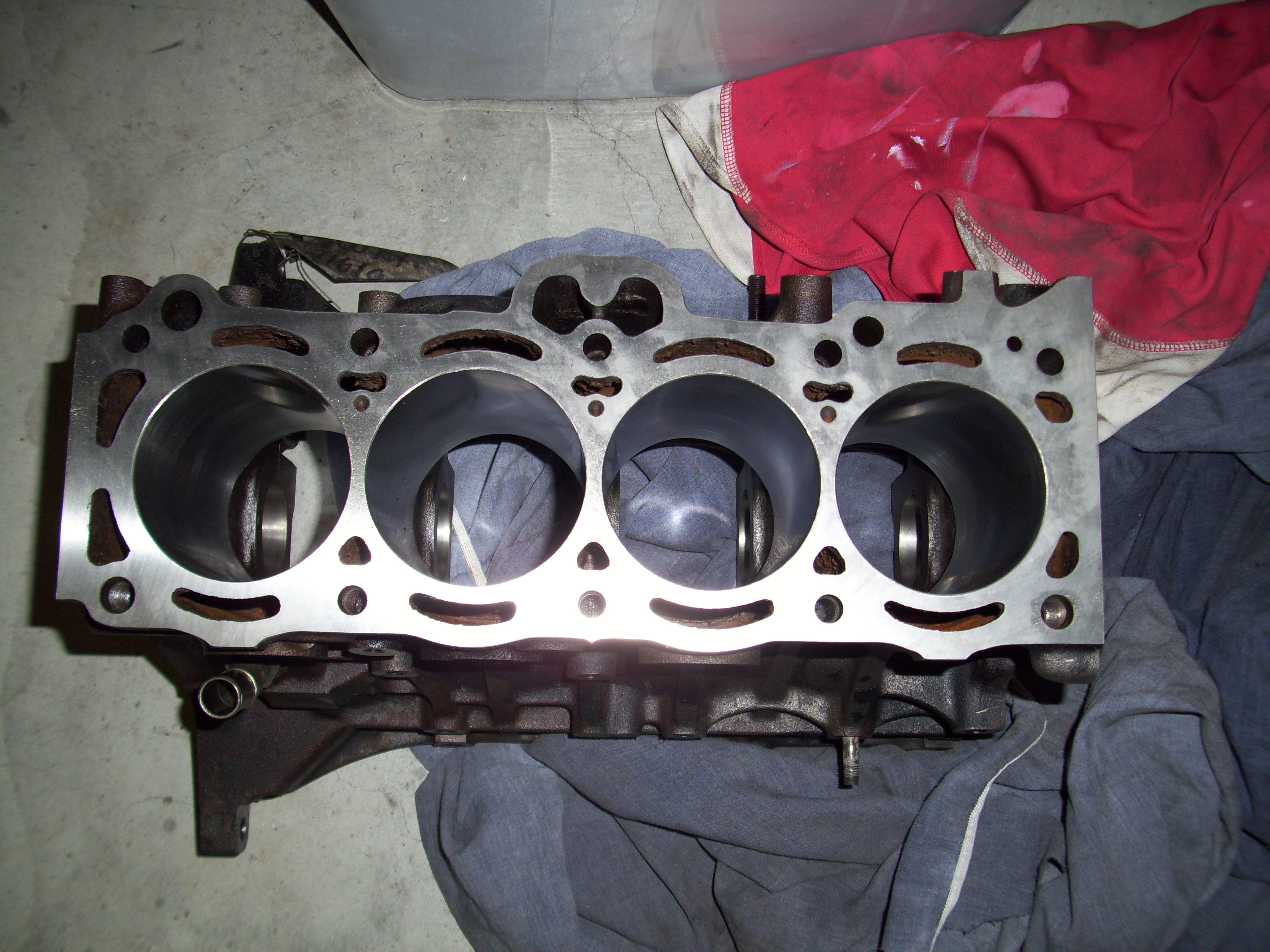

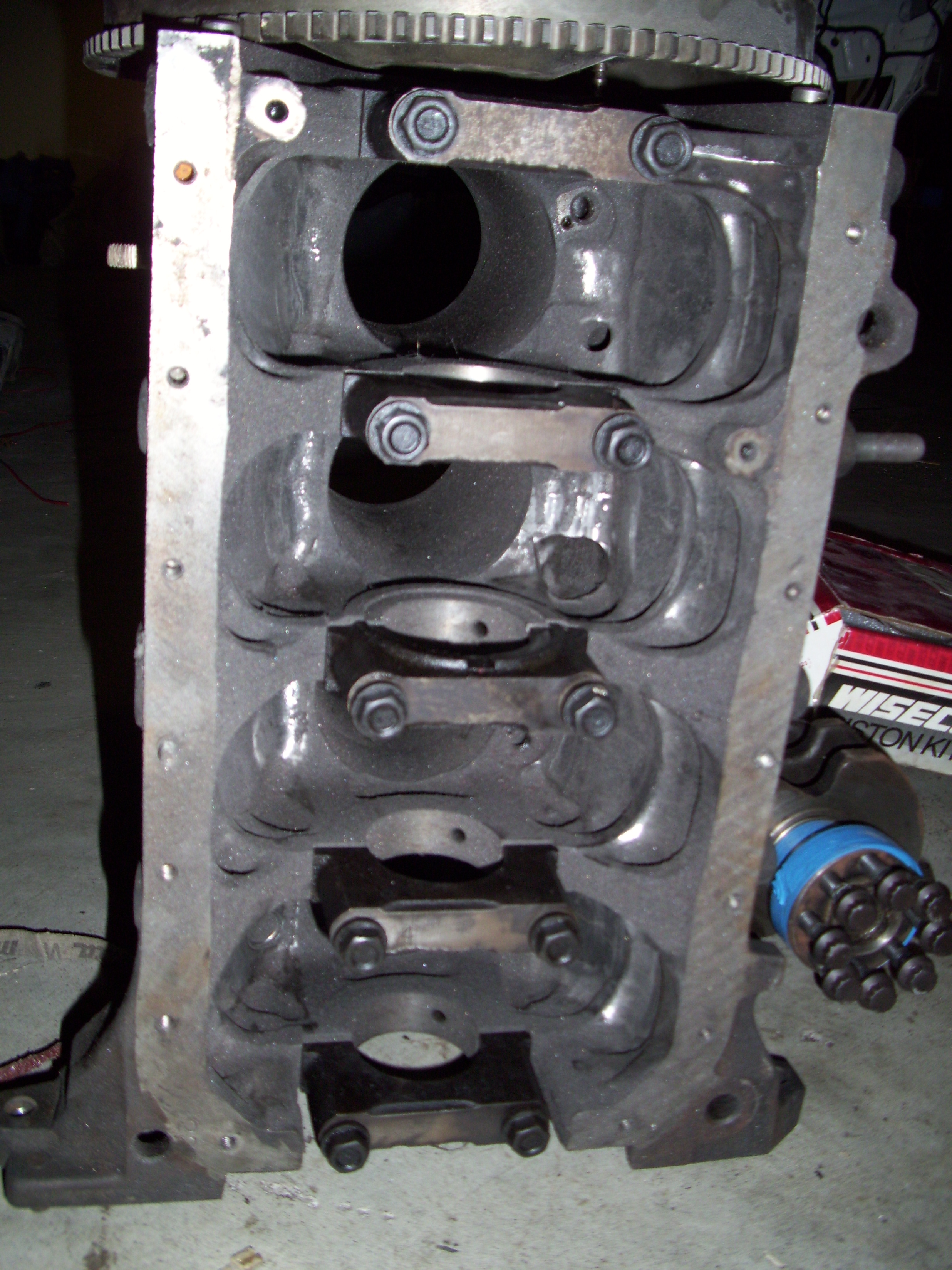

Tony deburred the block all ready to go to the machine shop on Monday,

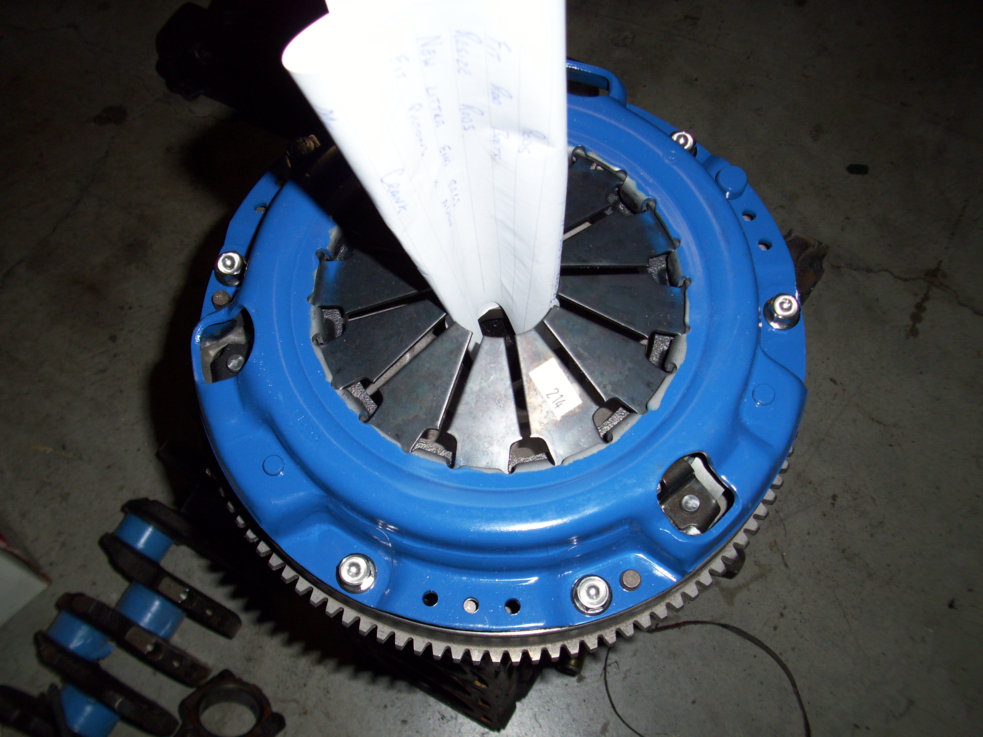

along with the crank,rods,pistons,flywheel,pressure plate and rocker covers(small welding job to be done).
Forged pistons.
Thermo fan relay wiring done!
Pressure plate (mmmm)

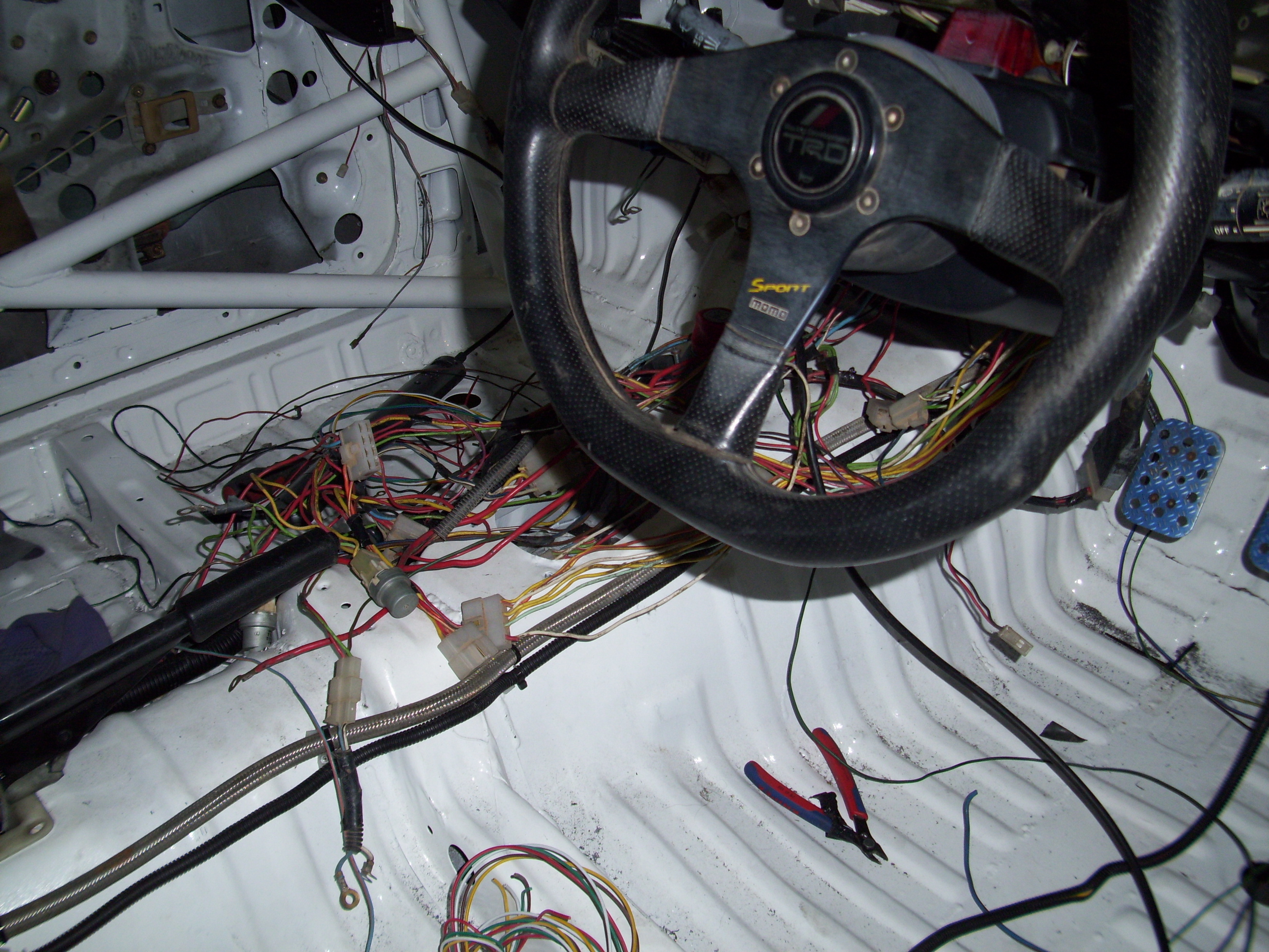

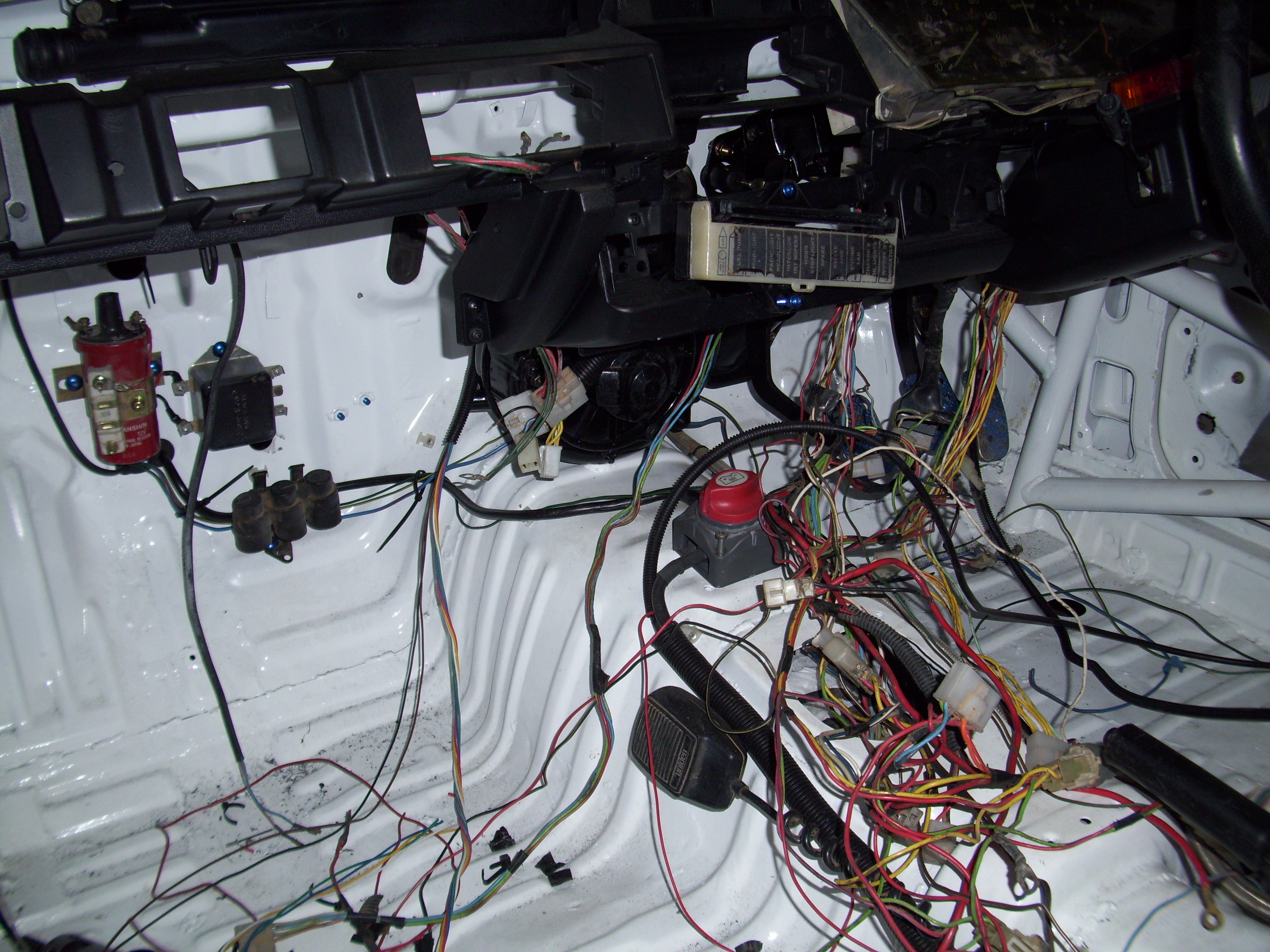

Not much to report for this week, just wiring and more wiring, F**ken over wiring!!!

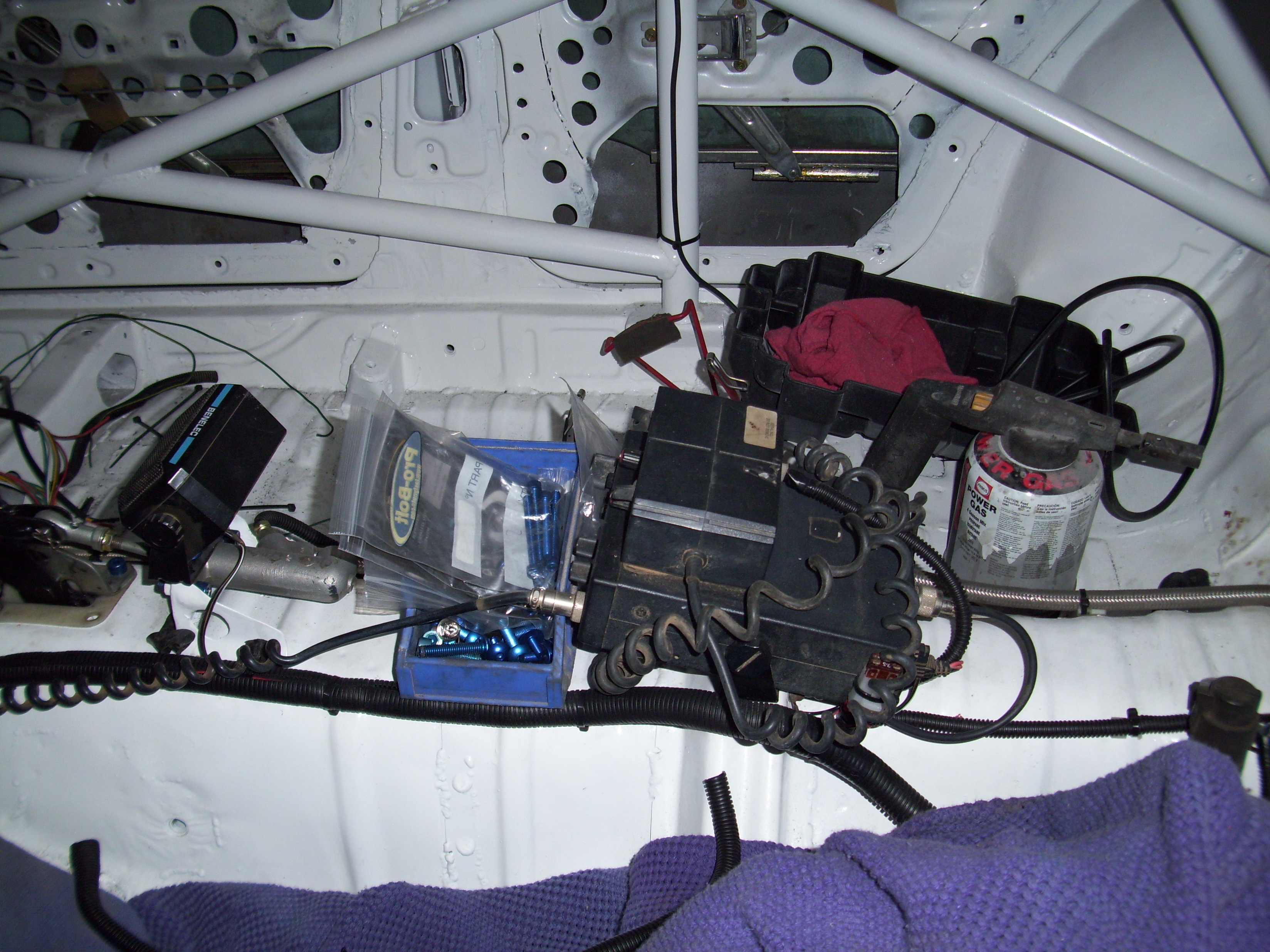

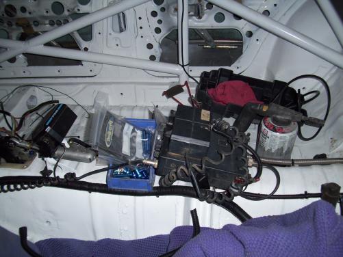

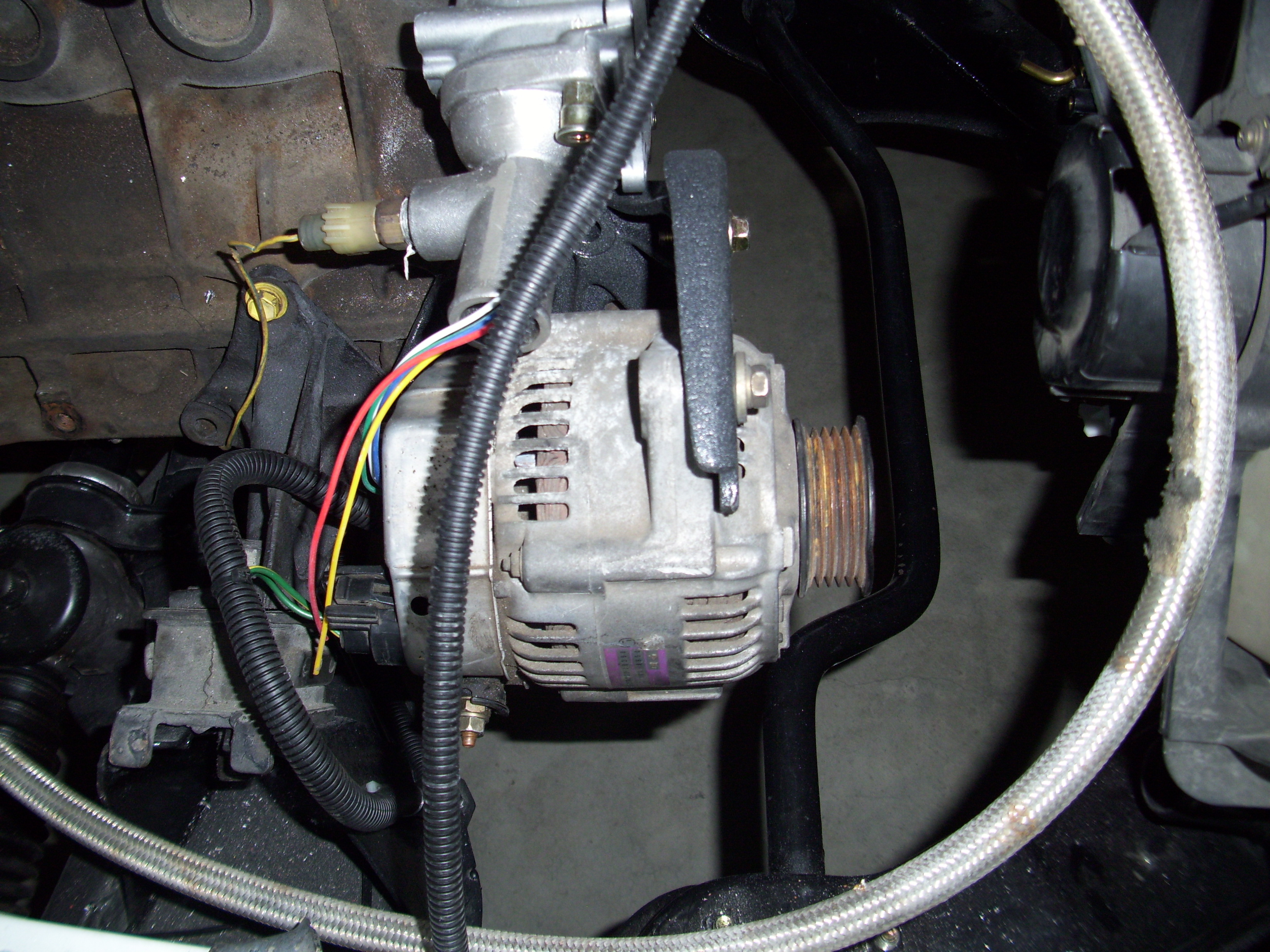

A lot more stuff has been re-installed into the car, two way, terraphone, tail lights are wired, alternator bracket turned up, now just needs to be lightened.
Slowly making my way to the dash wiring.

Alternator bracket arrived and we have trial fitted that.
Two way and intercom are all wired and screwed in.
