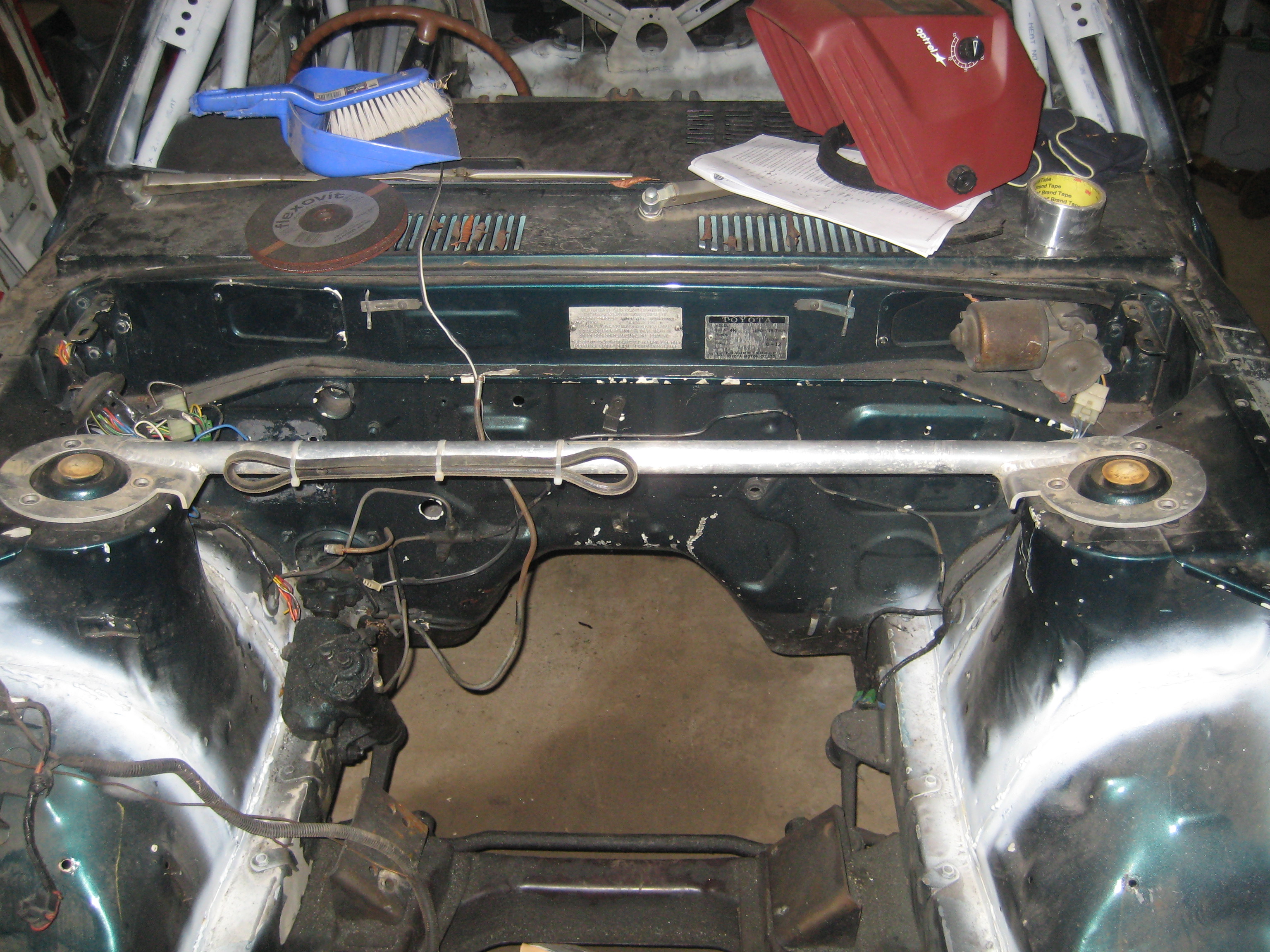

i looked round 4 ages trying to find 1 but i ended up getting my engineer to make up sum plates 4 the strut tops and used an cusco strut brace bar and just welded sum mounts on the plates. worked reali well and cost me stuff all. I'm pretty sure the strut brace i used was out of the rear of a skyline or sumthing.

I made one out of Stainless for my old Bluebird, then we just turned down some endpieces and welded them into a steel tube. I have a left hand thread 12mm tap as well.
Ball joint ends cost me about 12 bucks. I'll see if I can find a pic of it.
