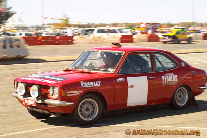

Tis set-up is with 70mm taken out of the back, and 50mm out of the front. Rear springs are a custom pack with inverted eyes, front 225lb springs on adjustable platforms.
This set-up would blow chunks in a daily.
