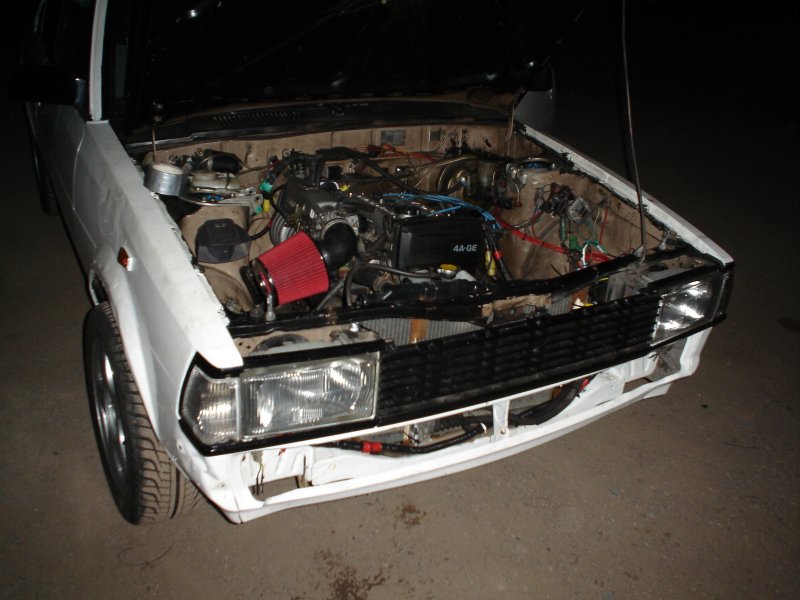

I have some prolems/questions..
what should I do about the throttle wire? the ke70 wire isn't long enough, and the ae86 wire has different mounts in the chassis.. swap only the wire and make new holes for it, or swap the whole wire,pedal etc?
what is the usual and best way to do this?
the 4age-alternator has builtin voltage regulator, how should I wire this? ( my old alternator has an external voltage regulator.. )
everything is not yet fixed, like handbrake etc.. but it's driveable, so I can get to/from work now :D

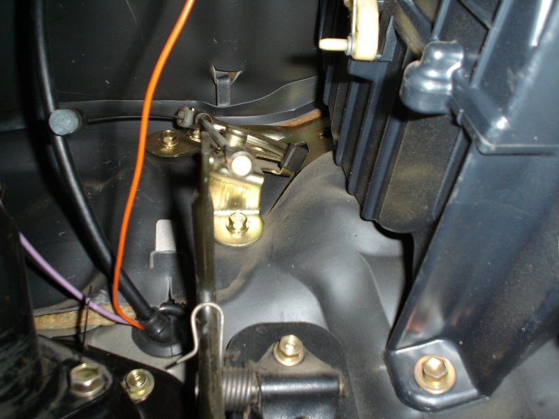

I had some problems with throttle cable, as there is a 'special' pedal linkage in ke70, but not ke20/ke55/ae86 etc..
ke70 pedal linkage :D
ae86 pedal linkage just pull the throttle cable out from the firewall, but ke70 does it sideways..
I solwed this problem by changing the whole pedal over, and make new holes in the firewall

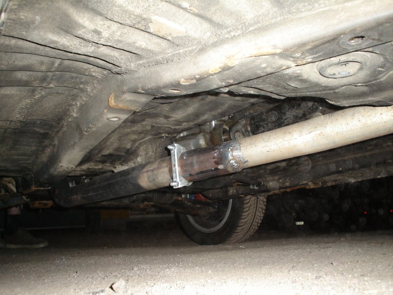

exhaust crashed with the tailshaft, so we had to bend it alittle, about 2cm clearing now when the car is off ground and even more when it's on ground..
wiring diagram for the alternator was a tricky part, since my cables was with different color than my wiring diagram..

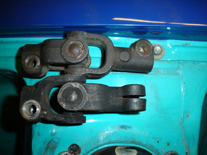

front suspension, rack&pinion, when I changed to the ae86 quaife quick ratio r&p I used the ke70 'steering wheel arm' and the shaft was to long, but I figured out that the part on the photo below has different lenghts.. so if you want to use ae86 steering rack on a ke70, you should also use the ae86 part of this:

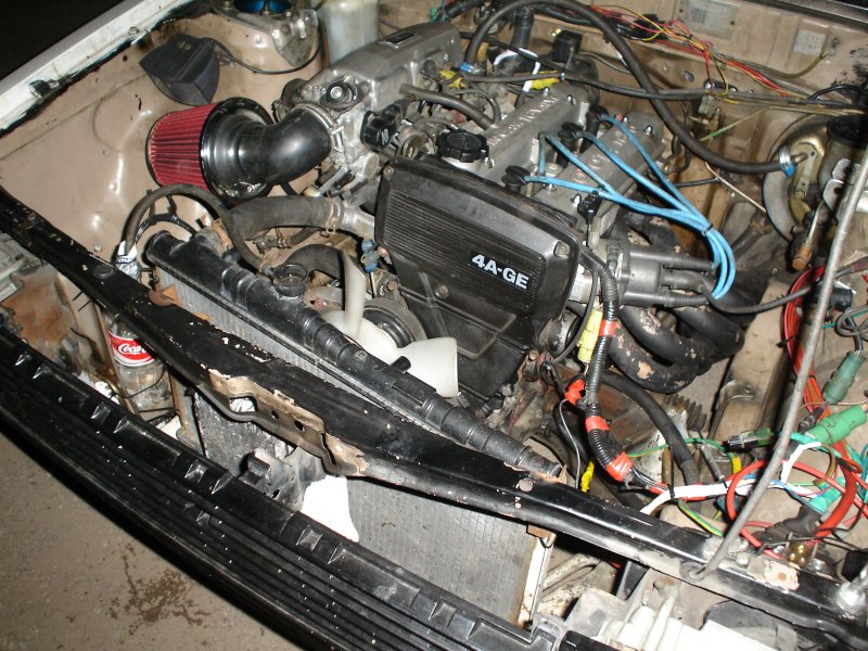

that's the big problems that has come in my way of doing this engine conversion..
and I found out, ae86 gearbox crossmember doesn't fit ke70 with 4age and t50..
I had to use my old gearbox crossmember.. and I could only mount it with two bolts without drilling new holes..
I didn't care about stressing to get ae86 fuel lines etc to fit, so I just bought 5 metres of 10mm and 5 metres with 8mm of flexiable rubber lines that I mounted to the brake line..
Fuel tank sender doesn't work I think.. it's showing half full tank when I filled it full.. and it's abit strange.. so I just drive around with a spare can with 5litres of fuel :D
