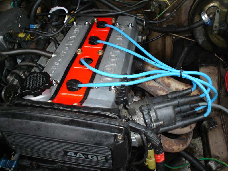

David[RL] Posted July 21, 2005 Author Report Posted July 21, 2005 (edited) progress is going slow it's raining else it's too damn hot to do any work! but I have started removing some rust and painting inside the car there is not much rust, but I want to remove all of it so it doesn't get any worse than it already are I have also mounted the damn nice red part between the cam covers and later I will get the cam covers powder painted black I think, ( not 100% sure about the color ) neat?:abuse: but I really have to do something about my wiring.. so damn ugly :jamie: I also need to secure my air filter alittle better.. it always jumps off when I'm doing a burnout.. the rear wheel are still jumping when I'm doing a stand still, is it suposed to do that? or is something really wrong.. got a bit better after I changed the gearbox mounts but it's still annoying.. if I do a skid on dry road there is no problems with this jumping rear wheels stupid thing :\ ? Edited July 21, 2005 by David Quote

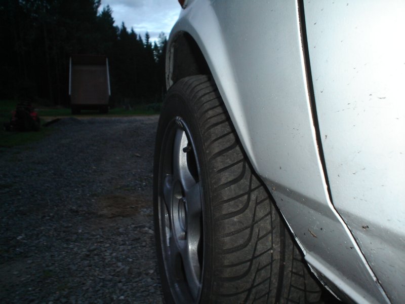

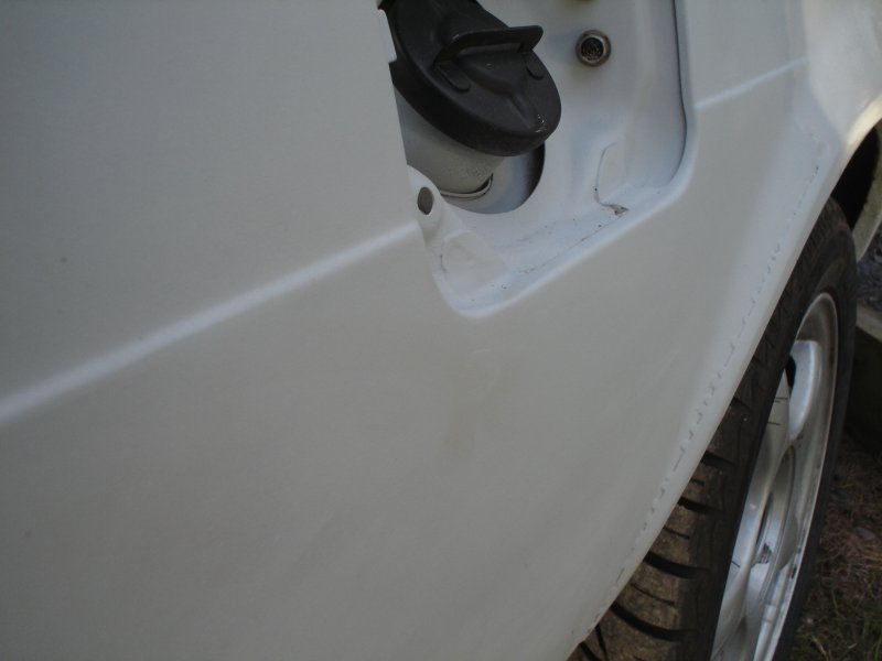

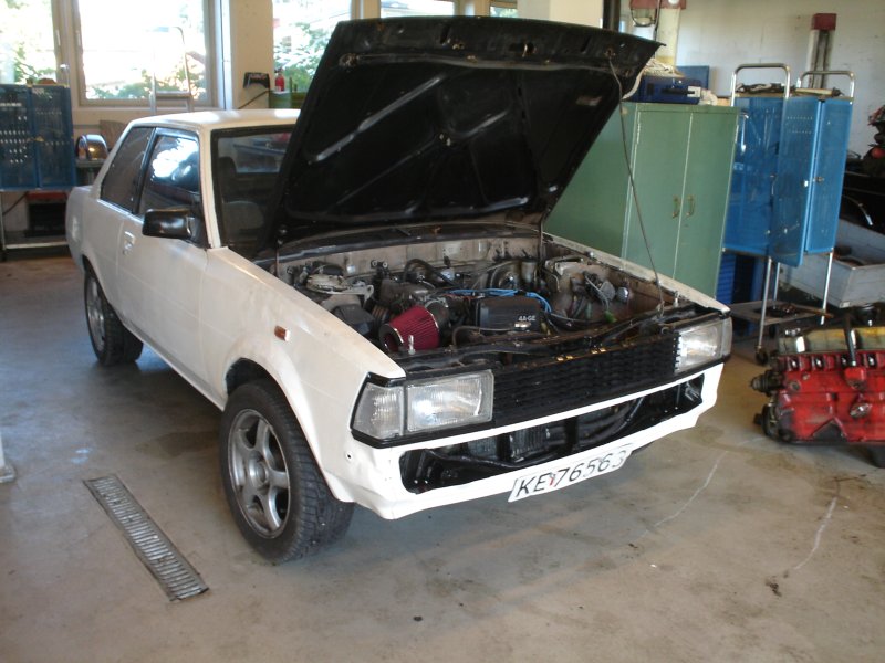

David[RL] Posted August 19, 2005 Author Report Posted August 19, 2005 Haven't really done very much too the car the last weeks except changing the gearbox, to a 20 splines gearbox from my old 2T-B engine, which is also dying very soon :D it's really hard to change to 2nd and 4th gear, and it's leaking a bit oil, so I often have to refill oil.. I have removed some rust, and since they stolen my cd player I removed the antenna, looks much better without it.. I have also painted the car some more, and will do a proper paintjob this time I have also looked at a partcar that will go to the wreckers in 2 months, so I will buy it before then, that one has a nicer front than mine, since I crashed with a bus a while ago#¤% making fibreglass bonnet, fenders etc, and get some flares I'm also gonna buy lexan/plexi to use on the 3 rear windows which one does you prefer? I'm gonna lower the car this weekend, cutting rear springs won't be a problem since they are much stiffer than standard springs, and adjusting front springs.. I really need some flares! and ride height is higher than stock :D removed some rust: Quote

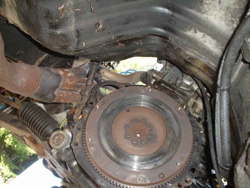

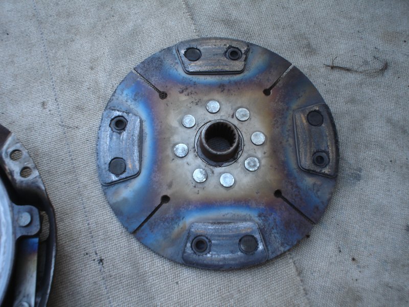

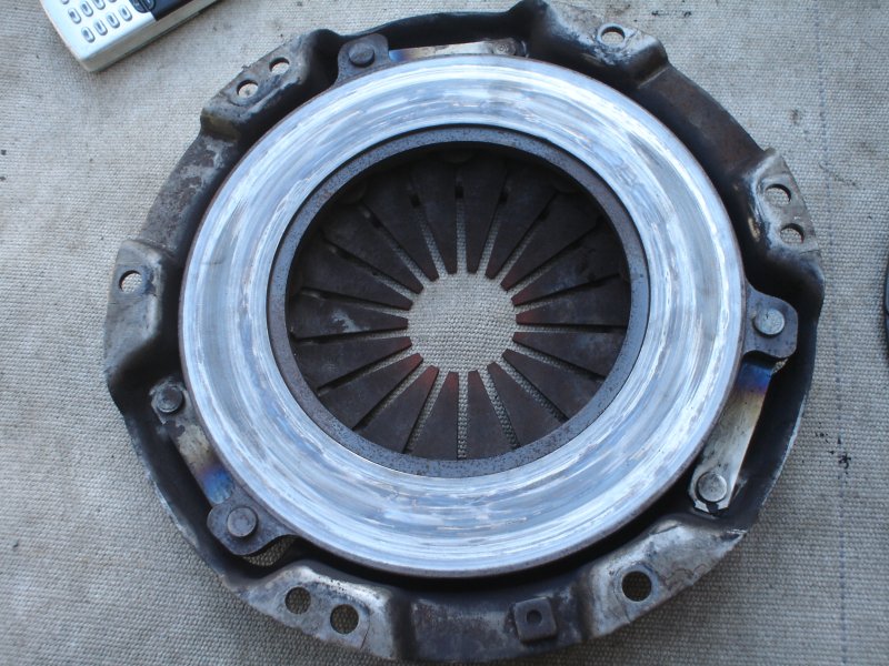

David[RL] Posted August 21, 2005 Author Report Posted August 21, 2005 I was gonna change the throwoutbearing this weekend, and then I checked the clutch.. so I have to ask.. does racing clutches like mine wear out faster than normal clutches? since I have to buy a new clutch, pressure plate and flywheel.. I want something better.. trd 212mm sinter clutch.. I've read that the 212mm clutch and flywheel fit T50 gearboxes, but have anyone actually tested? Quote
Super Jamie Posted August 21, 2005 Report Posted August 21, 2005 so I have to ask.. does racing clutches like mine wear out faster than normal clutches? yes a button clutch like yours is designed for race-only use, where the clutch is never slipped. driving on the street, you are supposed to slip the clutch so you have a comfortable ride and you don't spin the wheels everywhere and possibly run into other cars seeing a button clutch wear out in a few thousand km due to street-only use isn't uncommon. everythis has its' place for street use, get a full-faced sprung organic center with a heavy pressure plate. with this setup, i doubt very heavily that you will experience clutch slip with a naturally aspirated 4ag Quote
