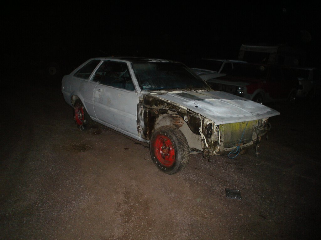

now I've bought another car LOL

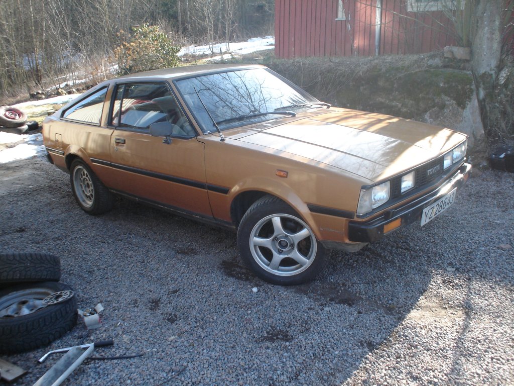

it's a te72 liftback :)
it's imported from USA in 1982.. the car from '80 so I guess it has a very funny diff ratio that is 100% unusable
it got a 3T engine with T50 gearbox, the engine doesn't run, and I haven't really checked out what's wrong with it yet, but it seems that it doesn't have compression..
anyway.. 3T engines wasn't a option here in norway so it's very rare.. so I'm thinking about maybe building a 3T-G and bore it to 2liter instead of the 4A-GE turbo..
the car was owned by a 13year old kid that DESTROYED it ;)
so I'm just going to remove all the parts that's worth saving then send the car to the wreckers so I get my money back

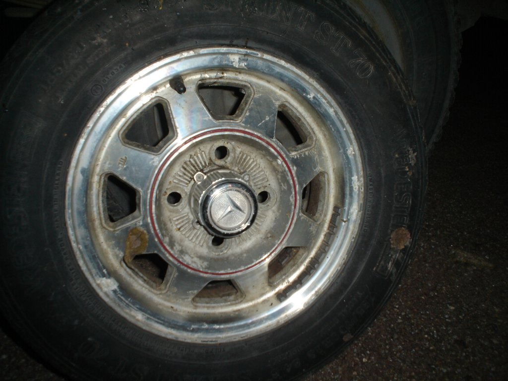

it also had some nice wheels that I'm going to clean up.. does anyone know the name on them??
here's a picture of the ugly car

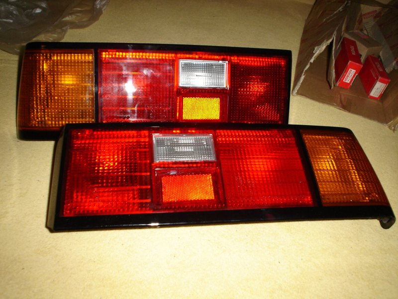

David, I want to buy driveshaft!
And tail lights!
sorry but the tail lights are destroyed by the previous owner and the driveshaft I need for myself

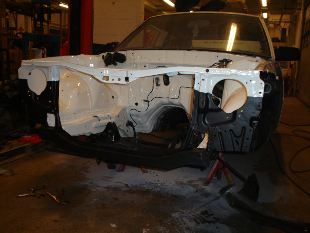

now I got the enginebay in the ke70 painted.. started to fit all the parts again
I did also modify the clutch pedal using te72 pedalbox with ae86 pedal giving me 1-2mm clearance between the brake booster and clutch pump, I had a big problem with the clutch pedal before on my previous setup..
also did reinforce the firewall with a 2mm plate around the clutch pump..

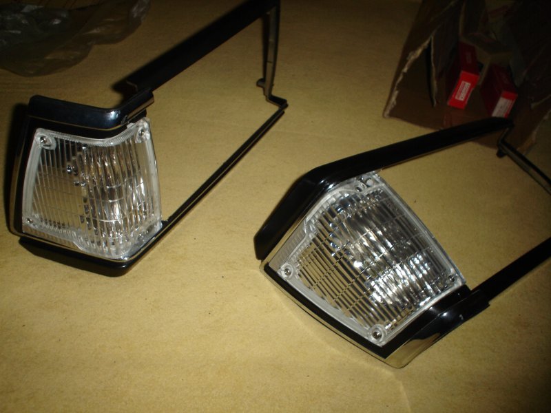

also got new lights

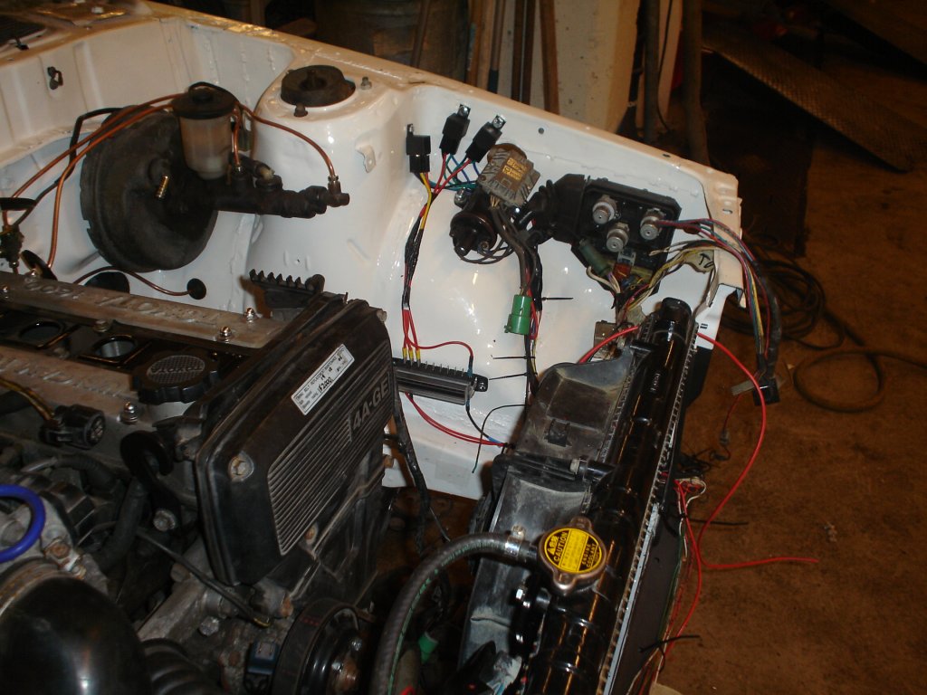

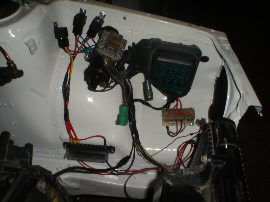

almost all electrical is going to be rewired

small update:
more wiring.. hehe.. still alot left..

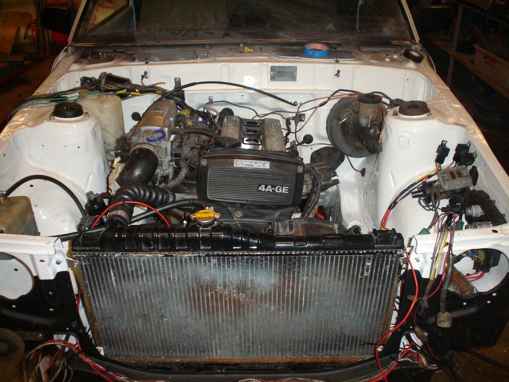

now I'm 99% finished with the wiring.. only thing left is to connect tachometer, etc

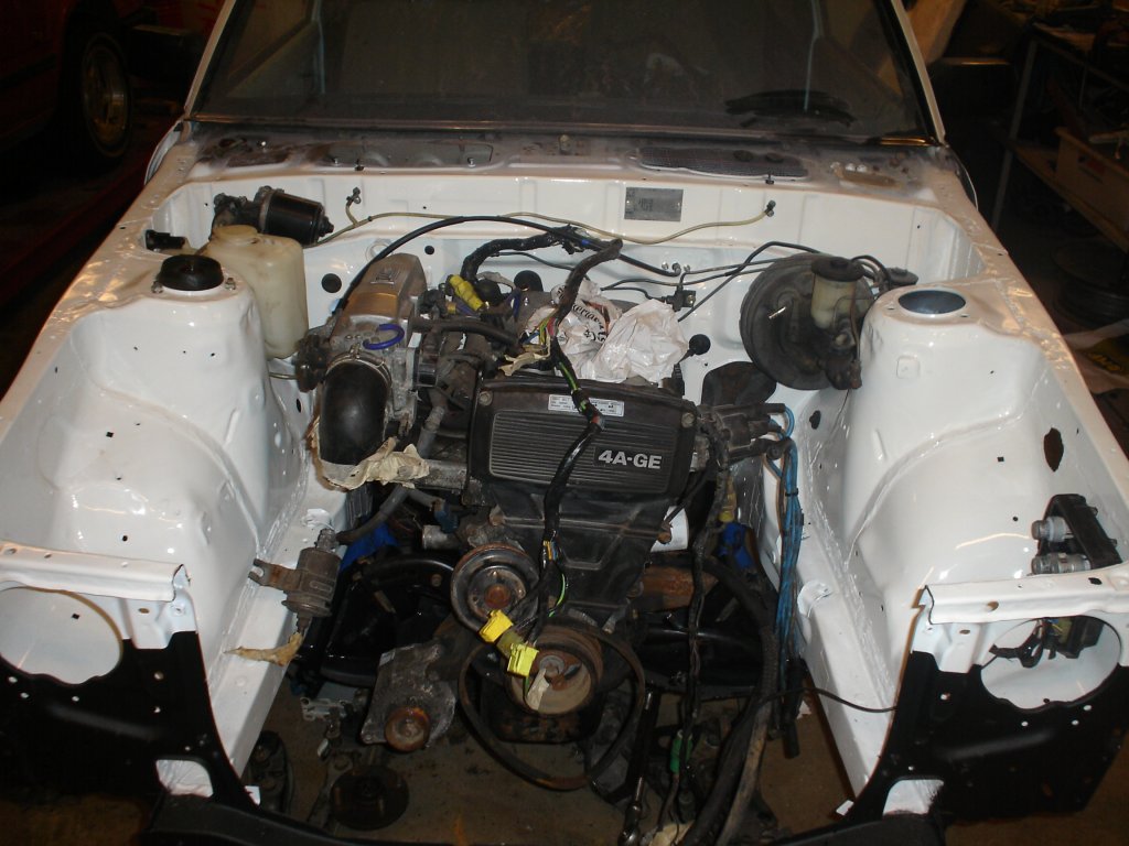

but the engine is not 100% straigt.. you can see it on the picture below..
the engine is mounted up perfectly but don't know why... crossmember is correct, engine mounts is also correct..
I know the engine is supposed to leaning 5degrees to the left.. but this is more like 7degrees+++

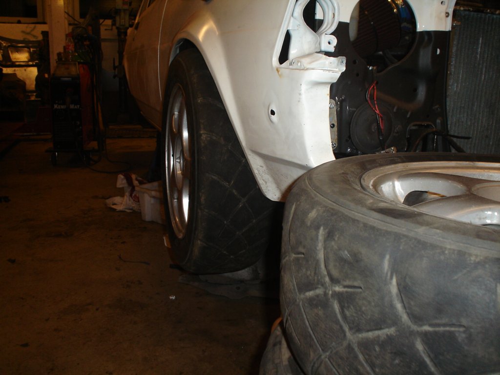

also I need to use some flares.. I think I'm going to buy some fibreglass flares on ebay that are 7cm wide.. ( stock is 4cm )
as you can see on the picture the wheels are sticking alot out.. and they are mounted without brake discs.. so it will stick out 7mm more
so if I buy those 7cm flares I will have under 1cm clearance..
