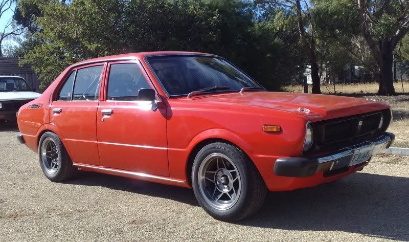

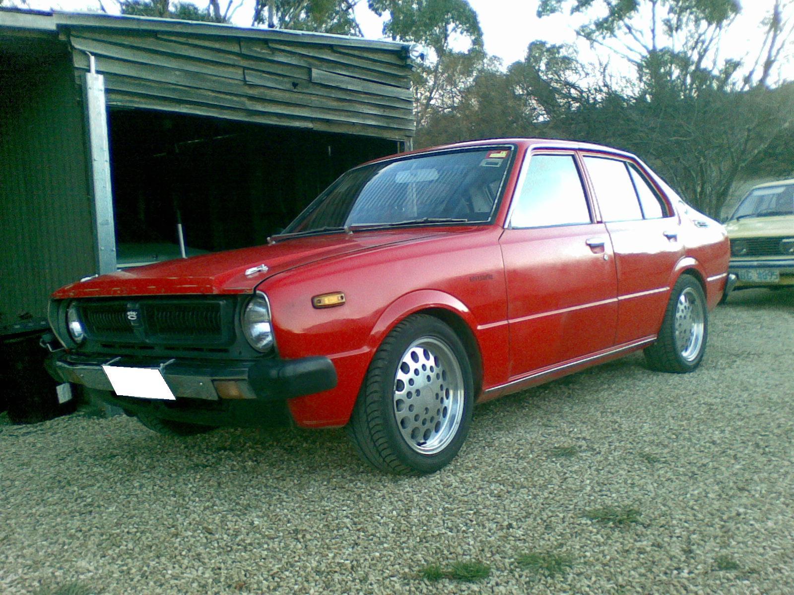

hey guys i brought this car a while ago but have pretty much rebuilt the whole car since. was just your average ke30 with a v6 and supra 5 speed fitted.
i have since repainted the car fitted a vr commordore diff 4.11 gears and spool, welded in cams approved cage race seats and harnesses, full adjustable suspension and nolathane bushes,

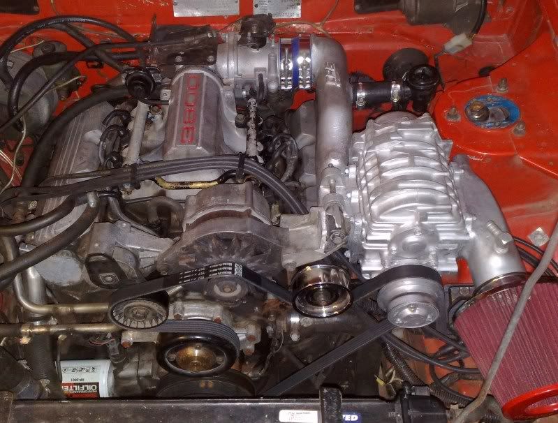

changed the wheels to 14x7 globes(street) and 14x61/5 longchamps(track). engine side of things it was stock but now has 70mm tb, sc14 supercharger (8psi) bigger injectors and computer to suit and a set of custom pipes are on there way to help it breath.
first pic is the day i brought it the others are when i finished it.

Looks really clean!
Please tell me you kept the pepperpot (sigma) rims :P
sounds like you've transformed the car into much better all round combo, keen to see pics of how the car is now
Looks good have you had it tuned if so what sort of power did it make

no havnt had it tuned and not much point really as the tune is in the computer just got to put it on the rollers to check the air fuel and i will give it a power run at the same time

BTW, is that one of those Capa/Castlemain SC kits?
Doing the same thing to me. I'll quickly upload them to my photobucket and link them. :P
yeah a castlemain kit havnt driven it yet waiting to get my axles back
