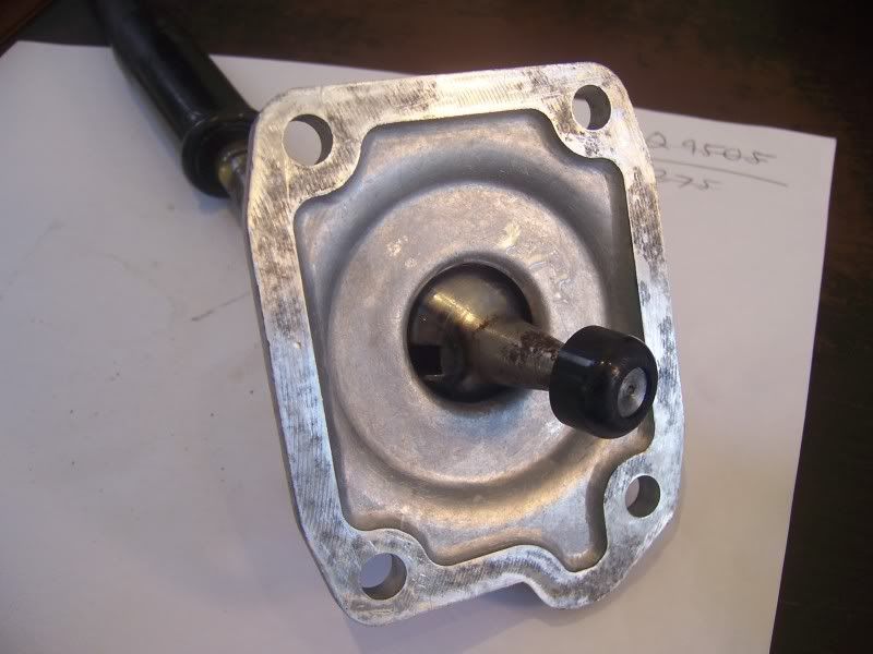

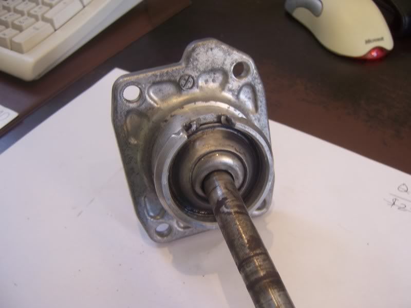

anastasios Posted November 25, 2009 Author Report Posted November 25, 2009 Ok should I grease inside the shifter ball? Or does oil go into this from the GB? Quote
Taz_Rx Posted November 25, 2009 Report Posted November 25, 2009 No oil up there, so yeah a bit of grease wouldn't hurt. Quote

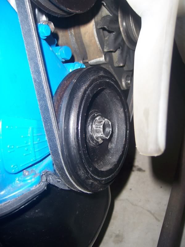

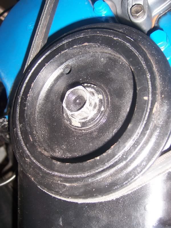

anastasios Posted November 26, 2009 Author Report Posted November 26, 2009 (edited) Ok here are some pics of my pulley, there are no visible notches on it on either side, which is really strange. If my valve train shows TDC, do I then mark it on the pulley? Also what is this on the rock mean, does it mean that both 4th valves are closed? Edited November 26, 2009 by anastasios Quote
Felix Posted November 26, 2009 Report Posted November 26, 2009 the valves for no4 will be on the rock (ie. exhaust closing, inlet opening). Quote
anastasios Posted November 26, 2009 Author Report Posted November 26, 2009 Ok so do I now make a mark on the pulley at zero? Quote
