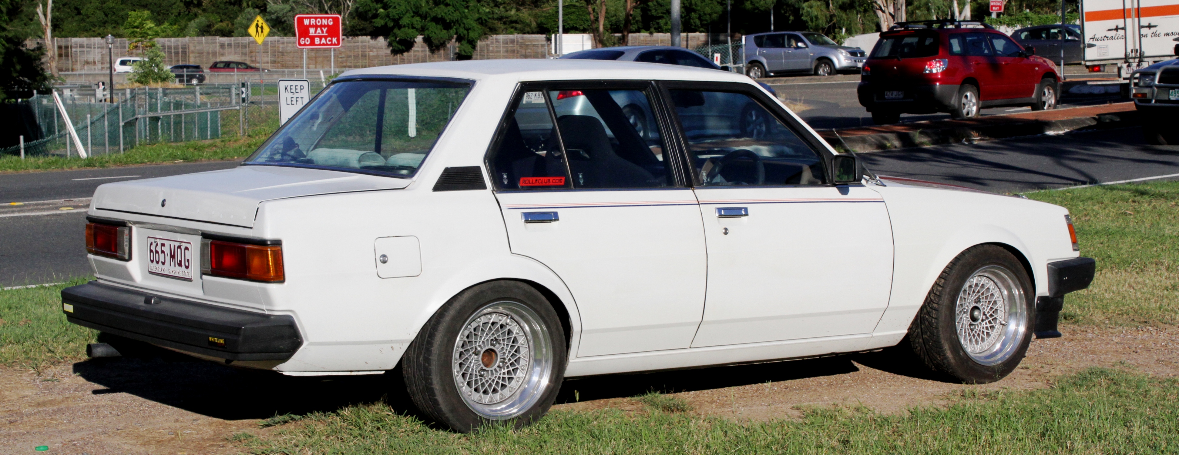

  • Did anyone else pick the irony in this photo?

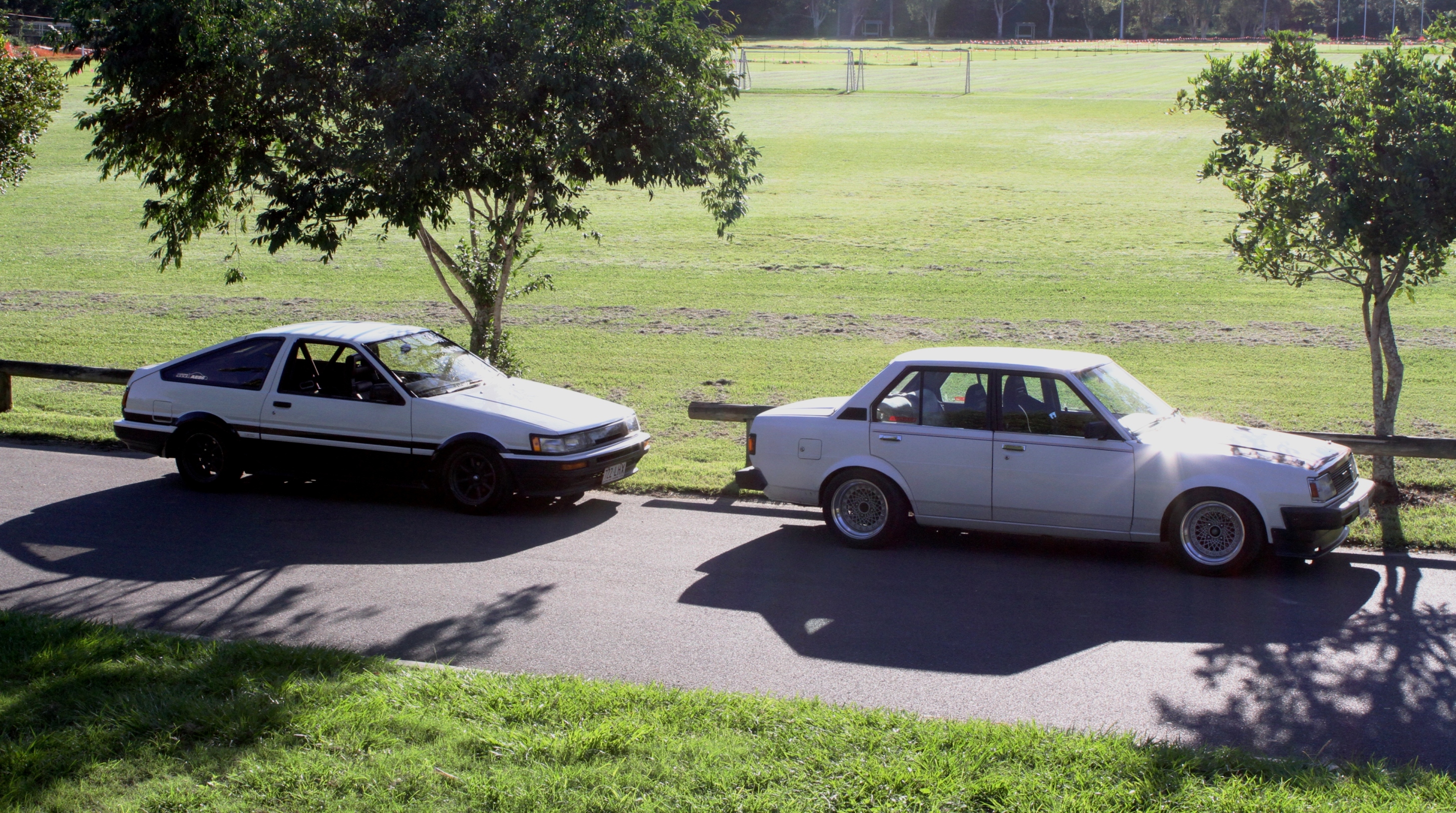

I took a long drive in the country today, did about 400 k's.
Sadly I went for a short drive after I got home and the diff started to get loud. Knowing what I know about failed diffs, its a bearing problem and will be fixed asap with no further use of the car till its done. The lucky thing is I have another diff lying around that is supposed to be a rebuilt one, I just don't know the ratio. As the pain men say, theres only one way to find out. Ill probably fit it tomorrow then pull the centre out of the noisy bitch and send it to the shop, to be rebuilt with my spare 4.5:1 cw&p and bearing set. I knew I bought them for a reason. The Ill probably sell the 4.3s or fit them to the spare diff if the ratio sucks when I swap it over.
geeze that 86 looks fine...! i also partook in a country drive saturday which resulted in a raging case of truckers arm.
