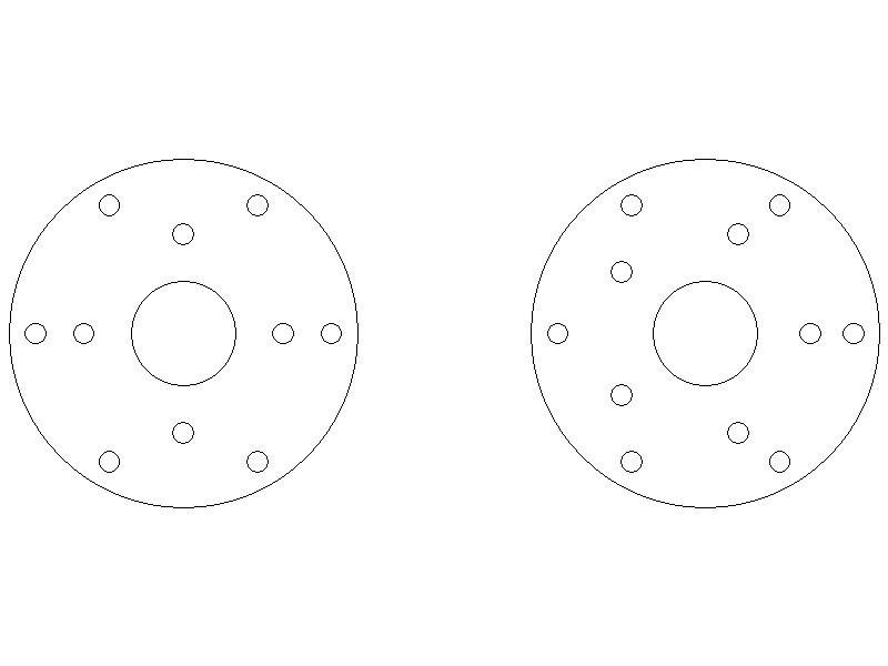

so i finished drawing up my wheel adaptors.. 4 to 5 stud adaptor. 2 piece total thickness will be 24mm can be made to 20mm as well.
these should be perfect for fitting up my 16x7" steelies.!
if i can figure how to save a dxf file as an image i'll post it up.
.... figured it out.
