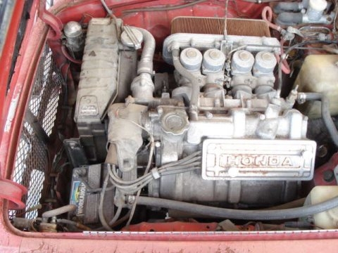

Check out some early Honda sports cars. Bike type engines in cars. I know these have been done in early Civics (my second love). It can and will be done!!
Honda 1300 Coupe 9S is the one you want, 1.3L quad Keihin carbies, air-cooled, dry-sump and 87kw :) Pretty damn good for a FWD car in 1970

That car is absolutely wikedsick! I think the 900cc carbies may be a little too big tho. My boss has told me that the 750 bike carbie is an excellent idea because the carbies were made bigger (more fuel flow) because of 12,000rpm hits.
And that requires alot of fuel. So then he started to drone on that back in the day blah blah Honda 750 carbies were are very popular choice. So basically what I'm saying is that a 900cc carby setup would be better for a 1.5-6 ltr.
