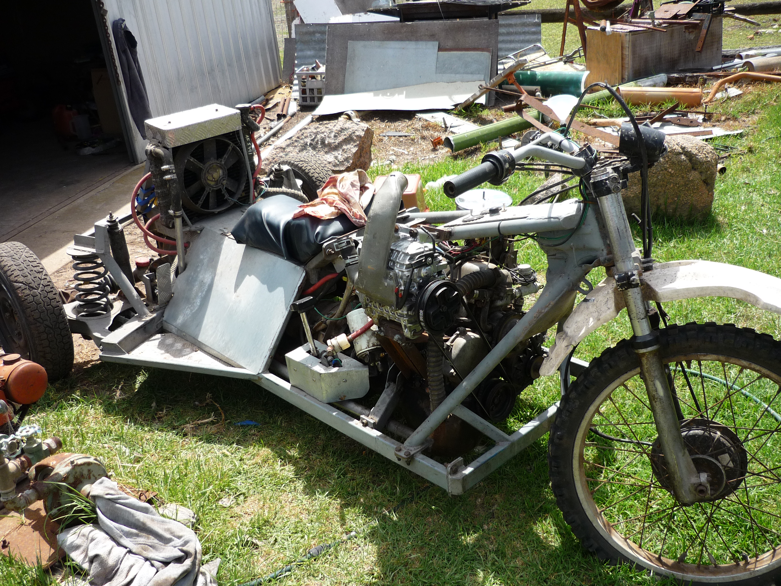

heres an update

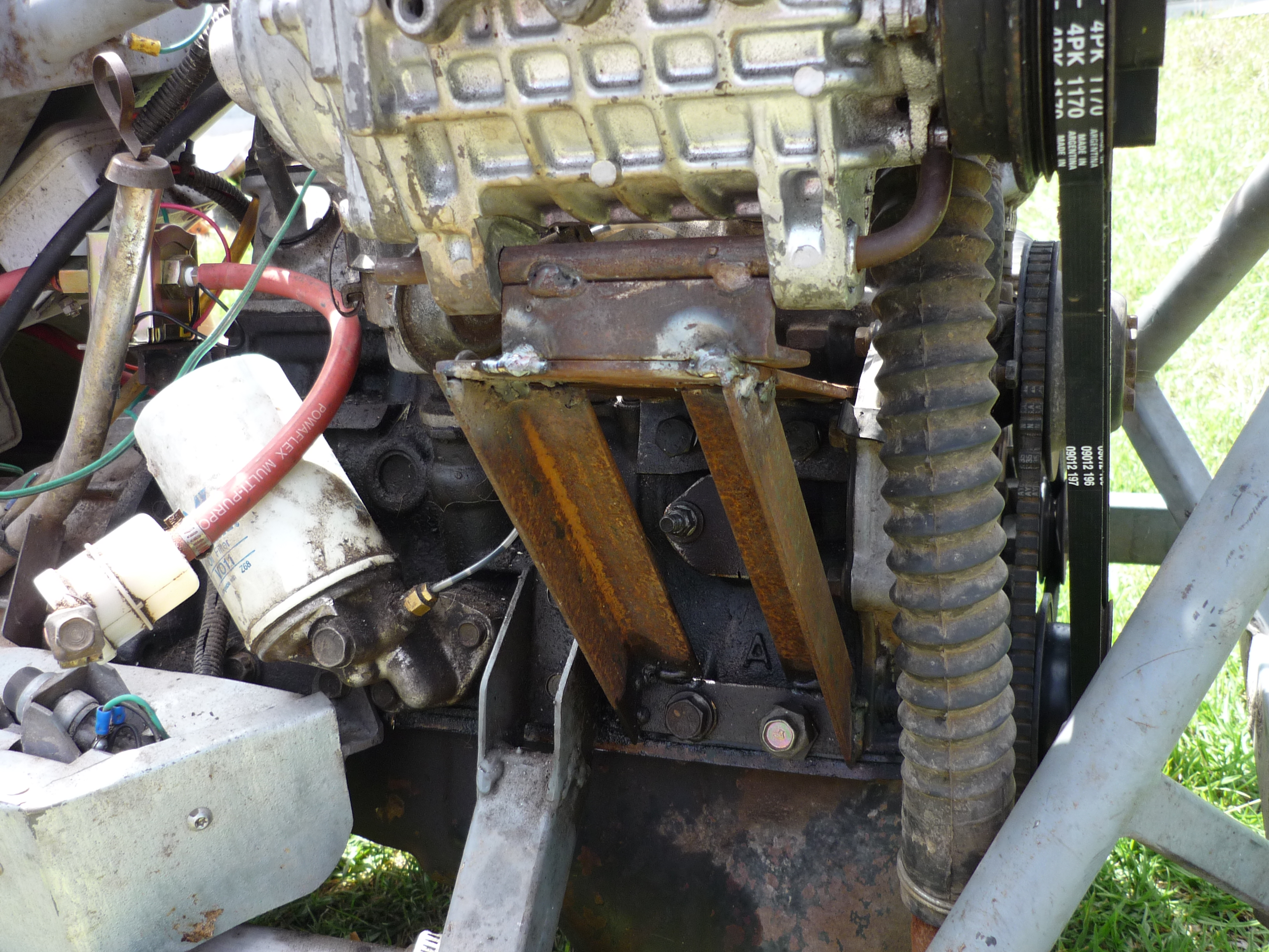

got blower bracket made to be welded better and painted
blower is fitted and had it spinning (not piped yet)running sweet

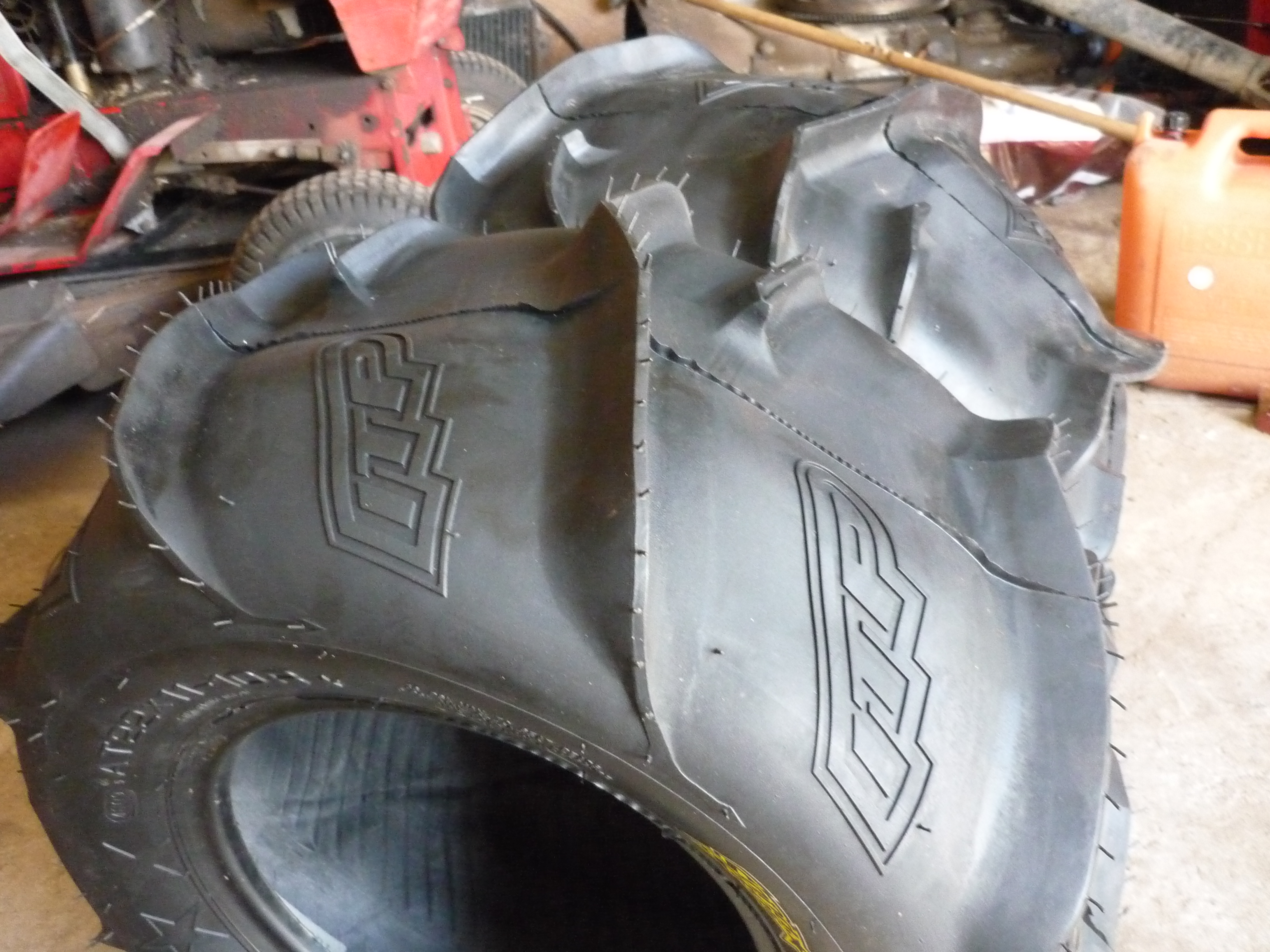

got atv tyres nice and grippy -yet to redrill atv rims only a small job
fitted eletric fuel pump
next up is su carb
inlet and exhaust
eletric dizzy
re ring/rebuild
cam$$????
front suspension also needs some work

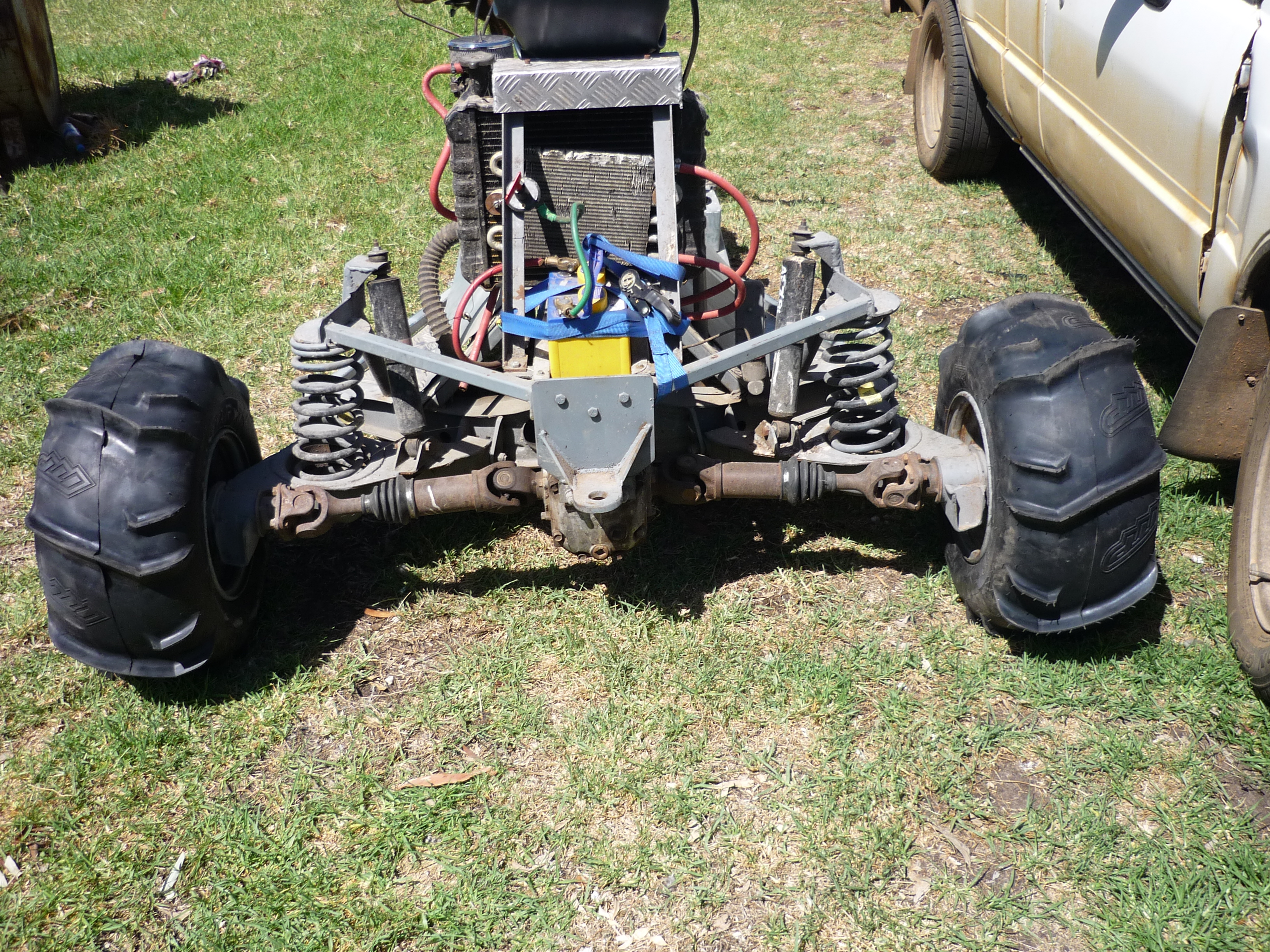

Good lawd, what size are those tires?
if your using the stock diff there are heaps of ATV wheels that they use in America with the 4x110 stud pattern.
tyres are 22*11*10 lugs are 27 mm
fitted tyres and rims
