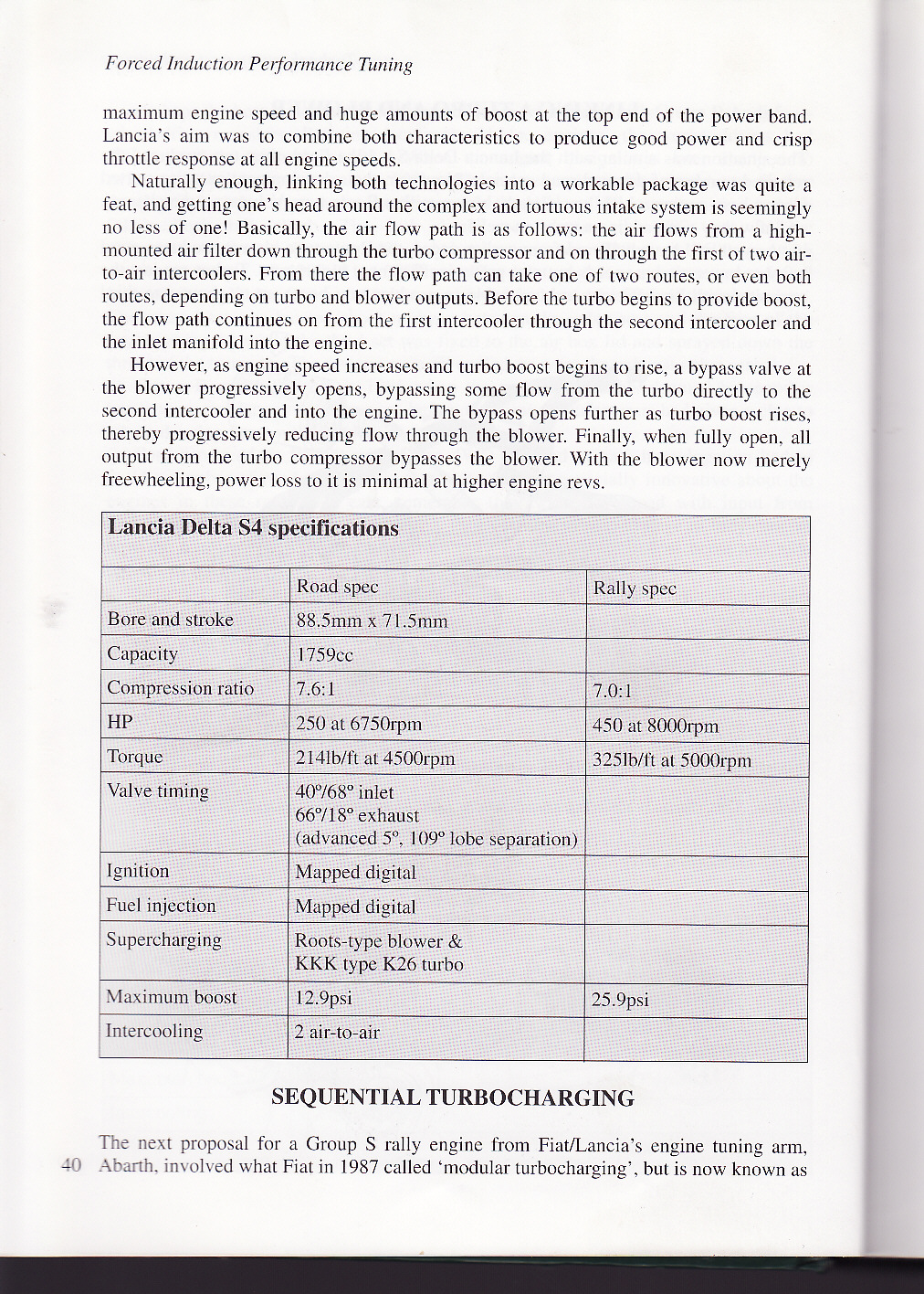

From the Group B rally cars - Lancia Delta S4 is one

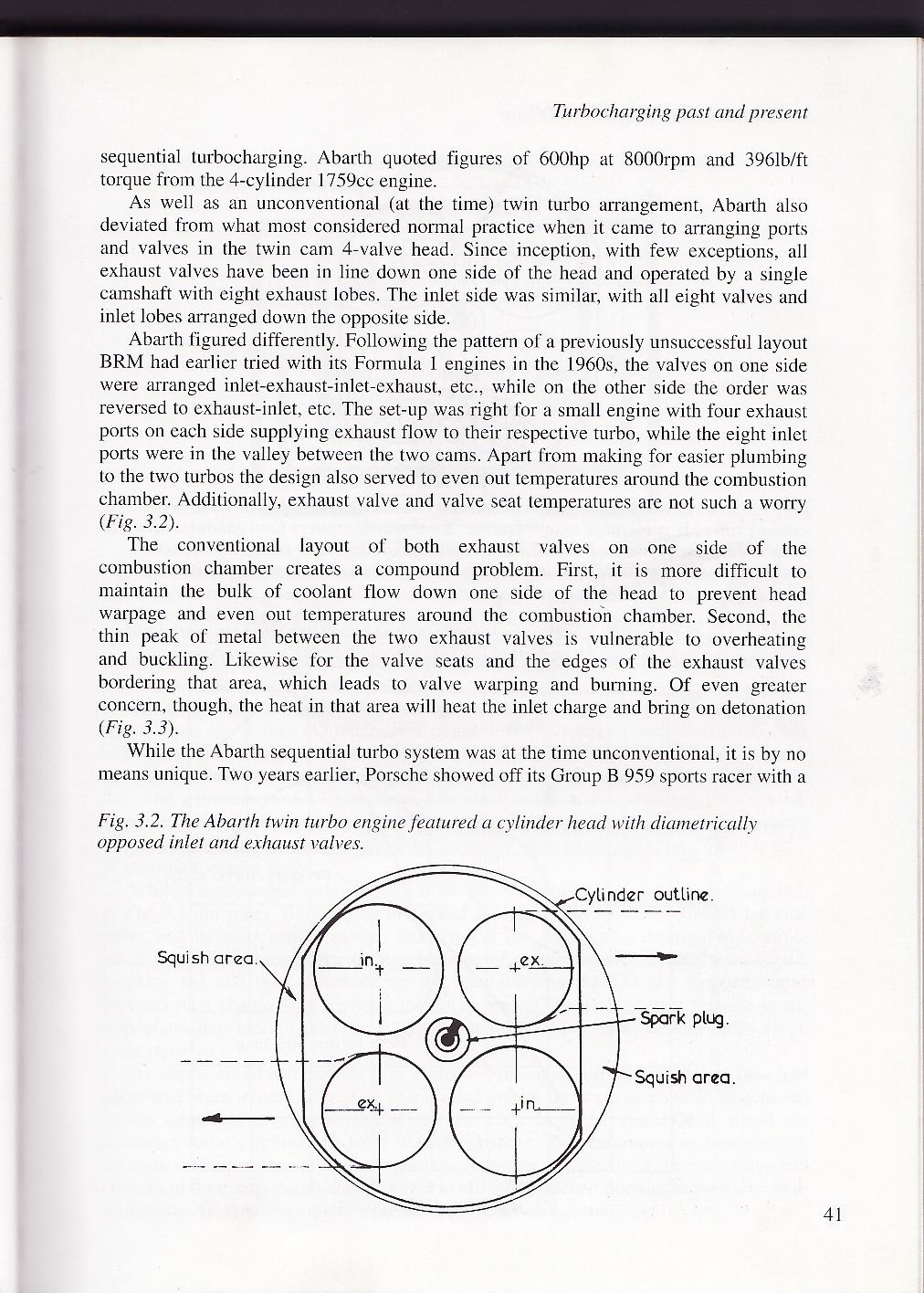

And for Ben there was a twin turbo 4 cylinder (if you could call it that) used in group b, it was either Lancia or Audi, i'm pretty sure it was Lancia, that made a twin cam four banger but each cam used both intake and exhaust lobes just like a single cam so that a turbo could be ran on each side of the block.
Huh!?
The S4 was twincharged as you mentioned but its predecessor the 037 was only supercharged.
Took me a while to find it.
Well i was right and wrong
Fiat/Lancia tuning arm Abarth. They called it "modular turbocharging" and it was used in Group S rally
600hp +- a few legs from 1.8litres
