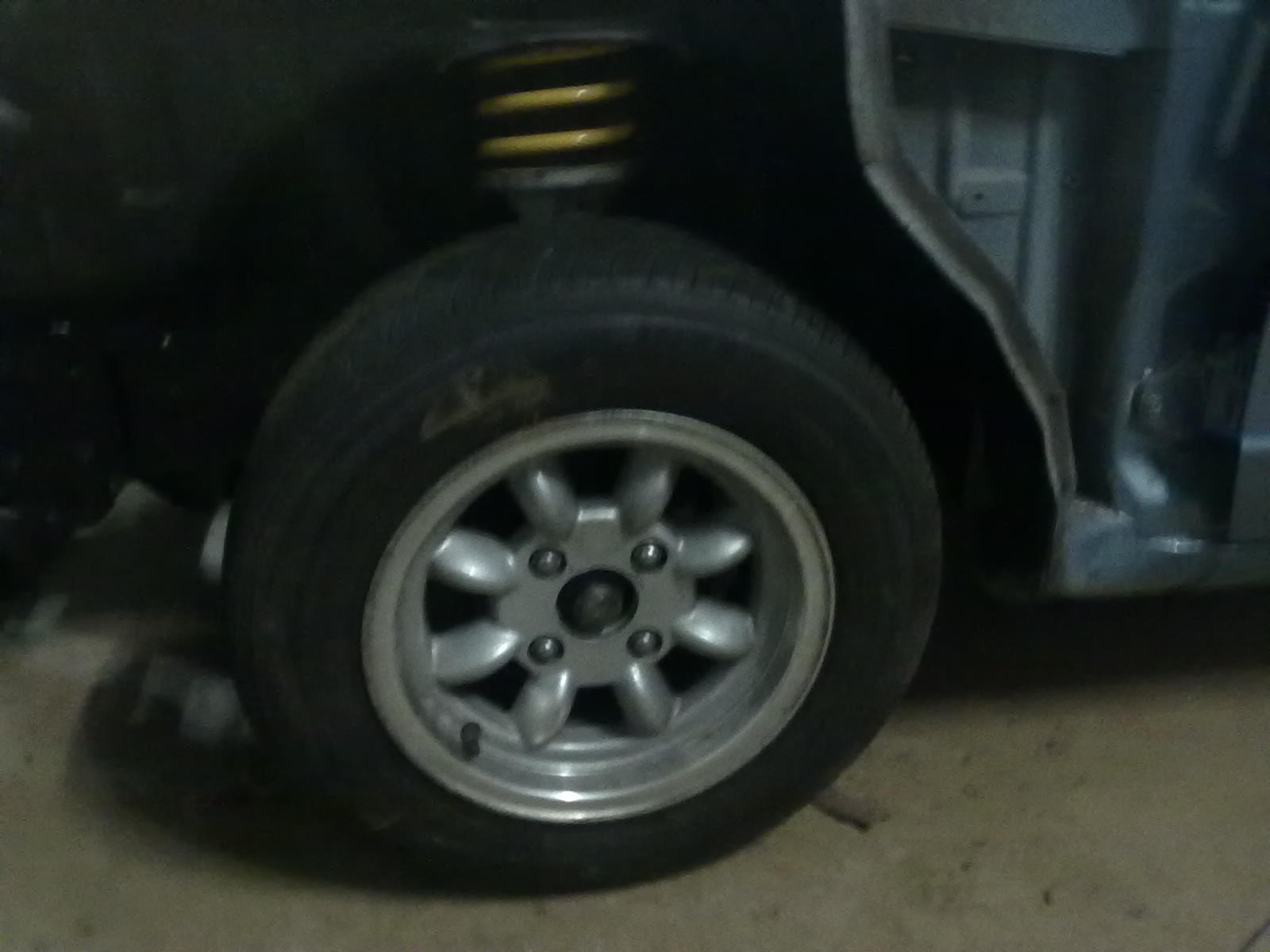

ok so I got the struts back from Southside Suspension. Shortened ke20 legs with VW Mach 1 Boge inserts, bump stops and custom 55mm King Springs. And for the rear 50mm lowering blocks.

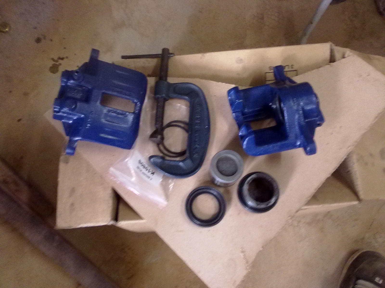

I go the struts in. I had to use the ke70 dust covers, redrilled. I used the ke70 rotors, wheel bearings and hubs. I picked up some PBR caliper kits for the girlock calipers. One caliper came apart well and is painted ready to go back together. The I couldn't get the piston out of the other to its soaking up some inox black in the hope it frees it up. I am unsure how to refit the main seal into the caliper so i'm looking for assistance with that.

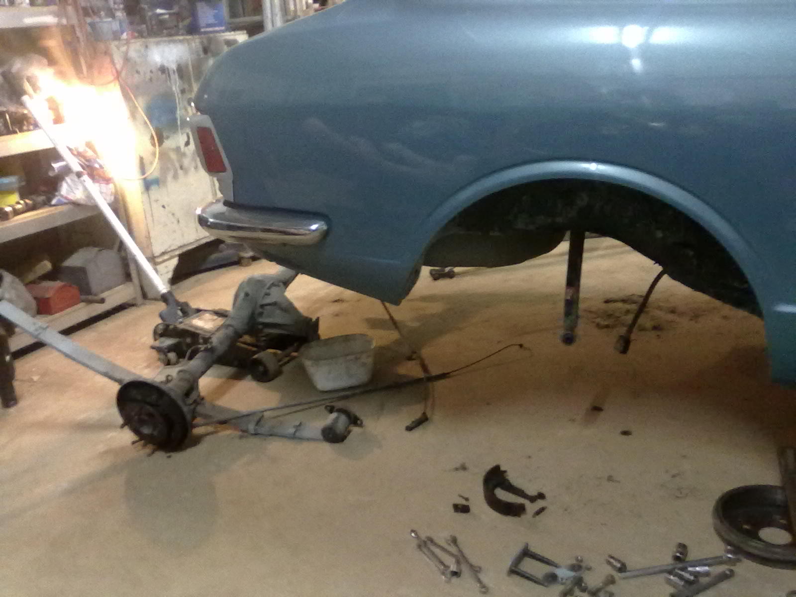

The front wheels are on without the calipers for now so I could get the rear end up and diff out. I know i'll need to use the ke20 handbrake cables on the 55 diff but other than that i'm hoping it goes straight in. It looks promising. I also need to work out how i'm going to mount the rear sway bar...

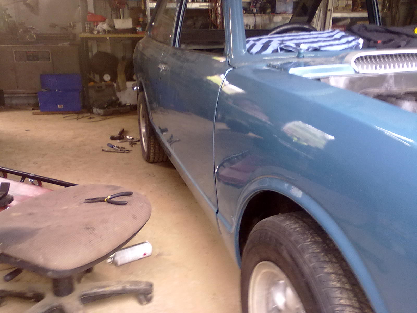

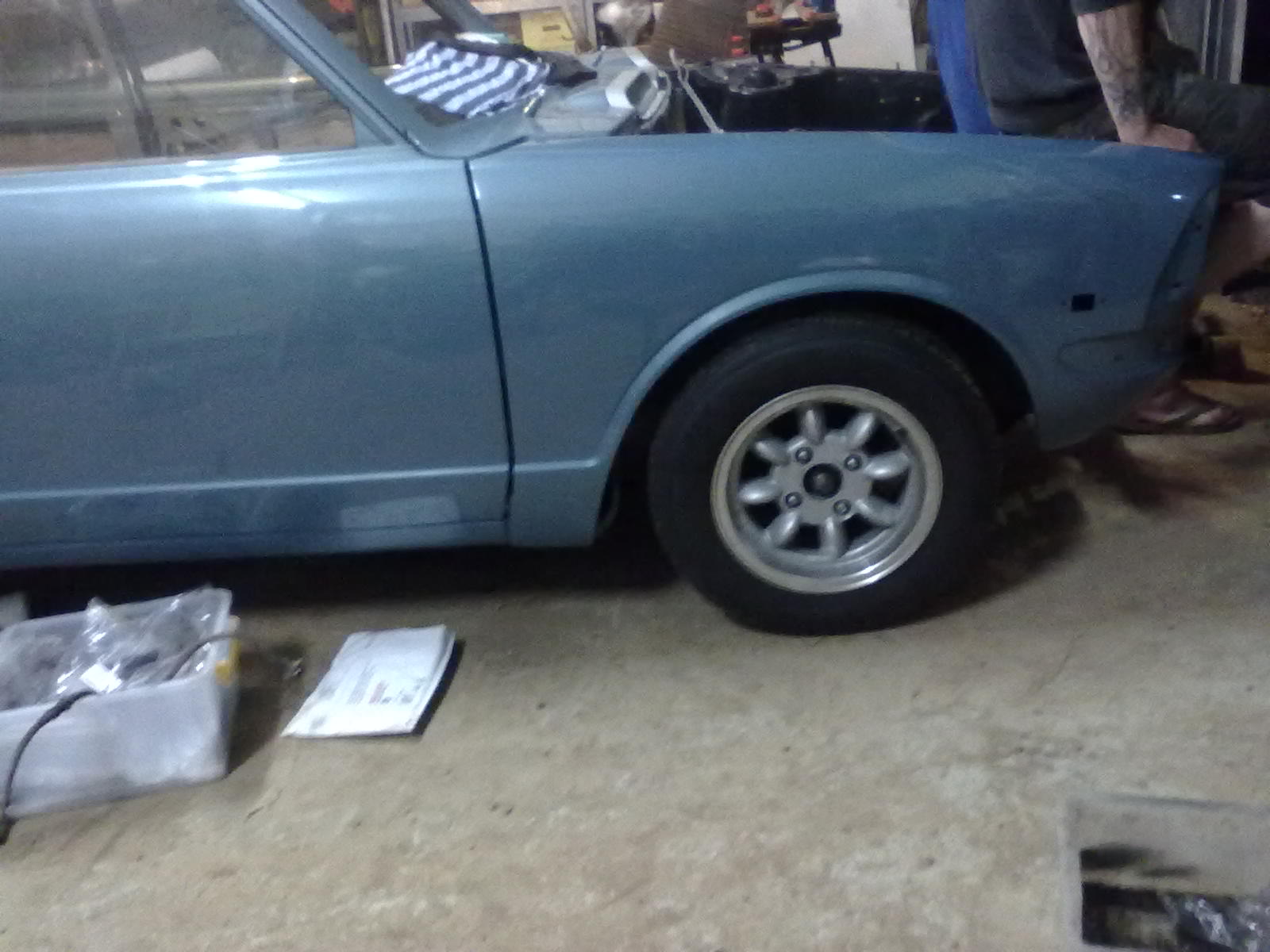

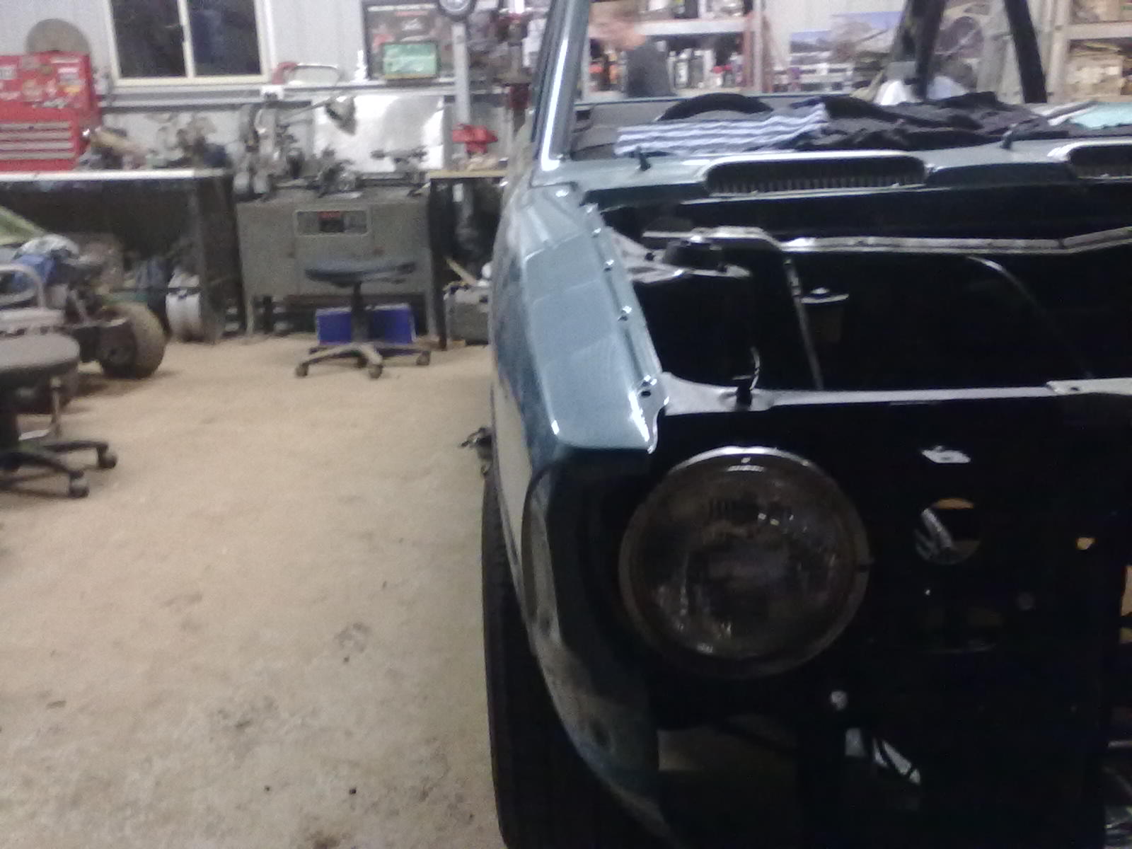

Here's the only pics I got last night...
post-8643-090980400 1290230159_thumb.jpgpost-8643-038495300 1290230243_thumb.jpgpost-8643-029957600 1290230260_thumb.jpgpost-8643-097522400 1290230275_thumb.jpg

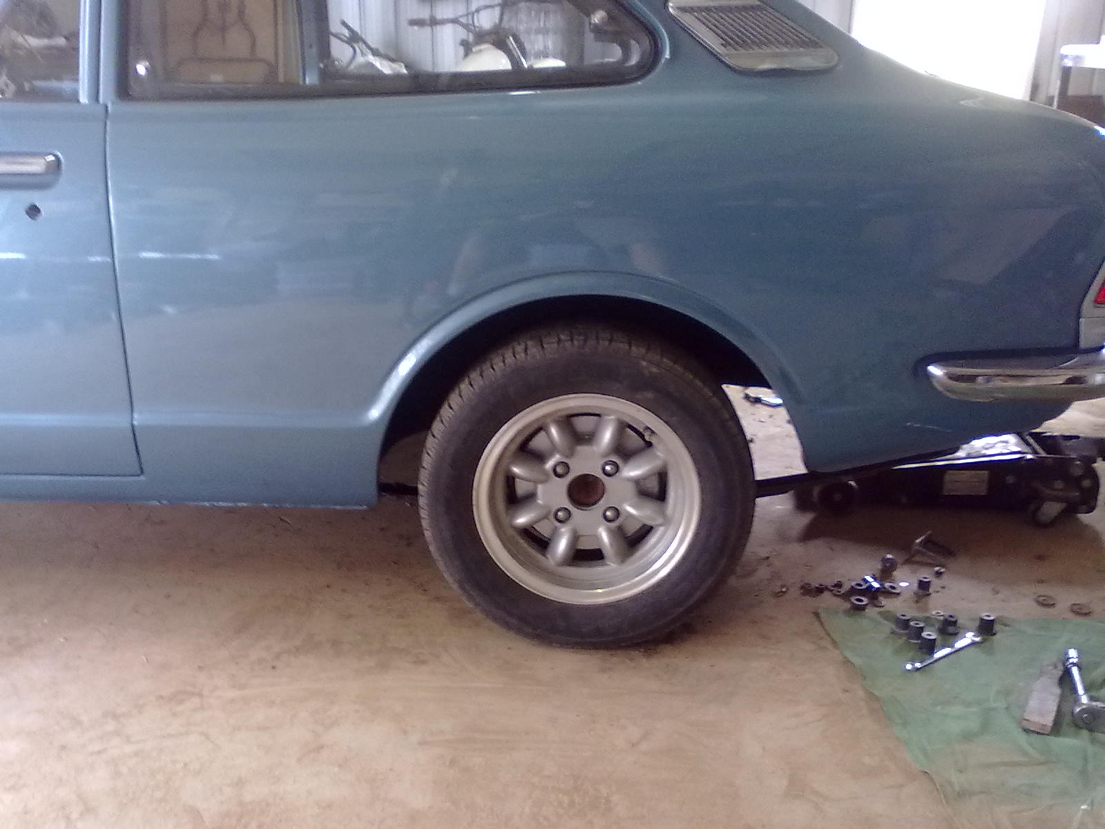

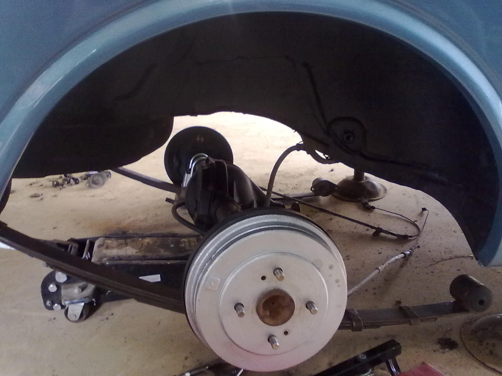

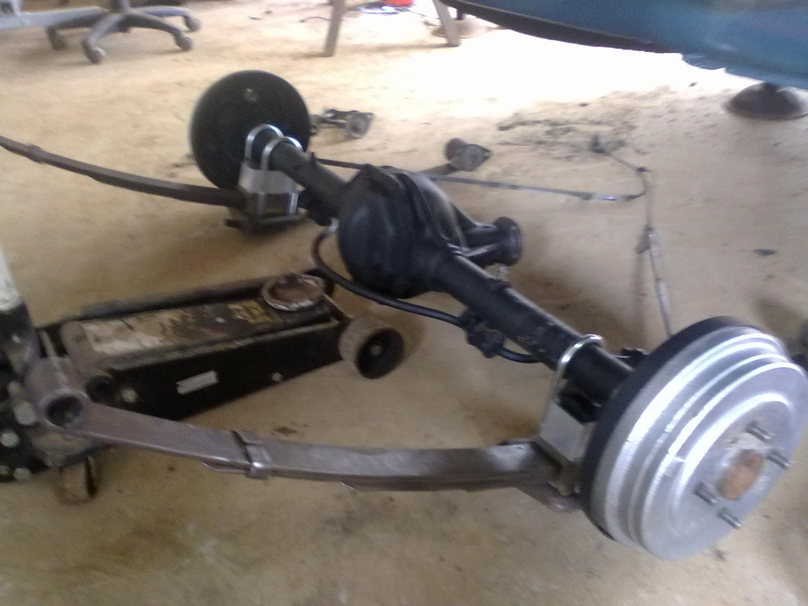

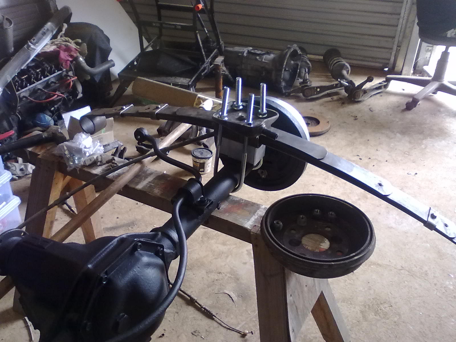

Today was another big effort. Wired wheeled the leaf springs, swapped over the hand brake cables and got the shit all together. Fitting became an issue. The locating lugs on the lowering blocks were 24mm when we need 19mm. Thank you Mr Lathe. We had to redrill the base plates because the extended U-bolts are 12mm instead of 10mm. Got it all up and found we only had 4 of the 8 ke55 rear shackle bushes and the ke20 KYB shock lower end don't fit onto the the ke55 diff. :glare:
But we fitted up the best way we could for now, got the rear wheels on and finished preping the front calipers. I'll sort a set of bushes and a new set of ke55 shocks this week....
post-8643-046575900 1290333388_thumb.jpgpost-8643-069913600 1290333414_thumb.jpgpost-8643-053781000 1290333441_thumb.jpgpost-8643-081453700 1290333768_thumb.jpgpost-8643-088350500 1290333789_thumb.jpgpost-8643-066366100 1290333811_thumb.jpgpost-8643-059152200 1290333827_thumb.jpg
So does the KE55 diff bolt straight in??
Is it just a bit wider?
yeah. the spring mounts are between 5 and 10mm wider on the 55 diff. But easy enough to pull in.
What do you mean by "pull in"??

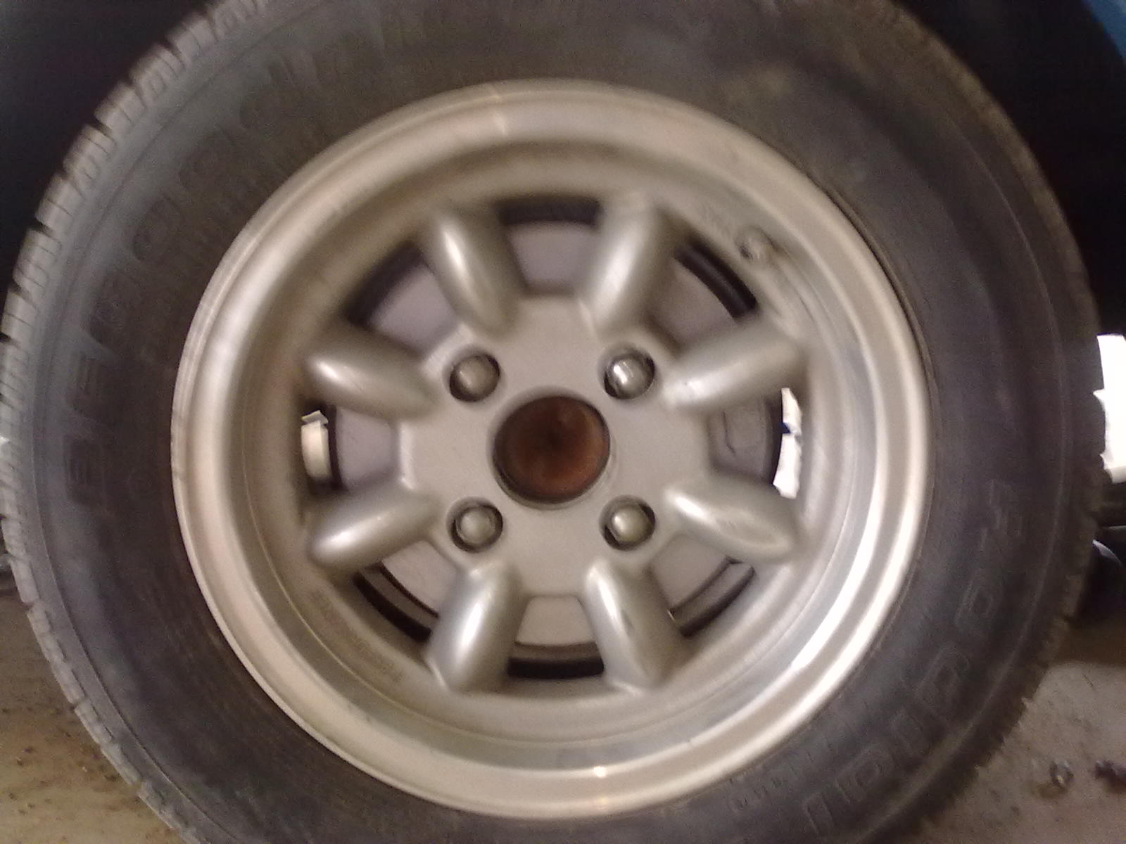

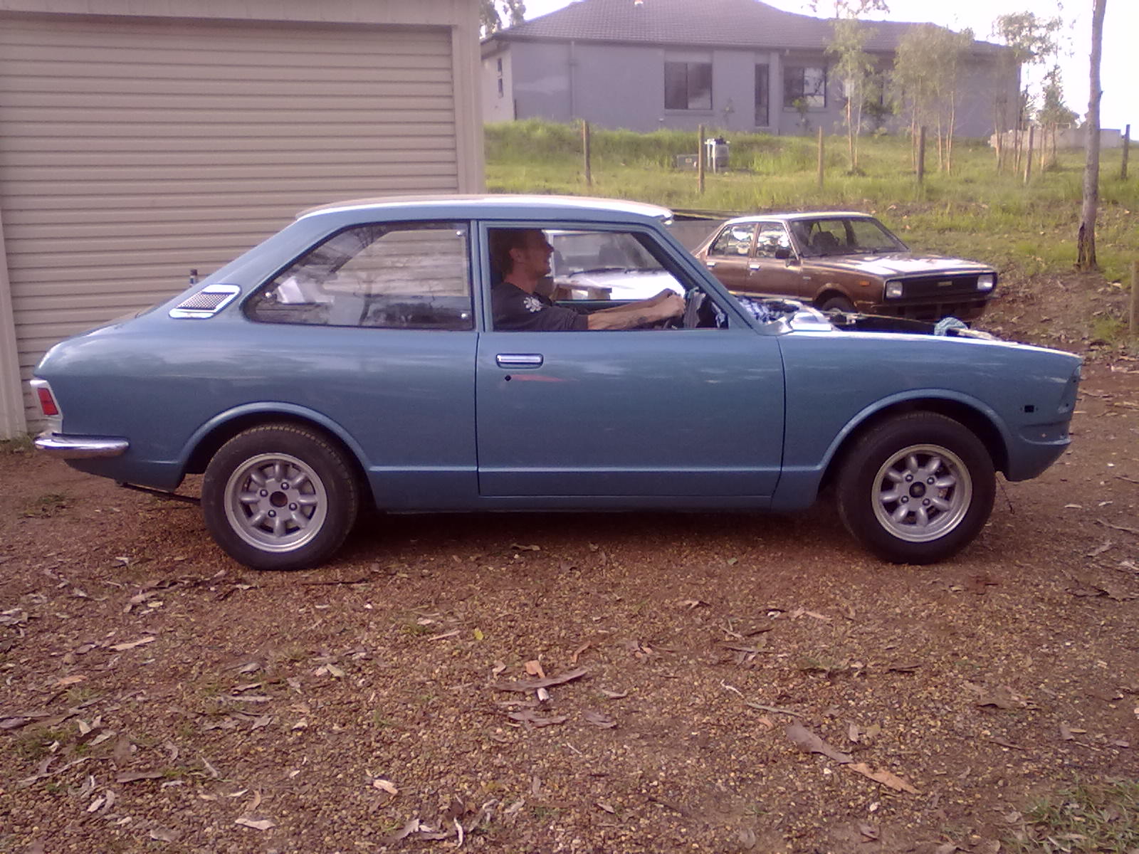

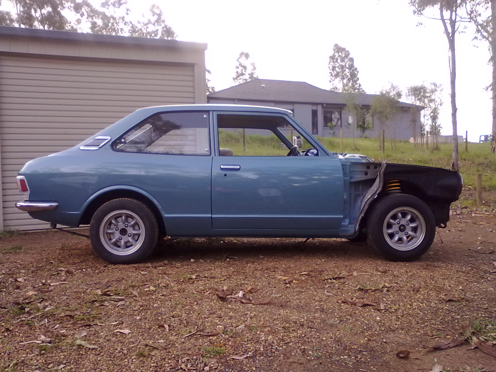

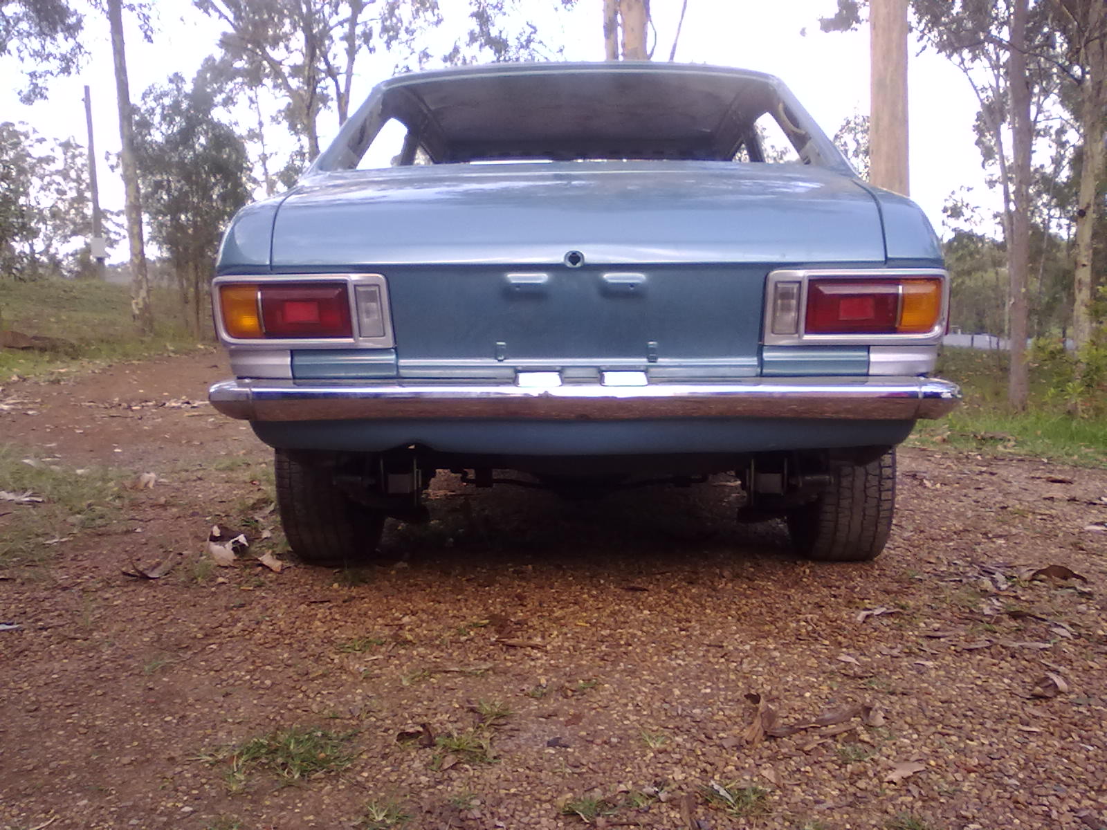

the 55 diff is longer the a stock ke20 one and judging by the pics looks like your wheels stick out the rear guards, could we get a side on view of the rear wheels?
wouldnt want to wreck those nice quarter panels going over a bump fast

Well, I found out only by trying it myself. A 55 diff is about 35mm longer overall and 10mm longer at the spring mounts so when you mount the front spring eyes the springs end up an inch wide of the shackle mounts at the rear. so you pull the spring inwards to mount the rear shackles. Other than that it was all sweet. I just need to weld some mounts to the underbody to fix off the rear sway bar.

This is the closest pic I have at the moment. The rear wheels have 185/60's on the and I plan on using 175/70's. The 55 springs are much firmer than the 20's and as it's only lowered 50mm I can't see the wheels ever touching the gaurds unless I get all Starsky and Hutch through the city.
