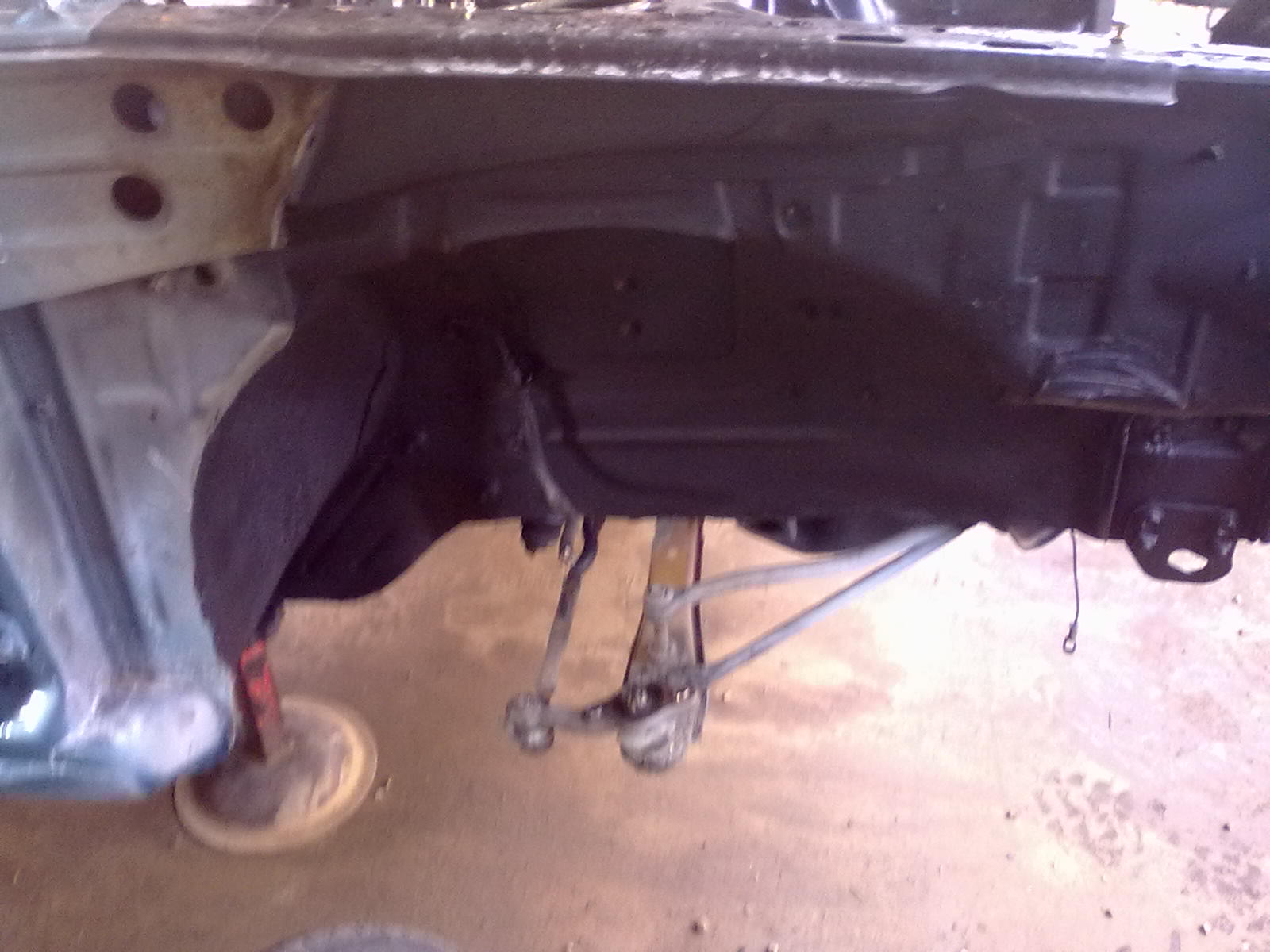

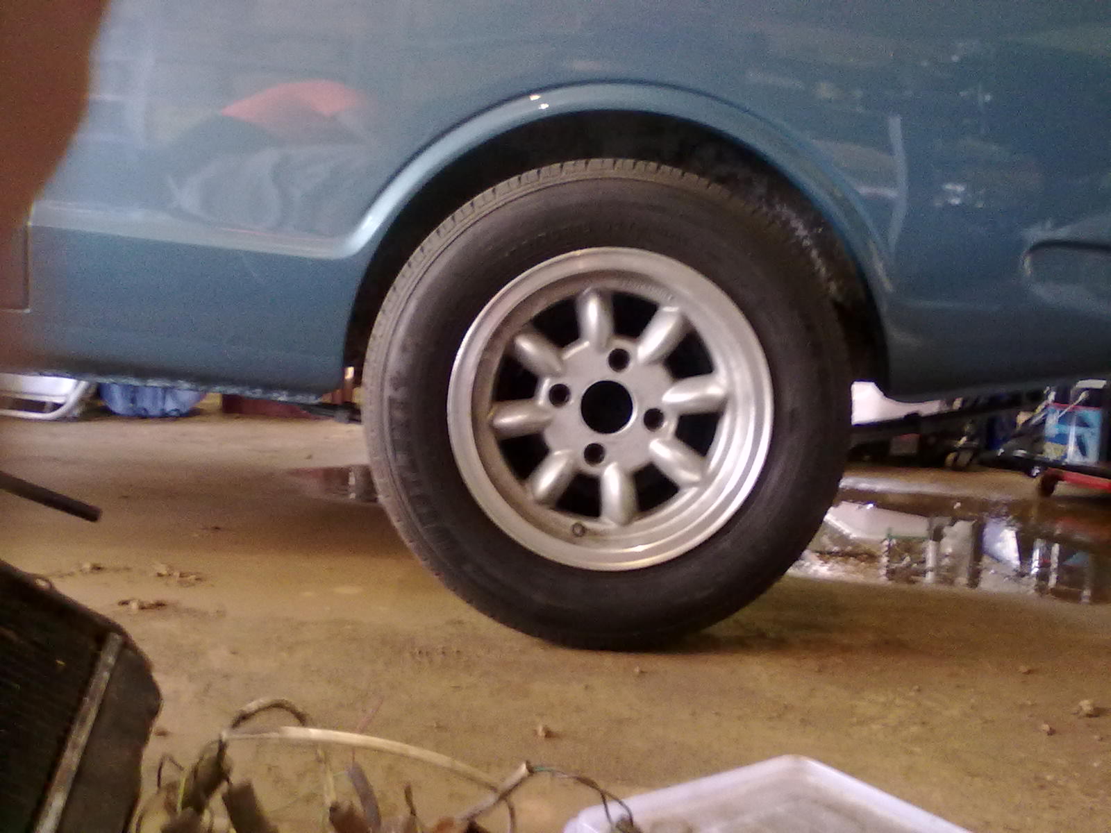

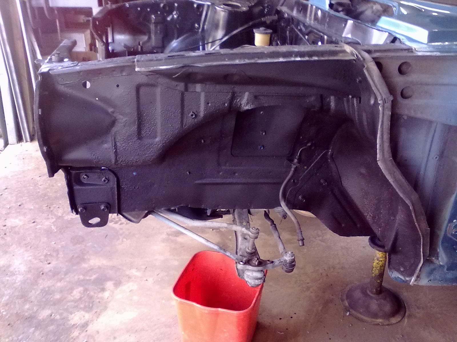

Today I hit the front inner guards with stone guard and had a look at the test viewed the superlites. The body still needs to come down 2 inches...

On a positive side the wheels look tough as against it
