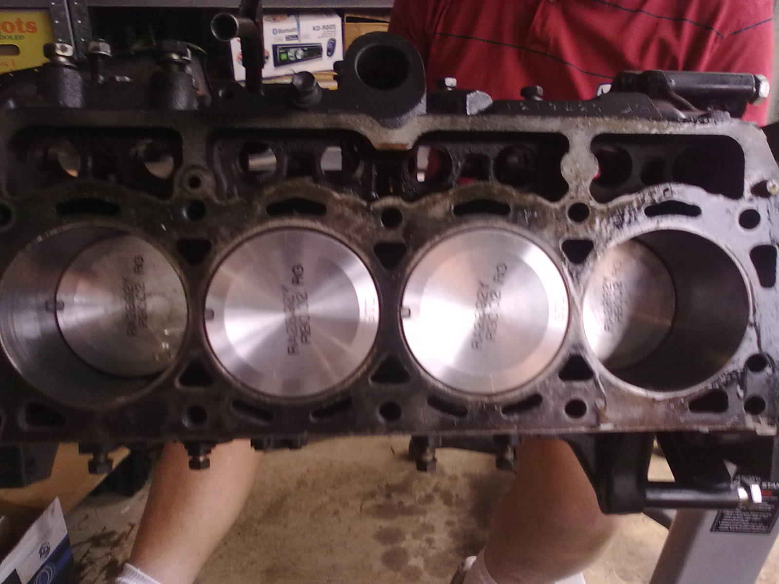

Got the sump off the 4k today. Wire wheeled it back and painted it. I still have a few coats to go. I also dropped the pistons in and tensioned up the big ends only to fond about a mm worth of play with new bearings... uh oh! The crank bigend measures in at 41.42mm. It's obviously had a crank grind, so we measured the crank out of the donor 4k. It stands at 42.42mm. The result is.... where swapping the cranks... should save me buying a set of oversized bearings :jamie:

The problem with that is man, is the 4k's stroke length and shit the same as the 5k cause you will run into drama's with it if it's not close man, i realise it shouldn't matter with the 5k pistons and rods it'll keep it close but will it be the same?
5ks use 4k cranks anywitch way (I'm pretty sure) so aslong your using 5k rods/pistons, it wont mess with the stroke.

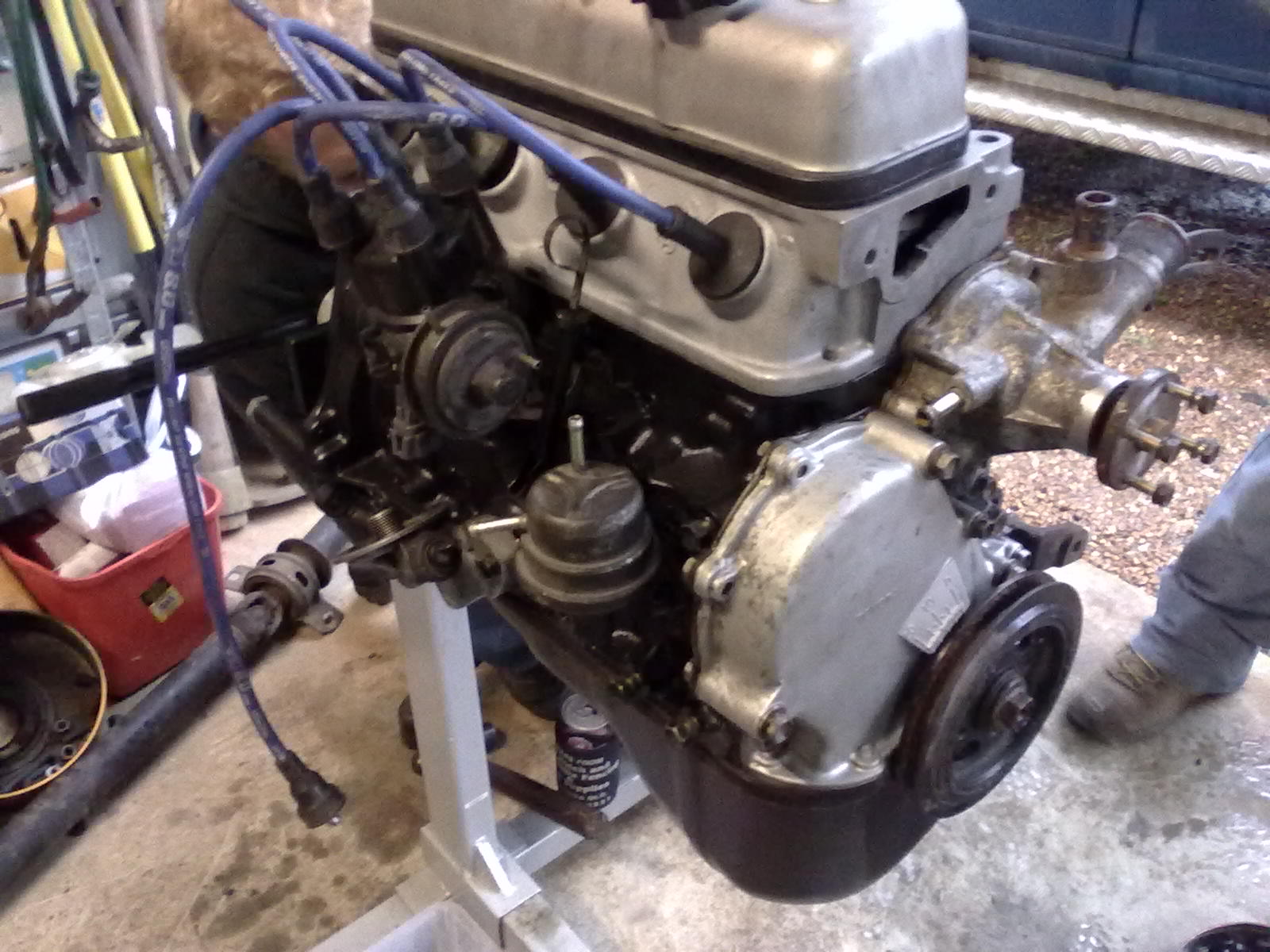

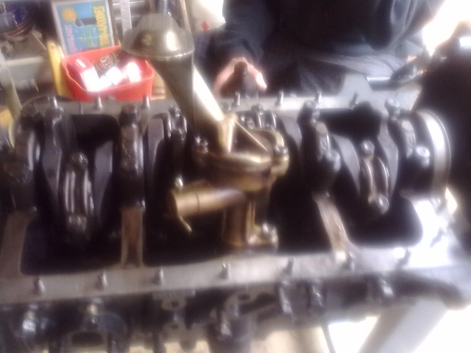

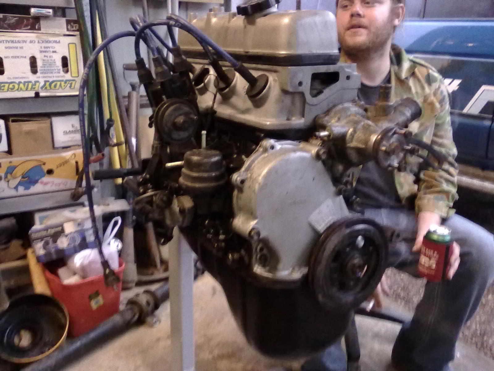

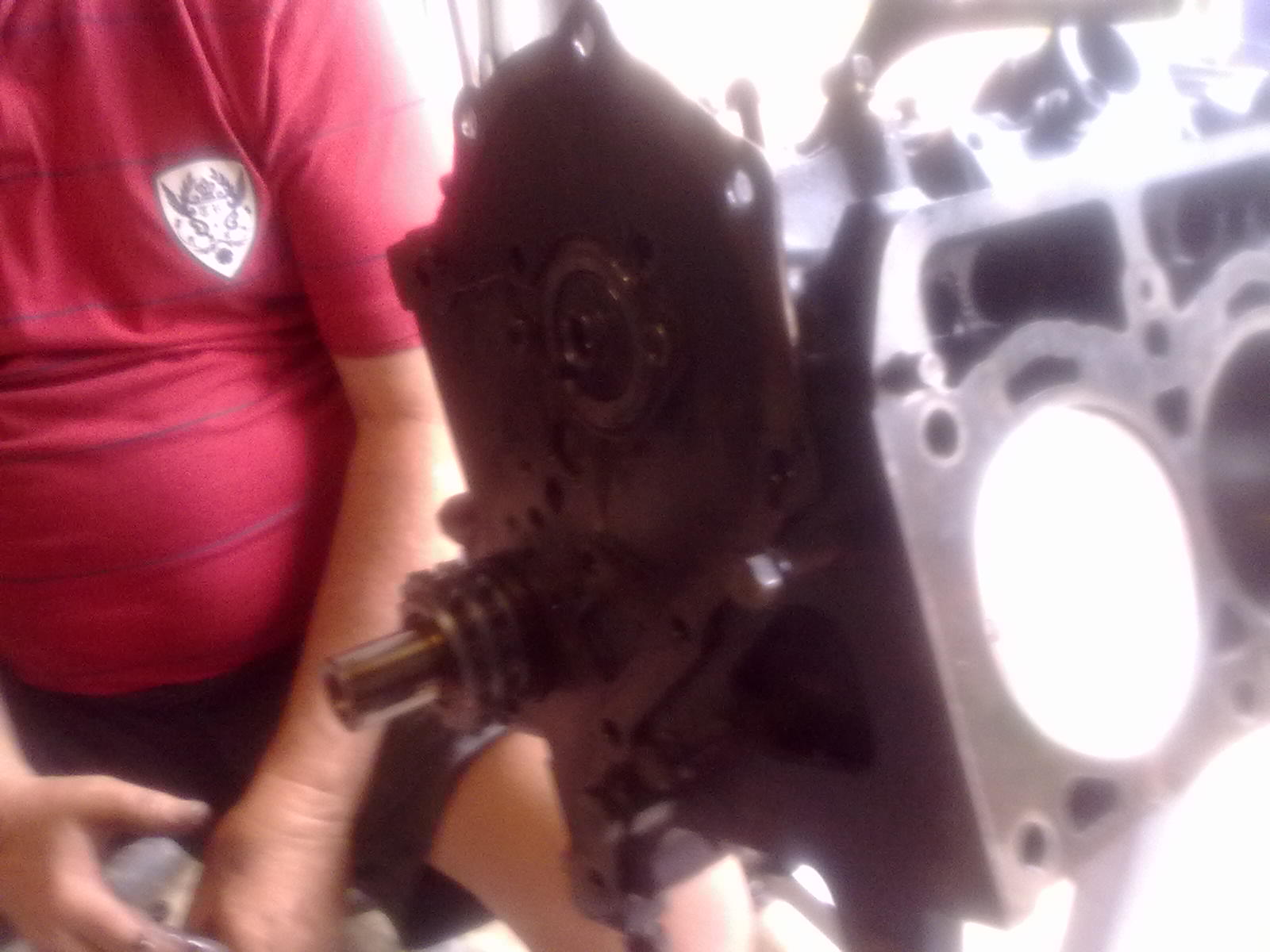

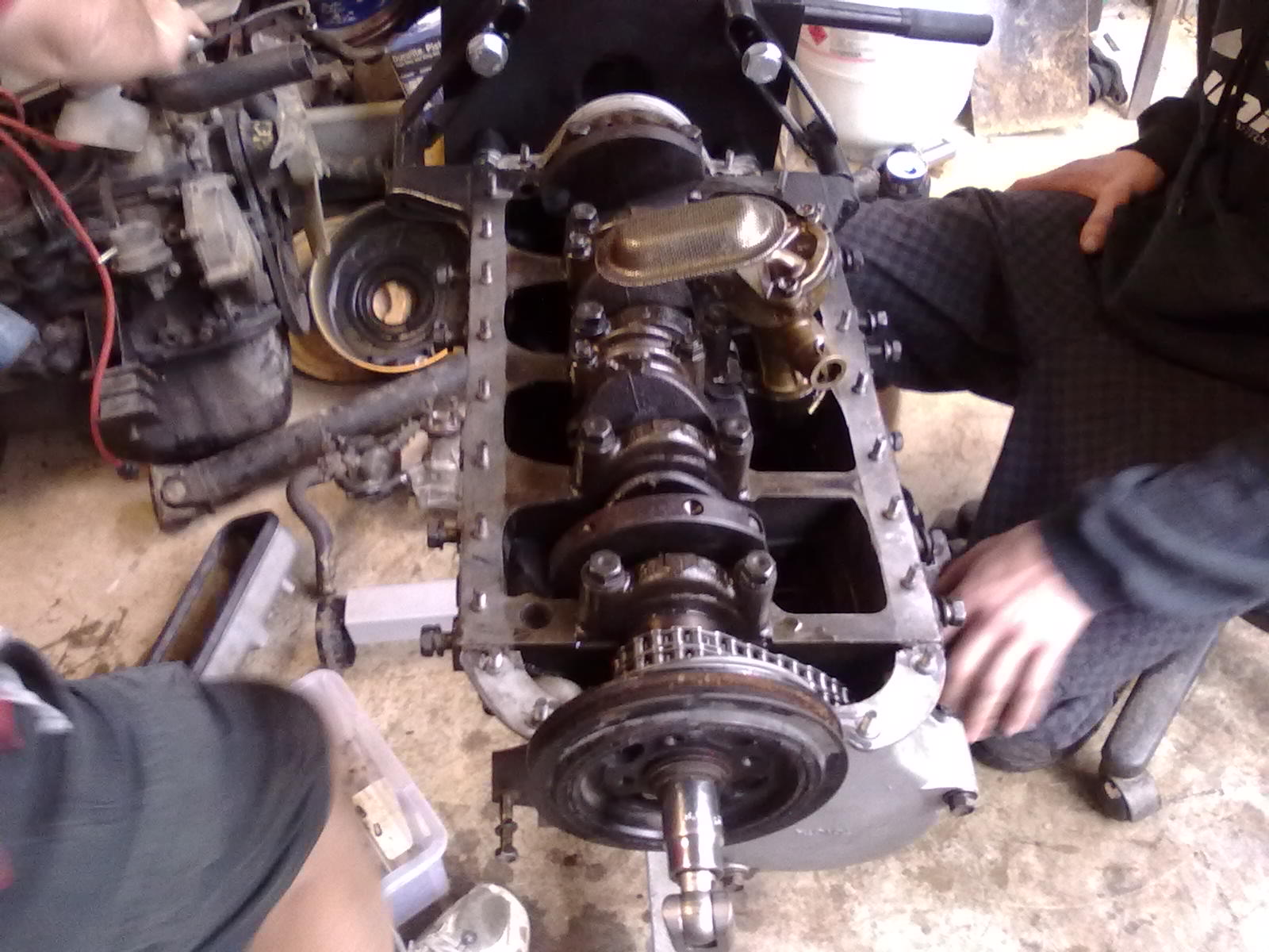

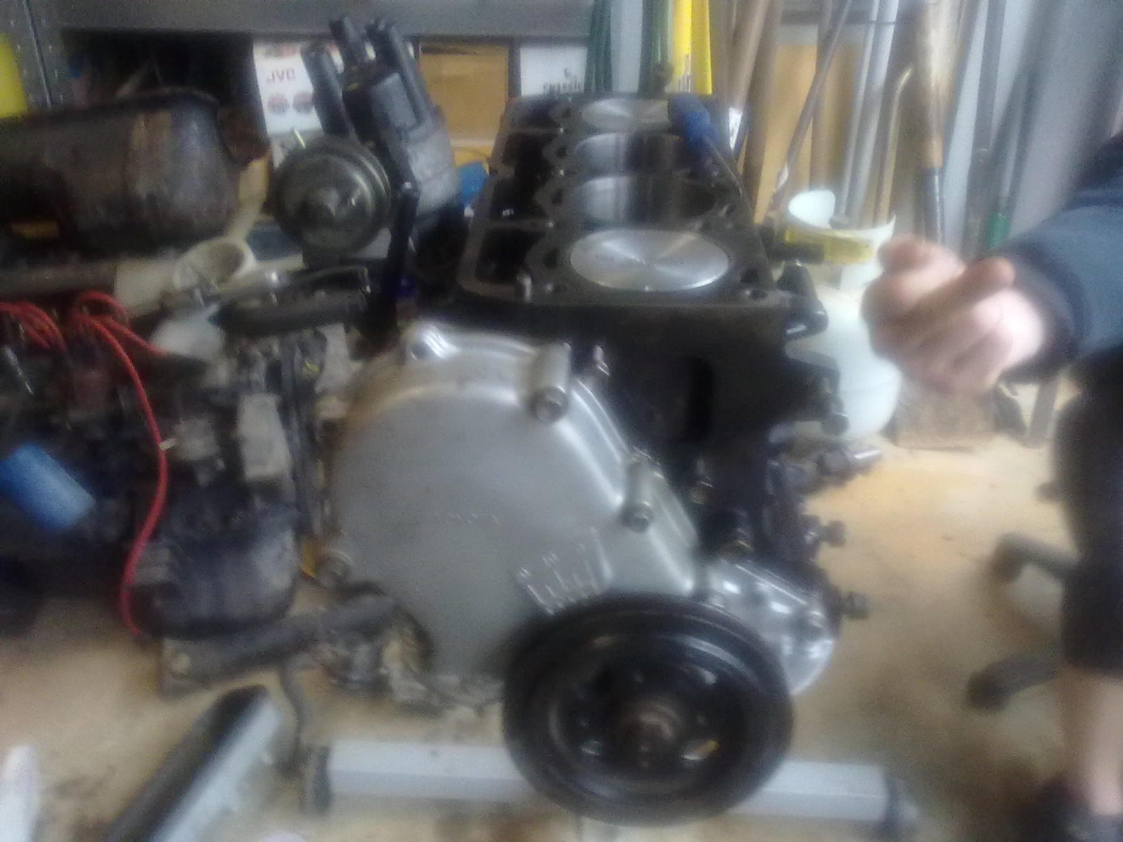

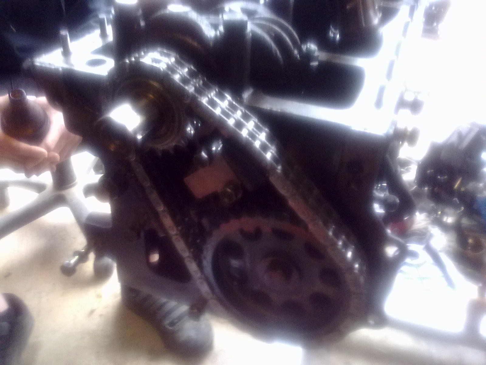

Went to Dad's today and pulled the 5k back out. We got the spare 4k crank in, pistons, cam and twin timing gear. Then we did the rear main seal, electric dizzy, timing cover, shimmed oil pump, 4k sump and 5k harmonic balancer. We then moved on to the gearbox mounts, oil regulator, 4k fuel pump, 4k water pump and finally the 4k alternator mounts.... :lolcry:

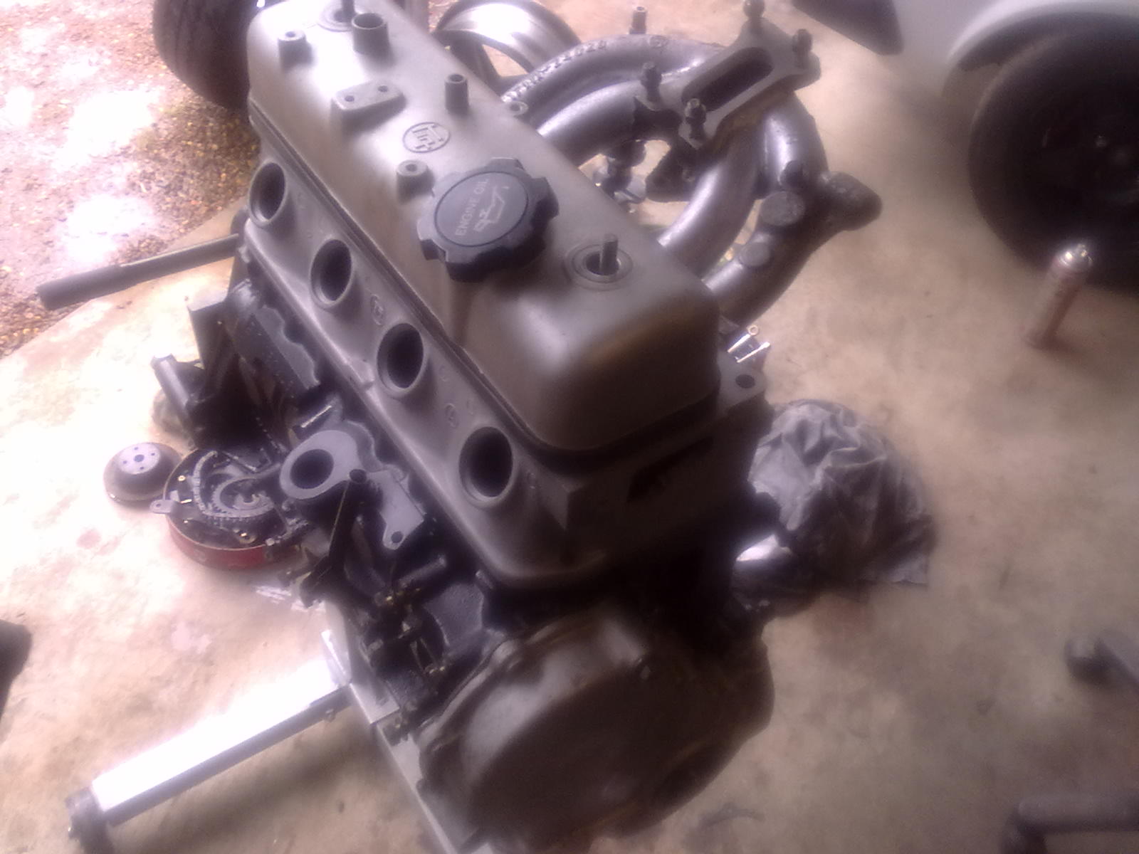

The head is sitting on and we were ready to do execute the exact math to determine the pushrod length when I realised I left the new lifters at home. That in turn put an end to my ever productive day. HOORAY!
....and the pics.

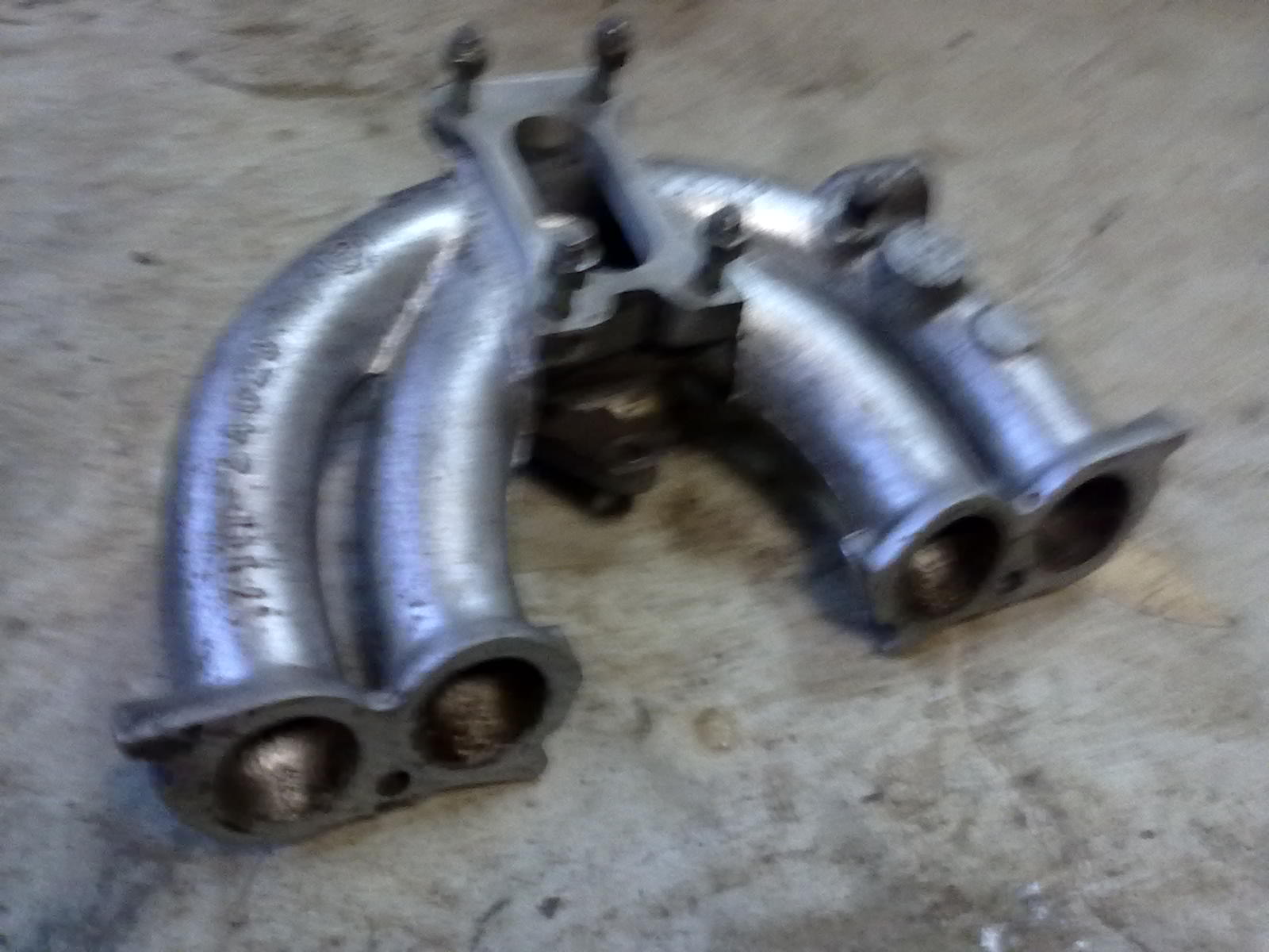

PS: I don't think i'll be using the 3kb manifold I just had milled out (viewable in last image) so I am considering putting it up for sale. Also say "hello" to Rozza. He's the hairy VB drinking dude who sat there the whole day watching us work.

That dude looks familiar, Did he use to live up the road back in the school days ?
Certainly did. Zoe's older brother.
Thought so.
