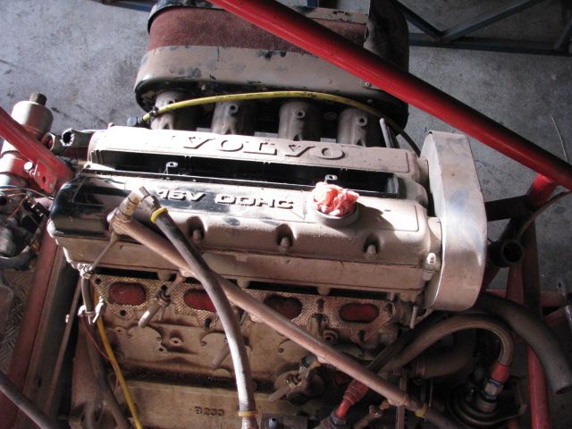

theres a decent racespec volvo engine that has been worked to the shit house ;) have been dreaming of putting that into my car.
but obviously i can't :( he also brought round his spare air compressor for me to use which sweetened the deal
