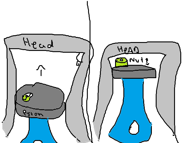

found the problem with the 5k as soon as the head came, a random nut made its way into the piston chamber thingo. (diagram will explain)
which was stopping the number 1 piston going all the way to the top and sparking. (which is why the crank wouldnt turn)
everything thing else is fine and not chipped/broken/cracked so the 5k should be getting dropped back in this weekend :)
