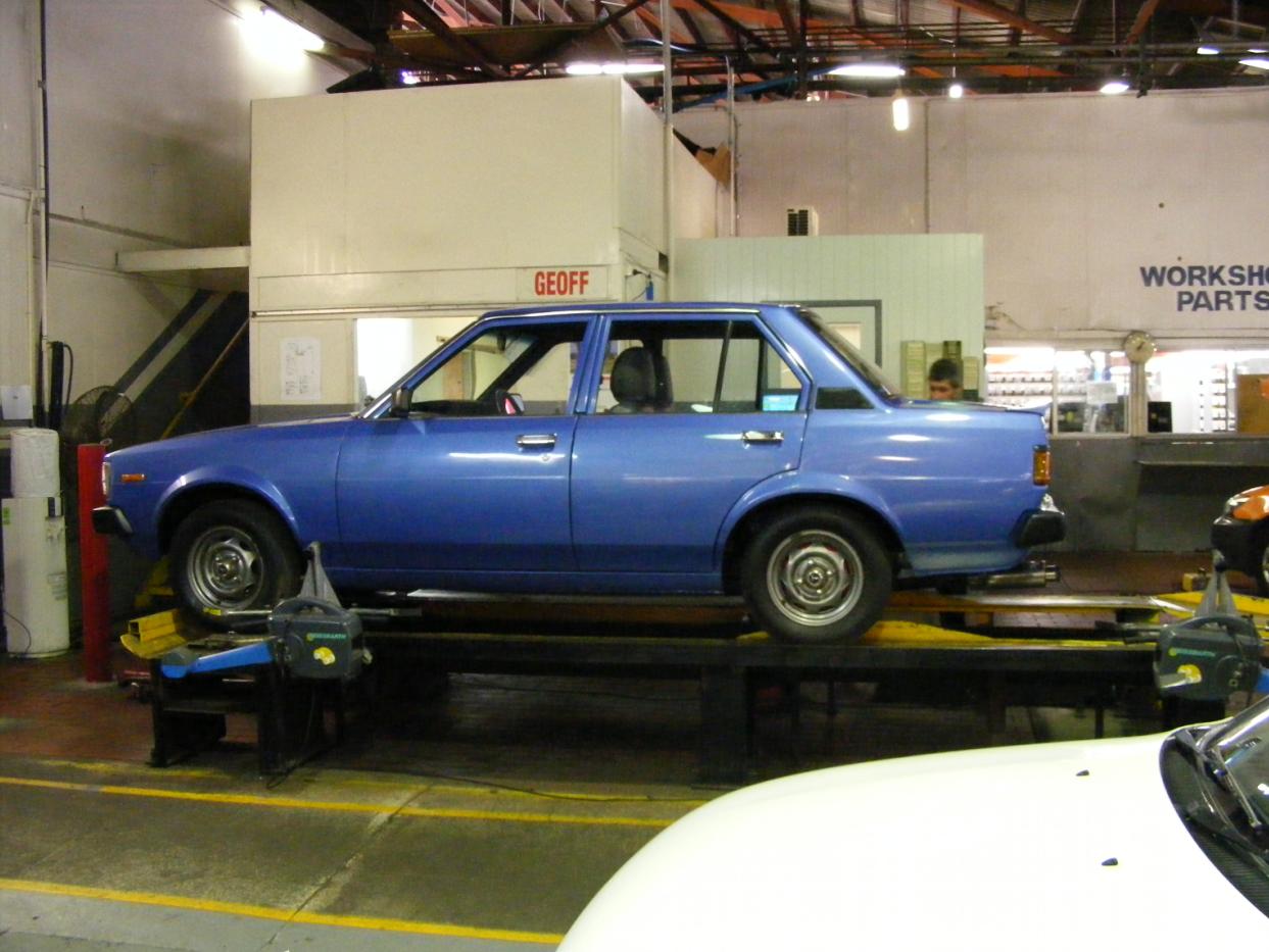

Yesterday was the first day the car has been touched in over 2 1/2 months. Auto-electrician came over & checked over a heap of things ~ Car currently wont fault with this intermntant running issue as if its starving of fuel. Wilst driving it around, tyres were howling severely.. it needs a Wheel Alignment A-Sap ! Stupid amounts of positve camber on front left wheel, and way tooo much toe- in on the front right wheel.
Had no.. 'umf' to do any work on that car. But, car is currently in at work & will get a wheel alignment andddd its first check over - ON A HOIST !

Today!
Car was center of attention for a little while, most people came over & had a good perv. Received many complements :wink:
Very Big Yes's for the wow, they are standard seats? & very big No for the exhaust & rice sticker(s) on car still from previous owner. lol.
LSD is so tight, ugh i Must speak to Paulie and find out how tight it was wound up, its insane.

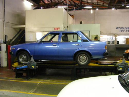

Wheel Alignment was done. Toe was out so badly, that it had the camber effected enough to be visible just looking at it haha. Caster is ok for the time being. Settings are basically as close to 0° as possible, until its worked out what were going to do with it.
Cold start injector isnt working, or receiving any pulse signal. Must check the starter signal and temp sensor(s). Mmm.
Sump plug is leaking, some bitch.
Wee :D
I should have a spare cold start injector here if you want to try it..
why didnt you atleast set the toe by eye before driving it?
I had it set when the car was up in the air and then shannon adjusted it again before we took it for its first test drive..

Car now has almost 60 kms on it!
- Electrical problems have appeared to have sorted them selves out (great, now this car fix's it self :y:)
- Having diagnostic thoughts with good reason, that the lift pump is mounted too high, and possibly struggeling with physical position in doing its job properly
- Clutch getting harder to operate, need to adjust and bleed system.
- Rear Tail light lenses popping out badly, god dam aftermarket crap. Need to re-seal
- On the last 10 kms of test drive back to work, rear breaks / diff starting to make sever scraping noises. Noted when we got back, diff from drain plug has leak. Mmm.
- Drivers seat has some form of internal blemish that gives me a dead leg, will be taking back to upholster to fix.
- Drivers seat base has excessive play. On the hunt for a new one
- Drivers seat belt takes too long to re-tract. Needs a new one.
- Dash has a small rattle intermittently on left hand top side. ~
- Diff is so tight, dislike it alot. Putting open center in.
- TPS needs adjusting, idol gets lost
- Goes like a shower of sH!t. :dance:
