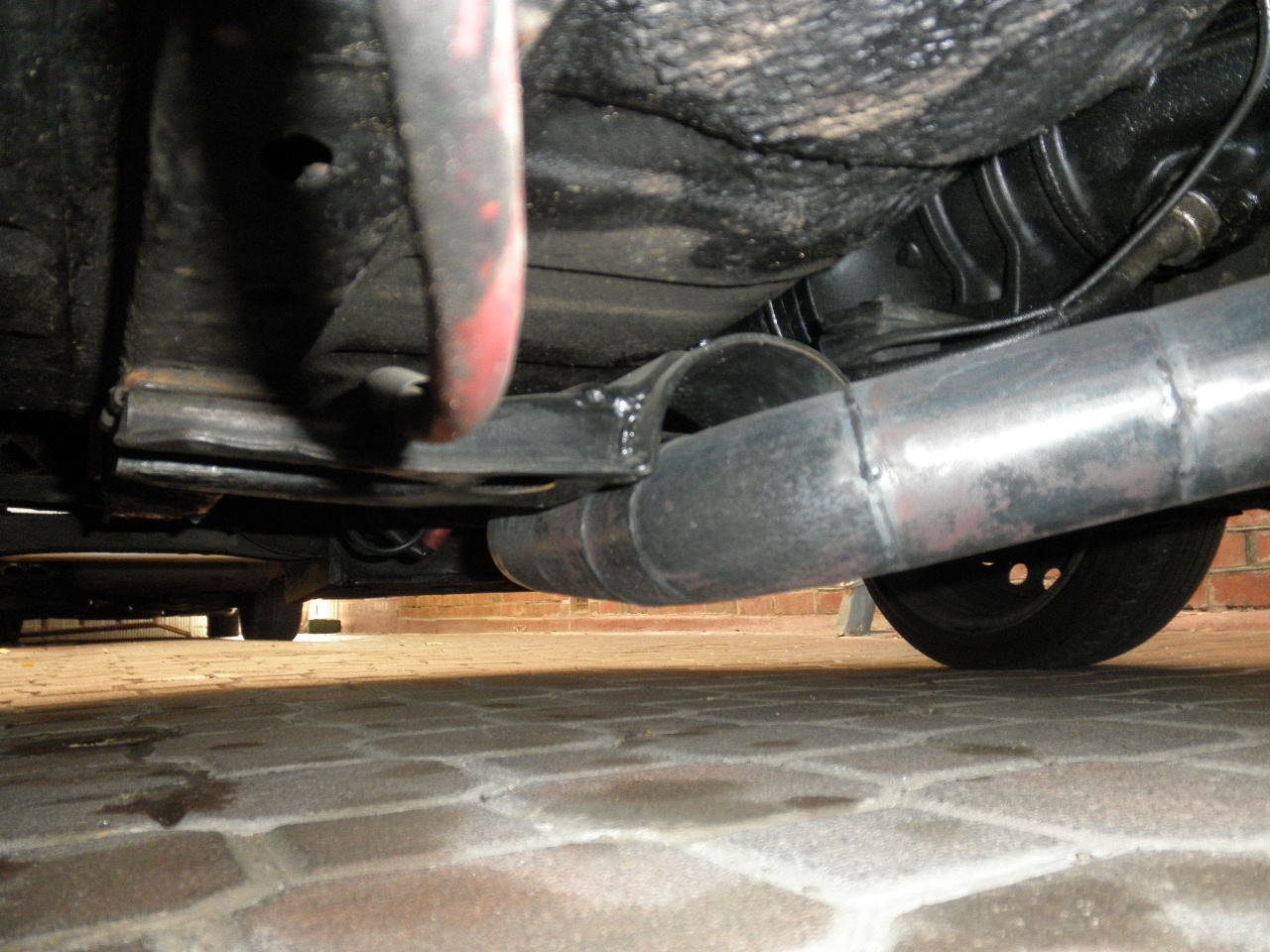

Another issue i have found is that the exhaust is probably 30mm from the ground at this height, So i can't really decide what I'm going to do. I may have to gut a section into the gearbox crossmember and weld an arch into it dunno yet though.
Hmm yeah i suppose i could get them air freighted, ill shoot streeter a pm.
This is how mine is done, helped lift the exhaust up enough to stop any scrapping issues i had. Really like what your doing with the car :yes:
Hey thanks for that and thanks for the photo! i think ill definately be doing what you did,the rest of the car is fine just under that crossmember theres no room. i could have squeezed it though with a smaller gearbox but i have a t50 in my trans tunnel. how thick plate did you use? i was thinking around 8mm
I was able to raise my exhaust roughly 2 inches with the modfication. Used double 3mm plate but it is reinforced on the top and underneath. Its thicker/stronger than the stock metal so shouldnt be any problems with it later down the track.
