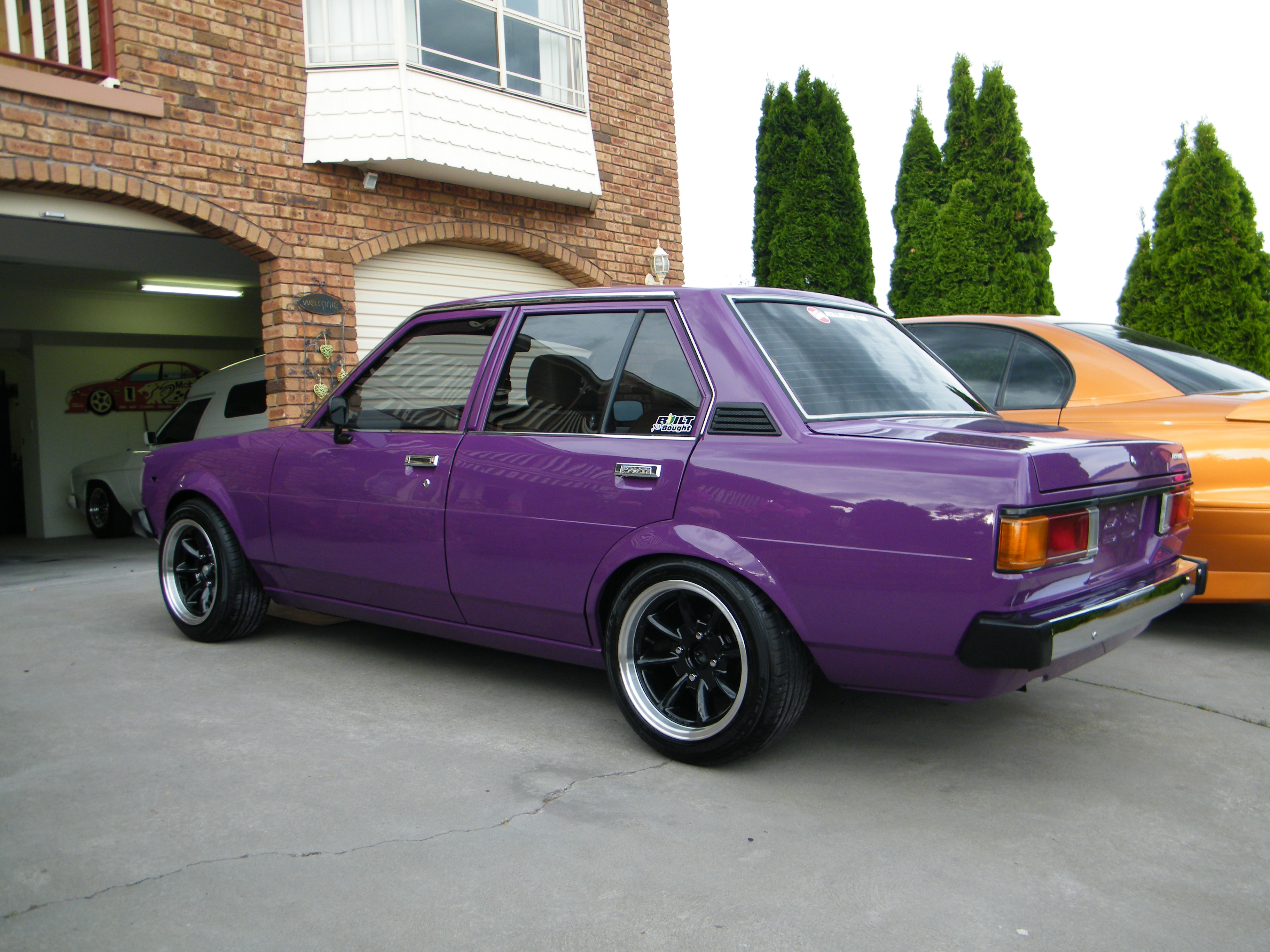

A few happy snaps outside :)
Looks amazing!
Thanks bro :y: , still not lowered properly yet though.

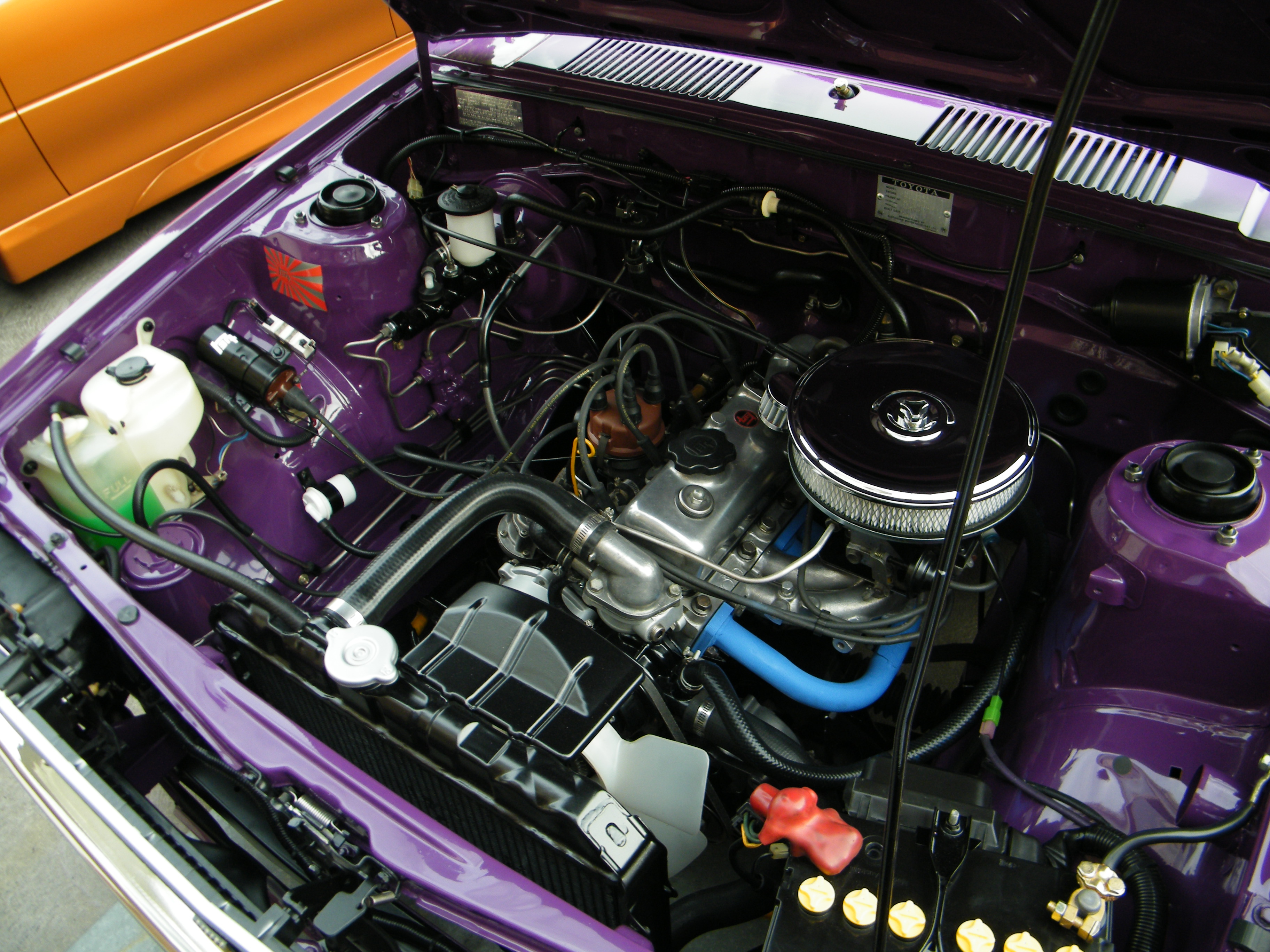

One of the cleanest Ksev's out. That engine bay doesn't disappoint either, clean enough to eat off!
Cheers man, still got a few things to do to the engine bay, white UR strut brace, billet overflow and washer bottles and a gilmer belt drive. Webbers later on when i find some :)

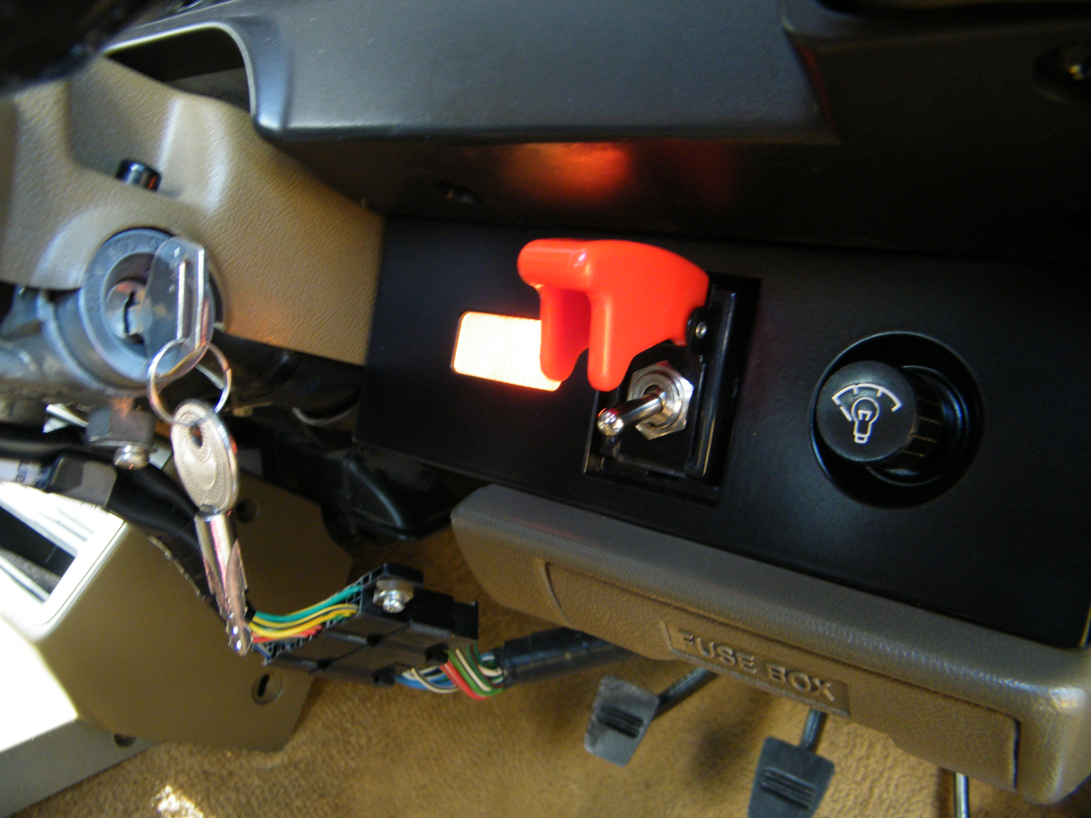

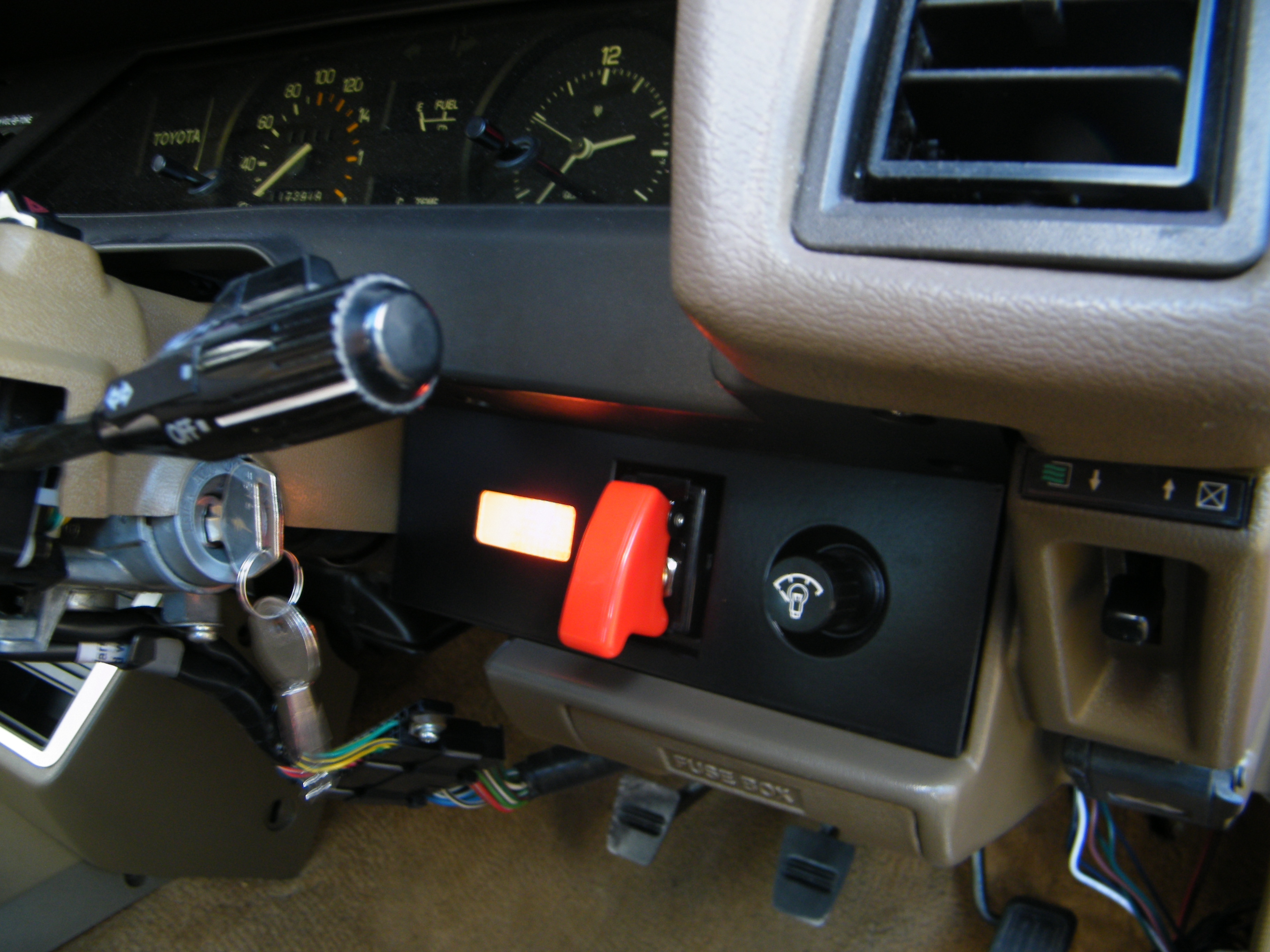

Had an awesome thought the other day and decided it would be sick to have a push button start in the beast, so i went out to Jacar yesterday and brought the parts for $15 haha.
Got busy today and decided to wire it in, works a treat :D :y:
Was it hard to do? whats the process? looks good btw :P
Na not hard at all man. You need to find the starter motor wire that runs to the back of the ignition switch and cut that, then find the power wire on the back of the ignition switch and cut that to. Then i ran a wire 2 wires off the back of the new switch and soldered them to the two cut wires. So then you have the power to the switch that then runs to the starter motor and you still have the key to turn the ignition on so it can't be stolen. Thanks man :y:
