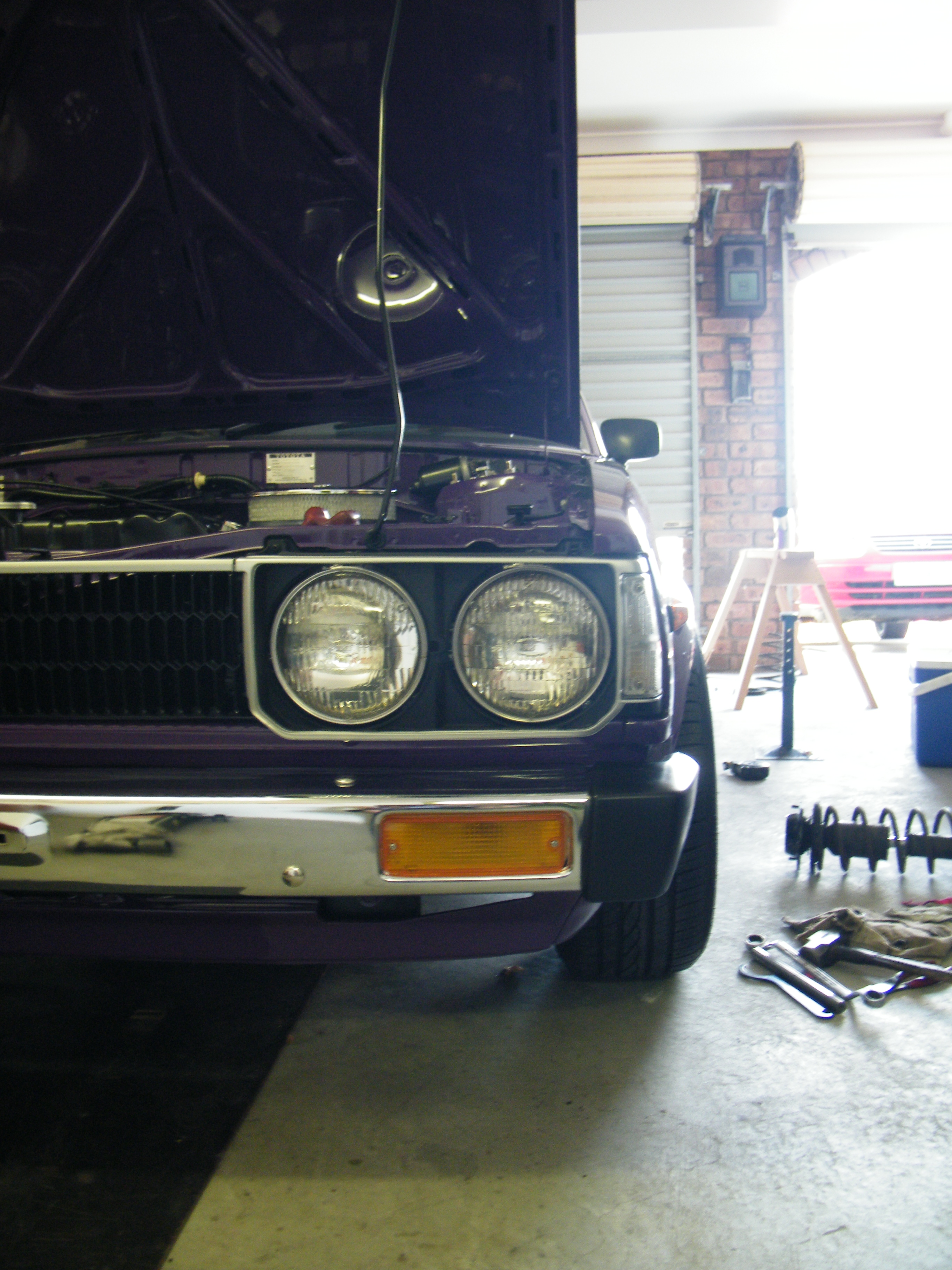

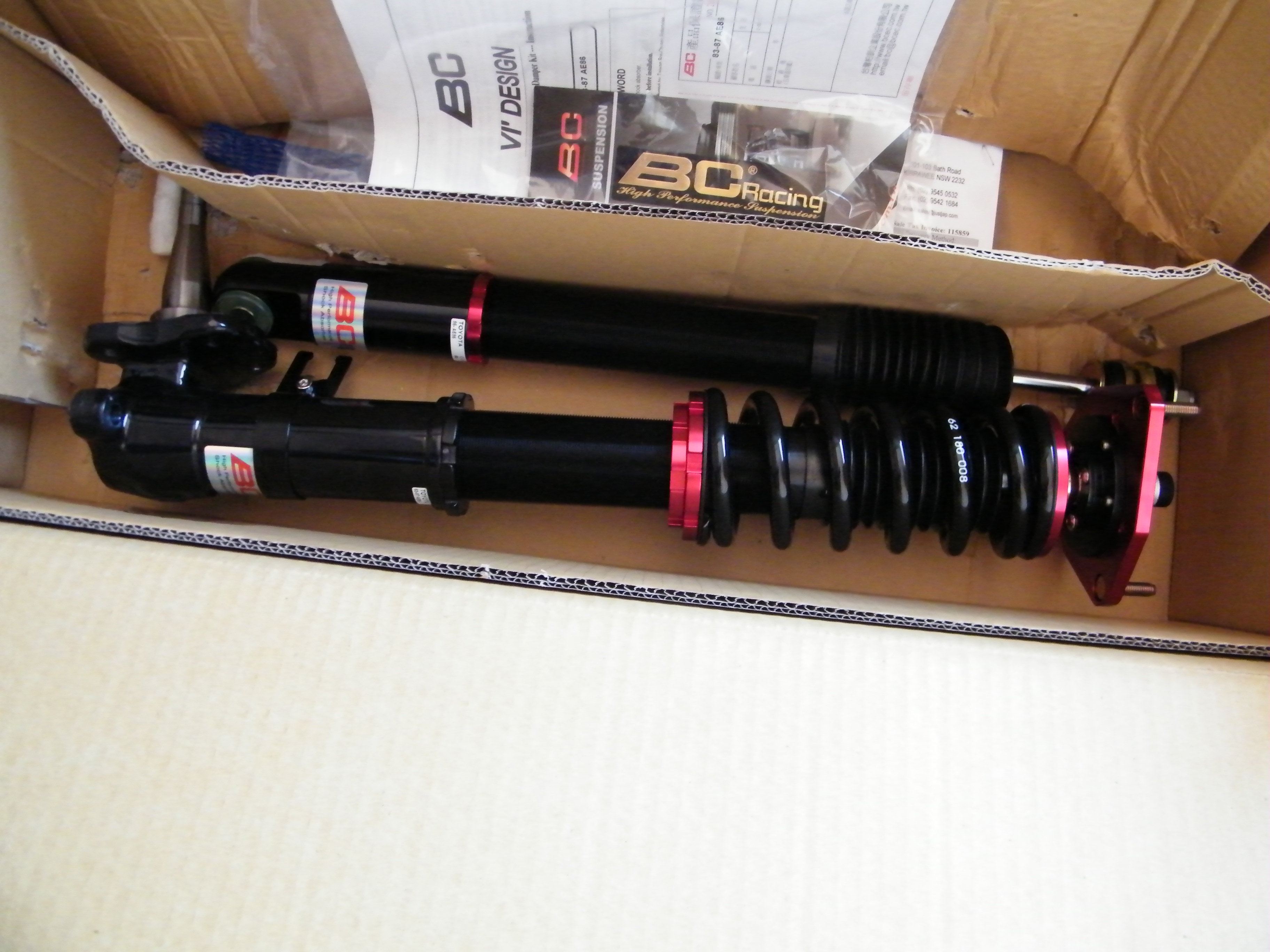

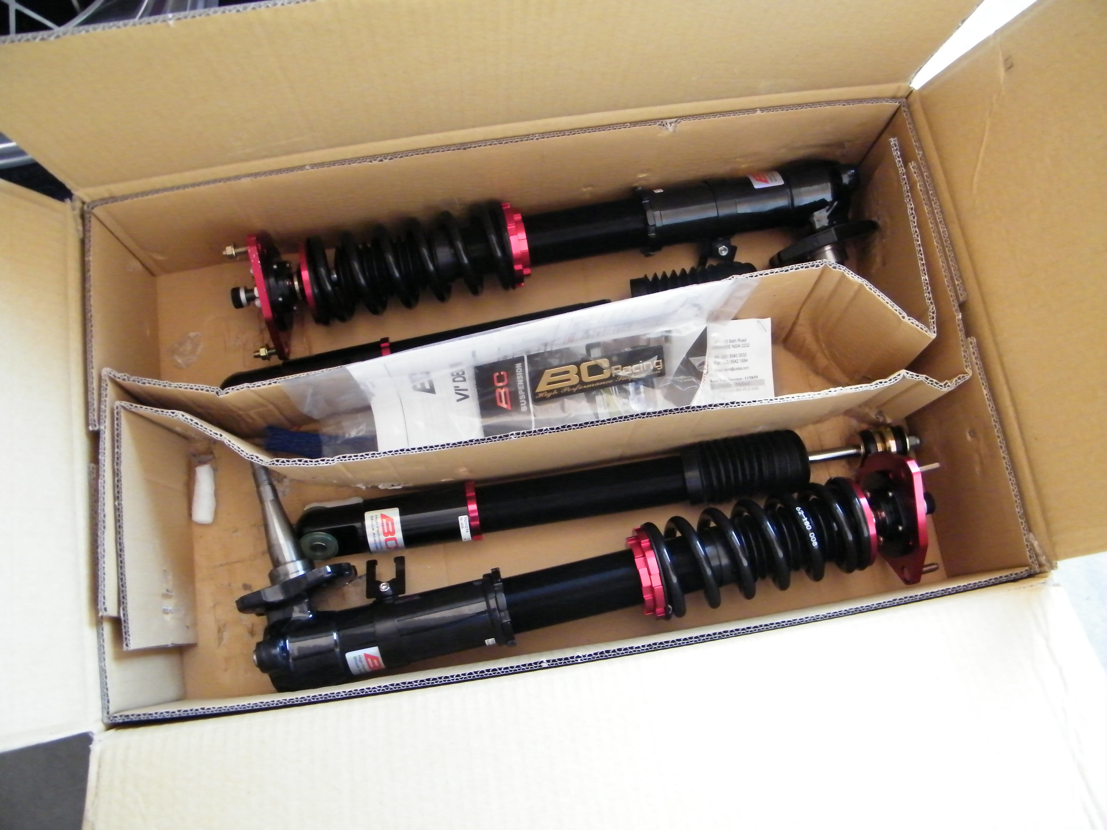

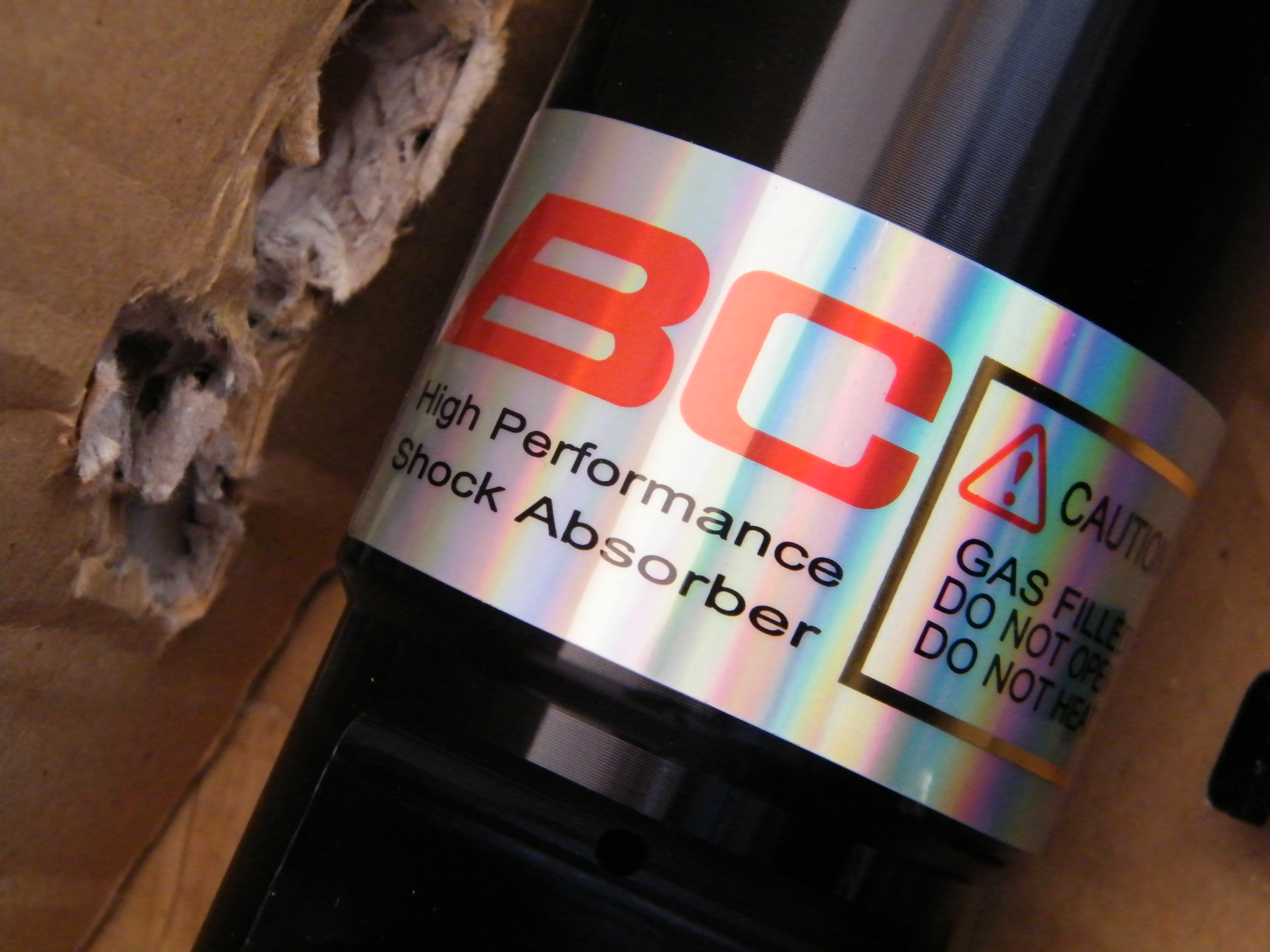

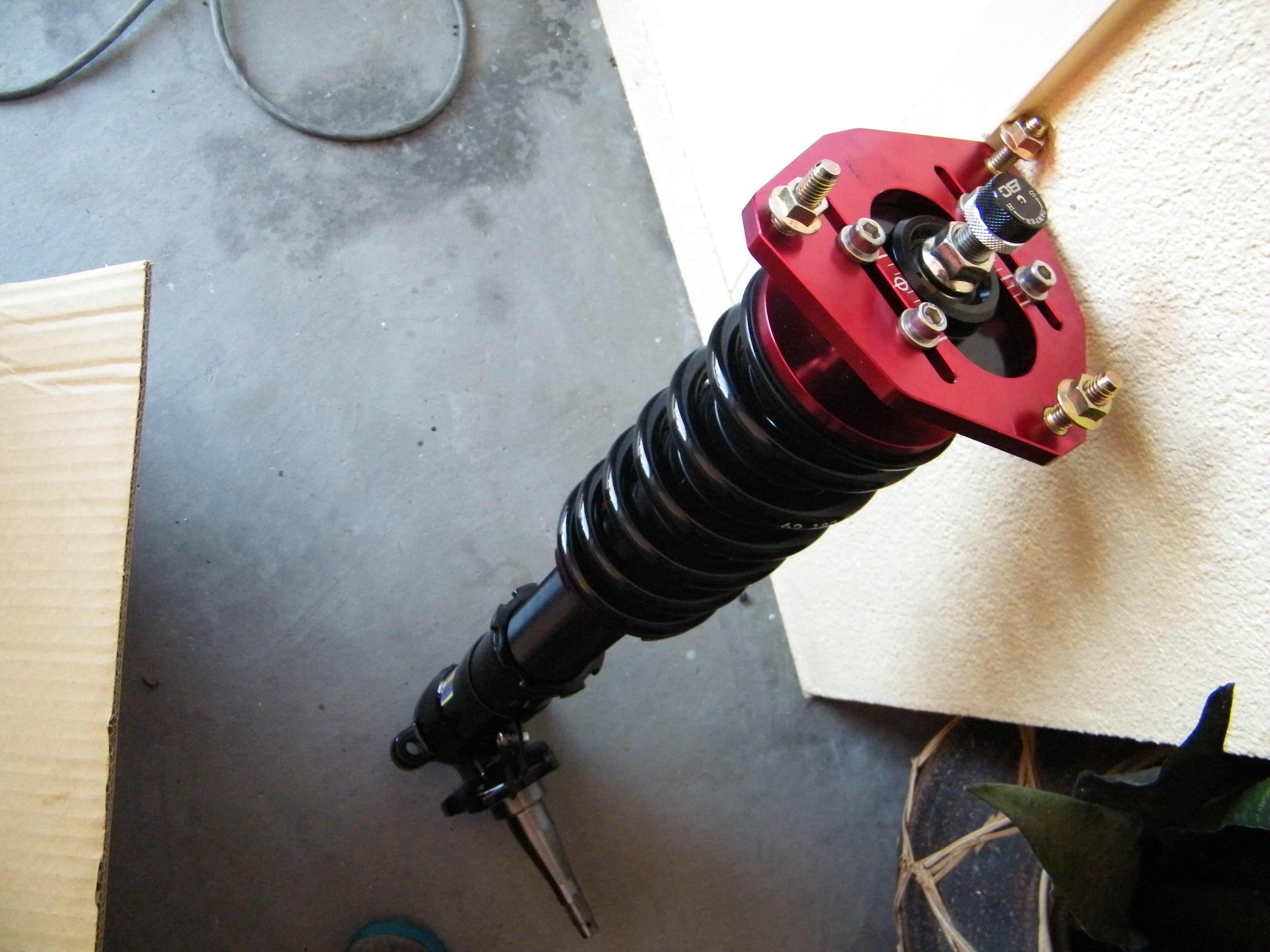

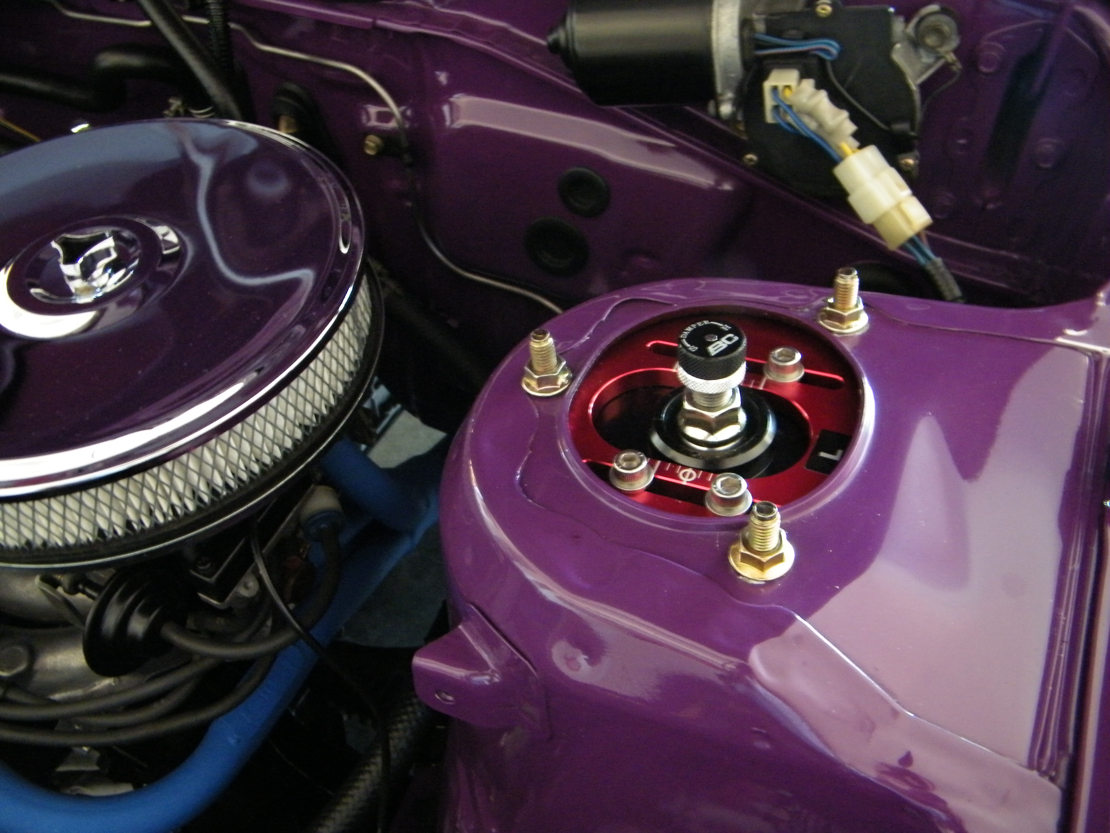

Another bit of mad news is that i also orded my BC V1 AE86 coilovers and they arrived the other day and i have begun fitting them :D so far i managed to file out the Ke70 bottom steering knuckles and recess the locator back in place with the dremil tool because as you might know AE86 knuckles are about 1mm difference between the holes. So they now fit in there perfectly :) Also borrowed an AE86 hub off a mate to try a wheel on for size and everythings all good. Now all i need is the hubs, rotors, callipers and backing plate off an ae86 to complete it.

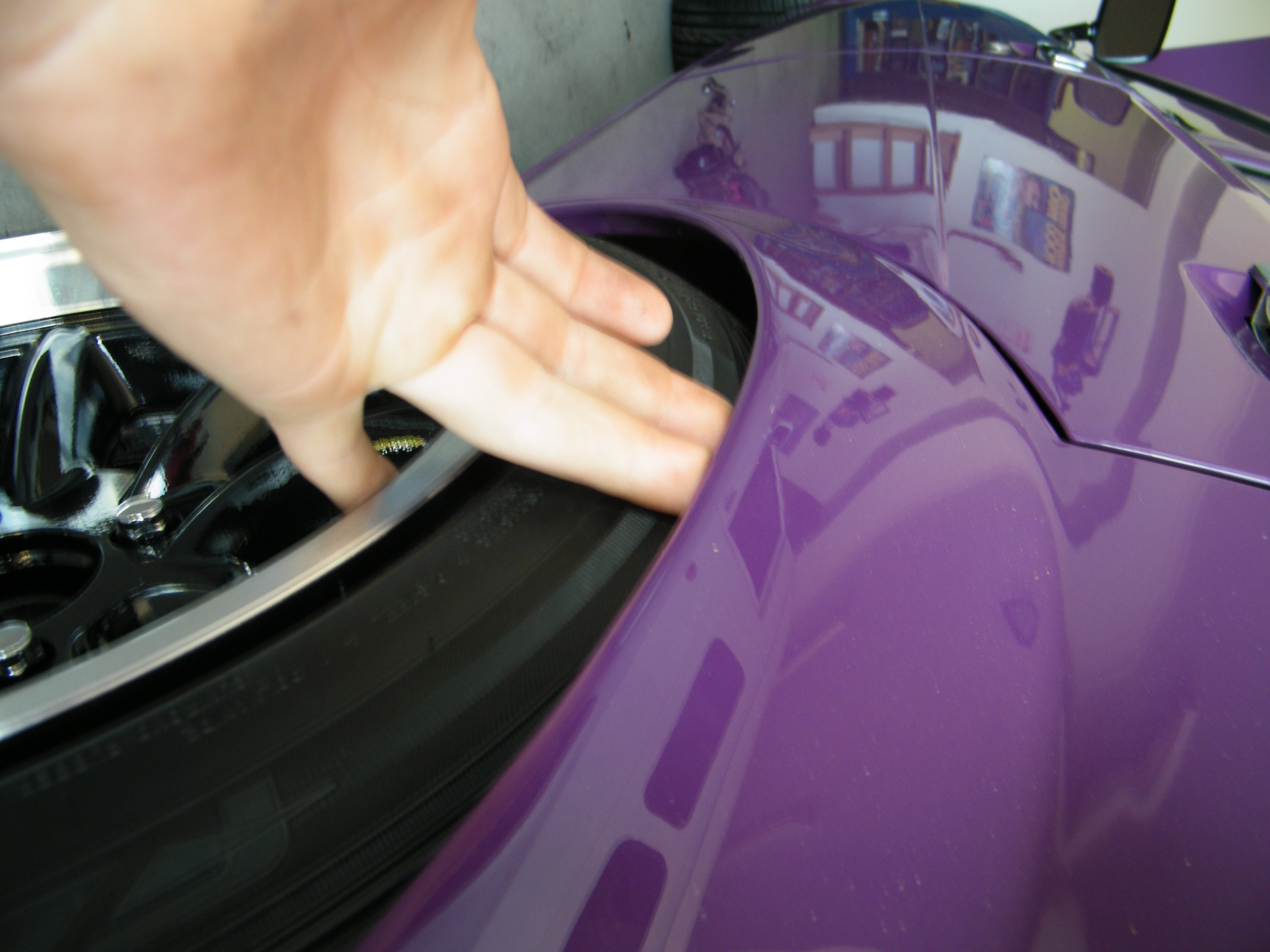

Rear ones fitted straight in and I'm very impressed with the overall quality and the way the dampeinig works, well woth the money. I can now run a really low ride height without compromising shock and spring travel.

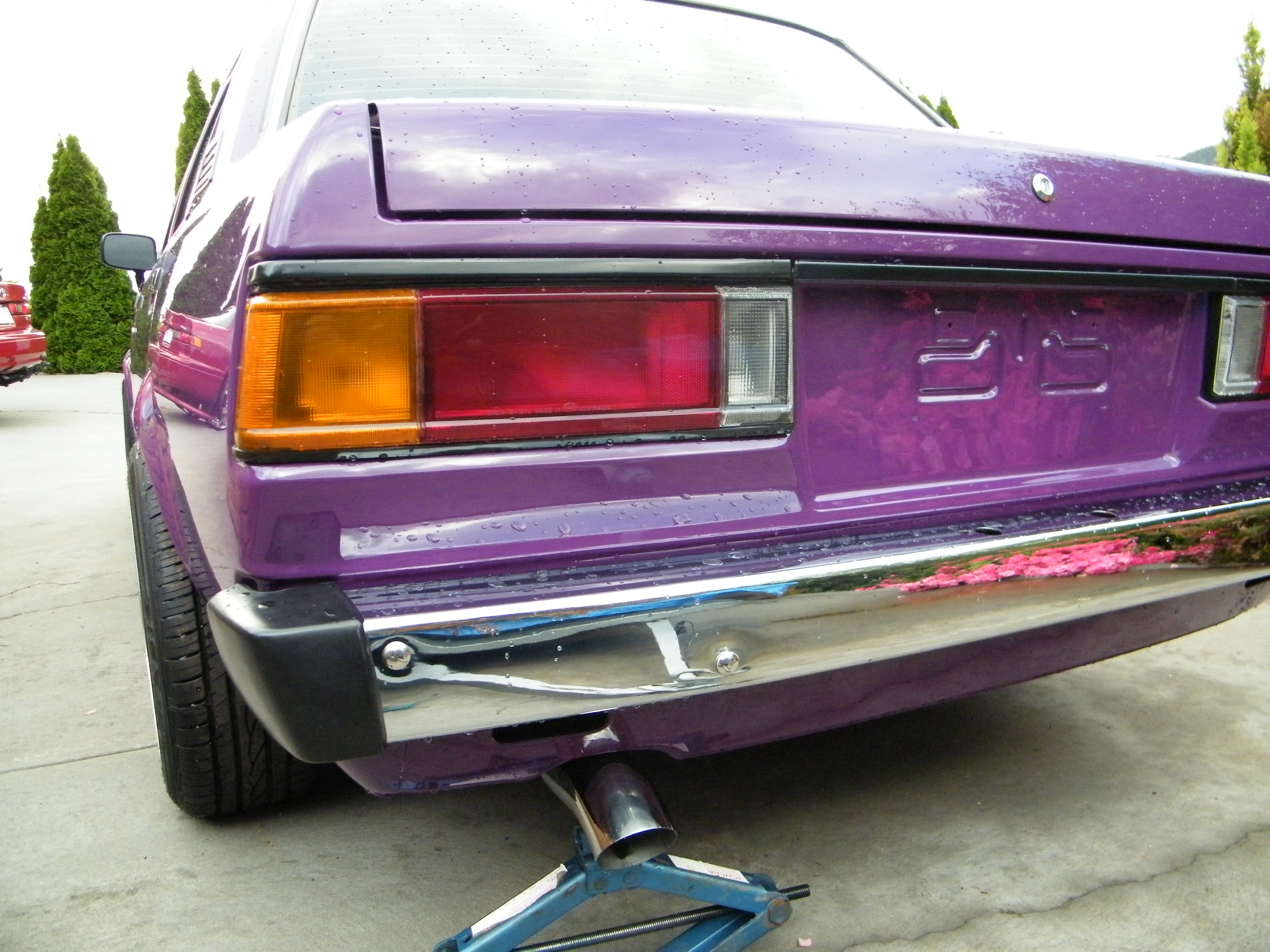

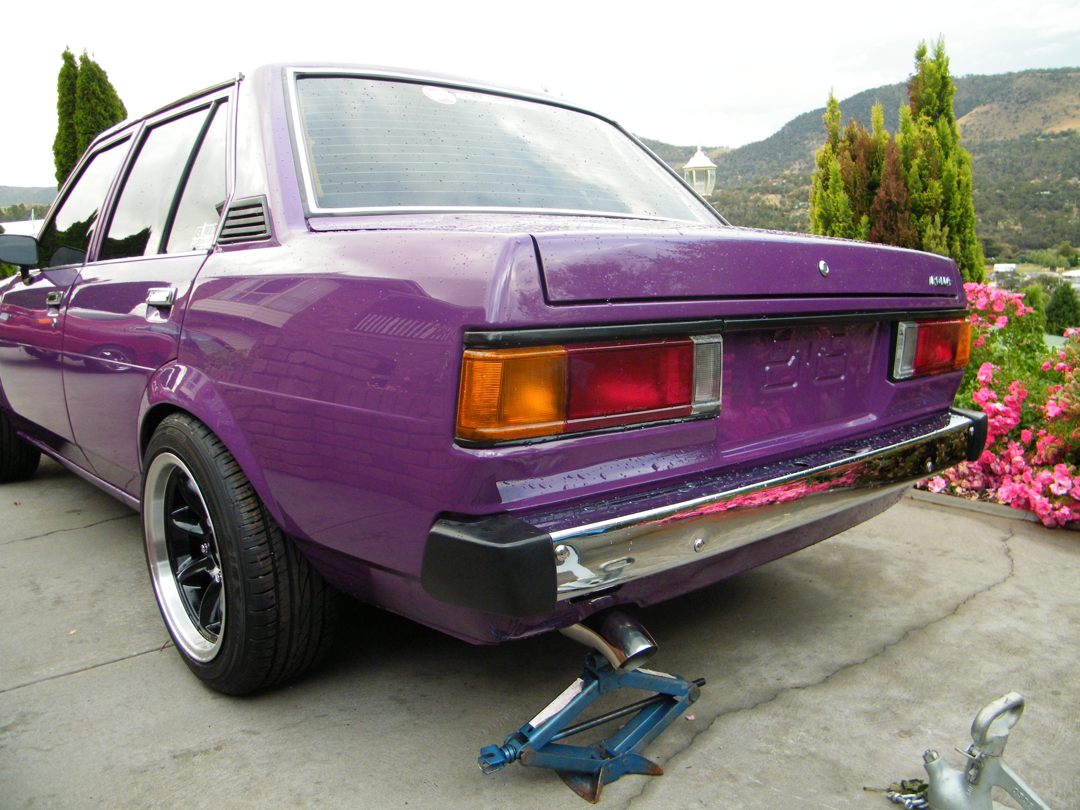

Found a 3" stainless dump tip to that i had to have aswell :laff:

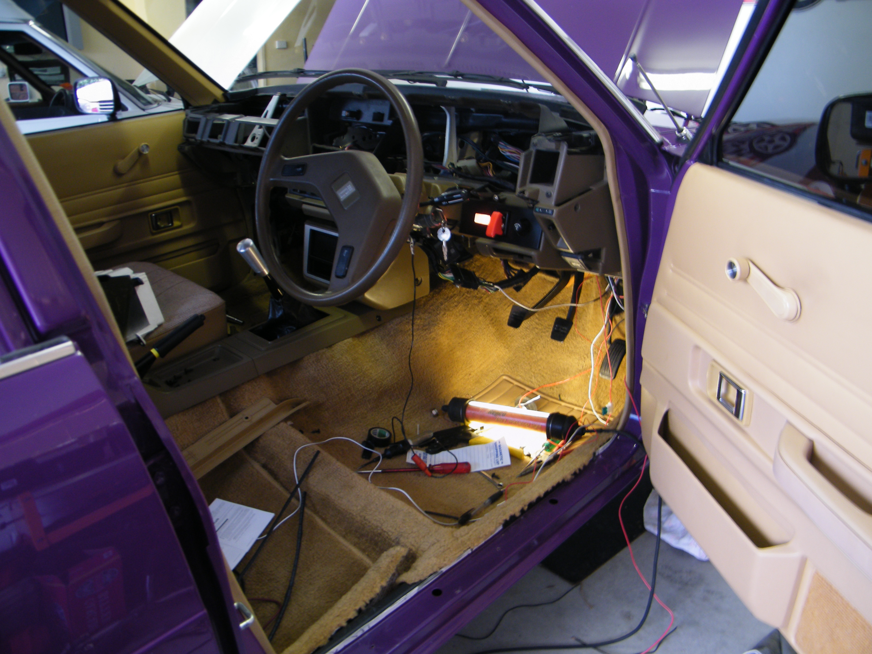

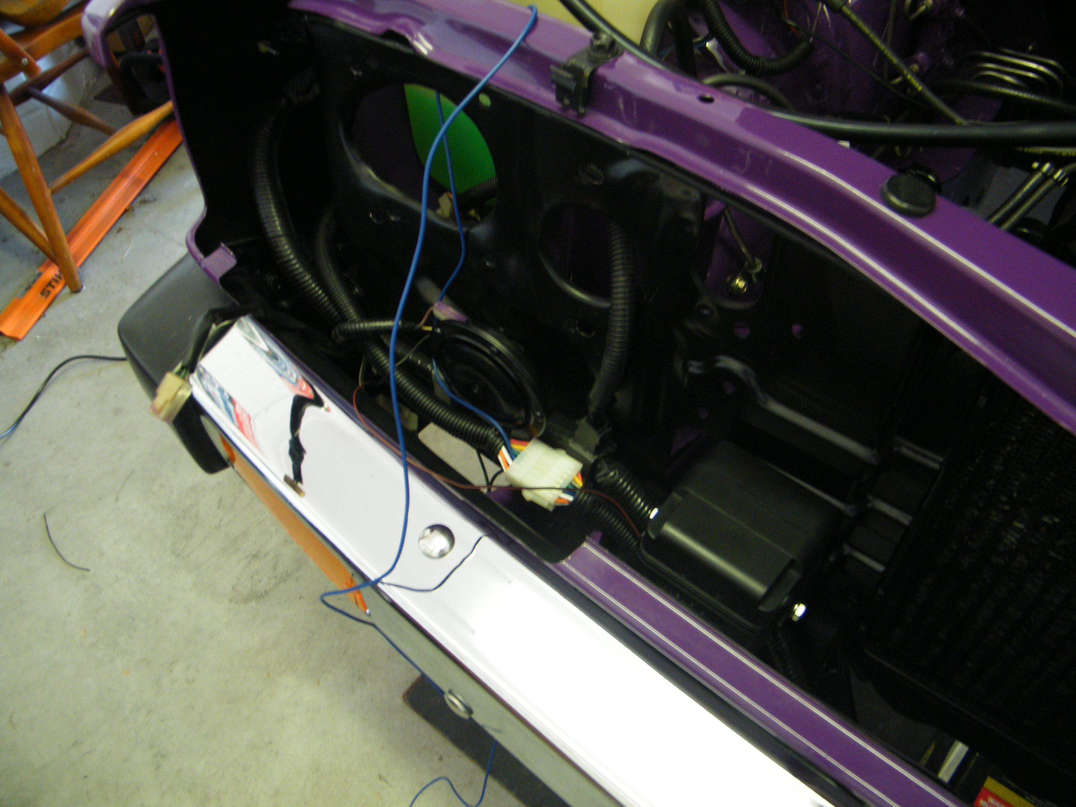

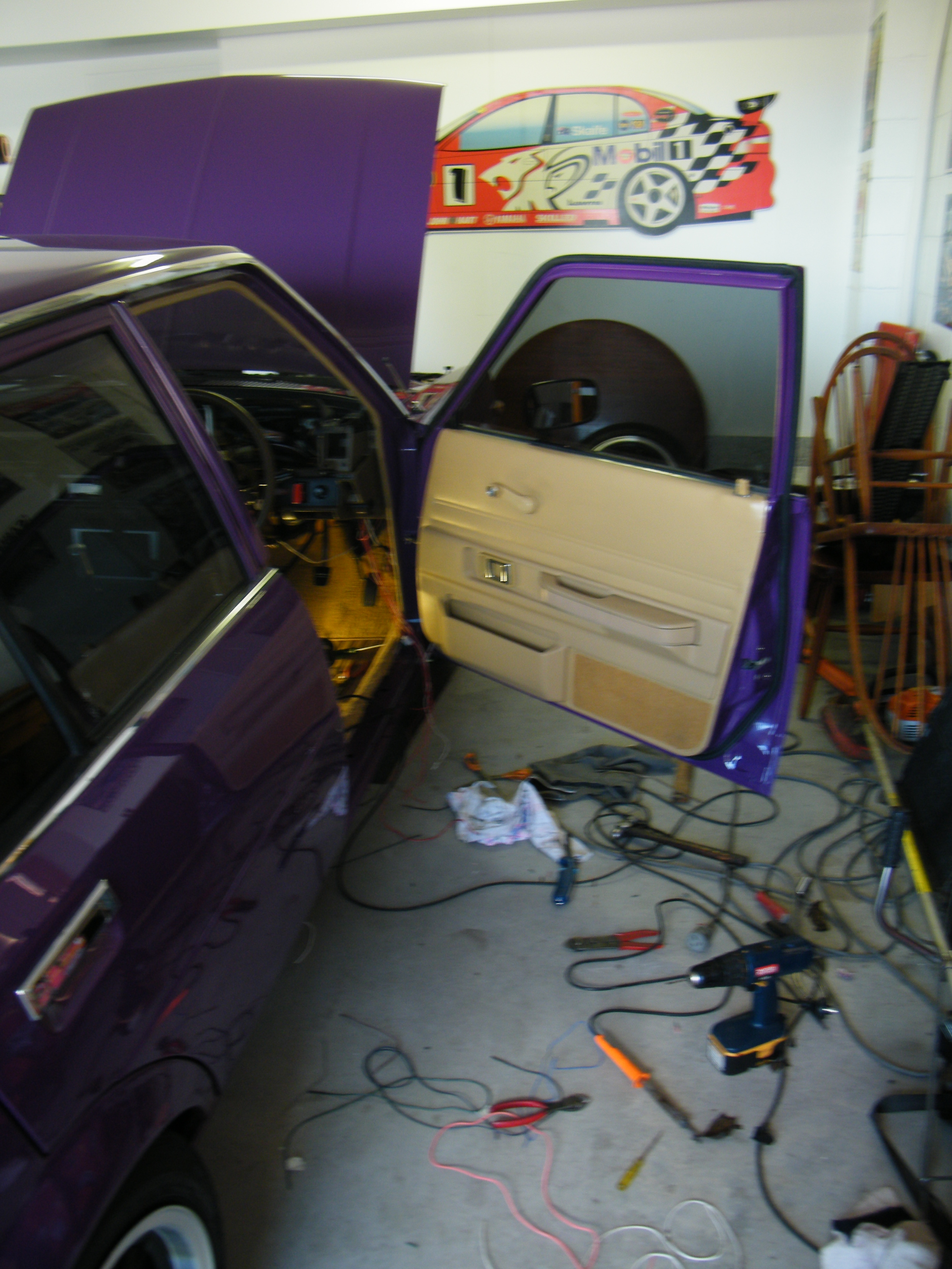

Got an awesome present for Christmas from the old man. A kick ass secerity system that immobilises the car and activates the central locking, has an 128db alarm 6 tone siren that is one of the loudest available, can be activated from over 100 feet away, has shock sensor detection and a bonnet alarm switch if someone manages to get it open and a back up battery on the alarm if someone disconnects the battery. Also wires into the indicators so they blink and the siren beeps when it is locked and unlocked and it has a remote control panic mode to scare people off. Loves it :D thanks Dad
So we began the mamoth task of wiring in the millions of wires yesterday and finished it off this afternoon and it works a treat, i also set the alarm off and i can safley say that yes it is one of the loudest as i am nearly deff :laff:

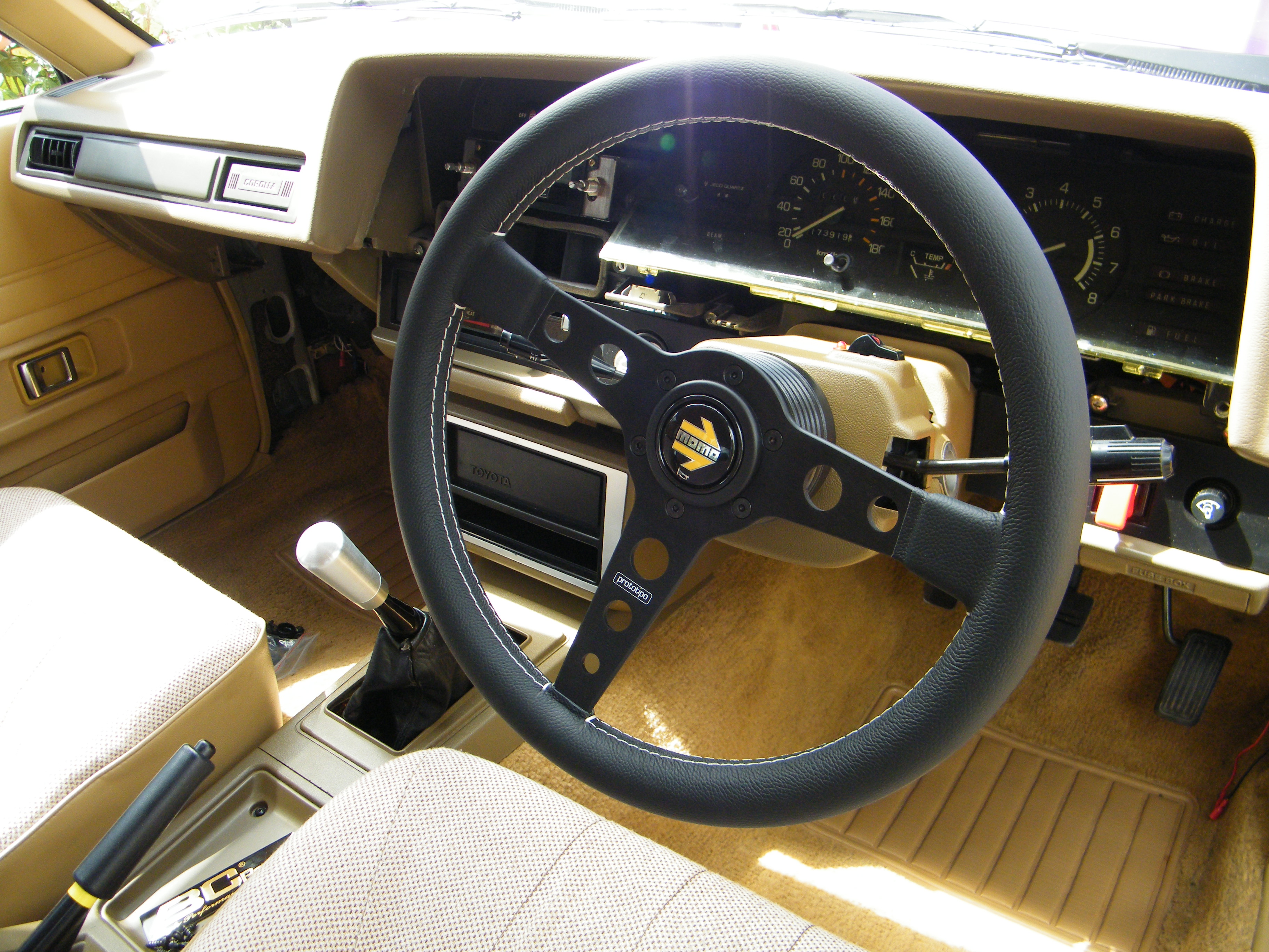

Also heaps of stuff i orded off the net arrived over the last few days. By far the best thing that arrived was the MOMO stearing wheel :wub: I raced out and brought a boss kit for it as soon as i got it :laff:

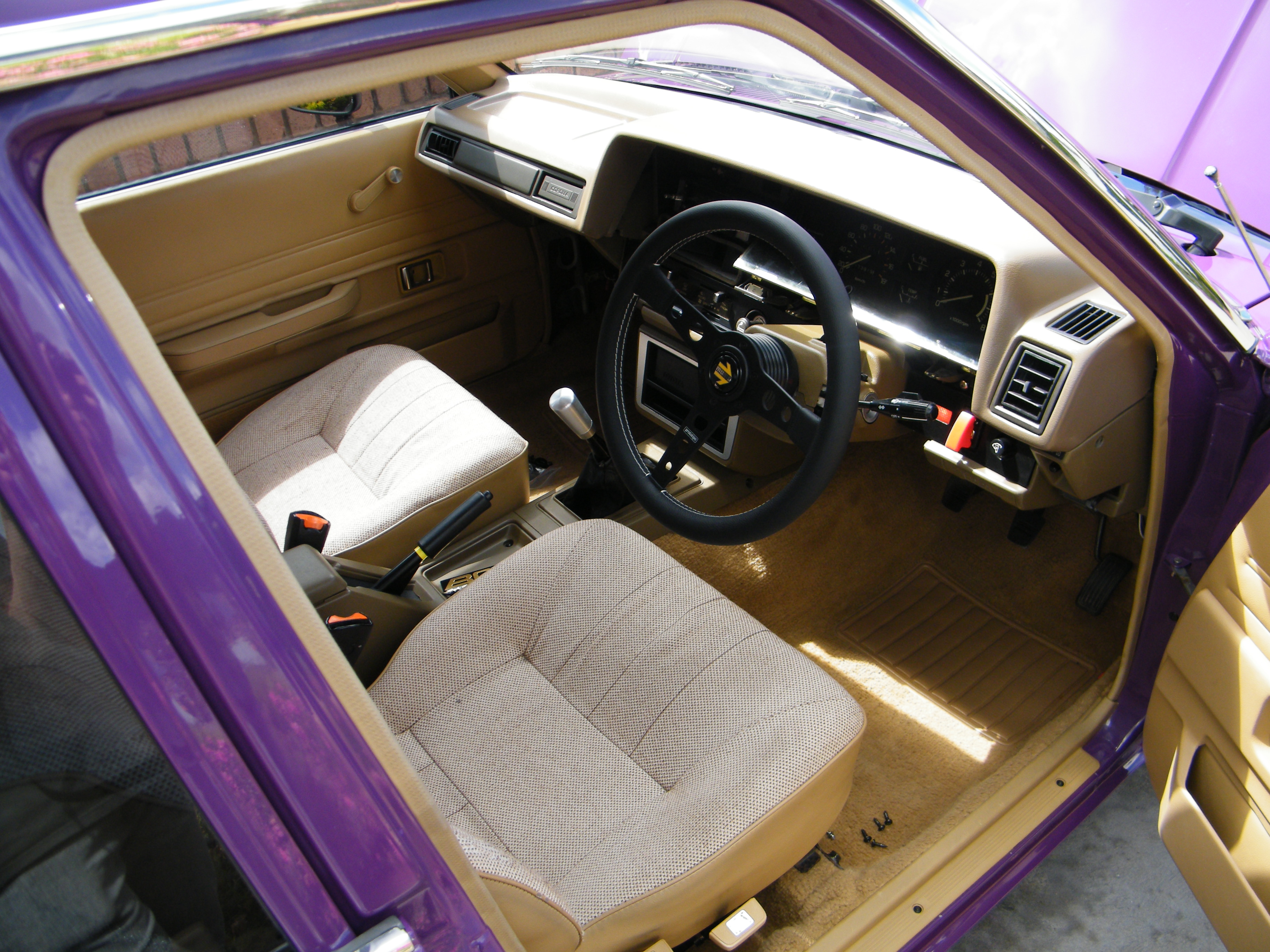

Added a bit of jdm to the inside :cool:
