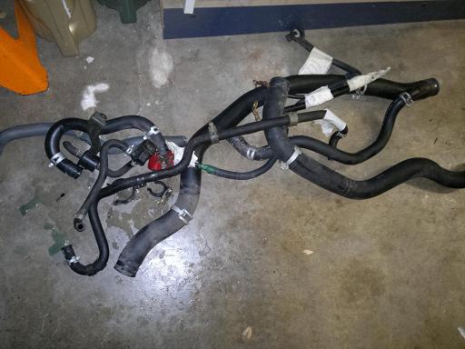

Started stripping the motor down today. I disconected the engine loom from the motor, pulled the factory exhust manifold off and the AC pump also as i wont be using these, now its ready to start fab work mounting it in the engine bay of the rolla. Stay tuned !

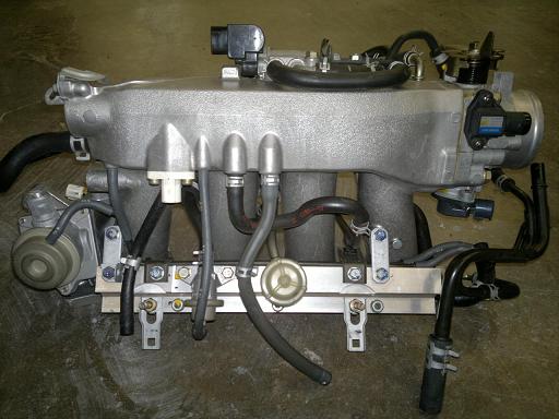

Been playing around with a spare intake plenum i bought cheap, deleting all the factory casting marks off the plenum and runners smoothening it out for hi fill primer so i can paint it when I'm ready. Should look the goods when its done !
