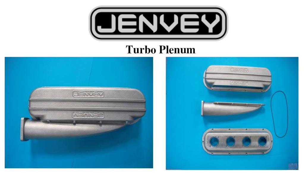

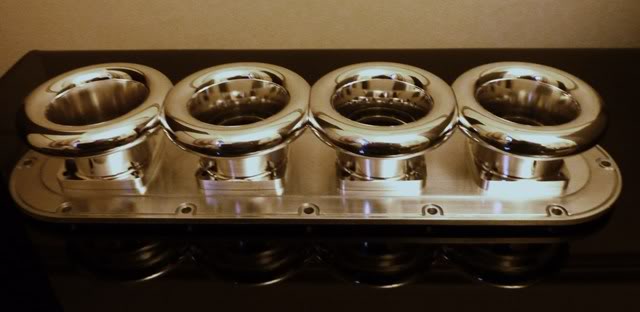

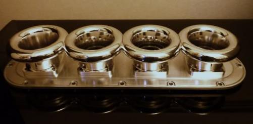

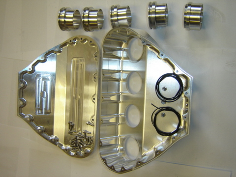

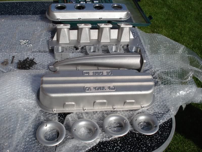

Are you talking about the smaller one pictured at the top or the one further down the page, I'm afraid your post left a bit too much detail open to interpretation, maybe next time just load the actual picture url instead of the whole thread, there were about a million plenums in that thread.
I looked at the bigger turbo plenum but I think it has more sticking up that will interfere with the bonnet potentially, whereas the other one I could save a little more height I think.
sorry about pics had some issues with my pc.
How about a plenum that extends downwards like on the hayabusa or bikes
with a pipe going to a filter where the grille is like on the 240 and 260z?
Could be done with the Jenvey backing plate for a base.
Its not the pic I had in mind but similar just missing the bottom inlet
here is the link to the bits and the backing plate is a good start maybe for something custom like the last pic?
http://www.jenvey.co...me/turbo-plenum
http://img847.images...plenumaps1t.jpg
