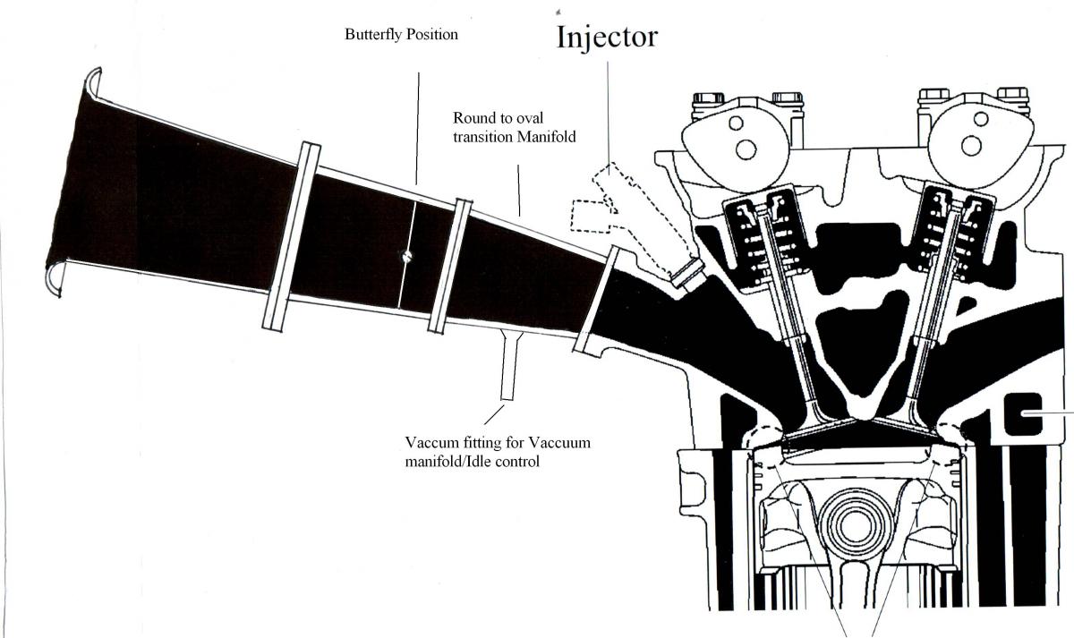

Dropped off the inlet to the engine machinist next to my shed. He is going to face the throttle side of the manifold, and tap the vacuum ports for me. Also, he is chemically cleaning the throttle bodies so they will look much nicer once installed. The I can port match it once I get it back.
