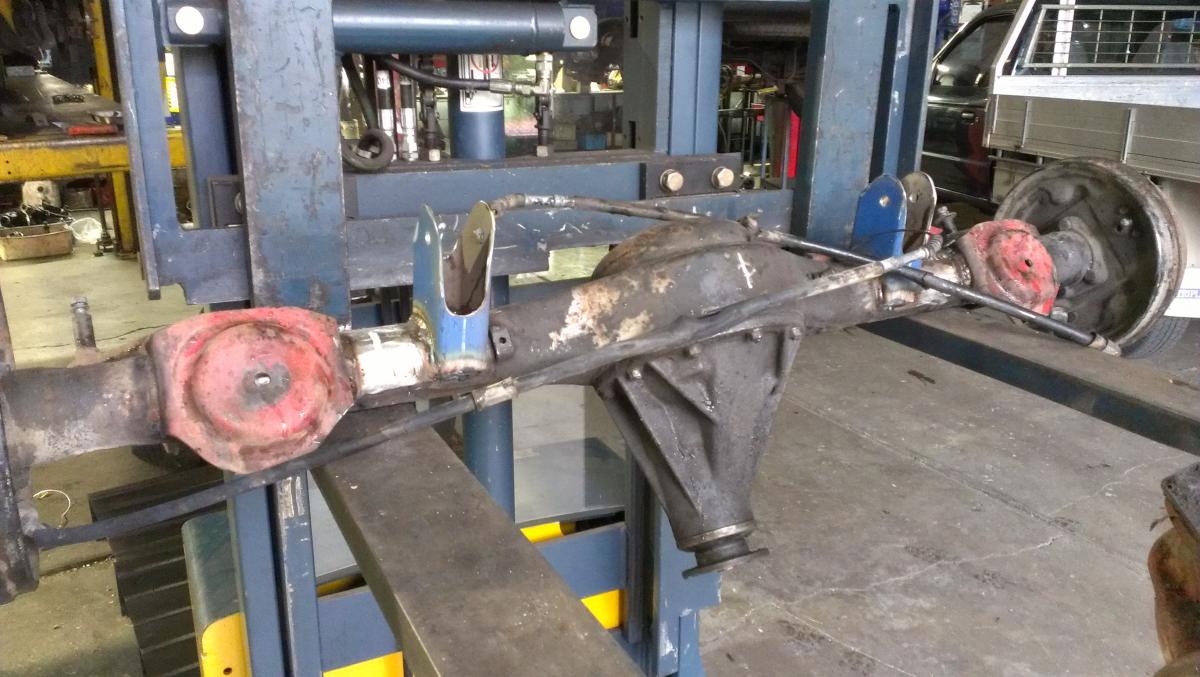

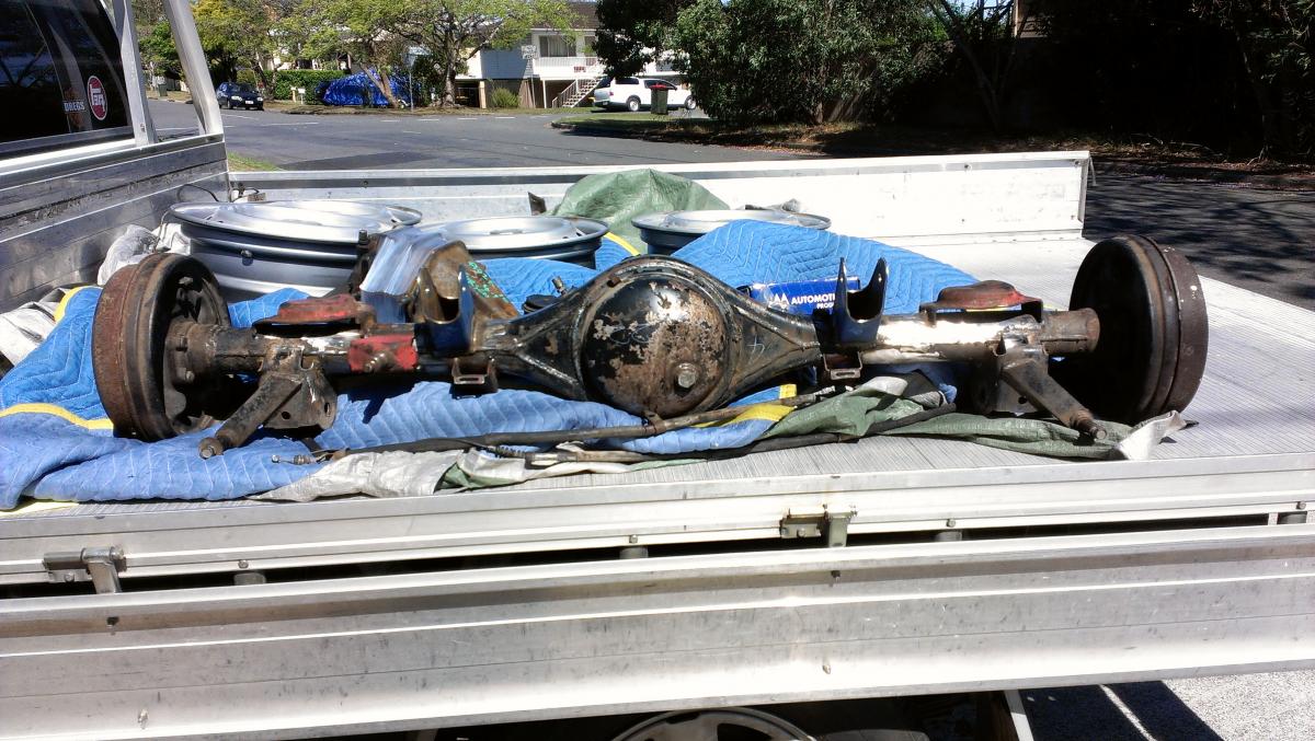

Just collected the diff housing from Rick sendalls. I'm very happy with it.
Took it straight over to diff lapping with the LSD centre for it. Should be done in under 2 weeks.
Ricky is also making the coilovers for me.
Once I get all this back ill bolt the driveline and suspension into the chassis. Then I can find and flare the wheels into the body before painting it.

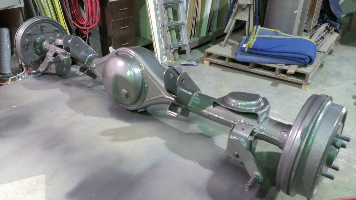

Surprisingly, today yielded a lot of awesome if expensive progress.
Diff lapping rang me. Diff all done.
Specs are...
3.9:1
Lexus torsen LSD. Type 2 (the type with parallel shafts along the pinion, not accross. The stronger type.)
F series mk 2 corona diff with ae86 mounts fitted.
New jap oil seals.
New pinion and carrier bearings.
Solid pinion spacer conversion.

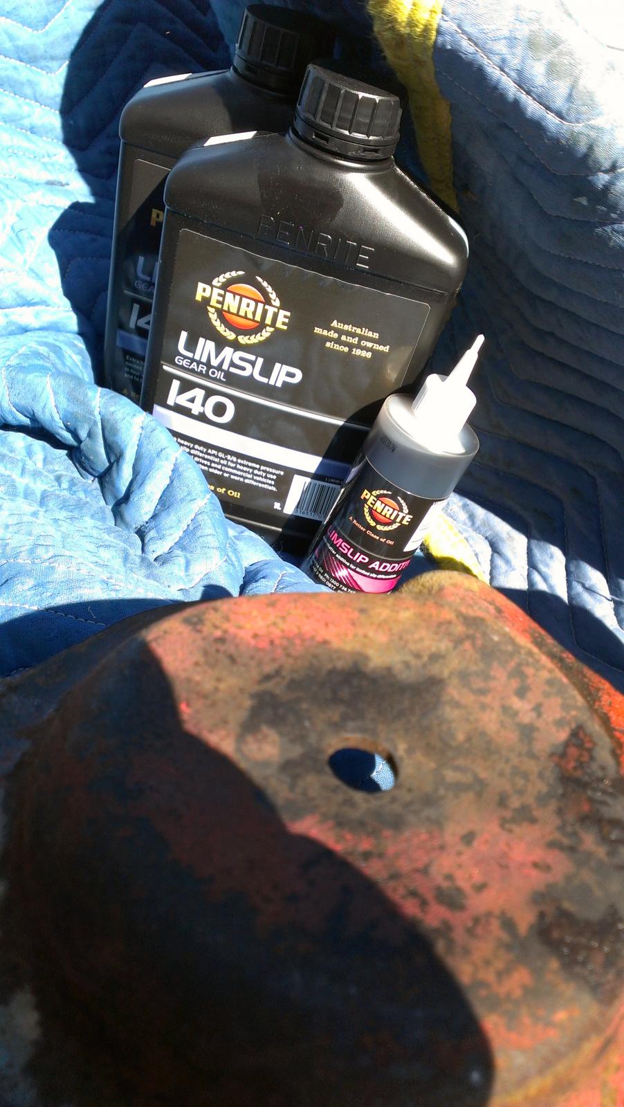

Comes with penrite limslip 140 and penrite LSD addittive.

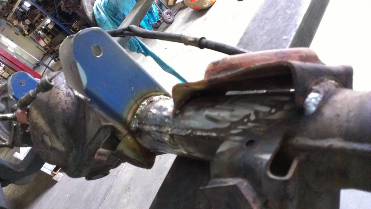

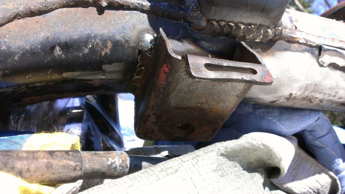

Housing was measured and straightened at the diff shop after it was welded.
Has ke70 swaybar mounts on it.

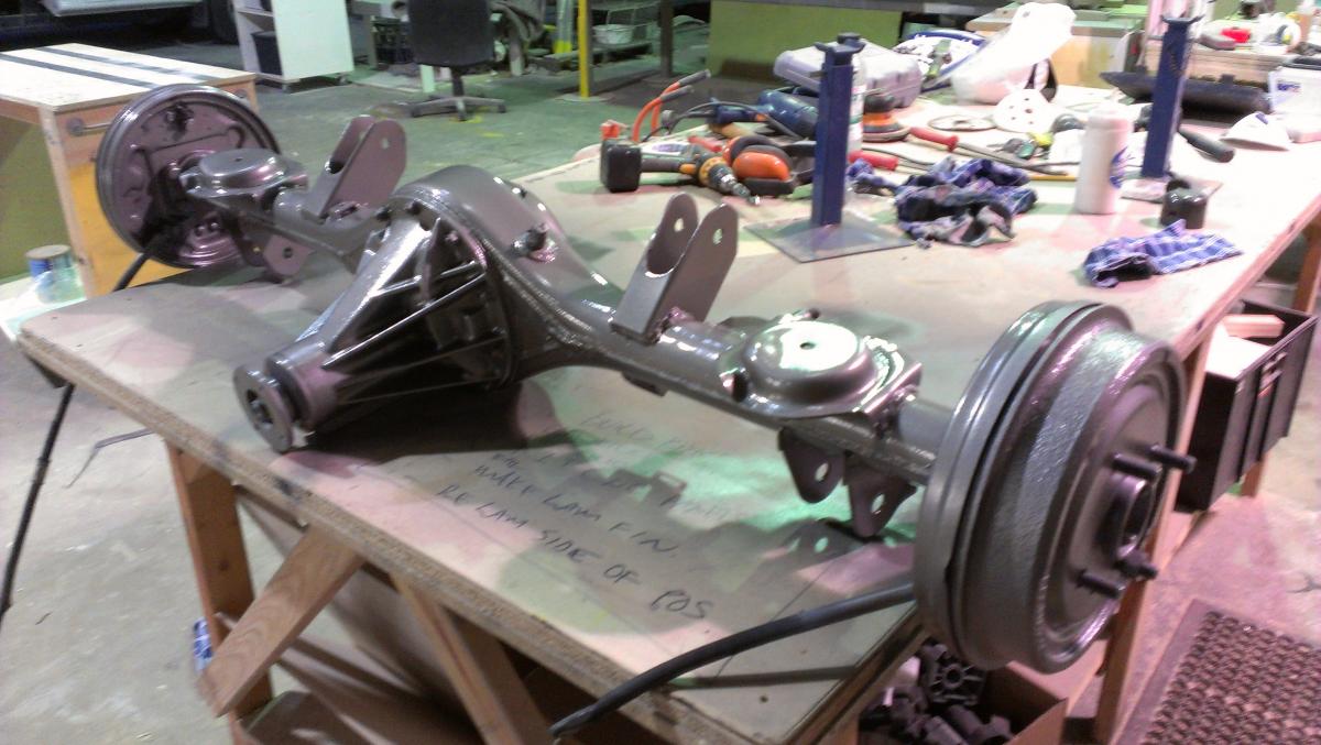

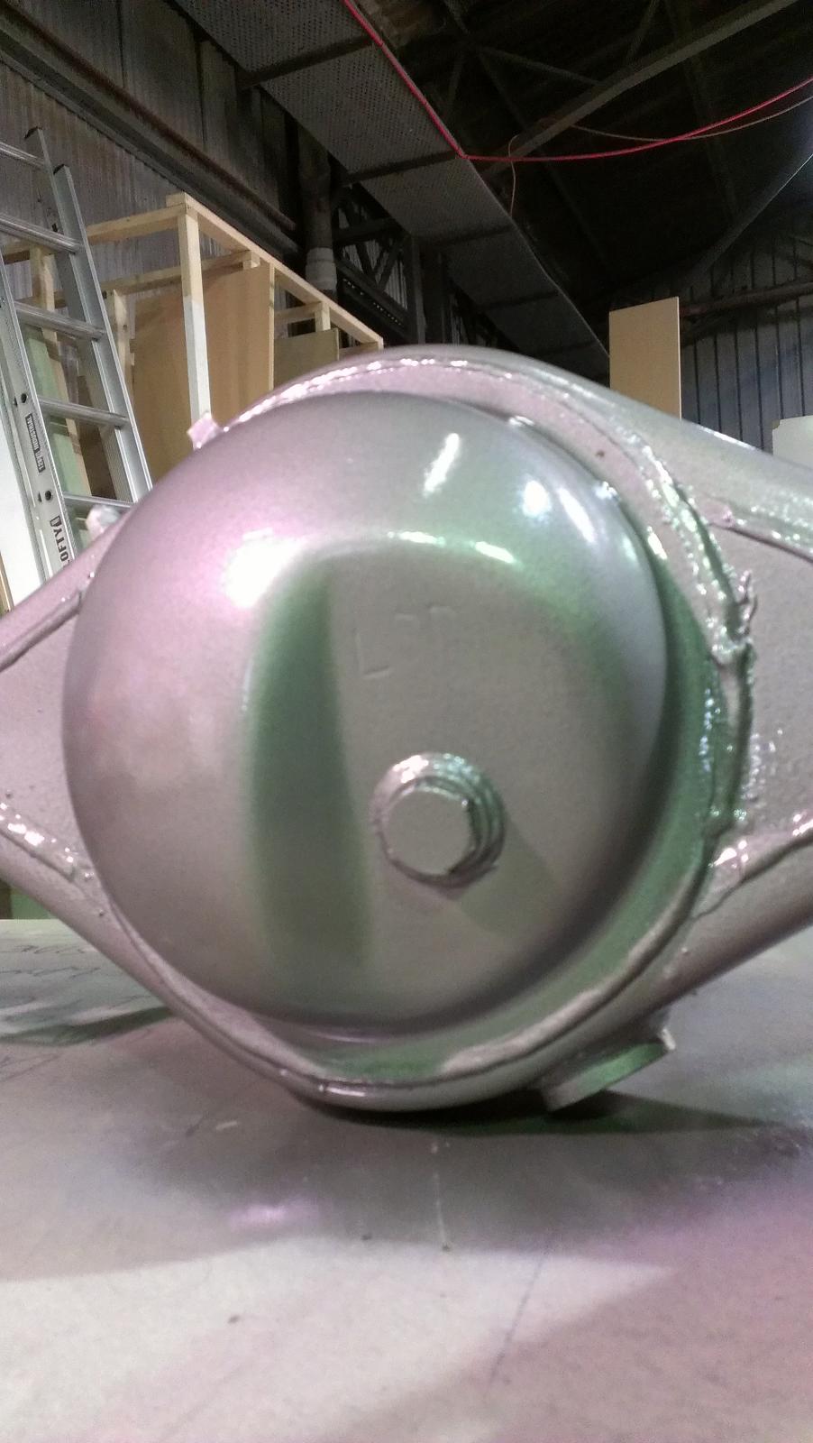

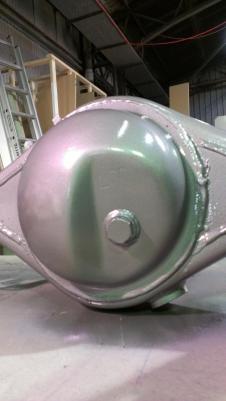

So I collected it, went by bunnings. Bought etch primer and two cans of hammer tone gunmetal grey.
Took it all back to the shop and soda blasted the housing. I then prepsolled it and did the paint. Came up amazingly well.
