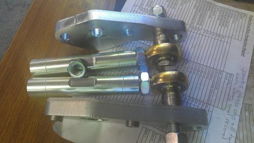

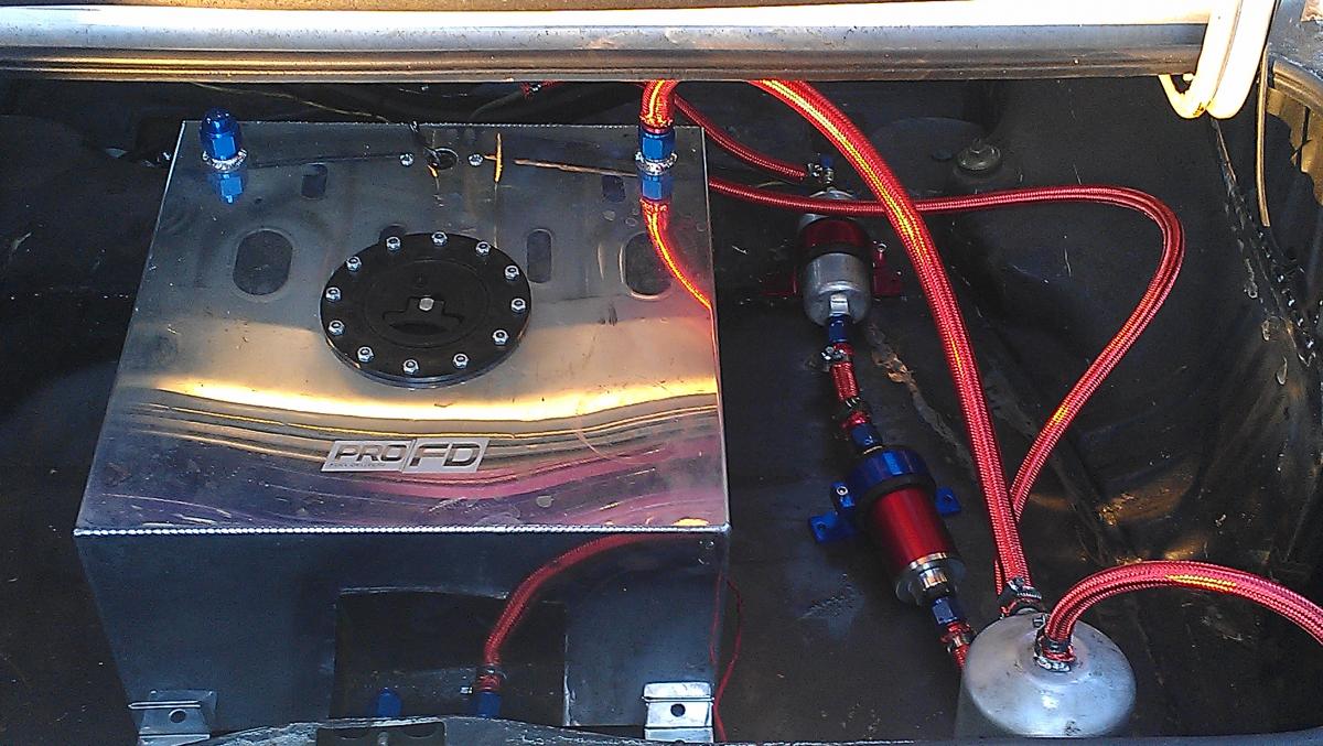

Fuel system is done, bit rough lookin but it does the job, have to pull it back out soon to paint the interior anyways.. my outer tie rods and steering knuckles showed up too, they are 20mm shorter than power steering knuckles and my god are they beefy !! 20mm thick.
